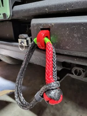

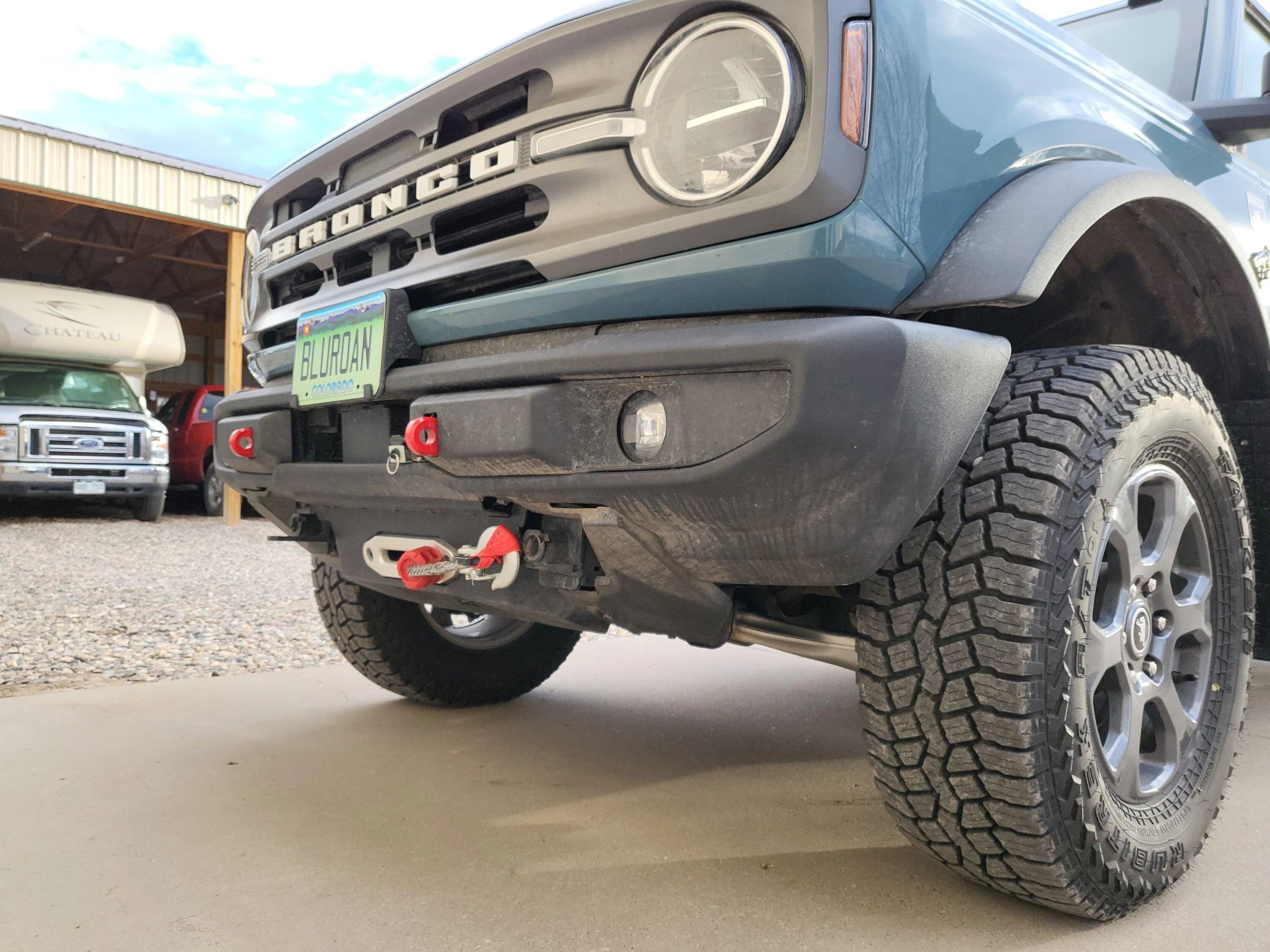

Good luck to you. I have the Blue Ox bases, first they are expensive and you lose your hooks. The BO bases are attached with 4 bolts and are he'll for stout. Having the skills you good add a recovery hook to them. I added some up high that I'm not that confident in.

@dgorsett How in the world did you add those recovery points???
I want to learn from what you did.

I built brackets out of 2x2 box iron with bolt/weld on shackle mounts from Amazon. Bolted on using 2 bumper bolts, cut opening in plastic trim. I have enough confidence to use them myself but not enough to recommend to others.
In the future I may add something to the BlueOx bases or maybe by a take off Capable bumper.

@dgorsett Thanks. I can fabricate a little myself. Do you have pictures to inspire the rest of us? Can you share details about what you got from Amazon?
