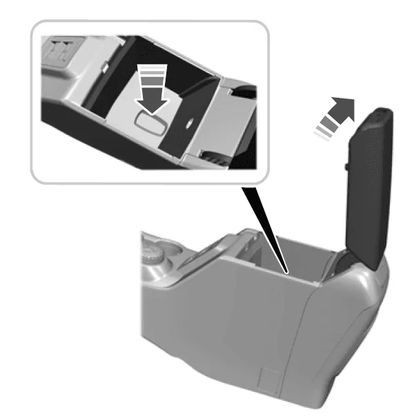

Also… should your key fob battery die, there is a spot near the bottom of the center console where you can place your key fob to start the vehicle even if the battery on the key fob itself is dead.
OK, where is this "spot"? :)
Are we talking about where the shifter is? or actually on the center console? I looked at my center console (manual) and there is no place to put a key fob other than the tray area.
Inside of the center console storage compartment at the very bottom. On most Ford vehicles they have a little picture of a key fob to show you where to put it—not sure if that is true for the Bronco.
Personally... I would take the battery out of your key fob and test it. My wife had an issue with her key fob on her Escape, and I told her about that trick and it didn't work. After about 5 hours of troubleshooting in a parking lot... it turns out the connector for the key fob sensor (I assume it's just an NFC reader) in the center console had wiggled loose—probably wasn't connected all the way at the factory. So yeah, test it... one of those things you only will use if you really need it, and it would suck to have it not work when you need it.

Inside the console, pull out the fabric bottom... Voila.
Picture from Owners Manual:
