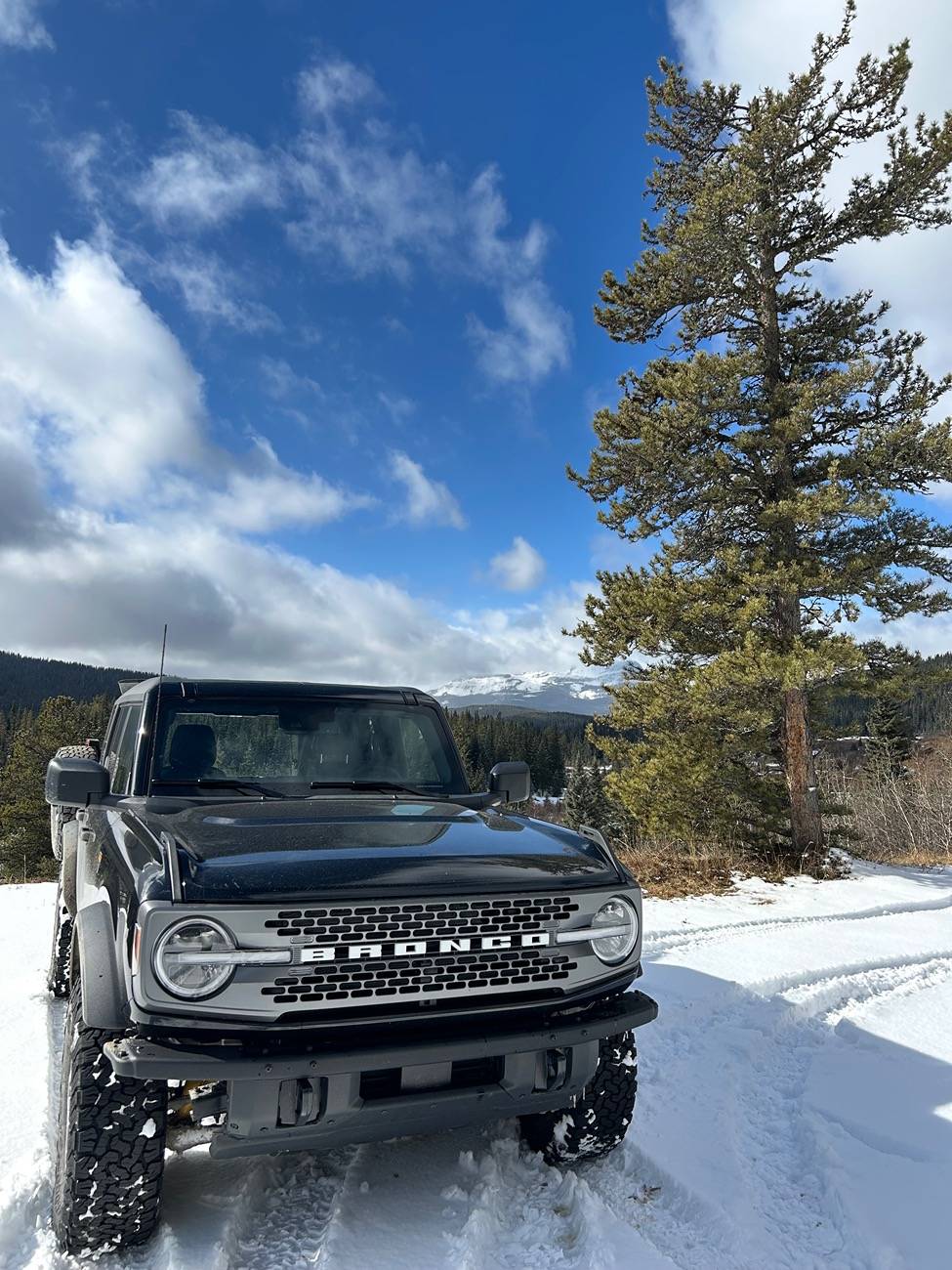

Out wheeling in the snow today and decided not to use Mud/Ruts like usual on a familiar trail, but manually engage 4H / RL / SBD / Trac Off - a much better experience! No unnecessary revving, smoother shifts, more predictable traction throughout the day, anyone else have similar experiences? In the snow or else where?…
I was moving through packed and fresh snow up to a foot deep, the packed snow in the heavily rutted areas was nasty, surprisingly technical trying to stay outta the treeline!
I’m getting a pretty good feel for the Bronco now and have been playing around with settings, modes and driving, really starting to get comfortable behind the wheel.
Just a few thoughts, another fun day out and about!
