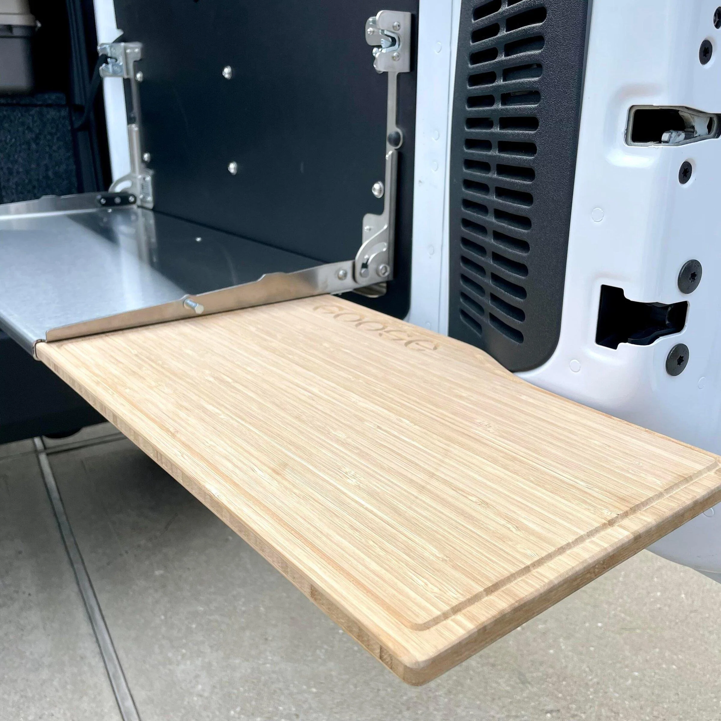

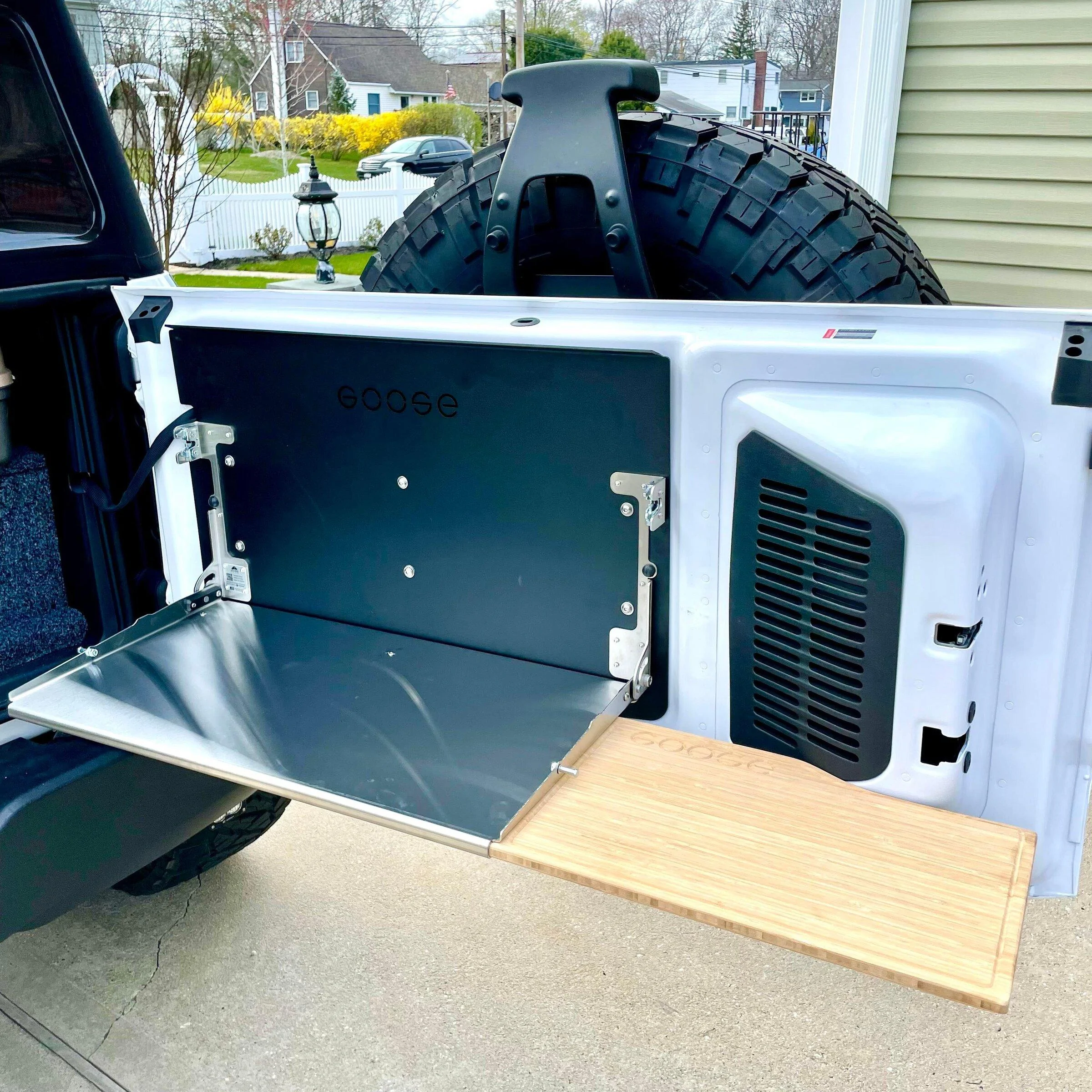

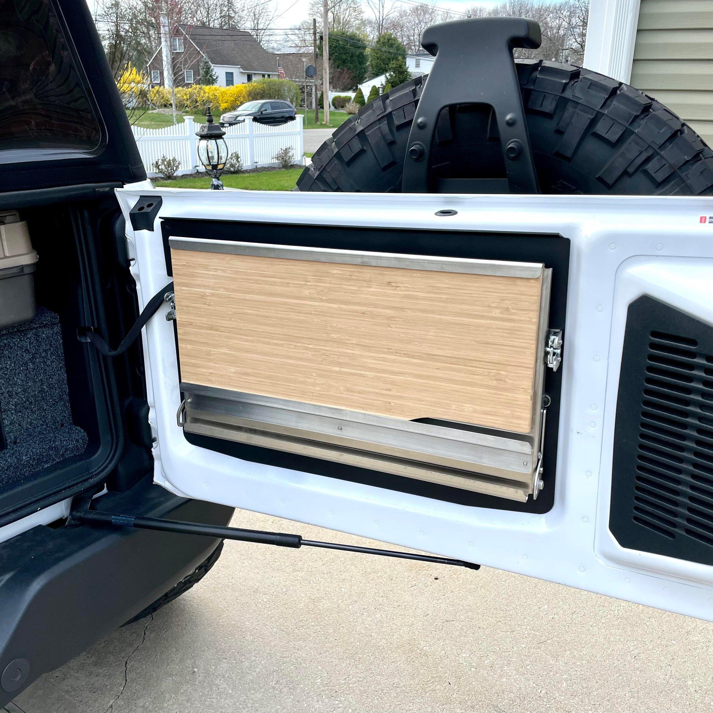

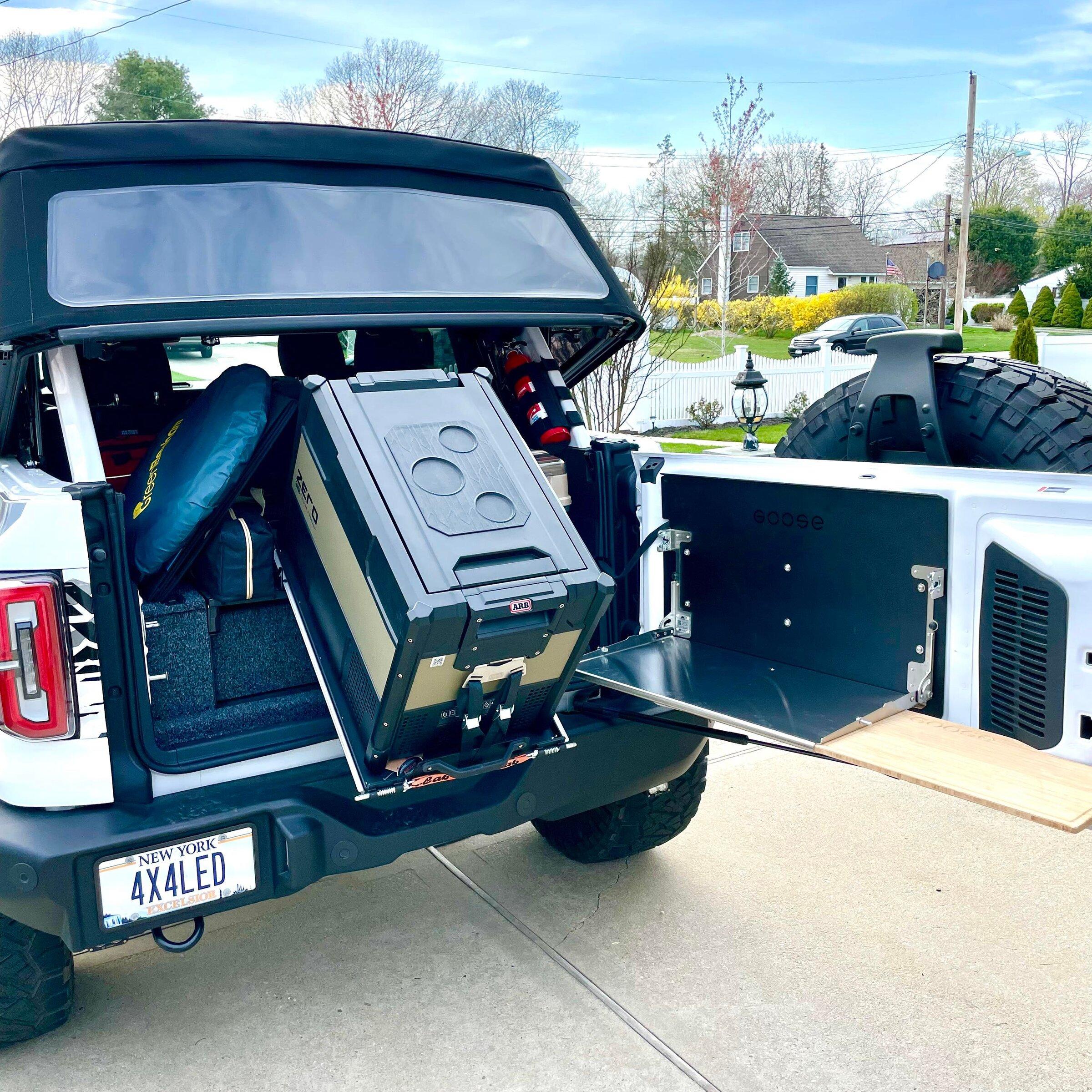

So we've wanted a table installed on our Bronco for a while. I wasn't happy with the tables out there, since we wanted something really solid and durable. I did like the JCR table with regards to how it mounts. The rear plate that "sandwiches" to the tail gate seemed like the most solid. But the lead times were an issue and I still wasn't a huge fan of the support cables.
I've seen the Goose-Gear table and liked it, but it has a $529 price tag. BIG BUCKS. At the end of the day, I decided on the Goose-Gear. It was in stock from a dealer (yes we actually bought this at full price) and we had it within a week.

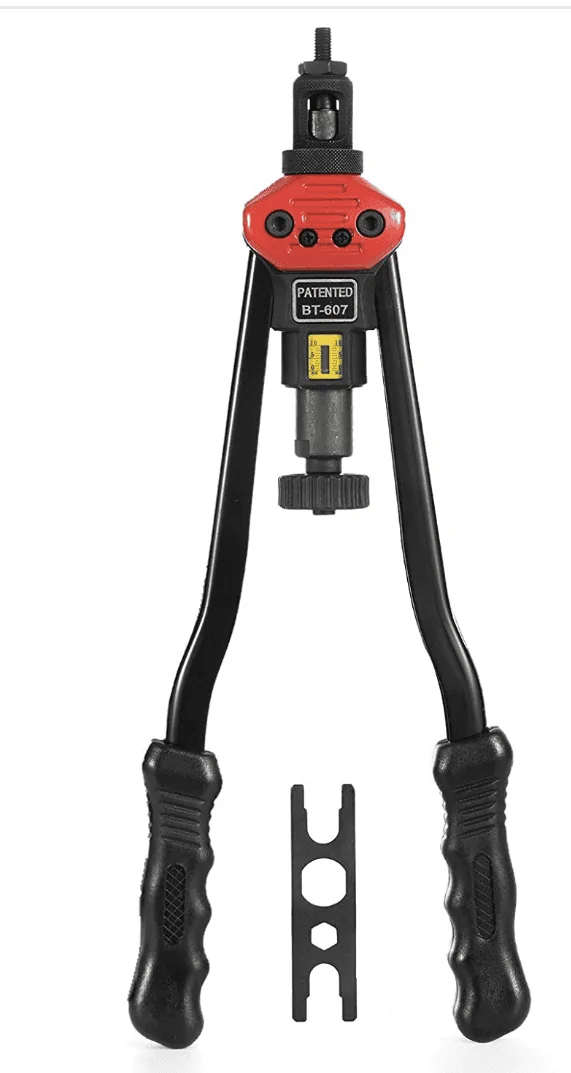

Installation was pretty straight forward. They use rivet nuts (provided) which is a pretty good way to mount things. I will say that anybody installing this... invest in the proper rivet nut gun to use. That'll make installation MUCH easier. We had a few issues with the provided tool (which is a bolt and a nut, that you use with a wrench/socket to tighten it down/mushroom the rivet). The LAST rivet bound up on us and free-spun. We had to cut it out and luckily our neighbor does automotive restorations so he was able to cut it out and put a new one in with a real rivet gun. MUCH BETTER! So invest in one of those tools or borrow a friends. It'll make installation MUCH easier (although installation was honestly pretty easy).
The table has some weight to it. That was a concern since we're already carrying a 35 x 13.50 spare. We do have a reinforced mounting system for the spare AND our VR Forged wheels are pretty light. So this should be fine.
Table is great. ROCK solid with a slide out cutting board (which was a big selling point for me, it's like a 2nd table). It would be nice if the cutting board had a small cut out area so you could grab it and pull it out, but it's just as easy to push it from the opposite side.

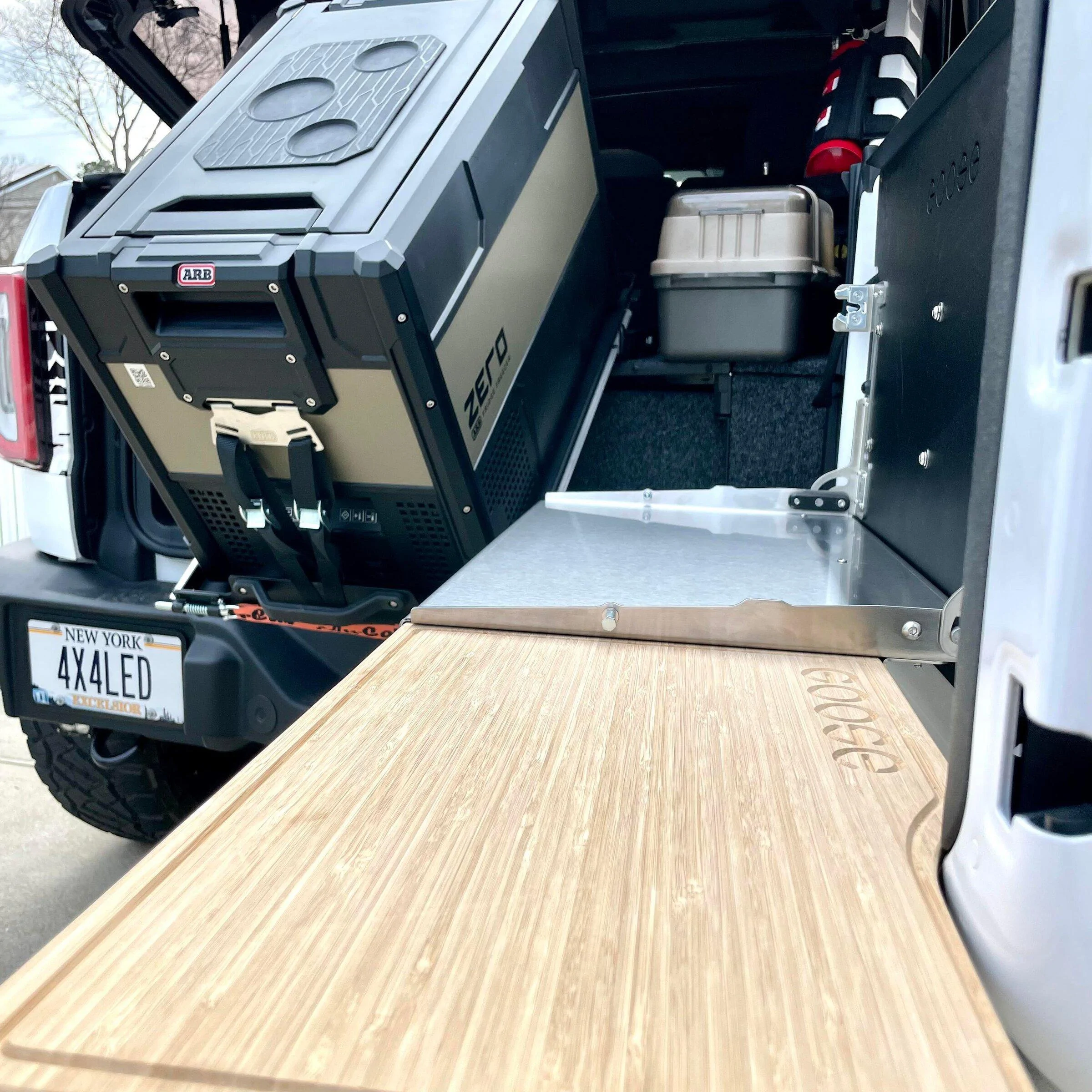

How is that fridge tilting like that?

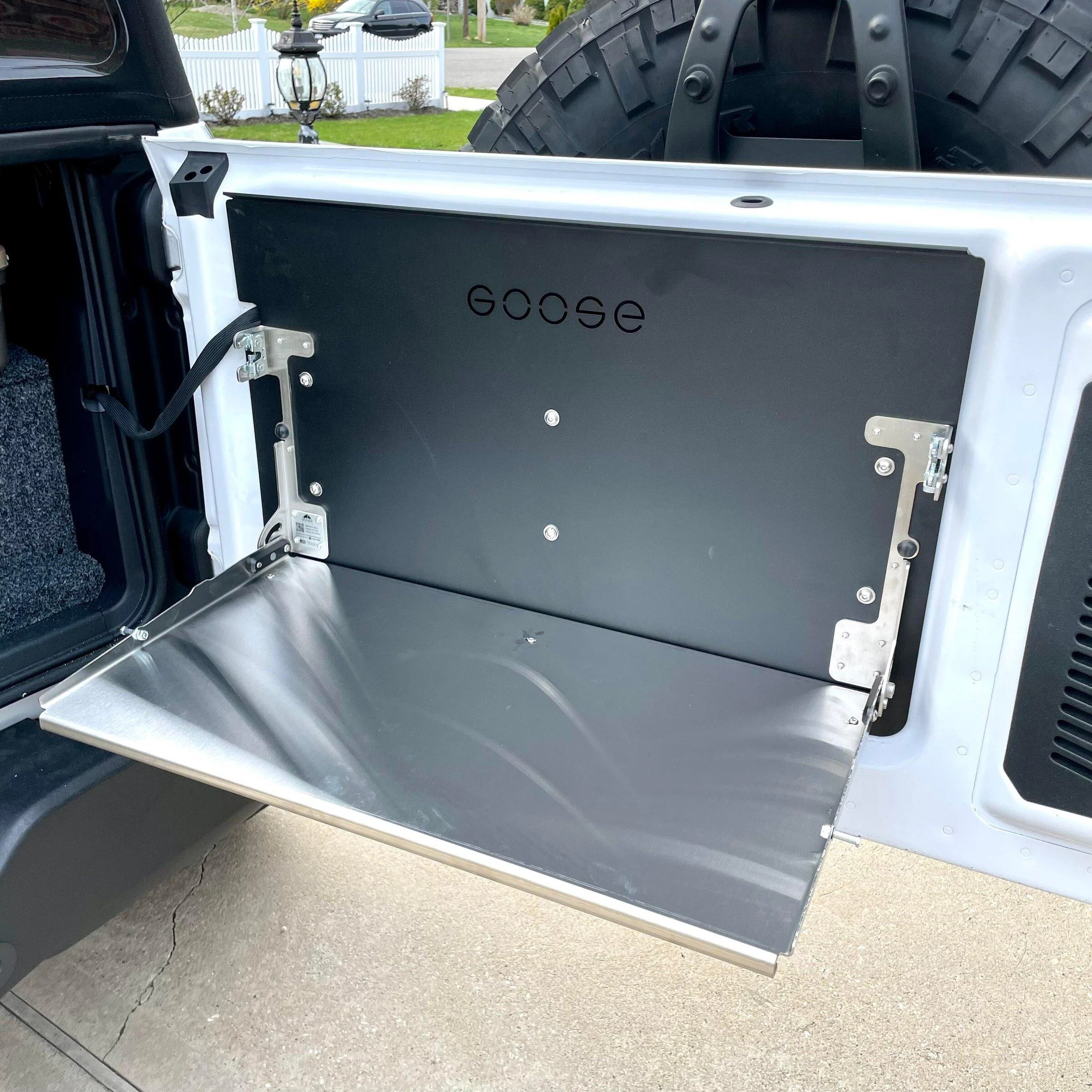

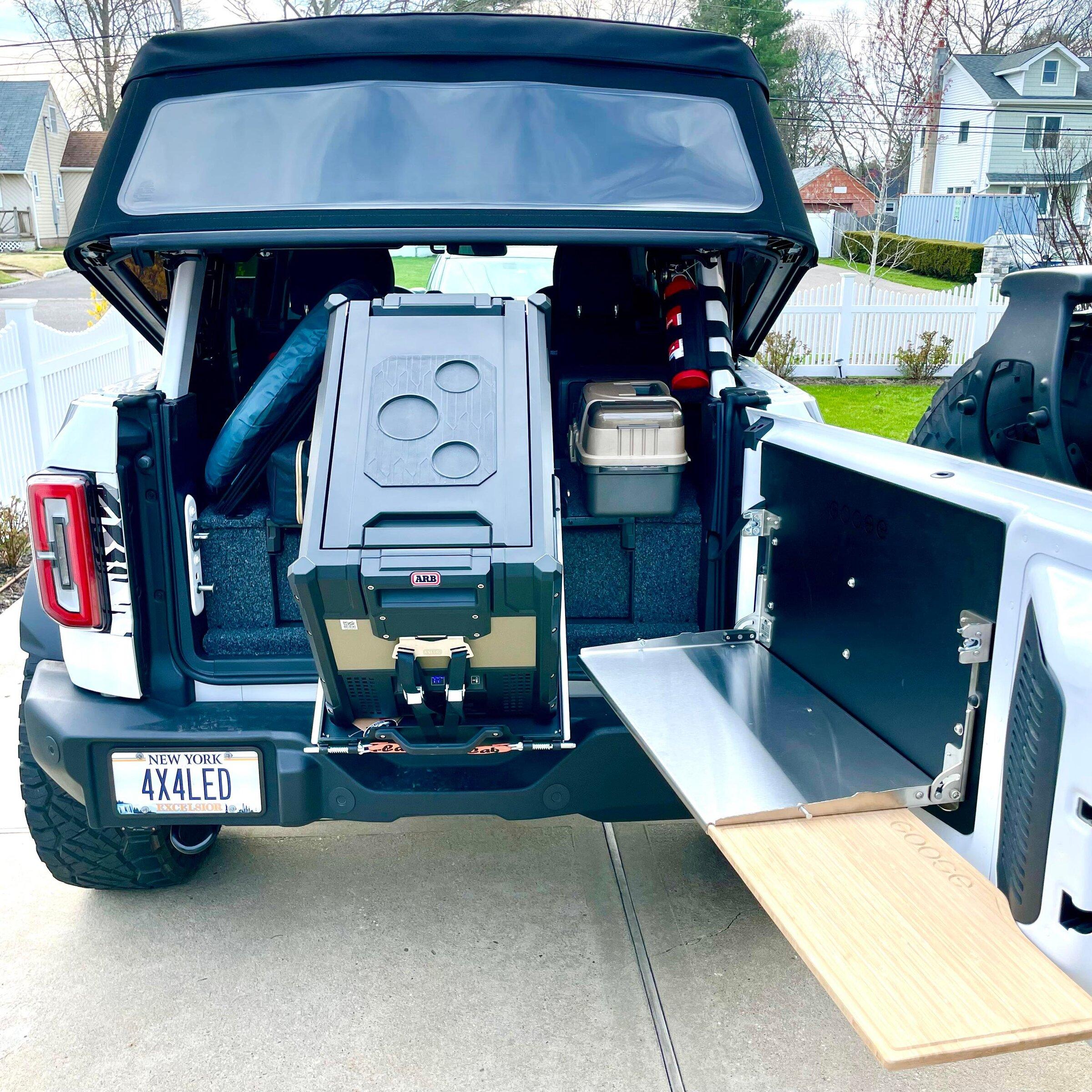

It looks like in the second photo the pull out and tilt down are not square with the mount. Can you confirm. Is it sagging? It's definitely not parallel or level or plum with the black rear plate. I'm really looking into something like this and I have a GG deck. Please advise.
Correct. We all sat there at the shop going "uhhh is that thing crooked or is it me" and sure enough when we measured the top of the black bracket to the mounting point for the shelf. One side was about 4.5" and the other side was a little over 5"
But when it's opened the shelf is level. I THINK they did that for a reason, because the back plate is installed in alignment WITH the bronco swing gate but the swing gate may not be 100% level. So by doing this, when the table folds open, the table is level.
Interesting. Thanks for the reply. Wonder why they didn't compensate on the plate? OCD here. (With some fab experience) Haha.
yeah tell me about it. I was like "uhh I KNOW we measured and its align with the top" then one of the guys actually got a tape measure and measured it.

I like it. As I said above, I DO recommend that you opt for a REAL rivet installation tool. The "Bolt and Socket" method WORKS but it's not the best. We had a few issues. One bolt was SLIGHTLY stripped a bit from using the BOLT they provided, probably because it was a bolt that had clearance issues behind it (the bolt they use is probably a universal one, and they didn't realize how shallow the bronco swing gate is). But when my neighbor used his it was much easier (im going to buy one now for the shop). He also re-tapped the problematic one since the threads were a TAD off from the "bolt tool"
I'd buy one again but again HIGHLY HIGHLY recommend using a proper rivet tool.
