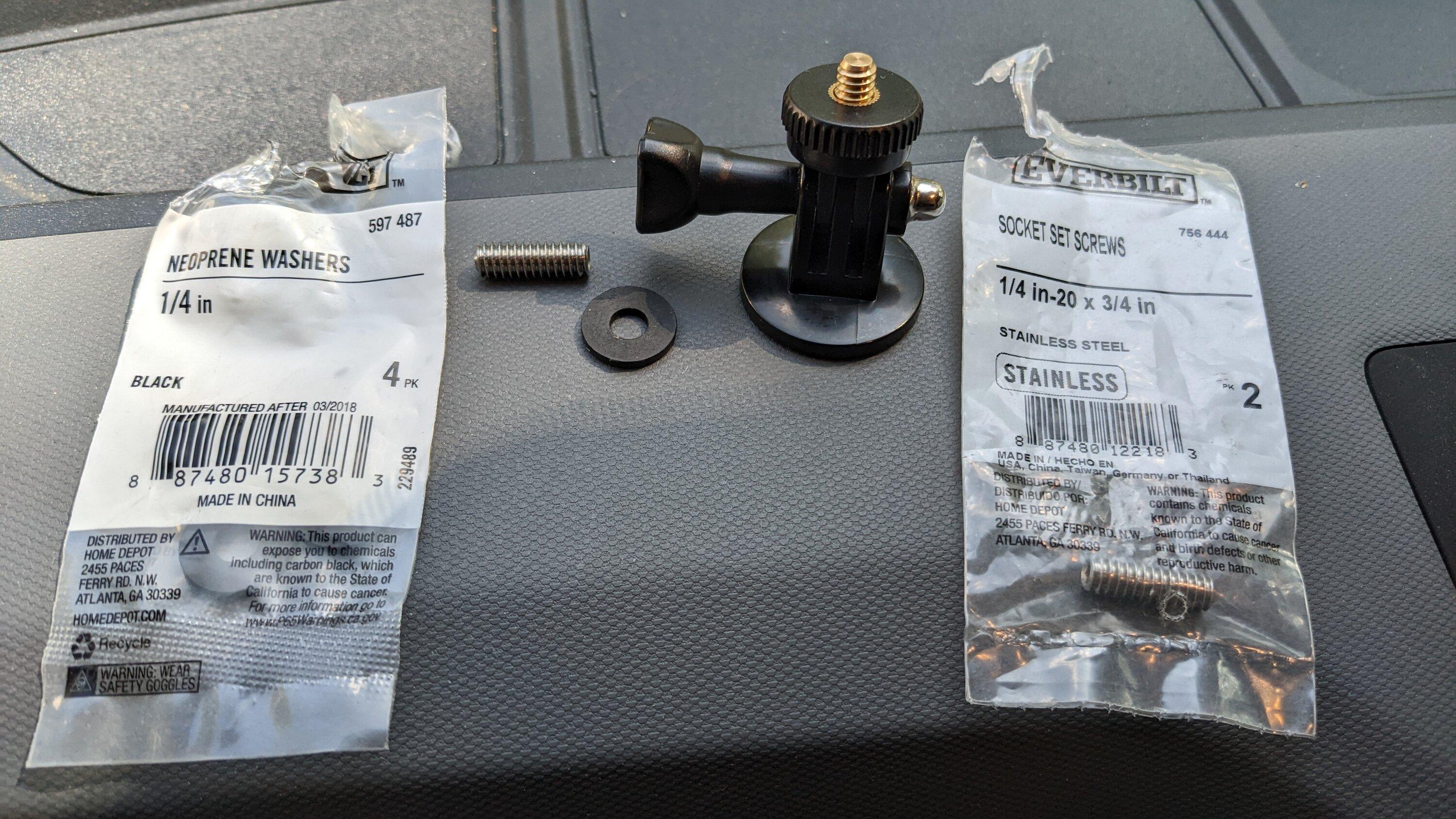

I went to home depot and purchased the following (They were about $2.50 each):
Ford Bronco Gopro mount for direct dash mount? components

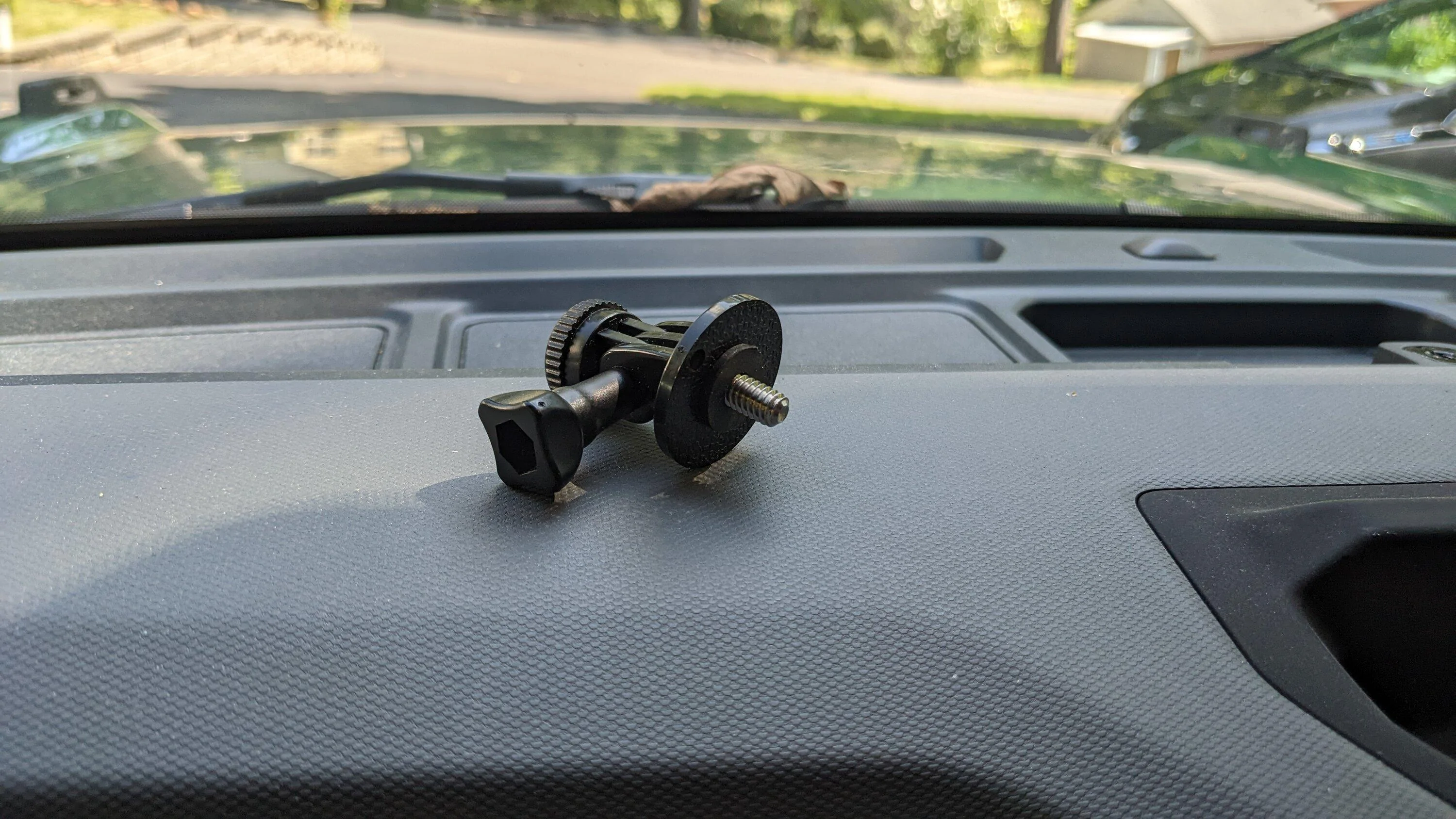

I can confirm the mount in the dash accepts 1/4-20. Also, it is deep beyond the 3/4" length that I got. The neoprene washers came in very handy because initially the mount did not face forward while fully seated. After adding the washer, that issue was resolved.
Ford Bronco Gopro mount for direct dash mount? mount_w_washer

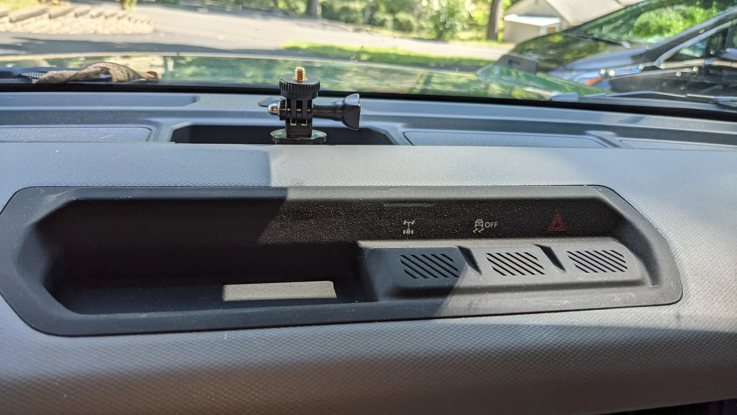

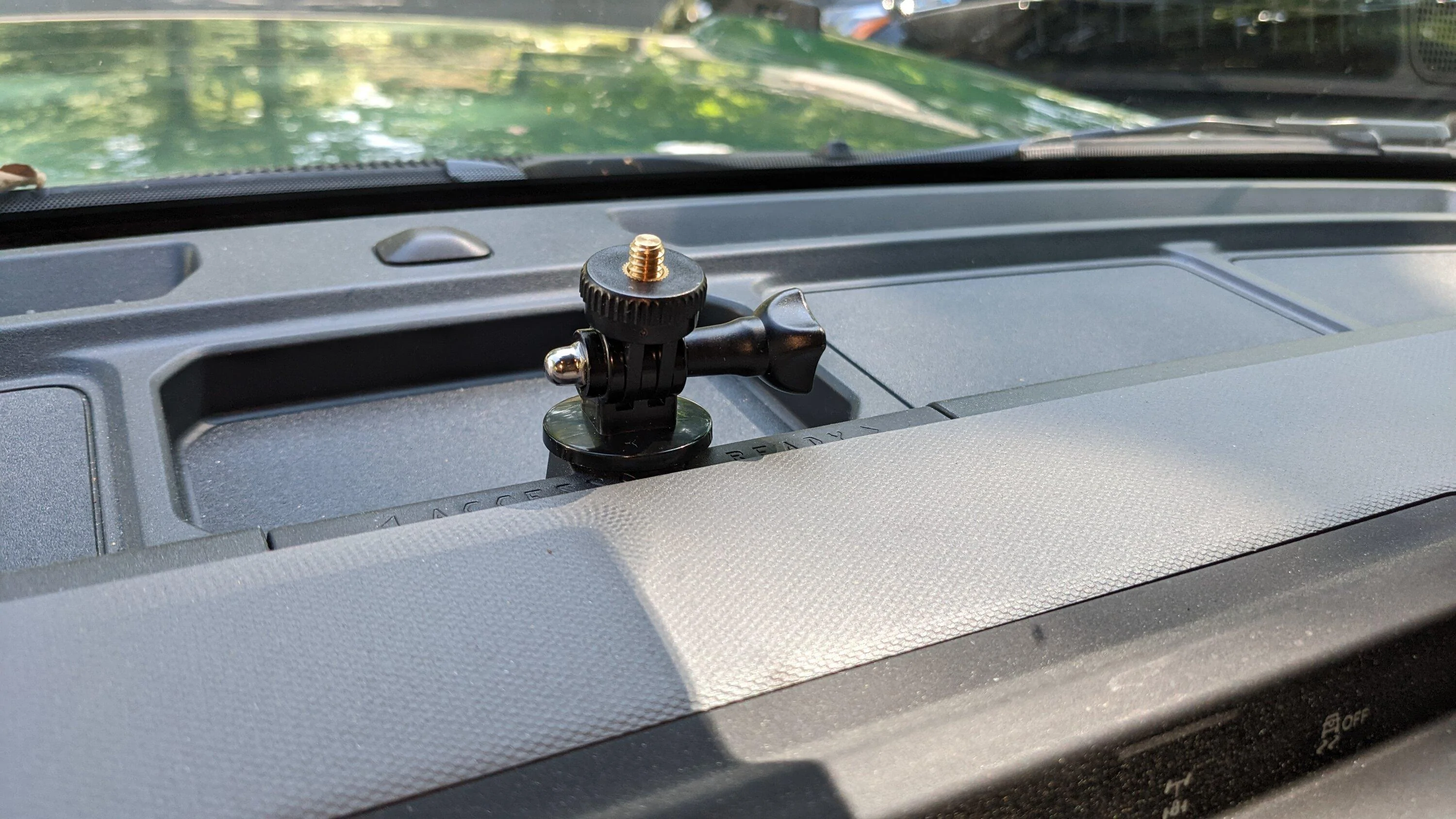

And finally the finished product:
Ford Bronco Gopro mount for direct dash mount? mount_dash_3
Ford Bronco Gopro mount for direct dash mount? mount_dash_2

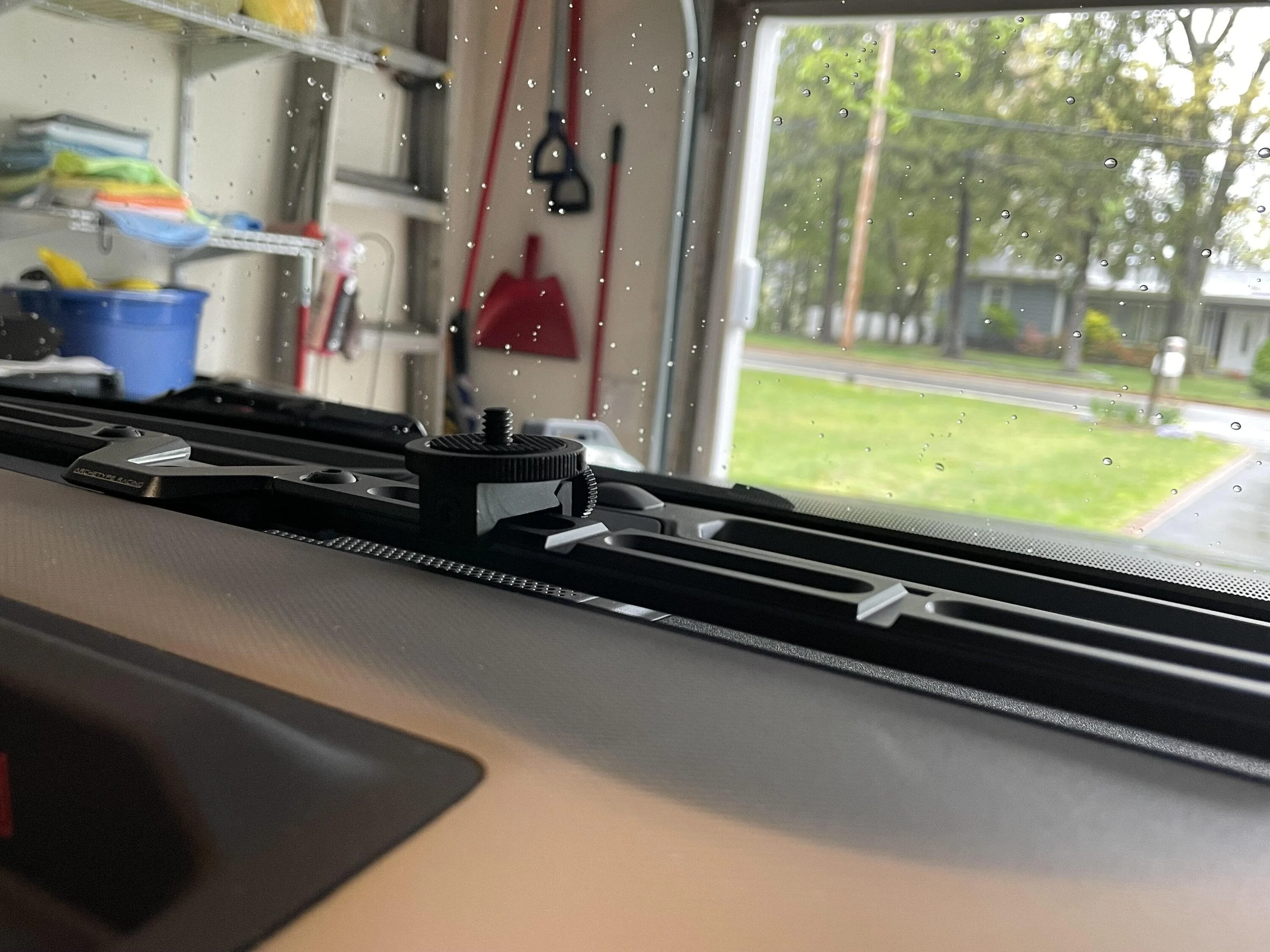

Here's what I used. You could get a 'mini rail' and mount several things or just screw right into the mount point. I like the look of the AR BYOD rail - glad I got it.
Ford Bronco Gopro mount for direct dash mount? BYOD
