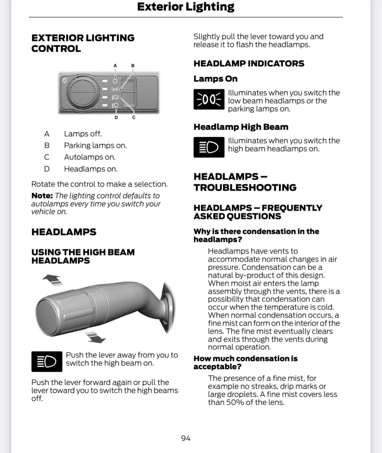

That's a headlights on indicator. So yes, should be on at night.
Edit: Actually, "Exterior Lighting", so parking lights on and/or headlights on will give you this lighted symbol.

Also, the headlight knob doesn't have "hard" positions. You can sit there and spin it clockwise or counter-clockwise all day. Every time you start up the Bronco it will default to the Automatic position.

Yes, that’s what I think may have happened when I came back to see the lights on. My knee or something spun the knob and since it was daytime I didn’t notice the lights stayed on. Fortunately it was only a short time before I got back or a coworker turned it off for me. The salesman didn’t even know about the default until I showed him … appreciate the help … glad you weren’t one of the “read the manual/ do a search “ guys (I did for the last couple days. Saw a couple people had the same issues with their sport…
