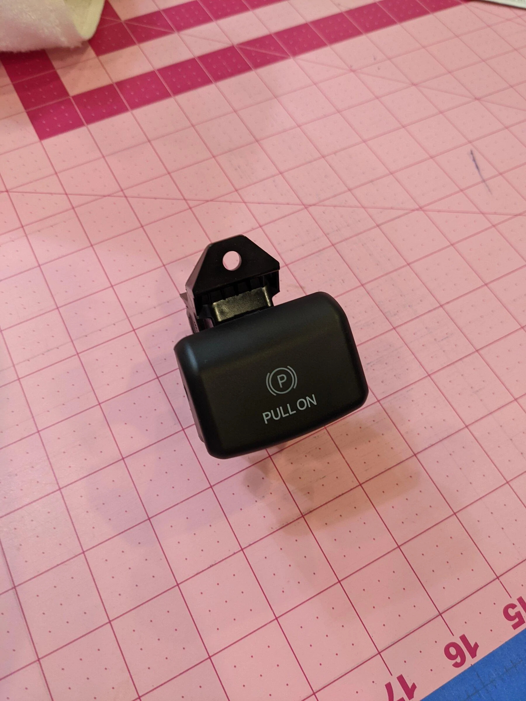

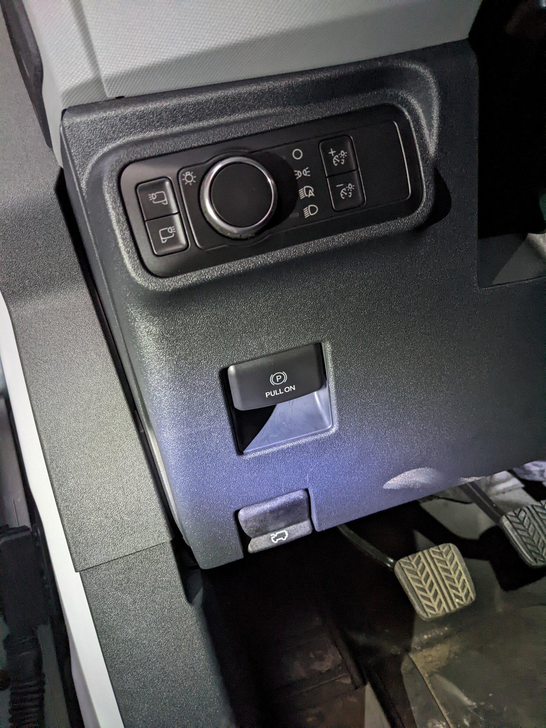

Last Friday, we were involved in an accident. Someone ran into the rear of our Bronco. I was a little frustrated (to say the least) and I pulled the parking brake handle right out of the dash. I ordered a new one ($58.64) Monday and the part came in today. I put the new one in this evening.

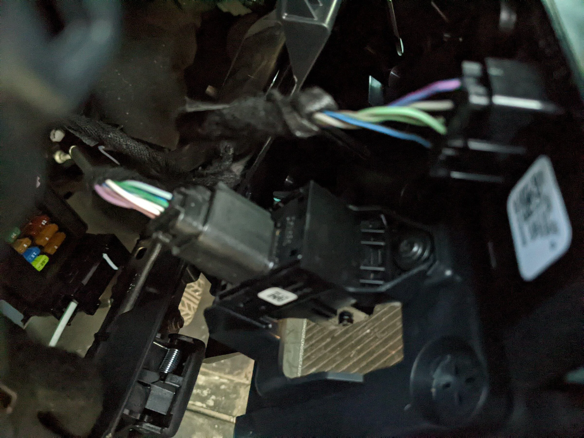

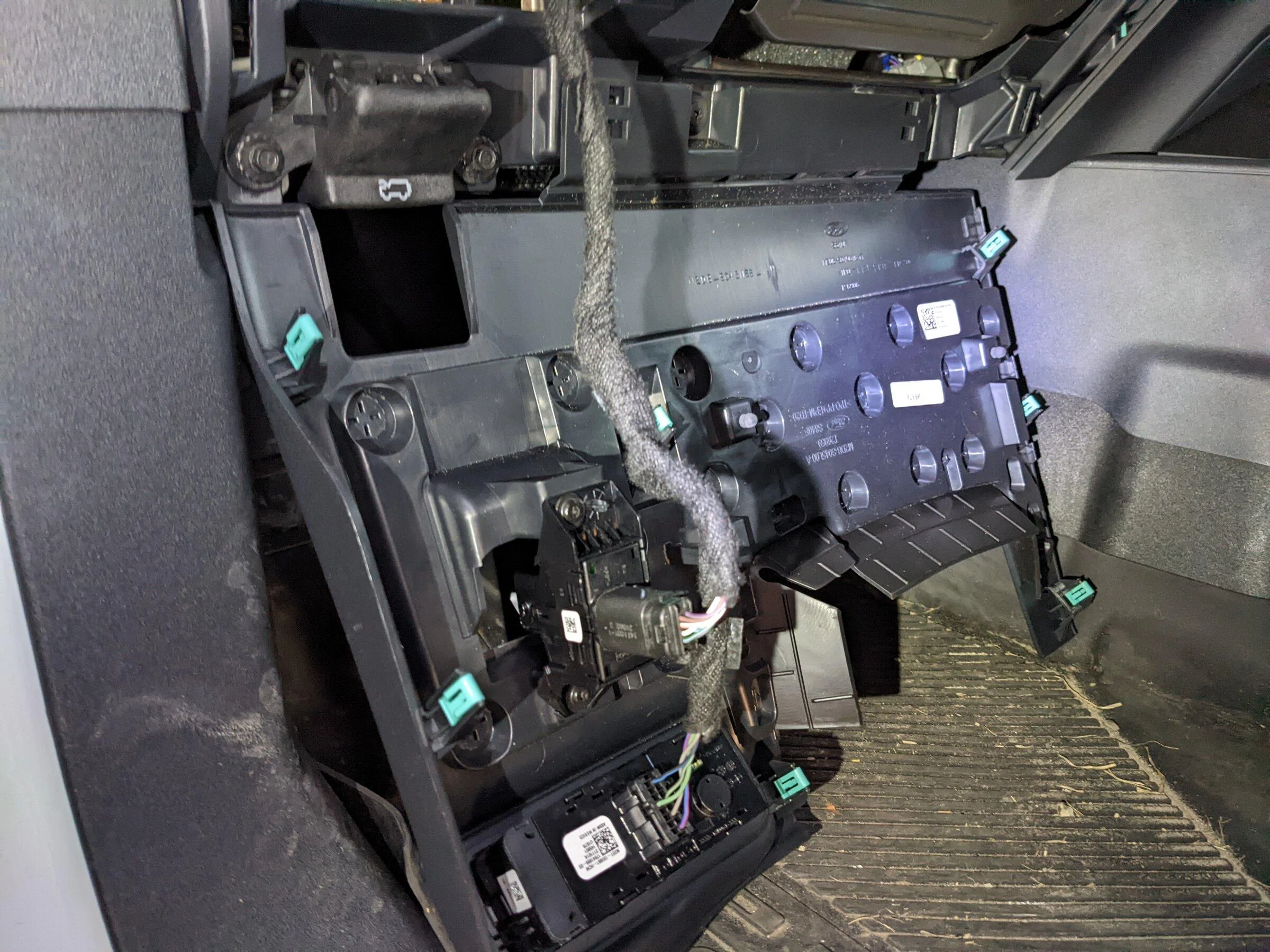

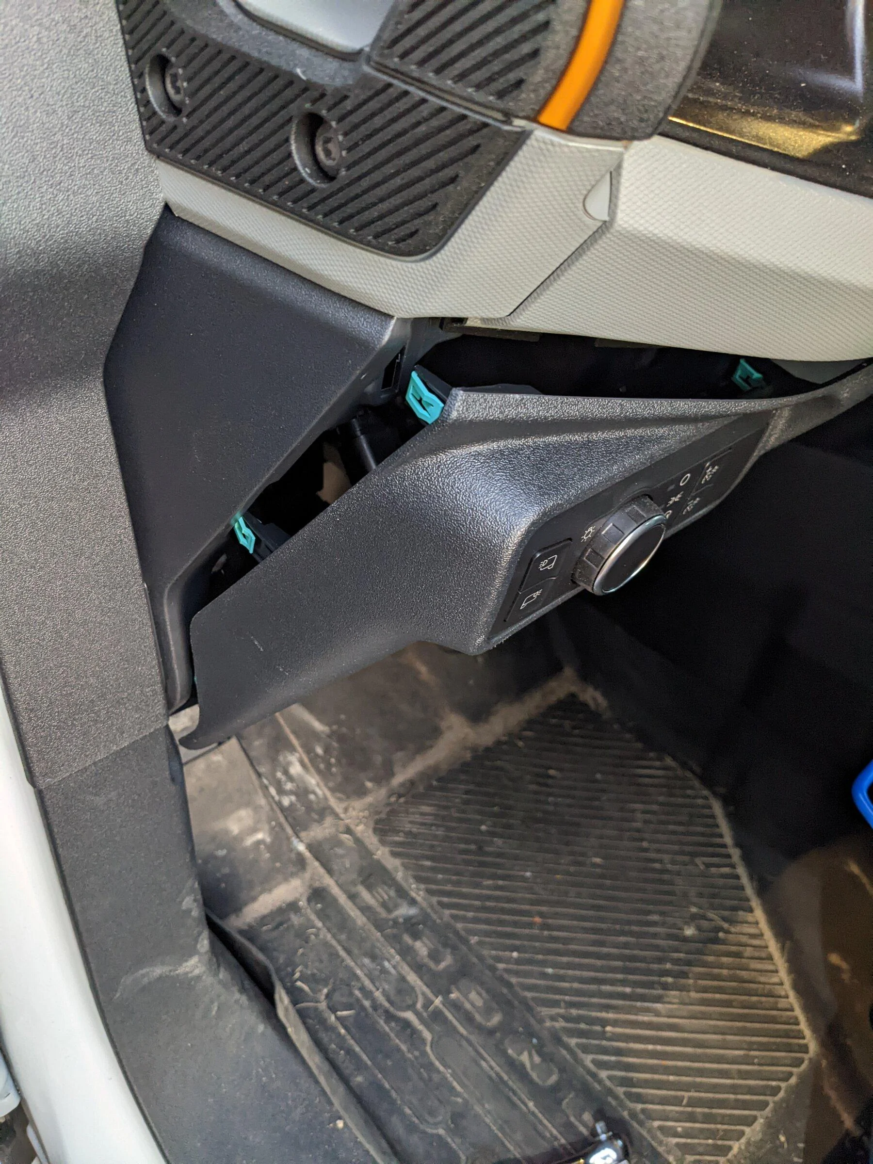

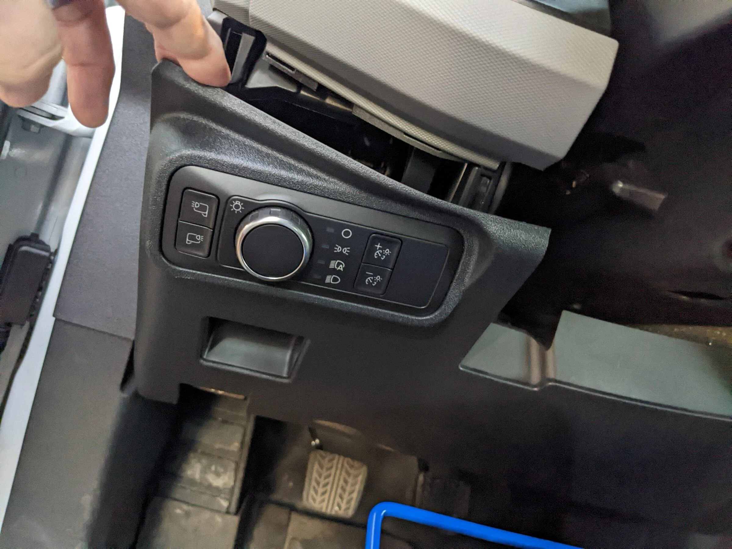

To the right of the light controls close to the steering column looked like a good place to pull gently to see how hard it was going to be to get the panel off. It popped out easily. Reached over to the other side of the steering column and pulled and the whole panel released and is hinged.
Ford Bronco Electronic Parking Brake Handle/Light Control Module Replacement PXL_20220210_000652973.MP
Ford Bronco Electronic Parking Brake Handle/Light Control Module Replacement PXL_20220210_001017840

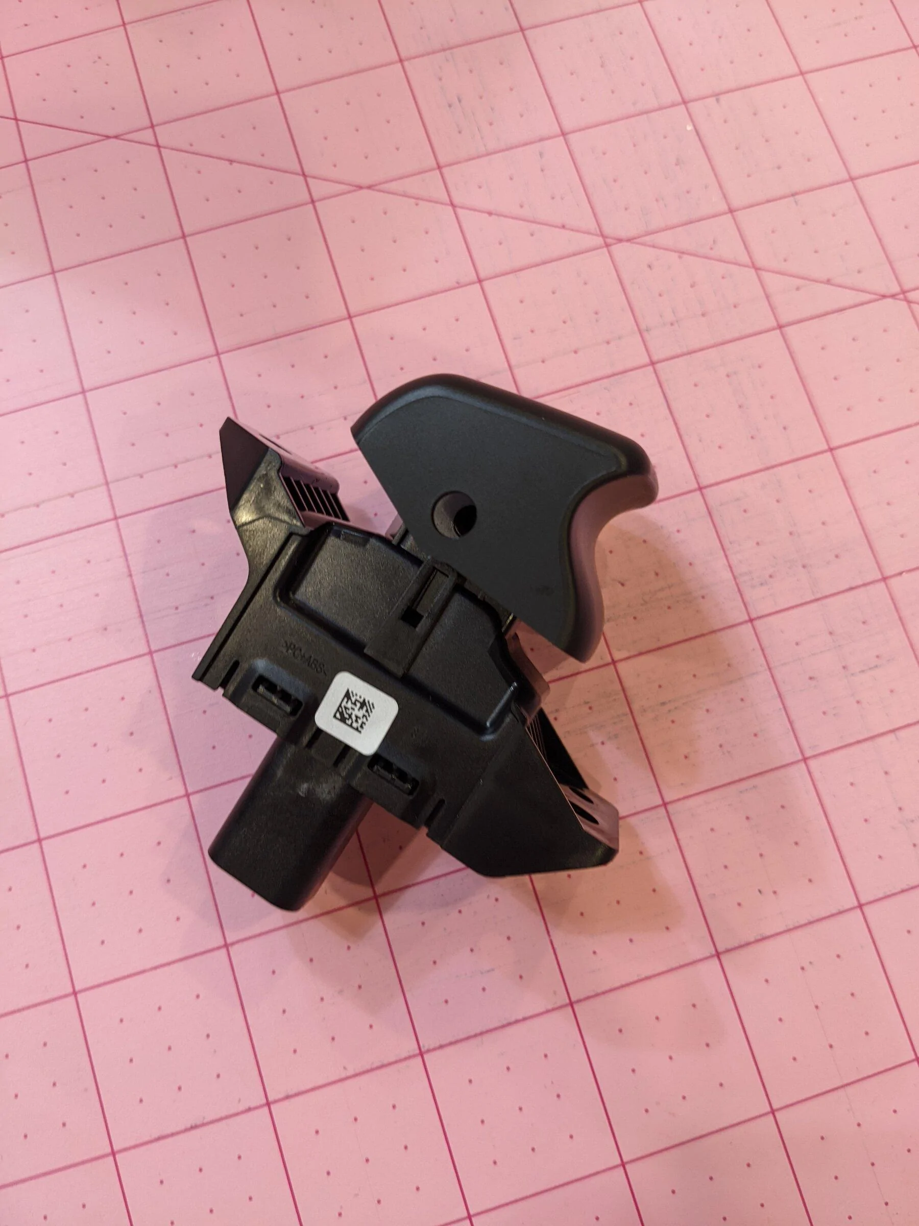

Once the panel is down, there are 2 Torx plus screws-TP15 holding in the handle. Unplug it remove the screws and replace. For those of you wanting to put in the Light control module that has the fog light button in it, it will be just as easy. Looks like it just pops out, two tabs on either side. Took me about 20 minutes, which included getting the tools. Closed the panel, pulled the handle and the parking brake engaged!
