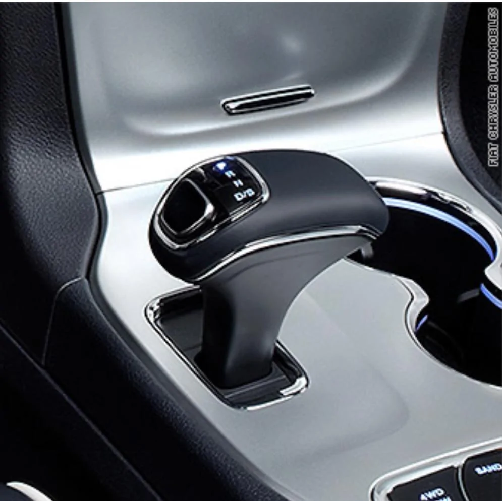

This is the problem shifter on the grand Cherokee , it was a return to center style shifter had to hold it forward until the transmission went into park. The fix was the transmission automatically goes into park if the driver door is opened. They have gone back to the standard shifter and they have a manual foot operated parking brake. Push once to set, push again to release.
