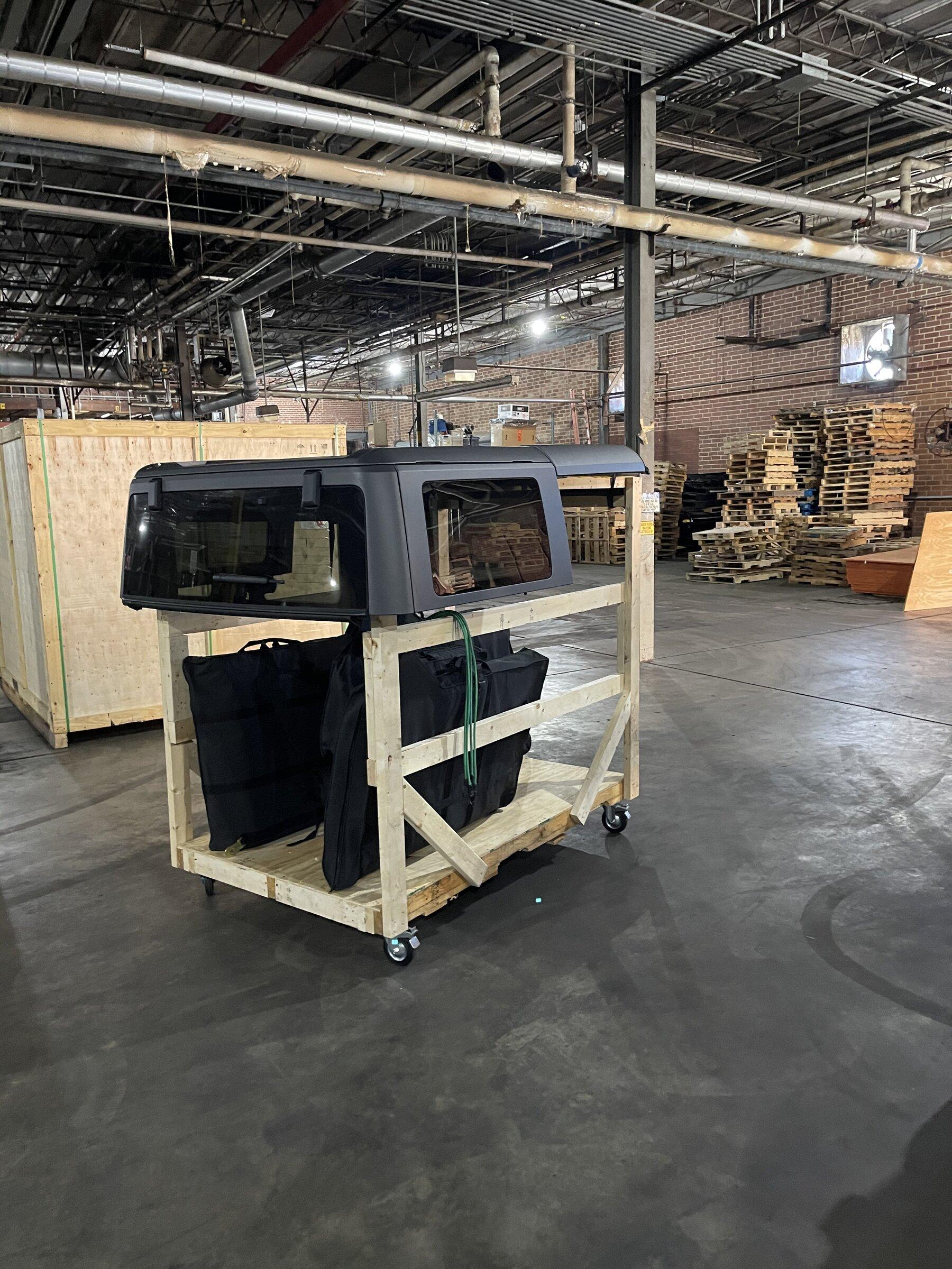

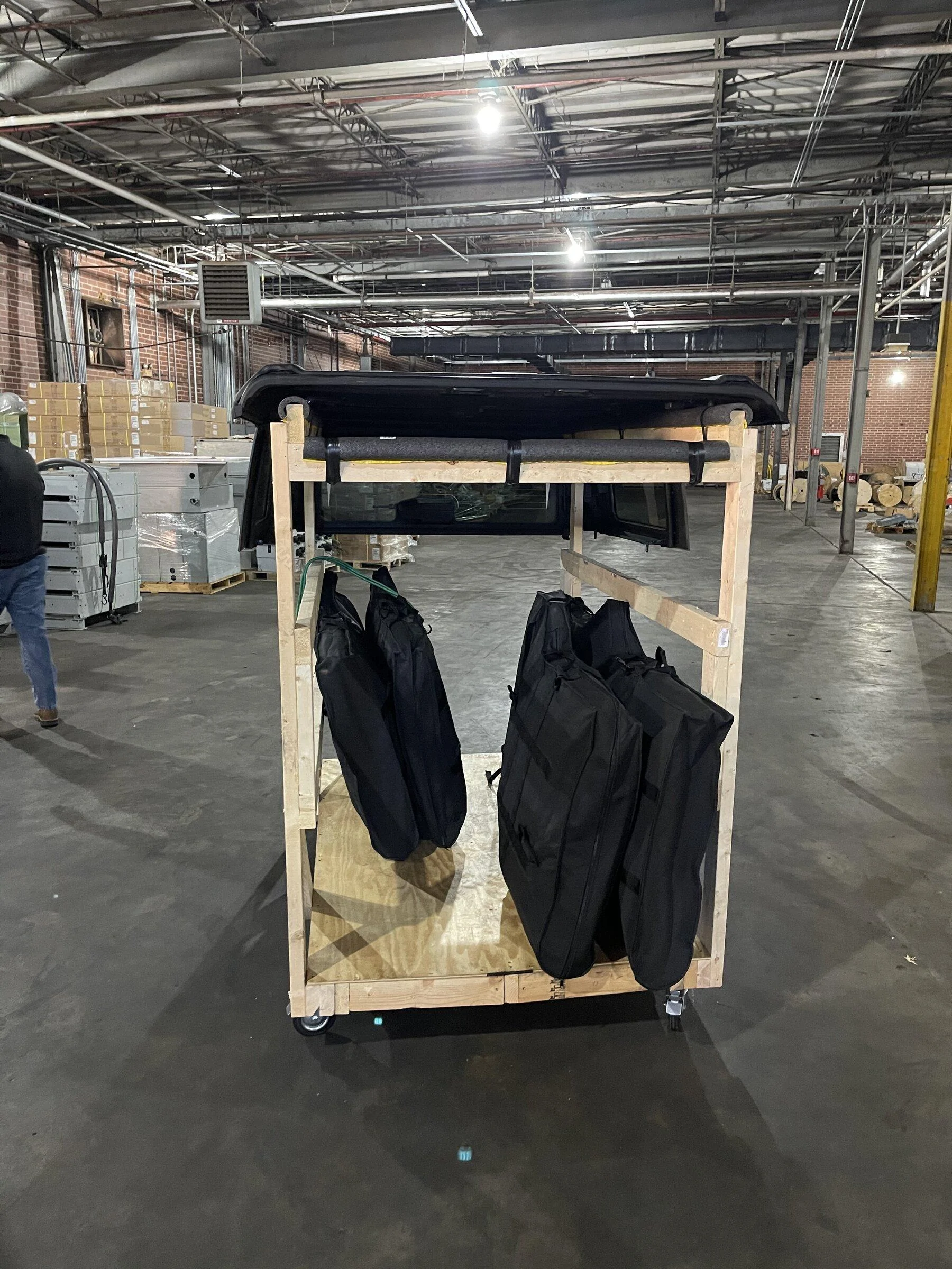

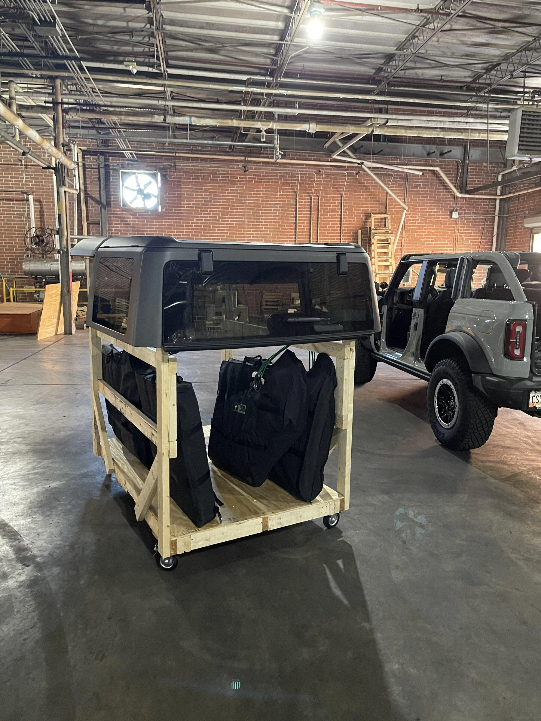

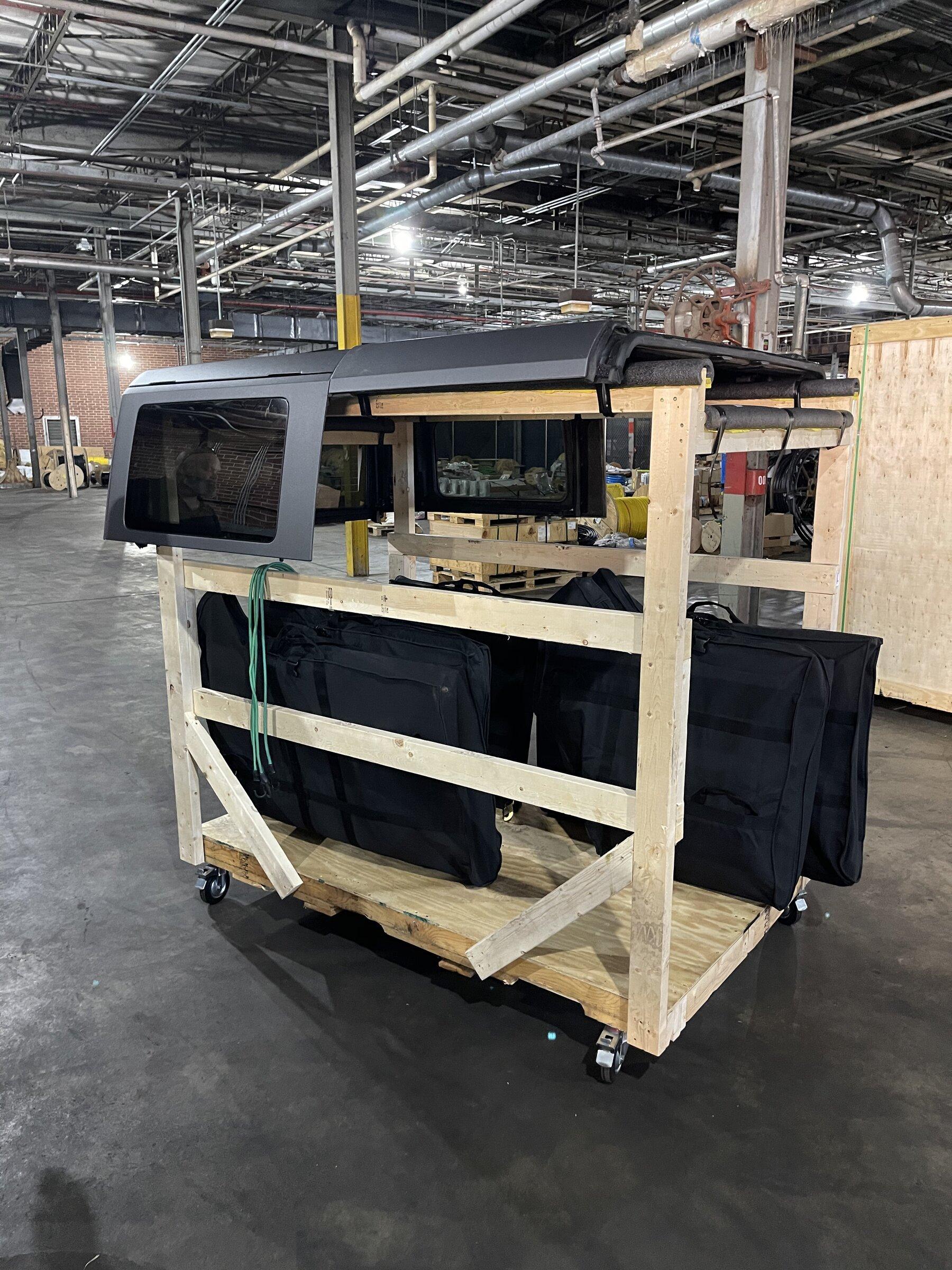

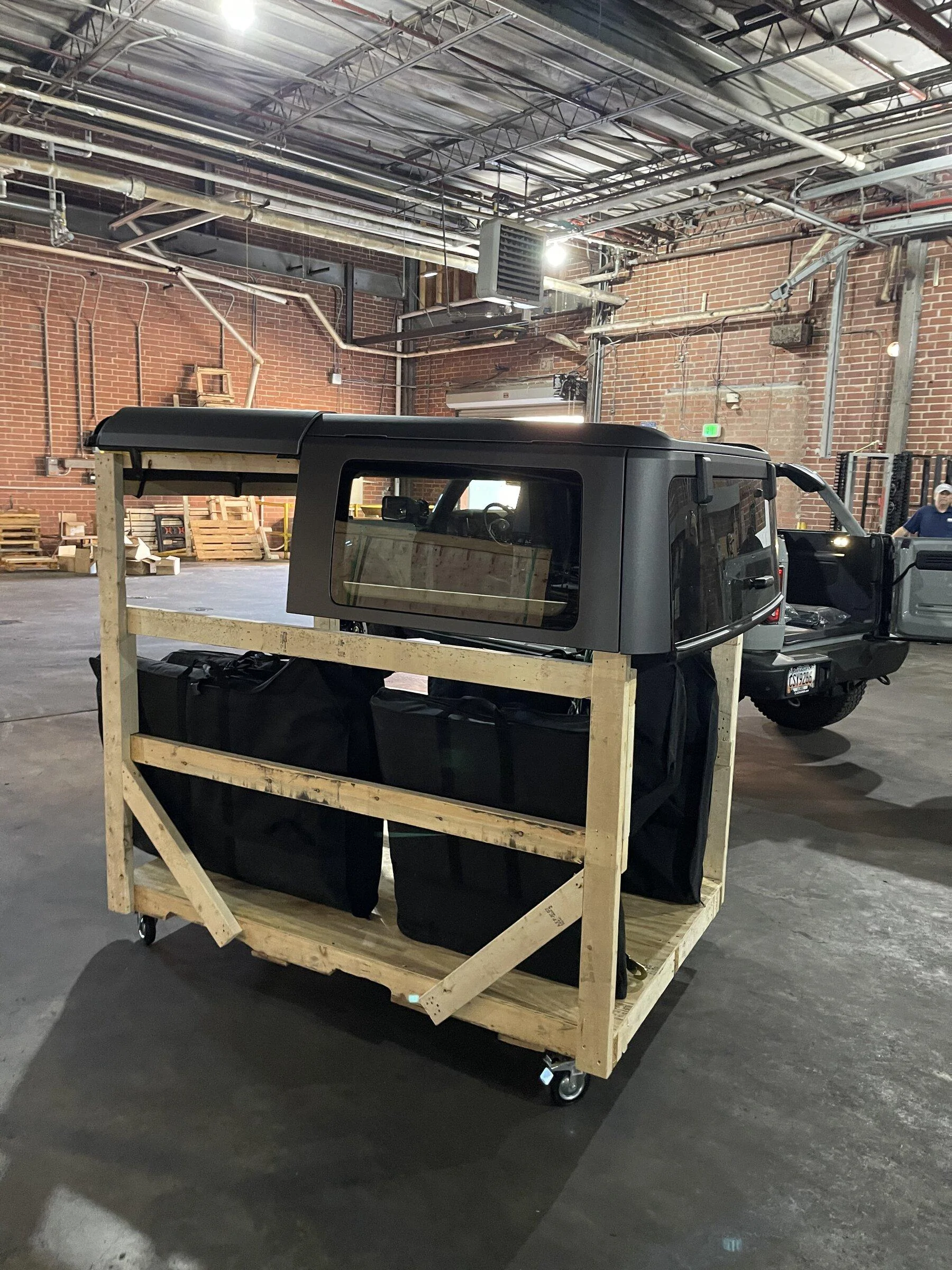

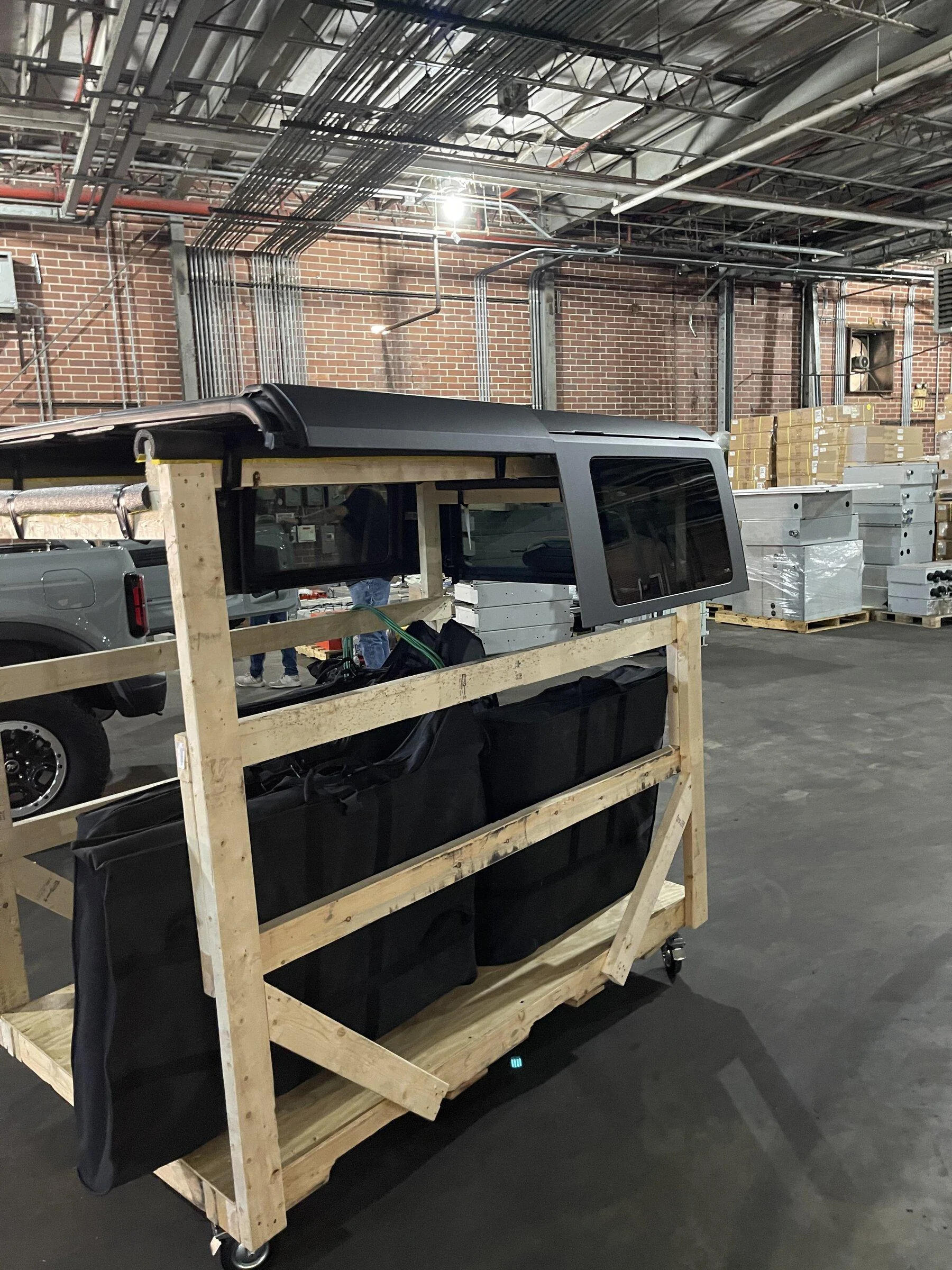

Here are some photos of a storage dolly I built to store the top, doors and panels on while not on the Bronco. Used wood harvested from pallets. works great! Uses 1" Pipe insulation across the top rails to protect the interior if the top. Casters on the bottom for easy moving. Saw a similar idea on the forum, so I thought I would had my contraption. :) Used a 10x12 tarp and bungees to cover and protect it. I plan to move it home soon.
