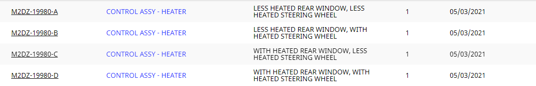

Any insight on whether the rear defrost in the climate control head is any different than the unit with the button for the heated side mirror?

Here's the list of heads for auto climate control but there is a difference for pre and post prep. I don't know what is different internally but the head likely just signals the BCM to turn the defrost on and either controls it by timer or some sort of load sensing. I don't know if anyone has tried to fit the later one and program their pre prep BCM (or if it's even has that function built in) with Forscan to make it work.
