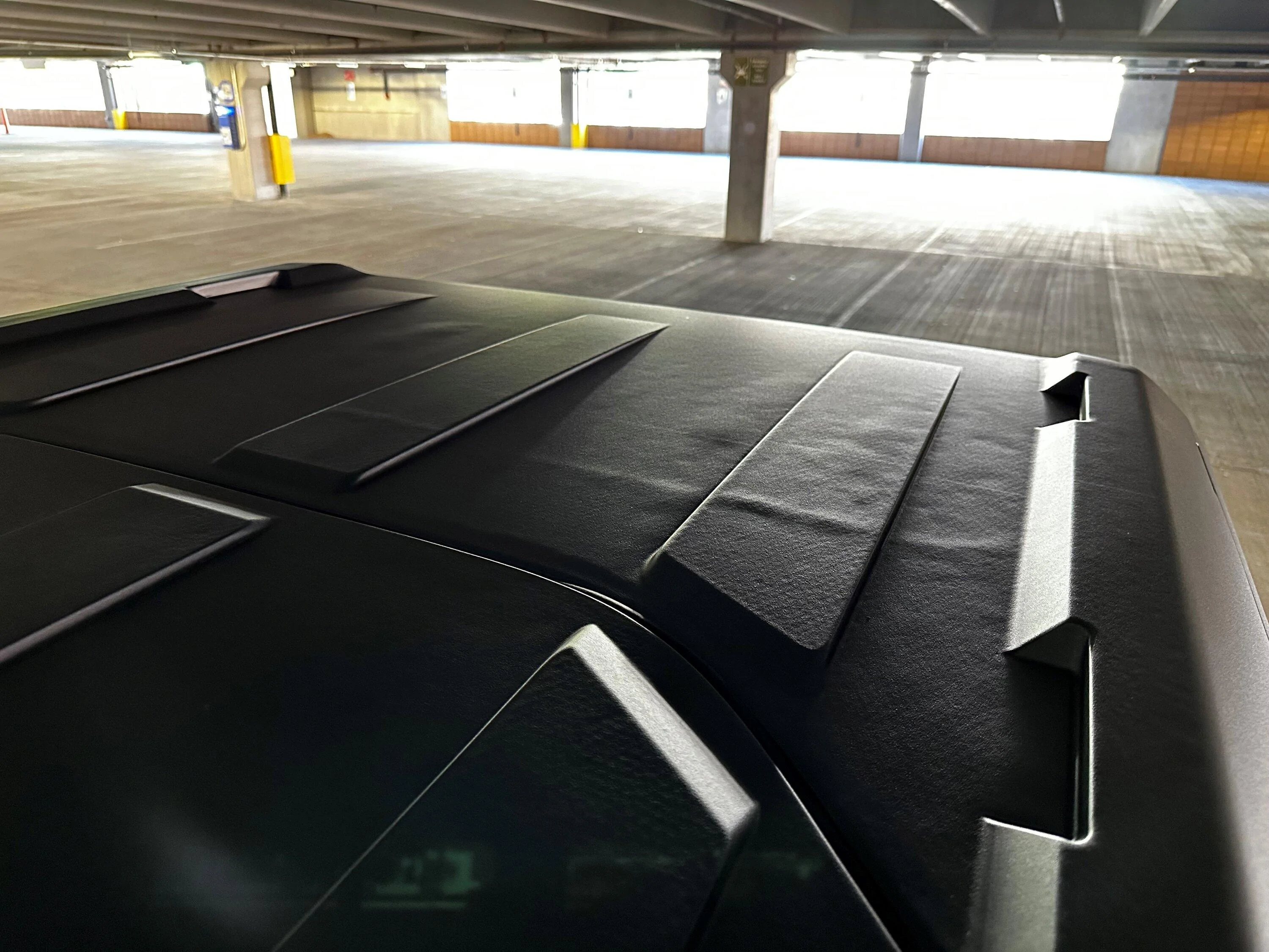

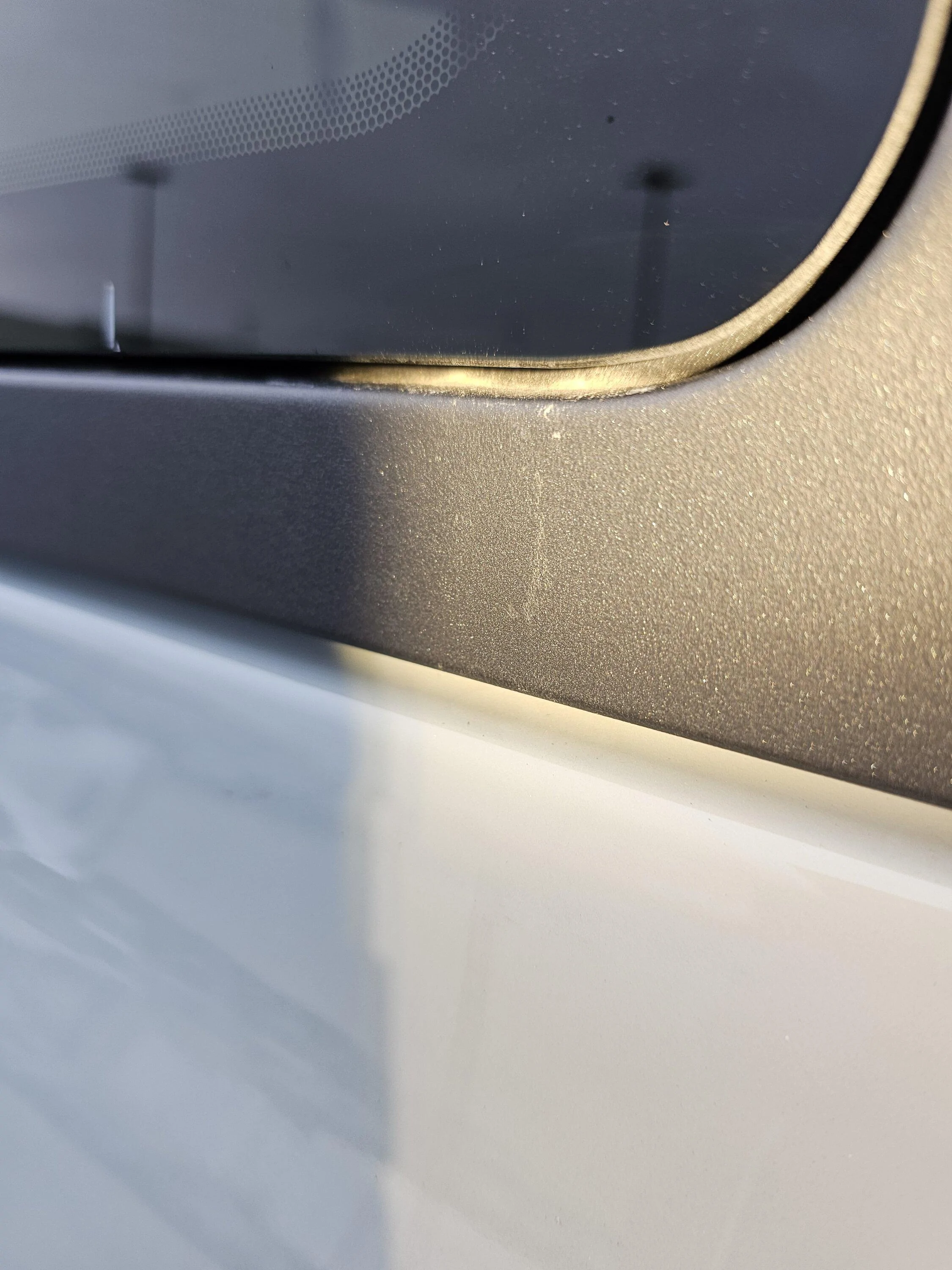

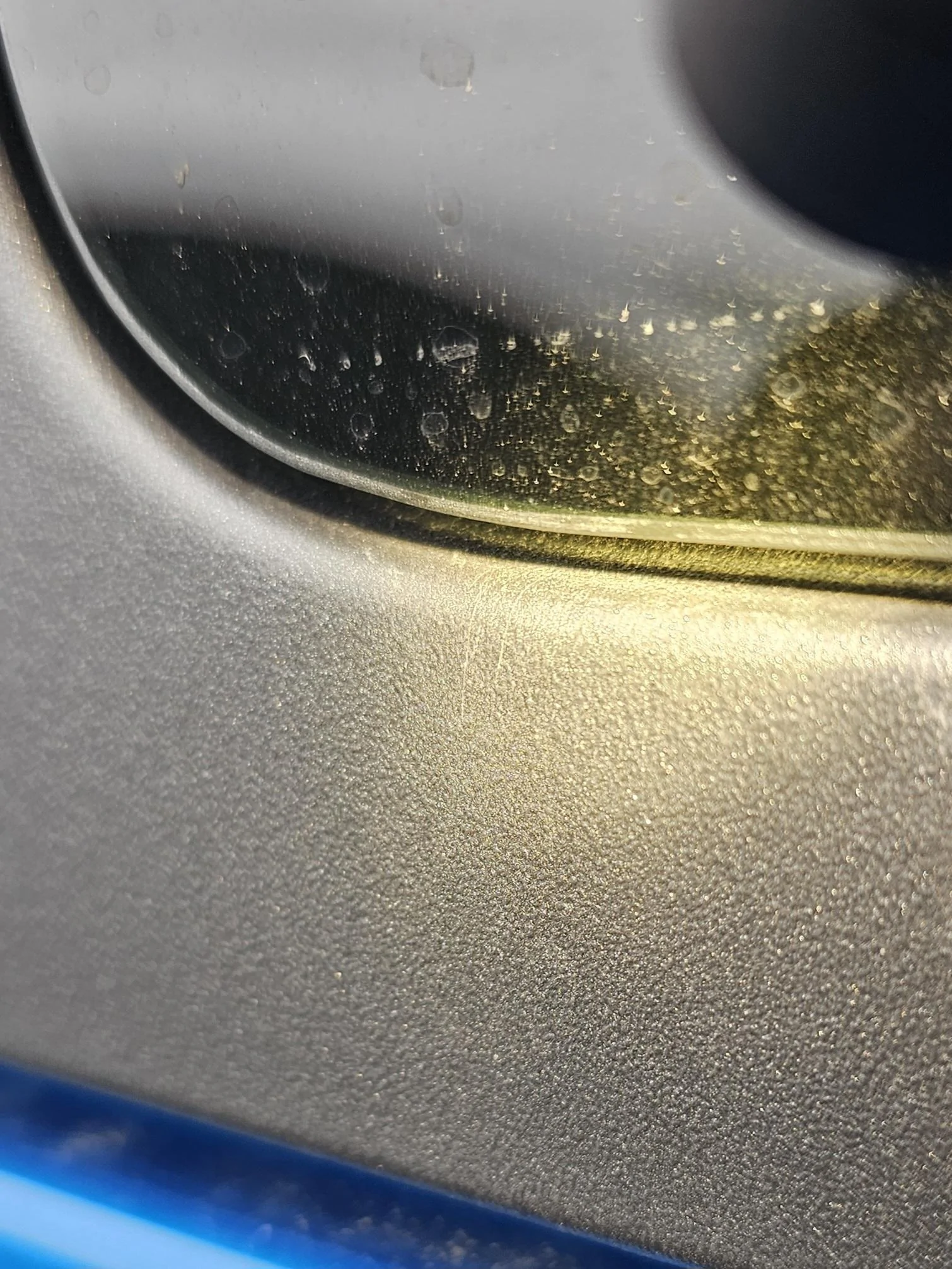

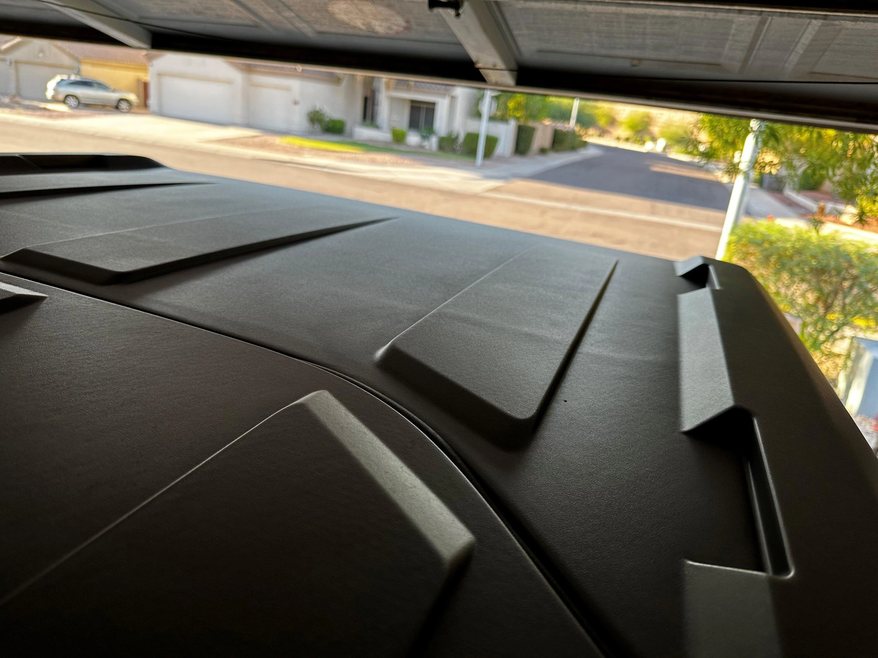

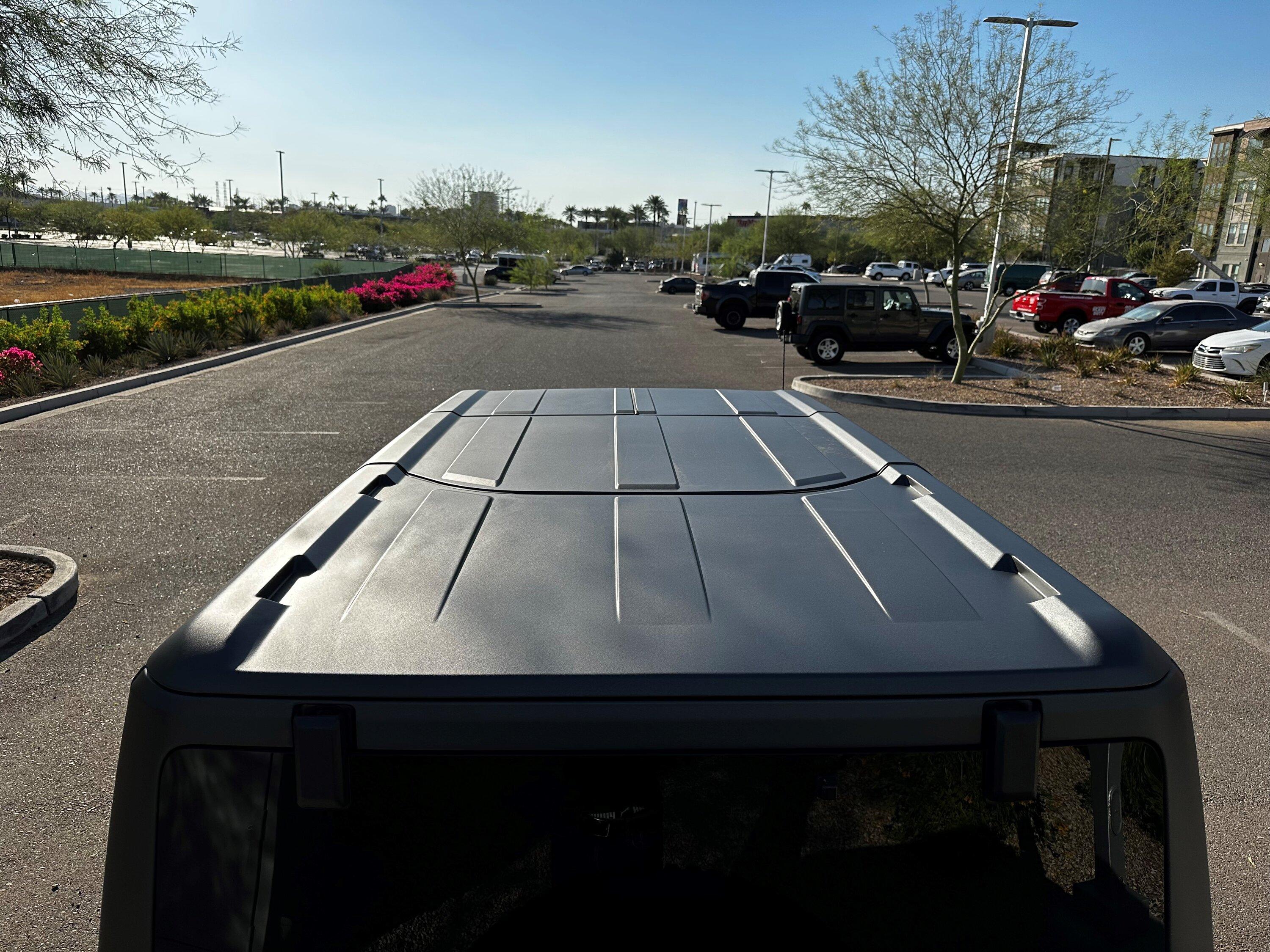

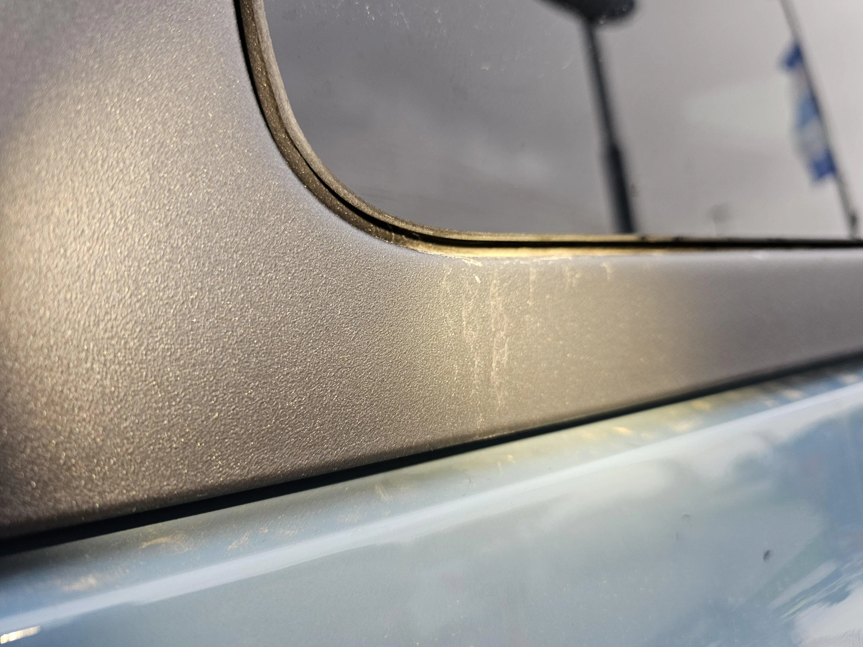

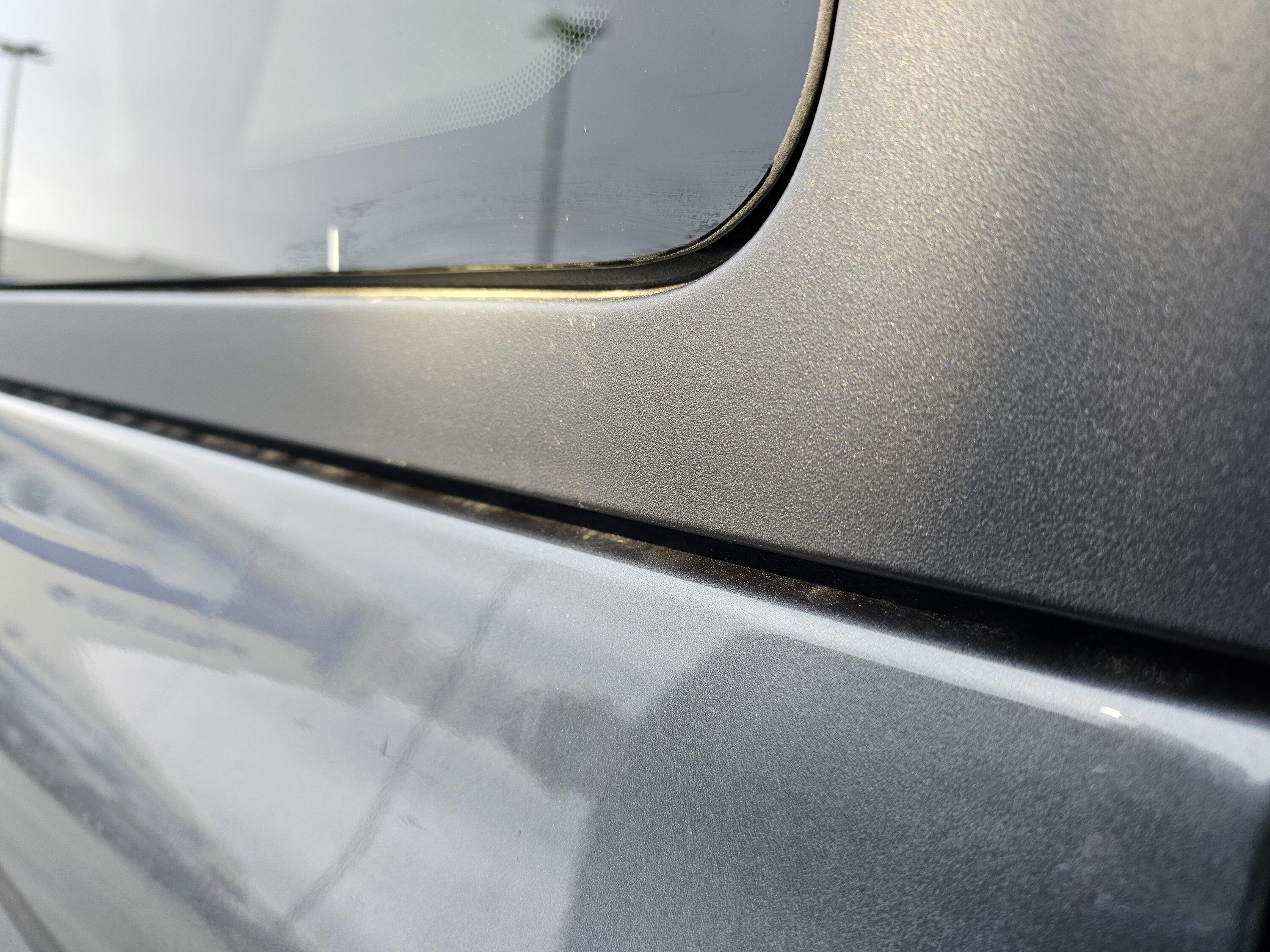

Lighting and angle is key. Here is my hard top in different lighting and angles. And this is just to show the delaminating. Not cracks.

Got a picture of the hail/dent/divots?
And can you get a picture of the area under the window toward the front, parallel to the inner bolt, shining an led light, multiple angles? Not trying to add fuel to the fire, but it took me awhile to get the right angle and it was only becuse one day the sun was hitting it as it came through the garage door and I was working at the bench.
I can take a picture of mine and it will look totally normal. I can even walk by it in full sunlight and not see anything at all.
It "looks like" it's been caught in a hail storm but it never did. I've attached the photo in the previous post.

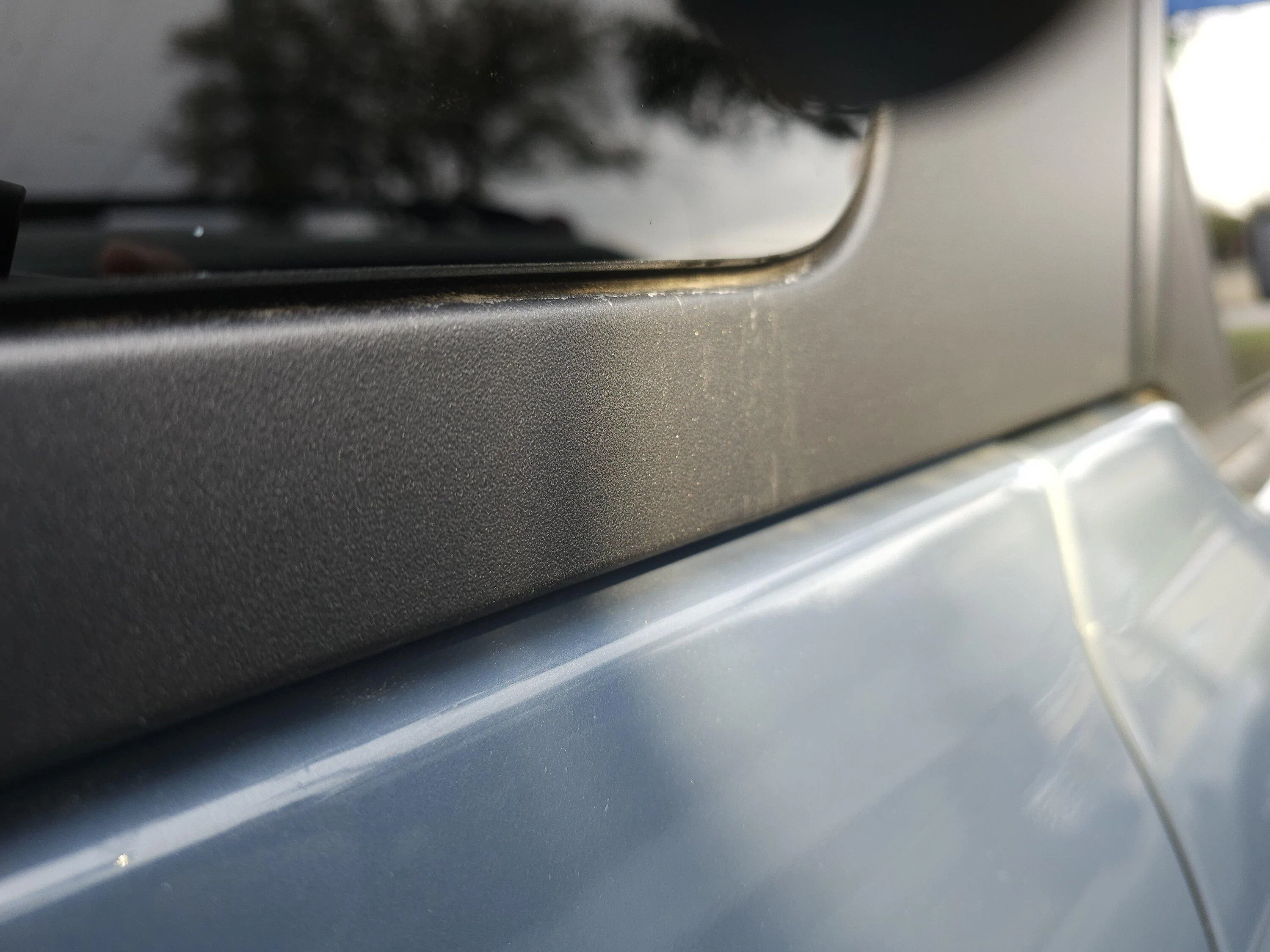

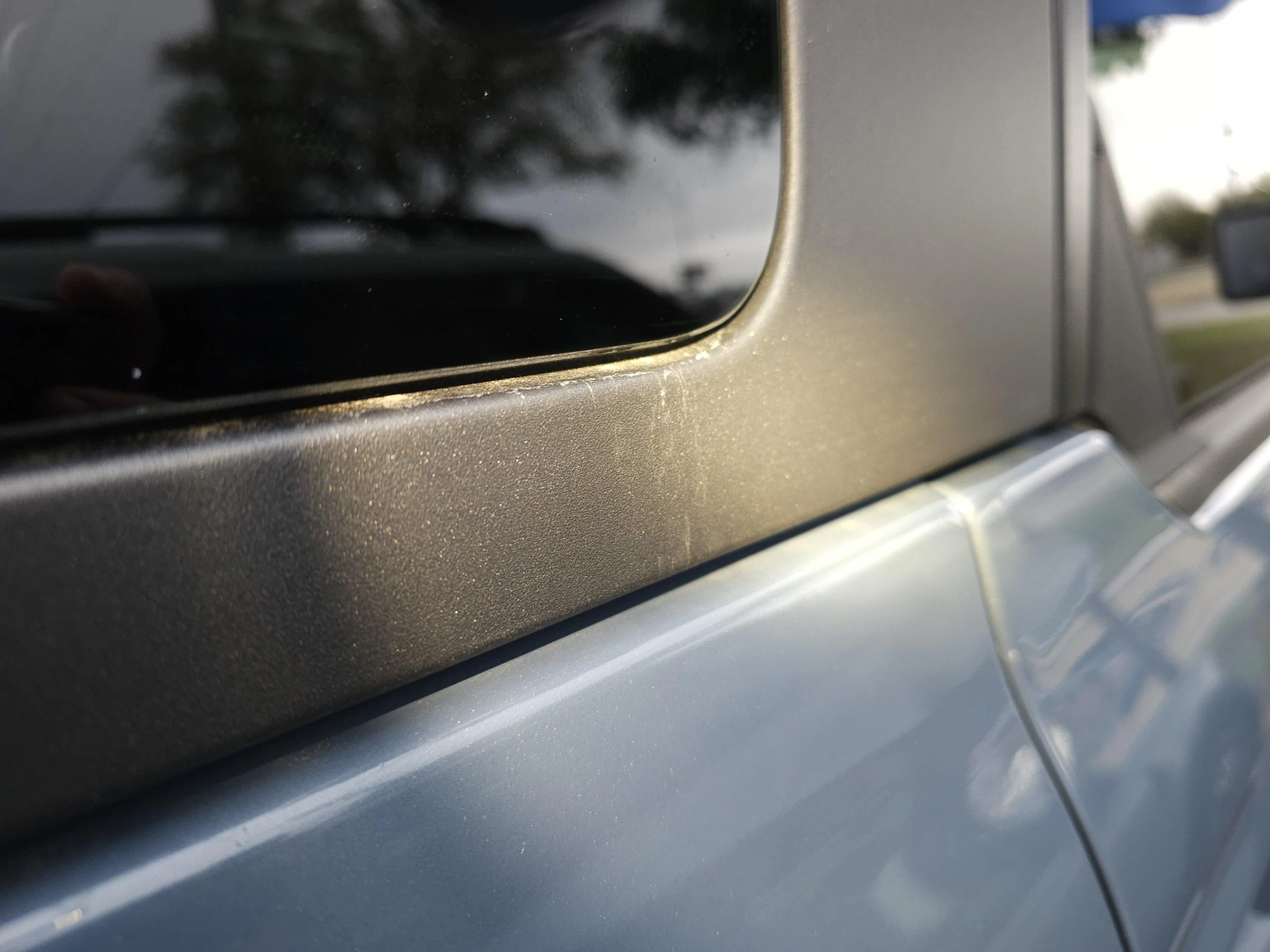

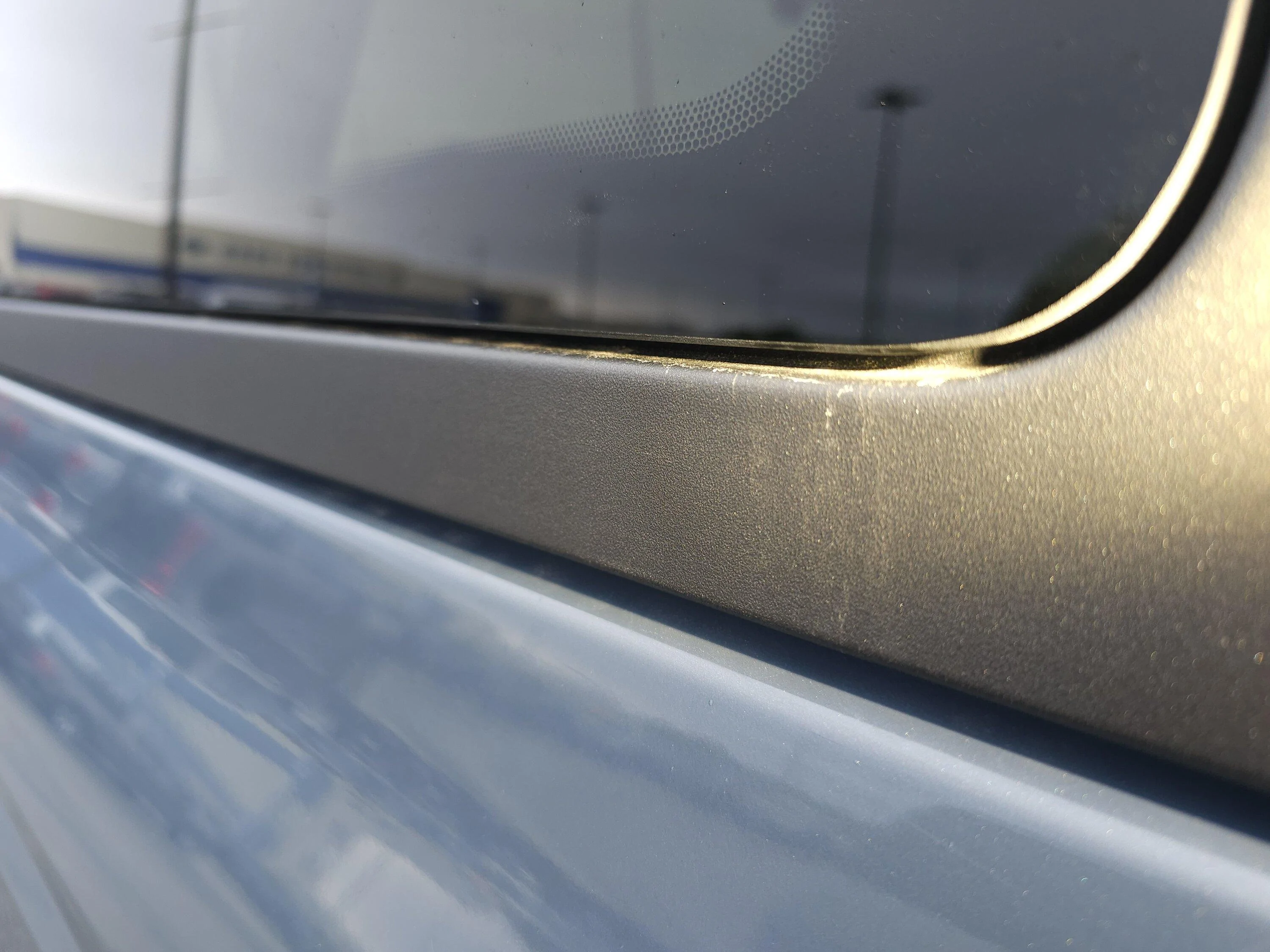

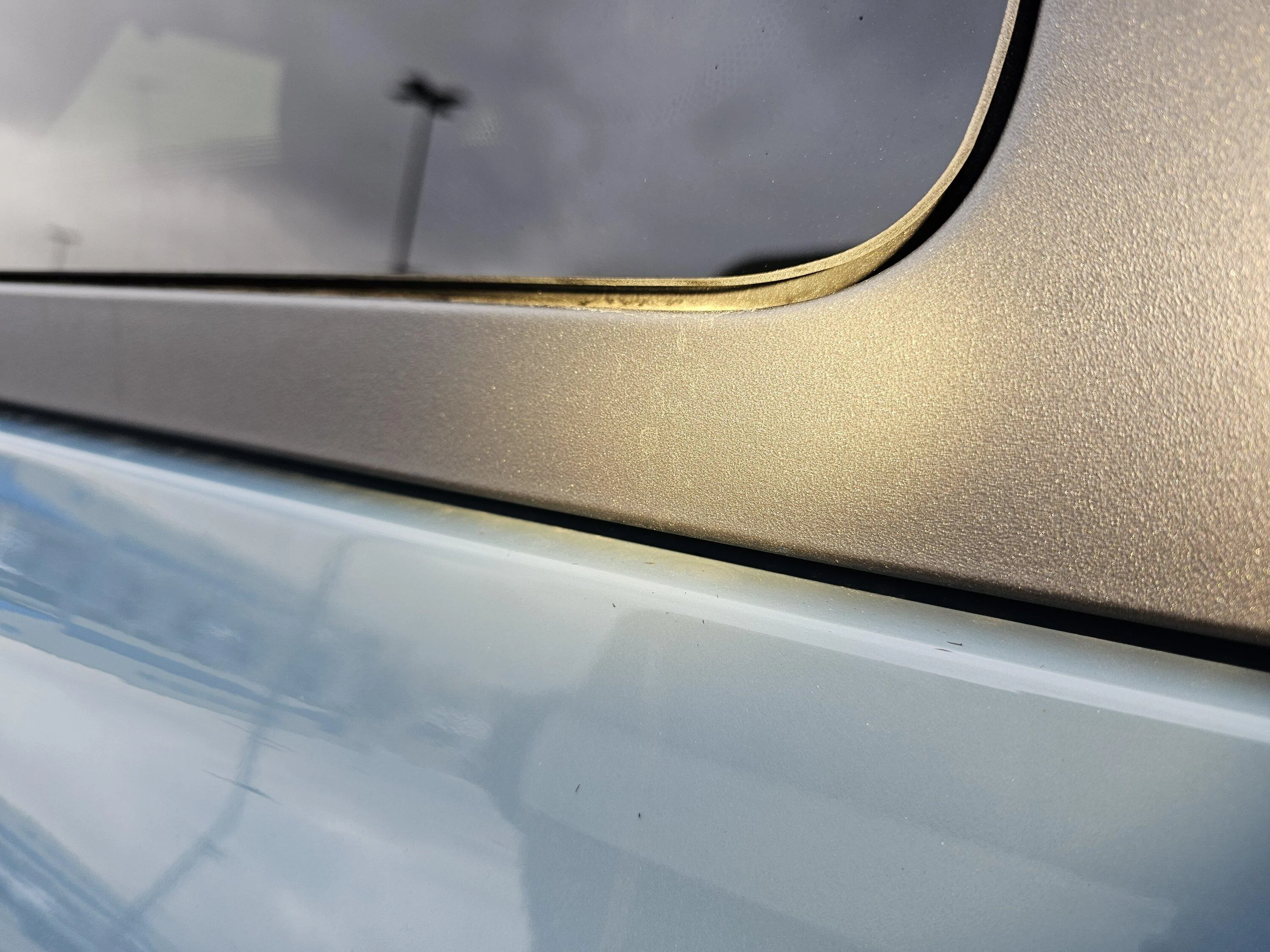

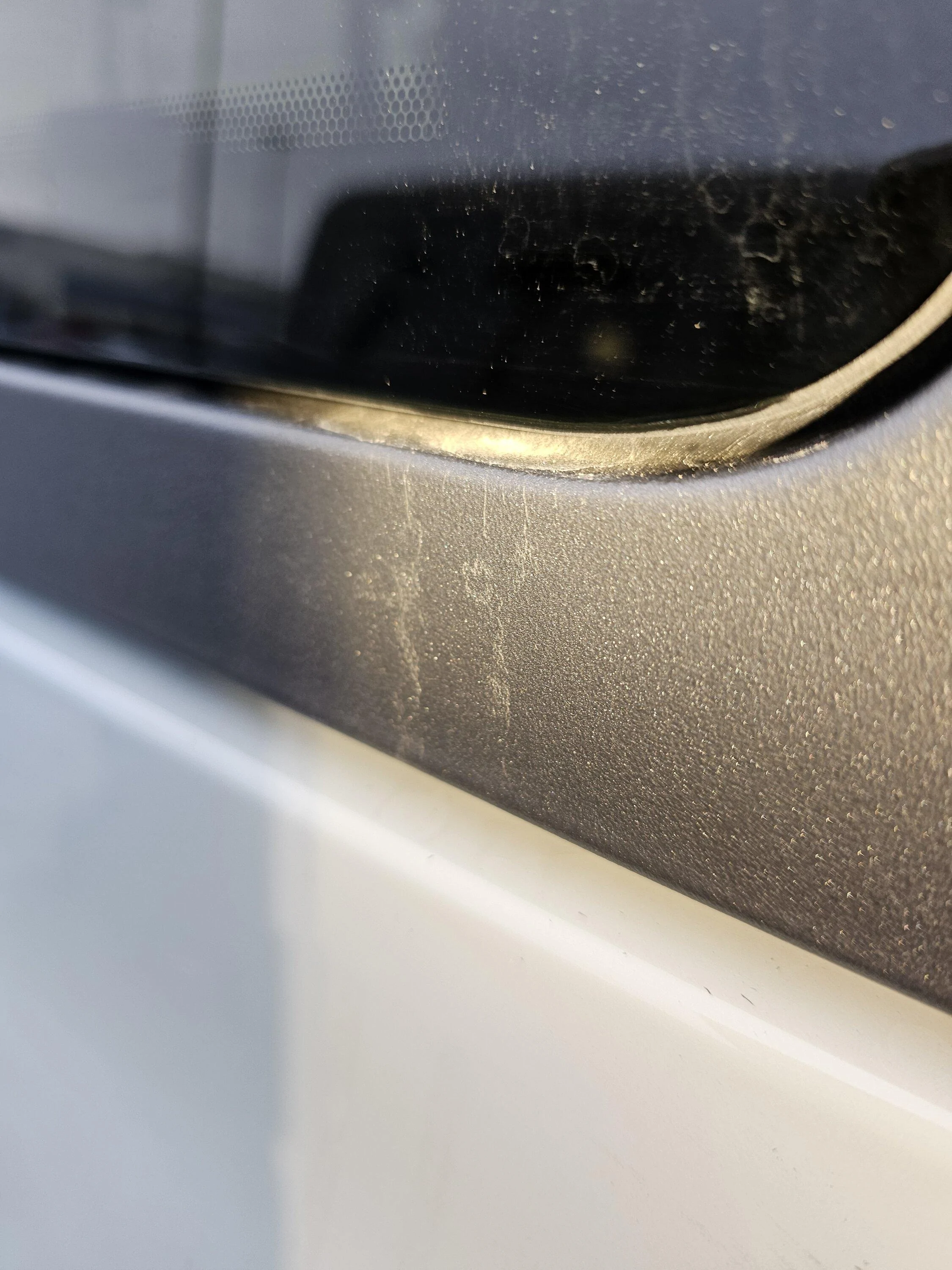

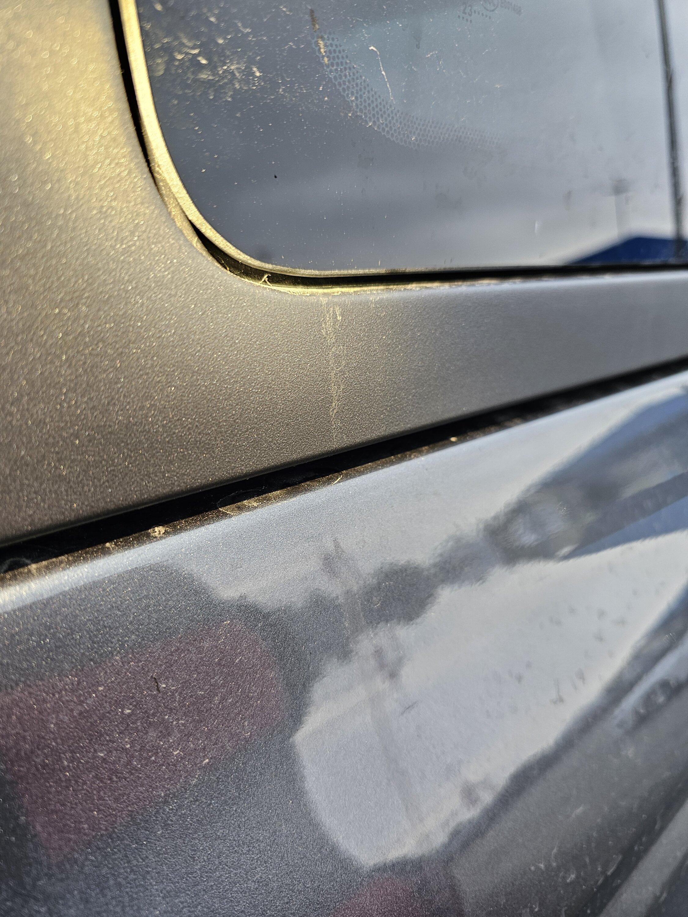

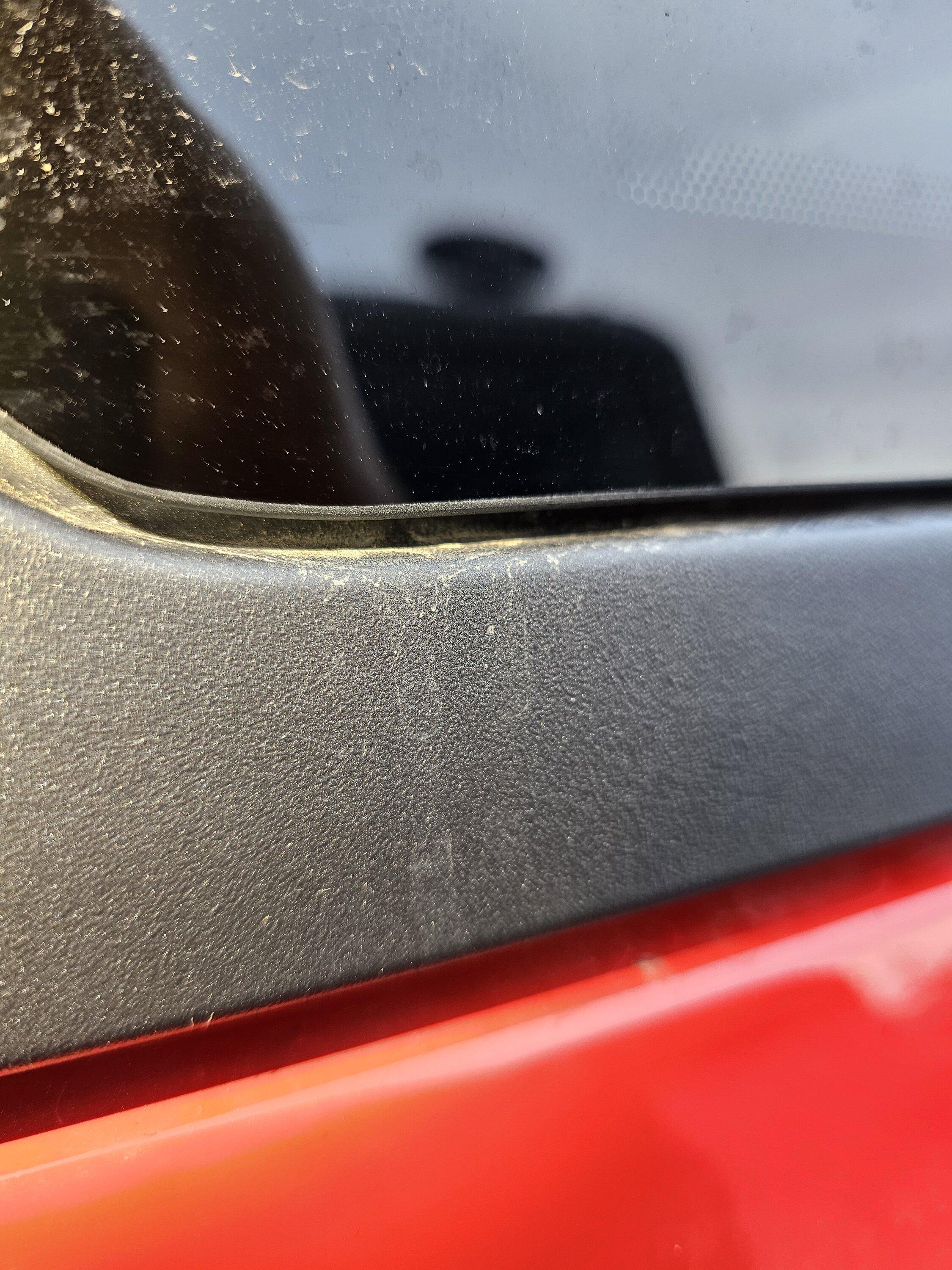

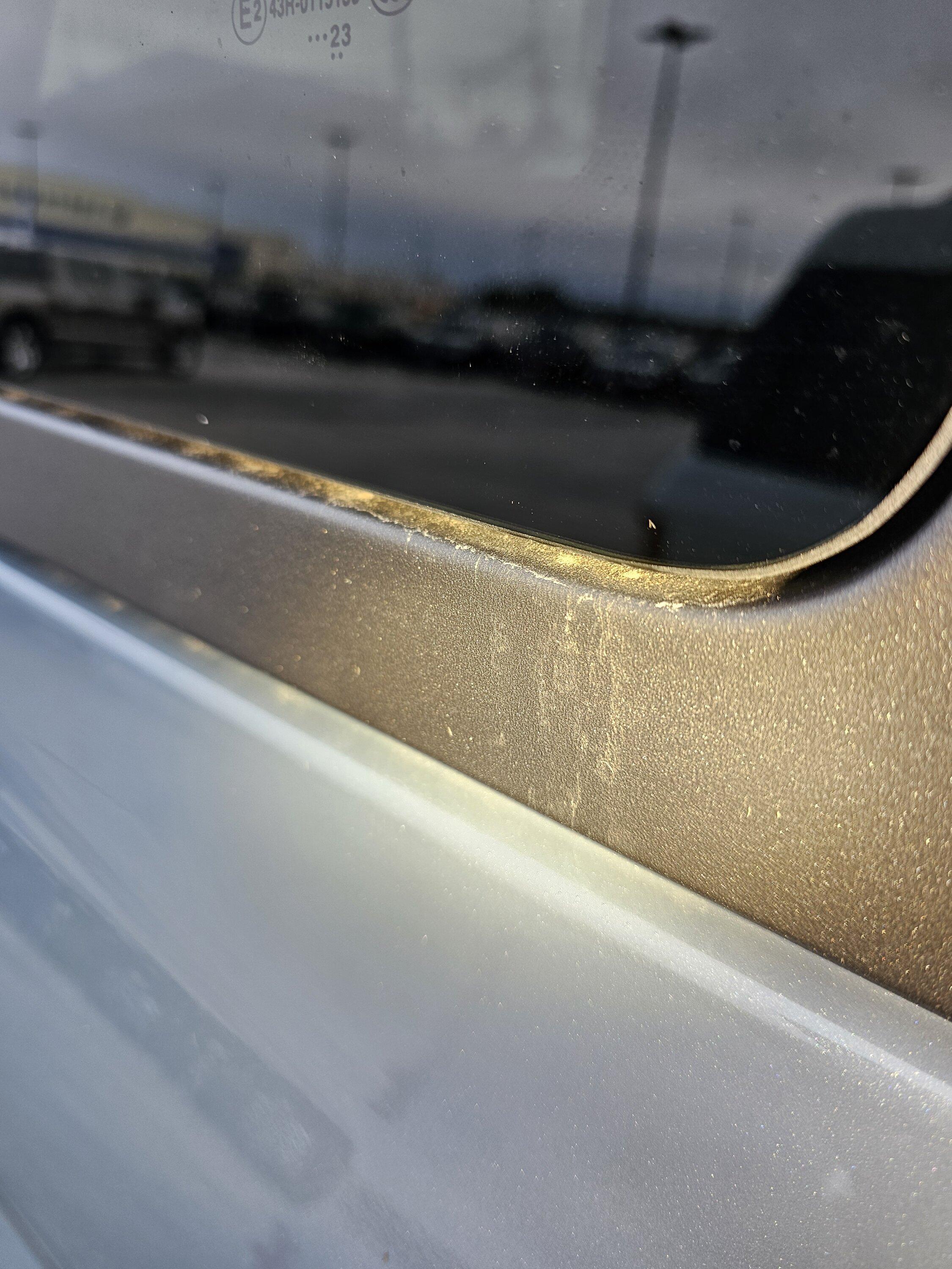

2 Broncos in our parking lot. Using a flashlight, both have cracks in the same spot. Was only able to get a picture of 1. Walking around a parking lot with a flashlight up to random vehicle windows will get a person around here shot.
It absolutely takes a flashlight and the right angle to see in the daylight.
Still at 100 percent failure rate.

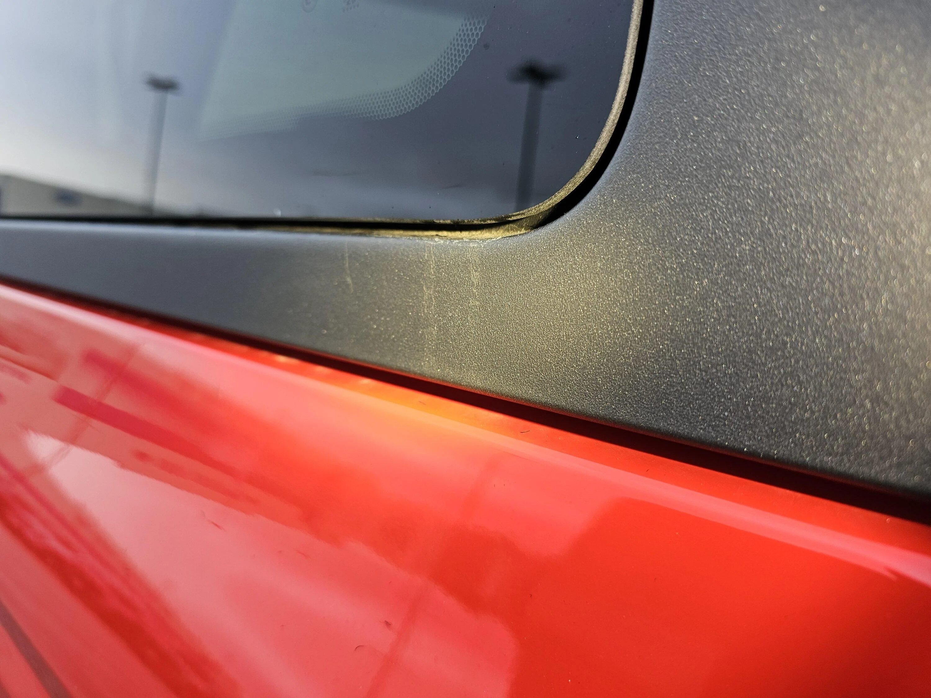

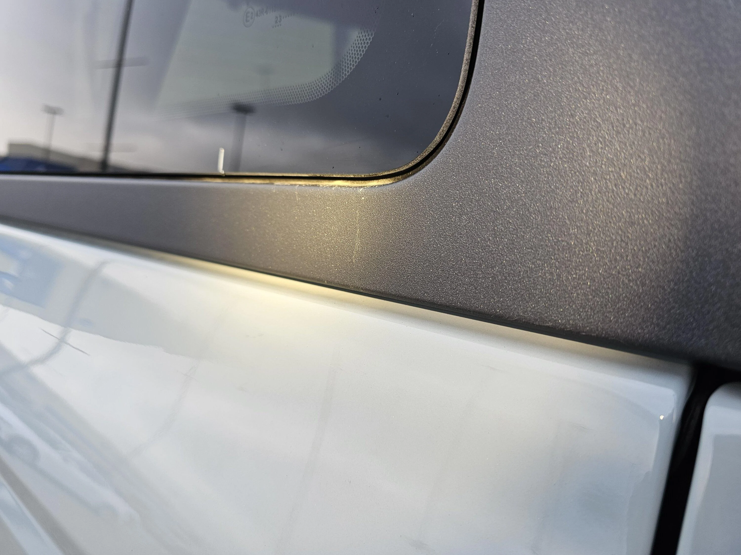

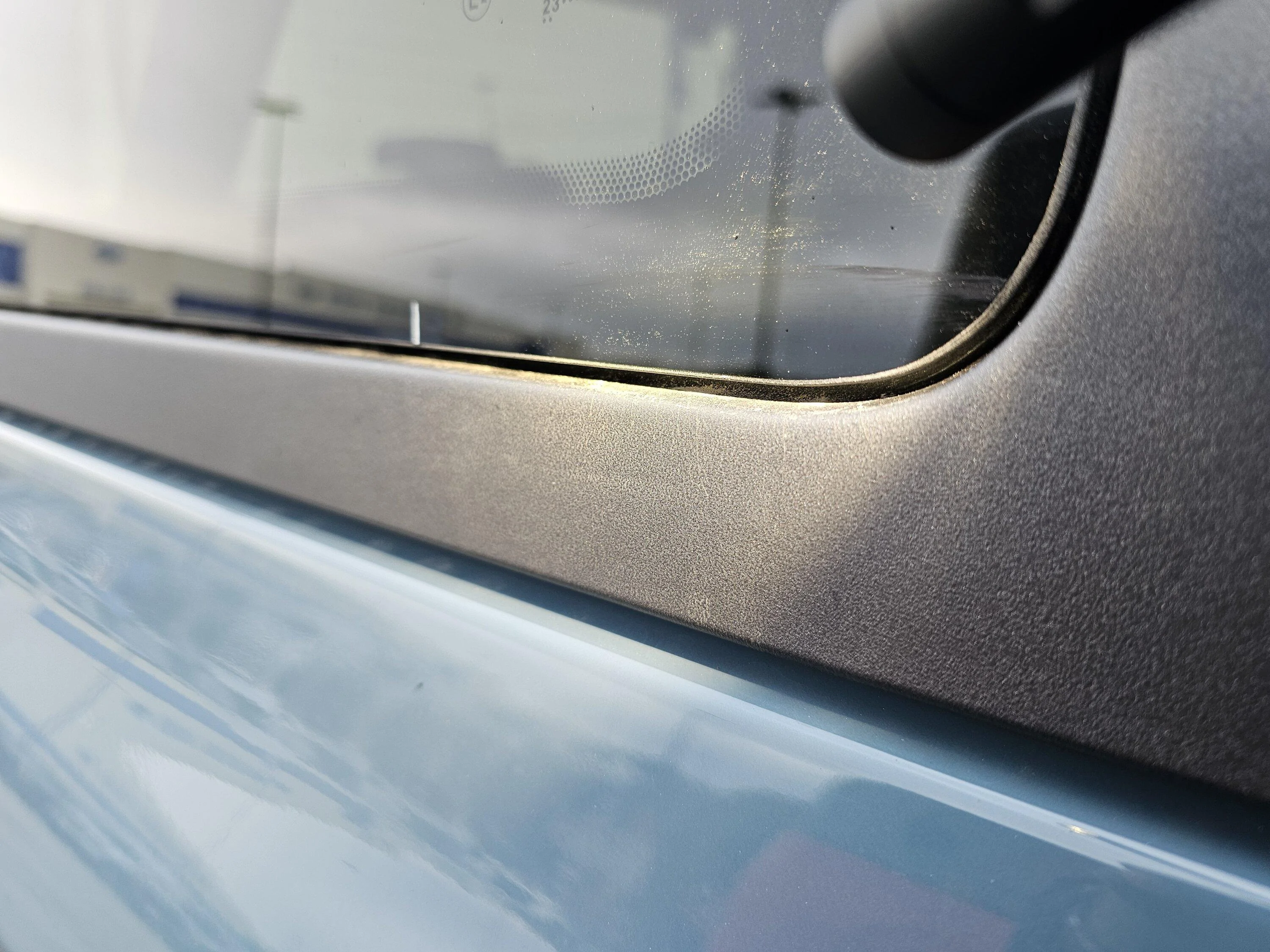

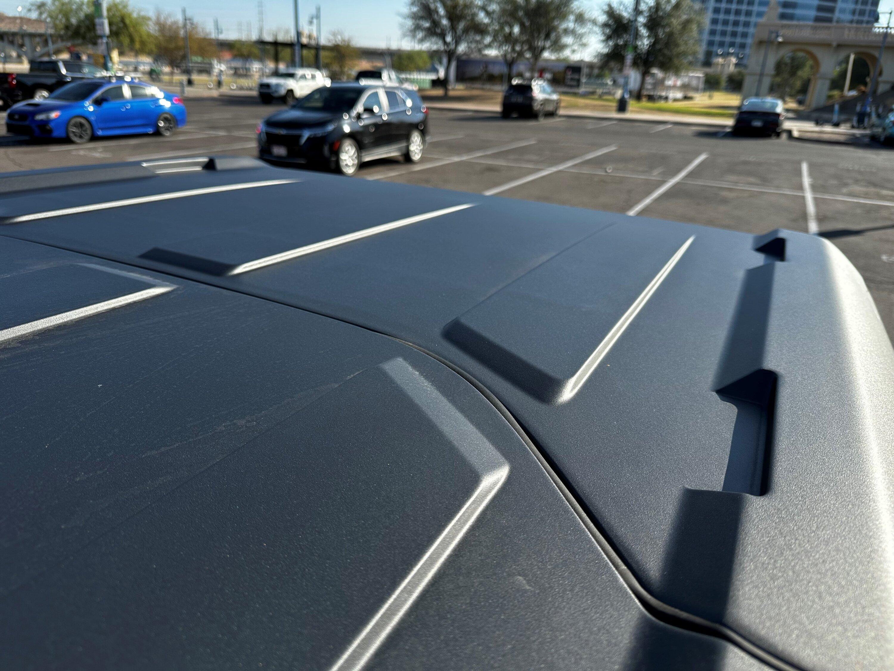

I was wrong. There are 9 more Broncos on this first lot...
Still 100%.
Pictures on the way.
1986Bronco
Jun 1, 2023
167
118
South Texas
2021 V90 T6 Polestar, 2018 4Runner, 1990 Pao

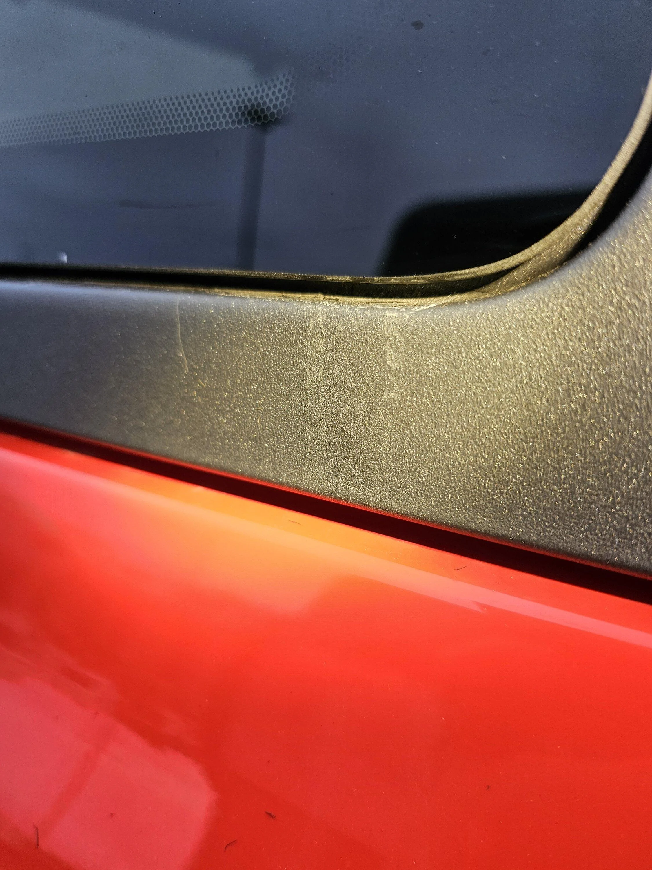

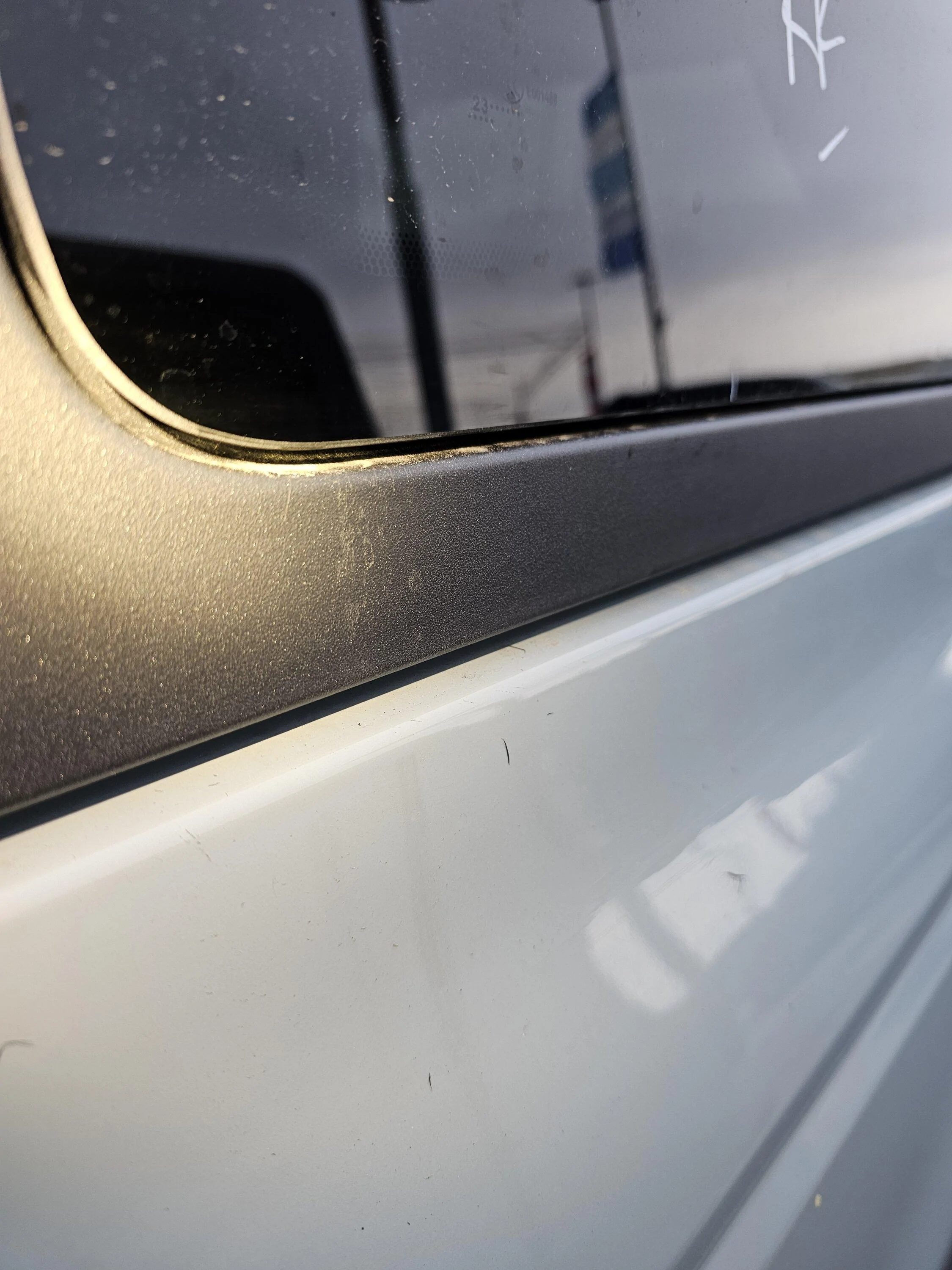

Also.
As an engineer...I'm an idiot.
A large portion of these are still wrapped in plastic on the inside and have never been "on the road" but still have the "cracks".
This has got to be an installation error at the factory or a storing at the warehouse problem. Maybe even a mass shipping problem. I am leaning towards installation/factory line for several reasons.
These are possibly stress cracks IN the material that, after they are formed, work their way to the surface over time with more driving and road vibrations, etc.
Edit: I have also been running through mental plausible scenarios like heat migration from the glass to the top, the temperature of the glass sealer, the chemical composition of the glass sealer interacting with the MIC material (hey Ford, you are so worried about US putting the wrong chemicals on the hartdop...are you worrried about yourself?) , etc. At this point, I might be spending more mental power on this than FORD.
Ford. Where are you at? We are solving problems for you...

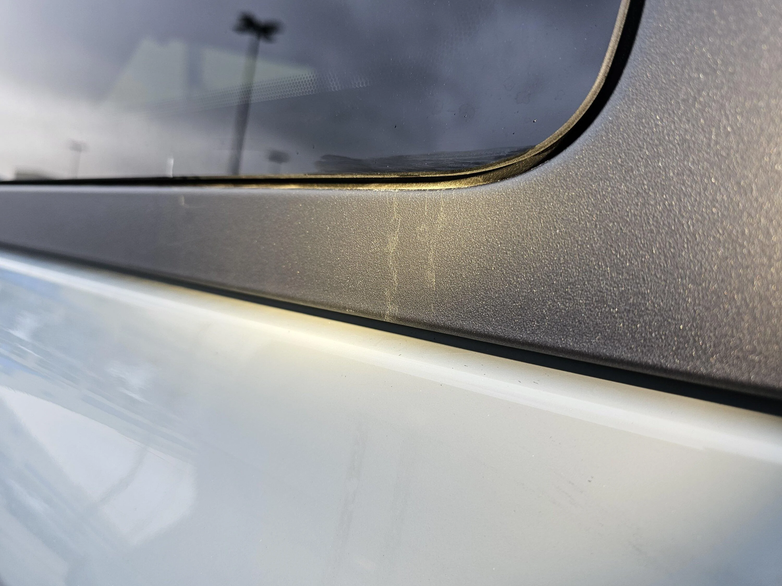

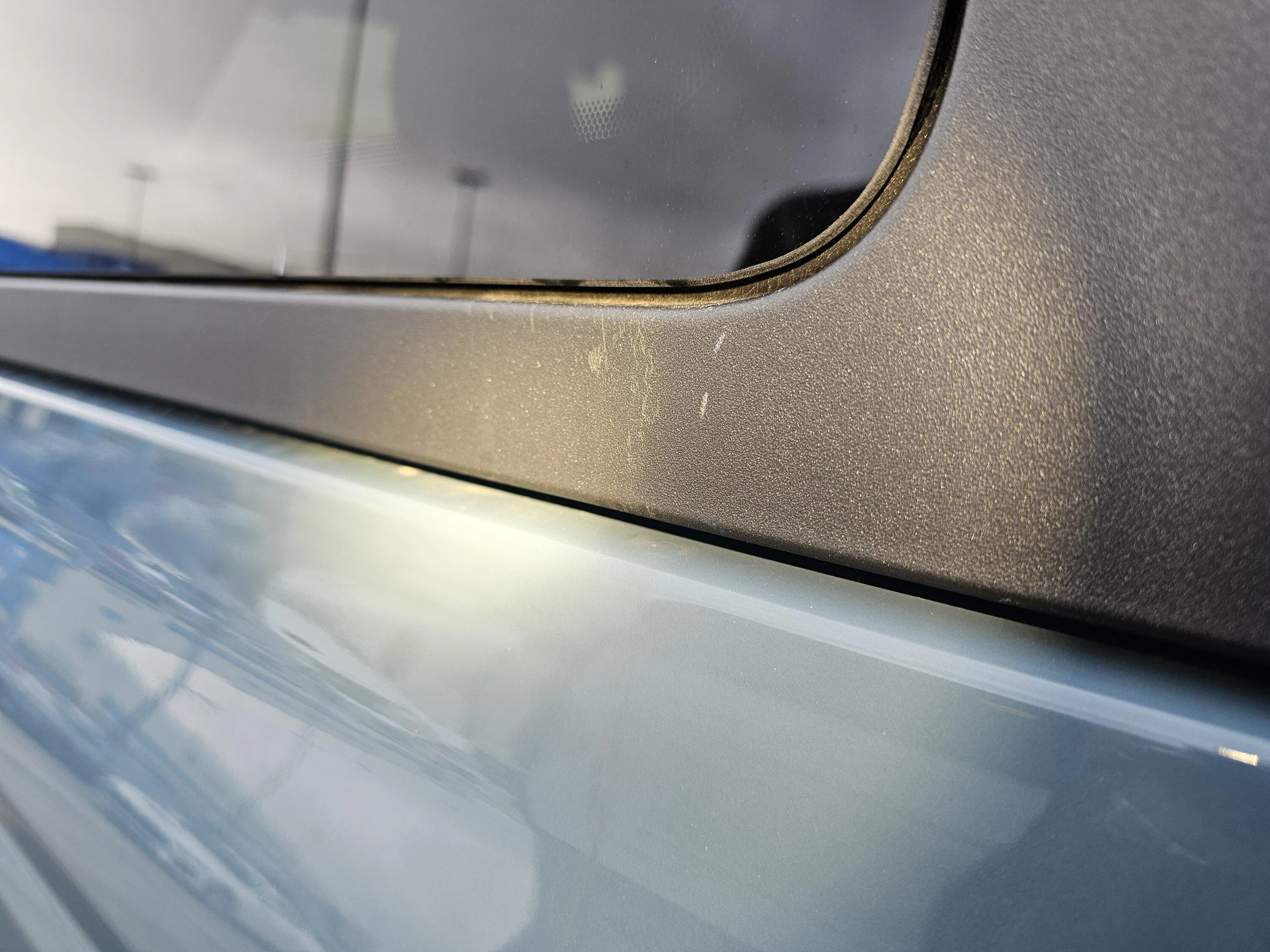

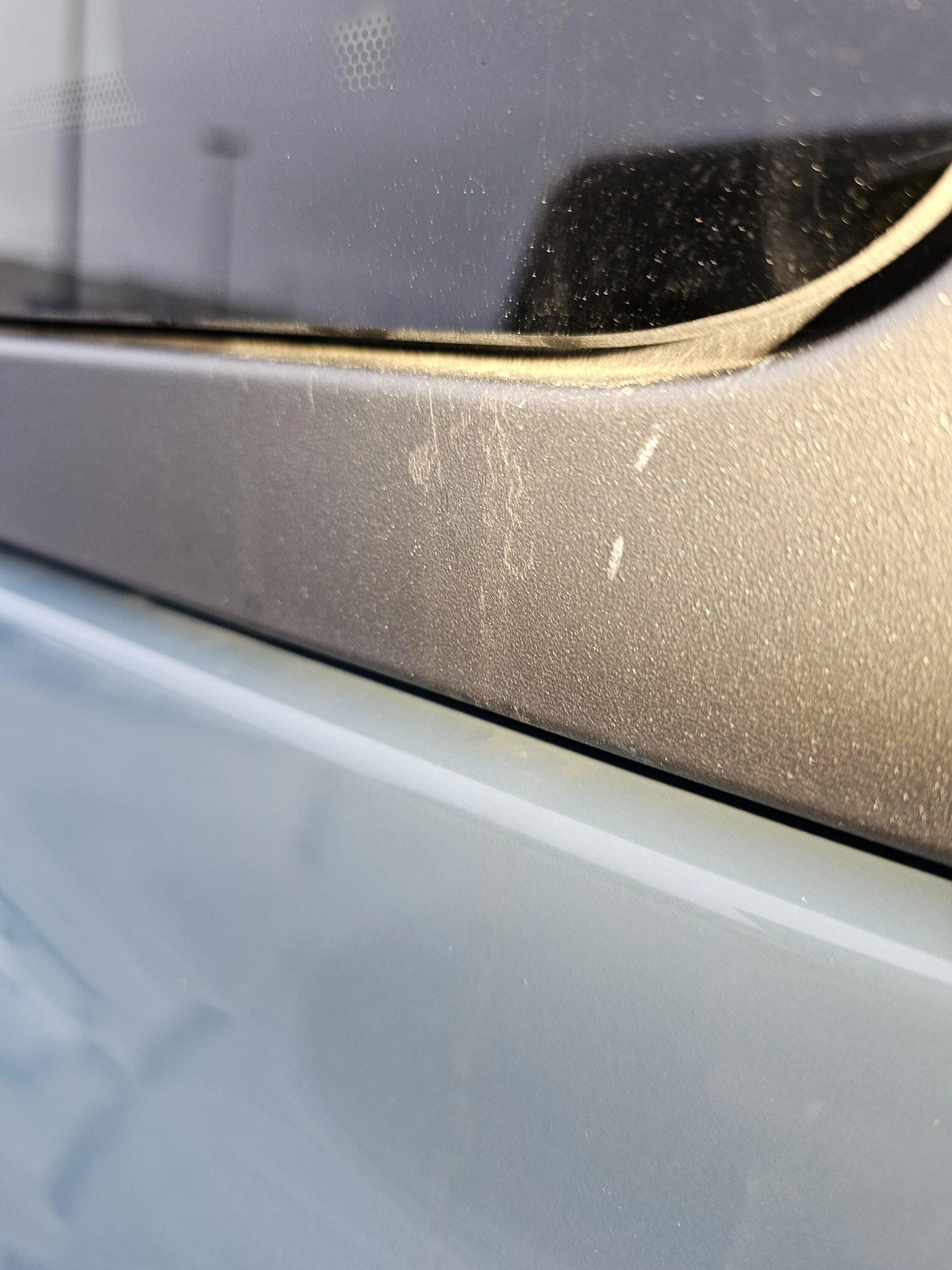

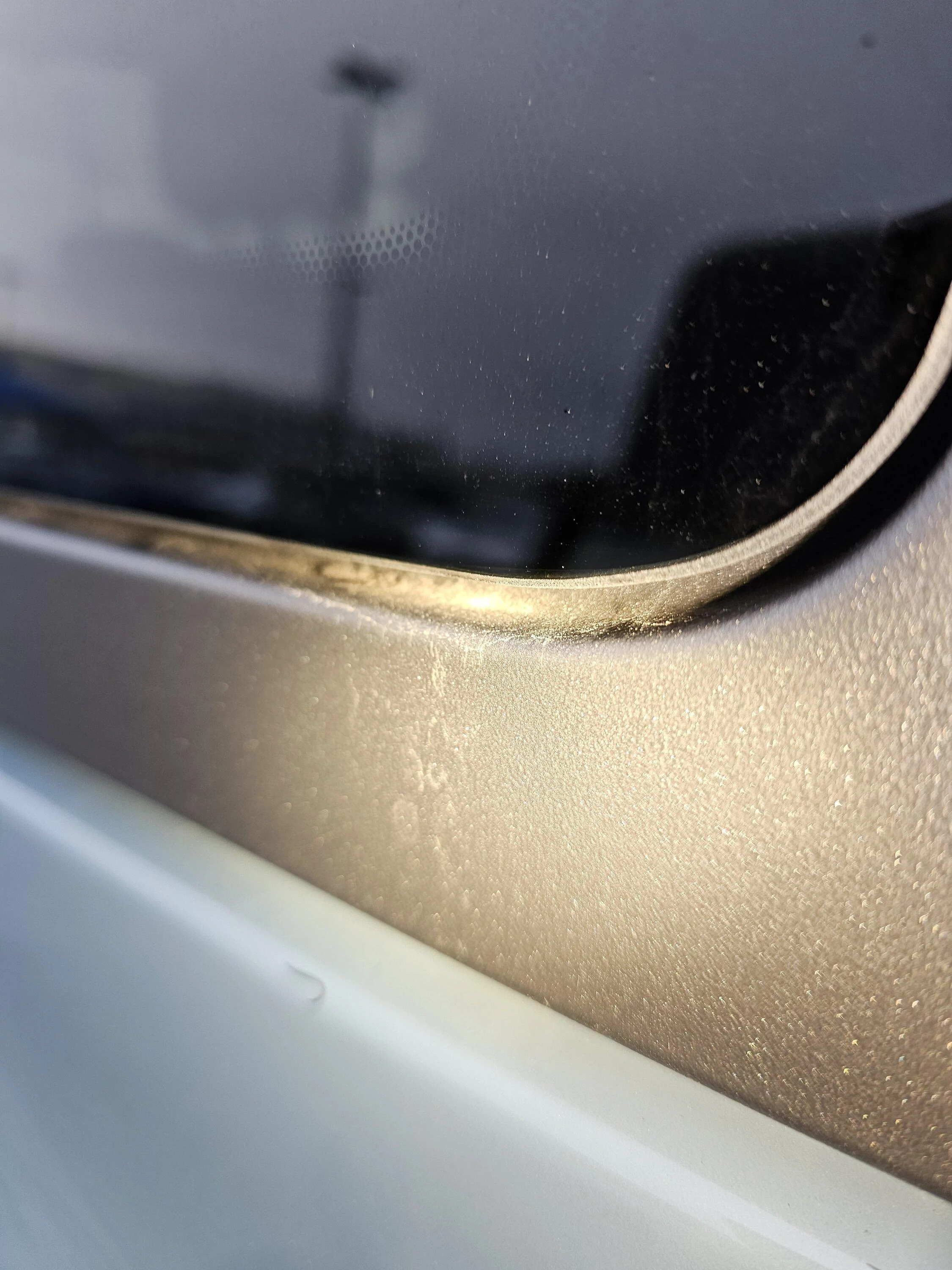

And I apologize for the jumble of pictures. It was difficult with the salesmen on the lot, holding a mug of coffee, and trying to beat the rising sun. These Broncos may not have been there before and were possibly delivered during the week, I am not sure how I missed them. If any pictures are missing, let me be clear that it was still a 100% failure rate with a mix of 2 and 4-door Broncos. This time, all on the new lot. I have full pictures of each but am keeping the dealership name out of it.
And Ford, you are welcome. An elderly gentleman and his wife in a newer Ranger stopped me becuase they thought I was a salesperson. I walked next to them as they drove back up to the front and brought a salesperson to them.
