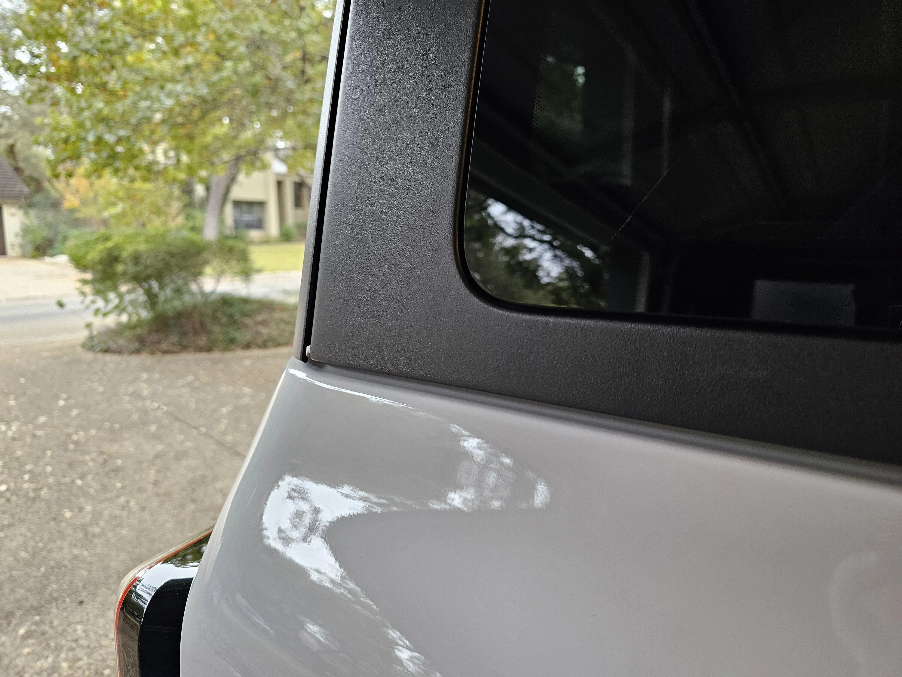

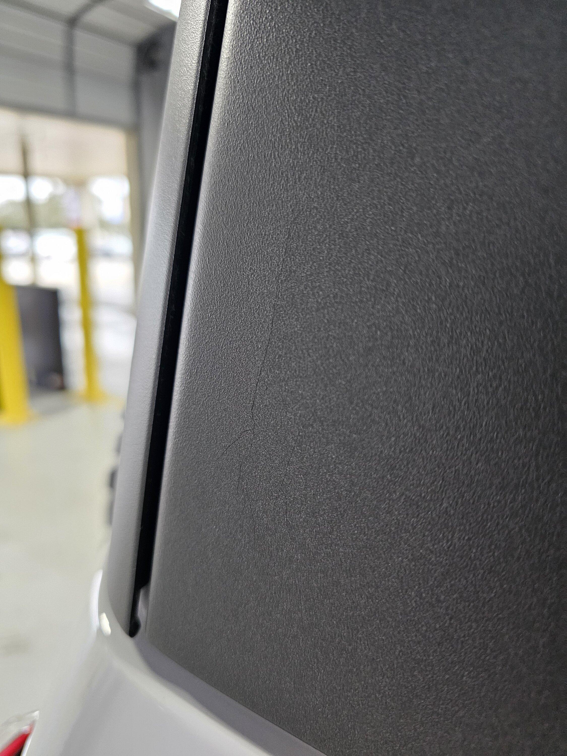

Admittingly, I'm a little more sensitive to looking over the hardtop these days to keep an eye on the "stress cracks".
Noticed new ones around the back window on the passenger side, vertical at the far back of the window. These look to have penetrated the outer layer. 1,616 miles. A bit of a temperature swing here, but mainly in the 50s. Humidity outside has shifted back and forth from 40% to 70% back to 40%. Bronco is garaged in a relatively climate controlled environment.
Zooming in reveals the edges of the crack.
Cannot catch it with my nail or feel it with my finger.

yup those will def turn into cracks. They start off like lil marks but then develop into full on cracks. Make sure you alert your dealer about it. Ford Engineers know it’s an issue but has yet to really do much about it unless you pursue it. Mine developed a few months after I took purchase. They all seem to start around the edges like that. After a year of trying my roof finally got replaced after getting the BBB involved. Keep pushing. It’s unacceptable they give so much pushback to this issue. Hope y’all get yours replaced! Ford needs to seriously reconsider these MIC Tops. They’re 100% faulty. Until they go back and discuss options to change the tops it’ll continue to happen.

Also. This is not dirt, a trail of dirt, a trail of water from condensation or washing. It is in the material. In the exact same spot. On every hardtop Bronco that I came across this morning.
Smells a lot like a design manufacturing issue. Likely a shrink issue as a guess. That kind of repeatability always points to a failed process or design. Or both. I'm waiting on our Bronco and fingers crossed this is fixed before Jan 2024. I'm placing no bets on that happening.

Maybe so. I was initially upset at the problem but entertained about trying to find out why it was happening.
Now that I have new vertical cracks along the back, I lost a bit of steam. I tried Ford again with the new cracks since they are through the outer material and visited the dealership. They took pictures and said they would get back to me. That was a week ago and I have not heard a thing from them.
