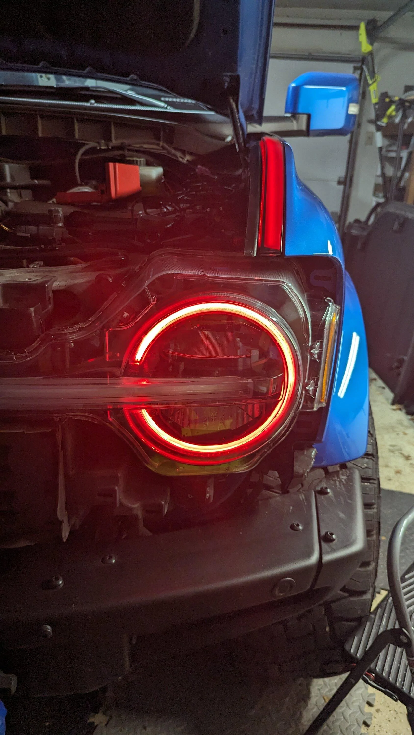

The opening of the headlights is not for the feint of heart. I purchased the Oracle Halo upgrade for my signature lights and have had nothing but trouble. I watched the Oracle video and tried to bake my passenger side housing. At 225, after 9 minutes my housing started to melt. I called them to let them know this happened and their reply was that they use that temp all the time and have never had it happen to them. To add insult to injury, I still couldn't pry the lens off of the housing so had to cut it any way. The cutting didn't go to bad, should have done it that way from the get go.
The next problem was not a problem, according to Oracle. I installed the new LED boards, per the video and everything worked, so I thought. I noticed the DRL bar, the one that is white and turns amber with the turn signals, was no longer working. The turn signals work but the white bar gets disconnected when you remove the OEM LED board for the halo. I called Oracle on that and if you look at their examples, not one of them has the bar working. They said they developed the halo without an actual Bronco, just the headlight. I was supposed to receive a call back if they found a solution. Must not have one yet but this was back in early March. I have since been experimenting with resistors to try and complete the circuit that was left open with the halo kit but don't have any consistency. This experimenting has required me to break my seal at least 5 times to reopen the headlight. I have since run the wires that I am experimenting with outside the housing.
The next problem I had with the halo kit was the control box that came with the kit. It isn't sealed very well and I think it got wet. It was giving me a constantly red halo that I couldn't turn off without removing the fuse from the BC1 controller. I contacted Oracle and they thought it was the BC1 but I tried to insist I thought it was the halo control box. They sent me a new BC1 which didn't fix the problem. Then they sent me a new control box that did fix the problem.
My last problem, which occurred today, is the BC1 controiler has died and I had to use the other one they sent me to get the problem fixed. I was going to use the 2nd one to make it so I could control the color of my DRL bar with a RGB strip that I purchased from Oracle. I am hoping they send me another replacement.

I baked mine and followed the video to a "T" the problem is that the video does not tell you what to do with the side marker light wire harness (which has to remain in order for the side markers to remain operational). I was able to get that figured out with a call to their tech line before sealing it all up. Also I learned from Oracle that you never get the seal soft enough on the first bake, the tech said he has to do it on average about (3) times. I was proud of my work until I resealed the headlight to only discover that I forgot to include the halo light diffuser. I was fed up at that point and left it alone for the night. In the morning I reopened the light and added the diffuser. At this point though, the black housing material was beyond repairable. So I have a perfect new Driver side light and a damaged housing passenger light if anyone wants to make an offer. Anyway ordered the Alpha T-Rex and learned from my mistake.

I should have read this before installing, but I'm glad to know I didn't do anything wrong because I just finished install today and my signature bar was not lit also.
Overall the install was not bad, I looked up a general video on how to remove the lens because 225 for 12 minutes did not cut it for mine. I ended up doing 250 for like 20 minutes where things were soft enough from me to work it loose. I connected the lights with the trail sight deletes so I guess that's the tradeoff.
