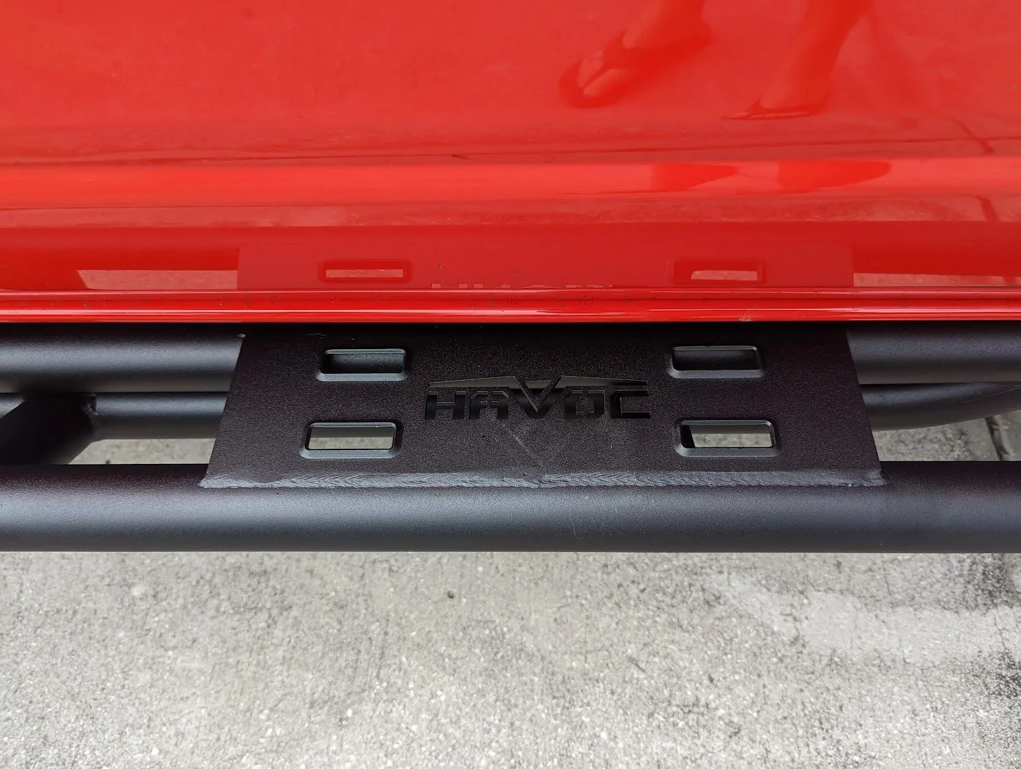

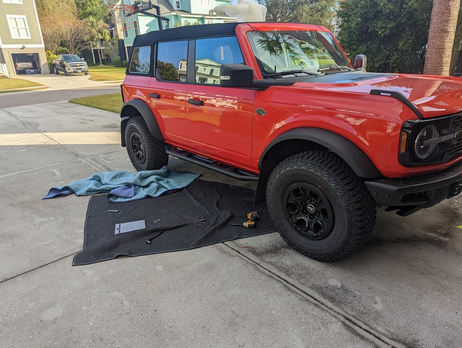

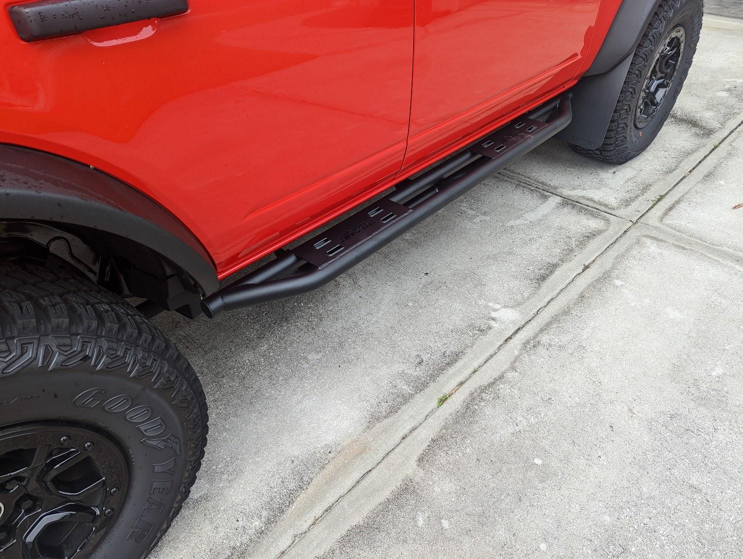

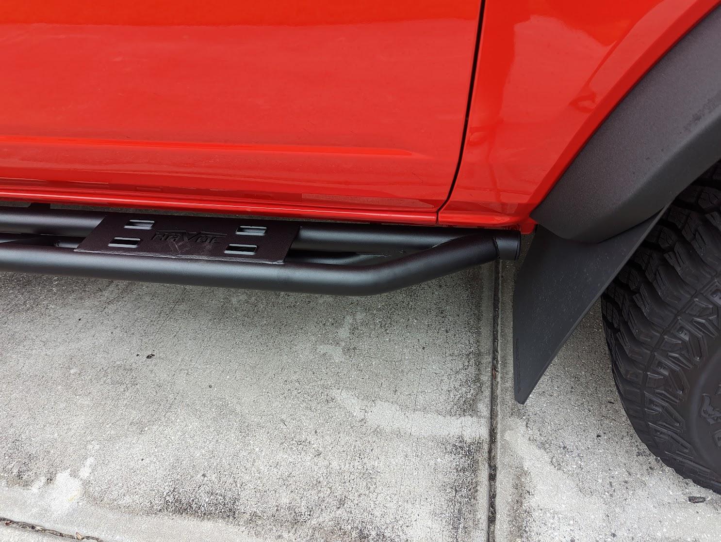

My wife pretty much demanded that I install steps on the Wildtrak, because it's tough for her to get into and out of, and I really liked the look of the Havoc Trailcrawler steps. I don't intend to do any crazy offroading, so I didn't need to buy anything that was a dedicated slider. Ordered Friday, received Tuesday, installed yesterday. They're heavy, and seem very well made, with end caps to stop moisture from getting in. Powder coating looks good, and the welds seem very good.
Installation took all of 15 minutes, but you need two sets of hands. I tried to maneuver the step into place, hold it, and start the center lower bolt, but I needed another hand. I had my kid start the bolt, and that worked perfectly. I have the Rekgen XL mud flaps, and these do not interfere, at all.

I anticipate all my trail time to be things like getting through wooded areas to/from camp sites, and since I live in Charleston, I have to really travel to get to anything where there are hills, let alone anything bigger than that. Are these rock sliders? No. Will they protect the pinch welds? Definitely. The brackets are pretty beefy, so I expect them to hold up well to what I'll throw at it, but getting high sided on a giant boulder is definitely not what these are meant for.
Looks great. I have a set of these waiting for my wildtrak when it comes in. I’ve been waiting on mud flaps until I knew a combo that worked. So looks like I’ll be ordering the rekgens
They're nicely made. Took me all of about 15 minutes to put on, and most of that was the front.
The one thing I'm going to change is that the rear mud flaps (at least on a Wildtrak) are screwing into a plastic bumper, and using holes that already exist from small bumper end plates. 5/6 of my screws went in solidly, but the sixth didn't want to tighten up like it should. I'm going to get replacement bolts and install these with nuts. We have access to the back side of the plastic bumper cover. Why wouldn't we bolt these in, rather than just screw them in?
