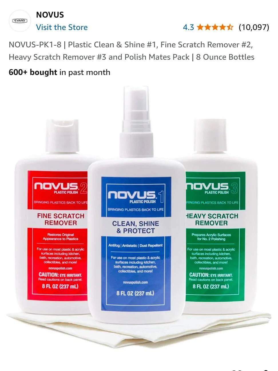

Scratched my headlights pretty bad on my 2023 Ford Bronco. Had a bunch of bug guts that wouldn't come off and thought hard side of a sponge wouldn't do any damage. How wrong was I scuffed it up pretty bad. This stuff on Amazon worked wonders made them look brand new again. I used the heavy scratch remover and then the clean and shine. Good as new!
Ford Bronco Headlight scratch fixed 1000003328

Now that you have them cleaned up slap some clear PPF on them for added protection. Pre-cut kits are pretty cheap and easy install.

Novus is great stuff. I've used refurbishing pinball machines for a long time. Definitely my go to and not surprised it works well on headlights...
