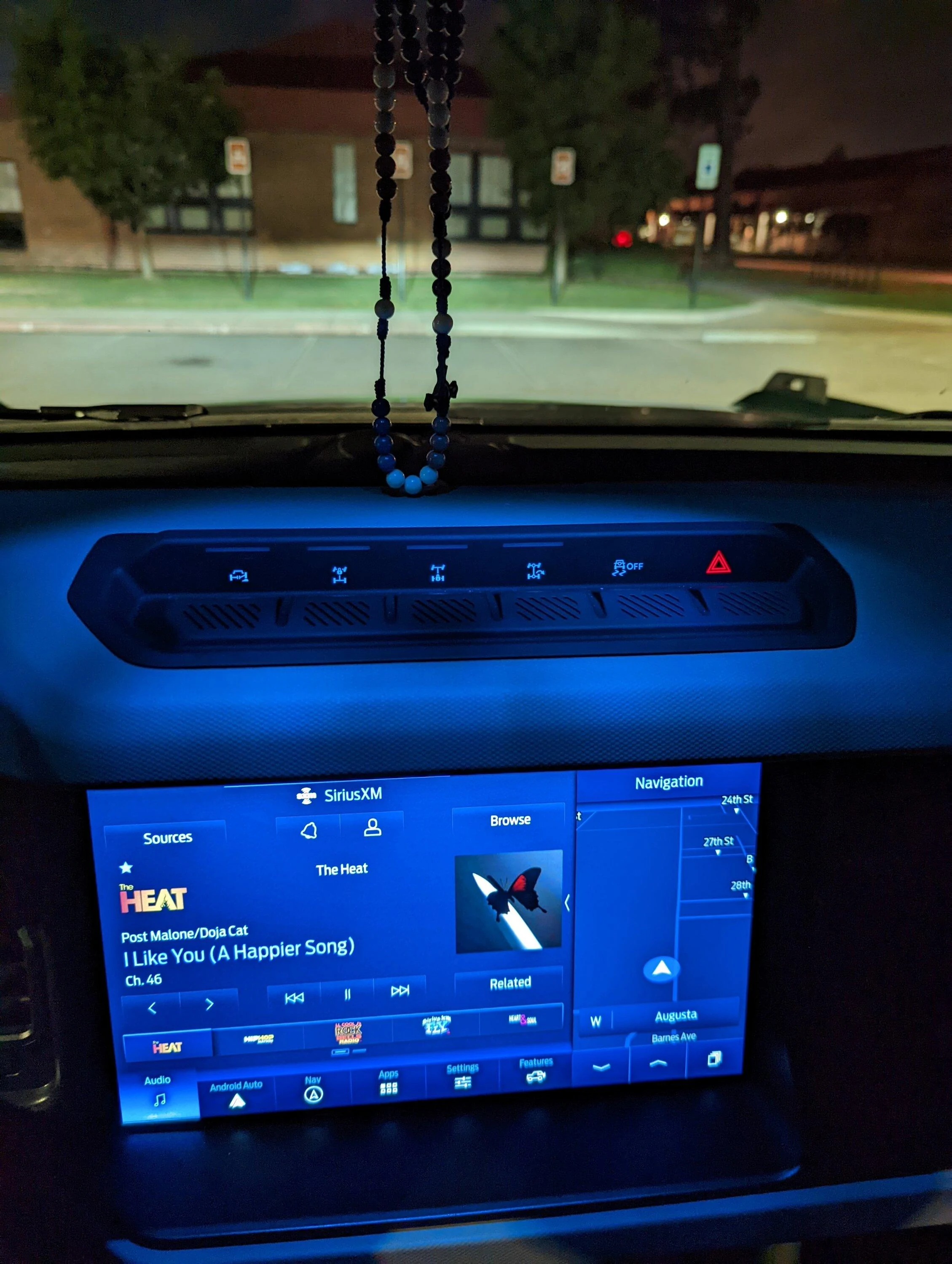

I just popped the original one out with a plastic pry tool, unplugged it, plugged in the new one, and snapped it back into place. I got it from Ruxer Ford, best place to get parts and you can get in on the forum discount since you are a member here and Phil @flip has outstanding customer service. Hit him up to get a quote, can't go wrong with them. I will post some pictures when I get home.

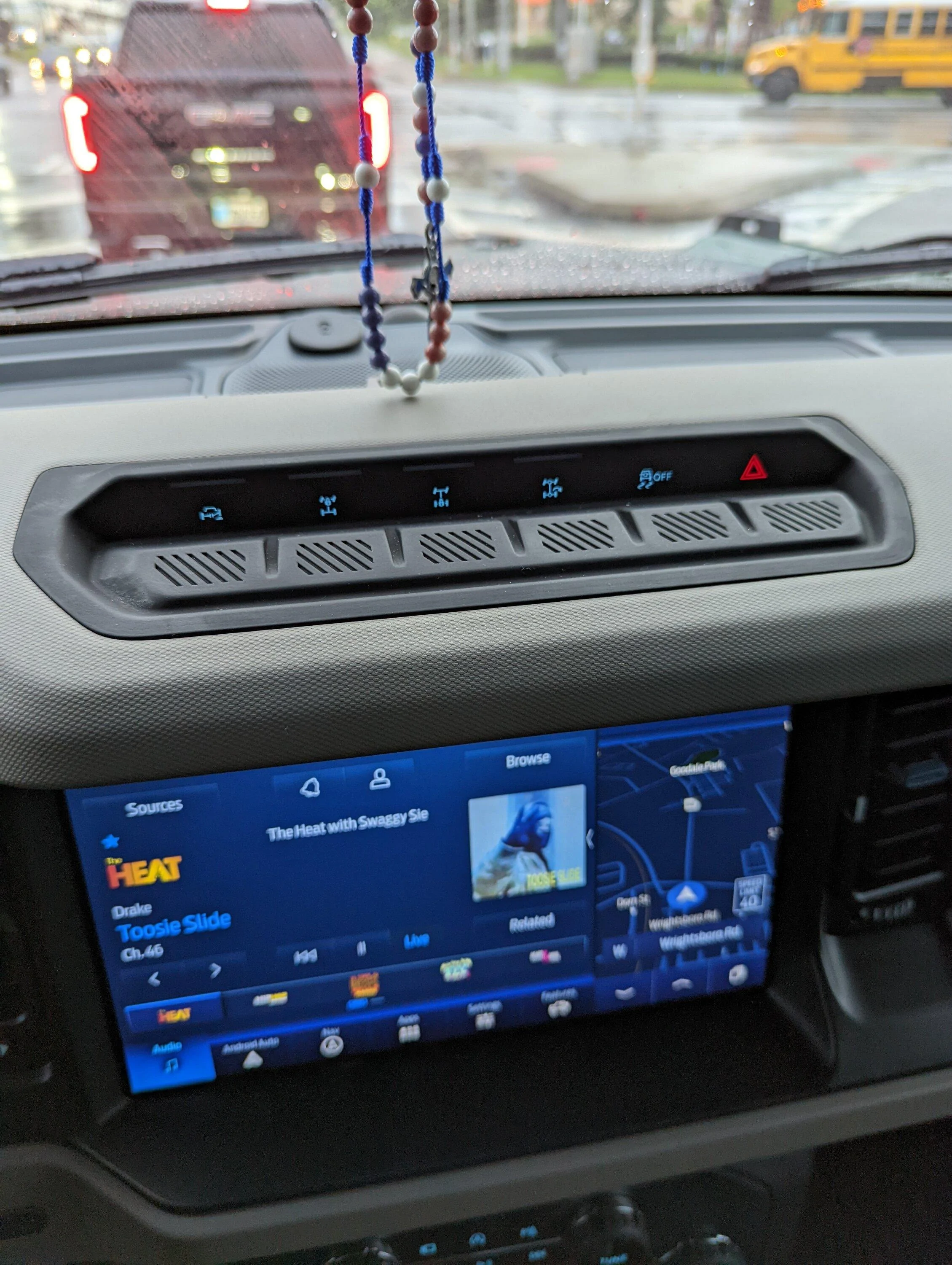

Wait you have sta-bar disconnect but no trail turn????
Manual badlands come in this configuration, trail turn is auto trans only
