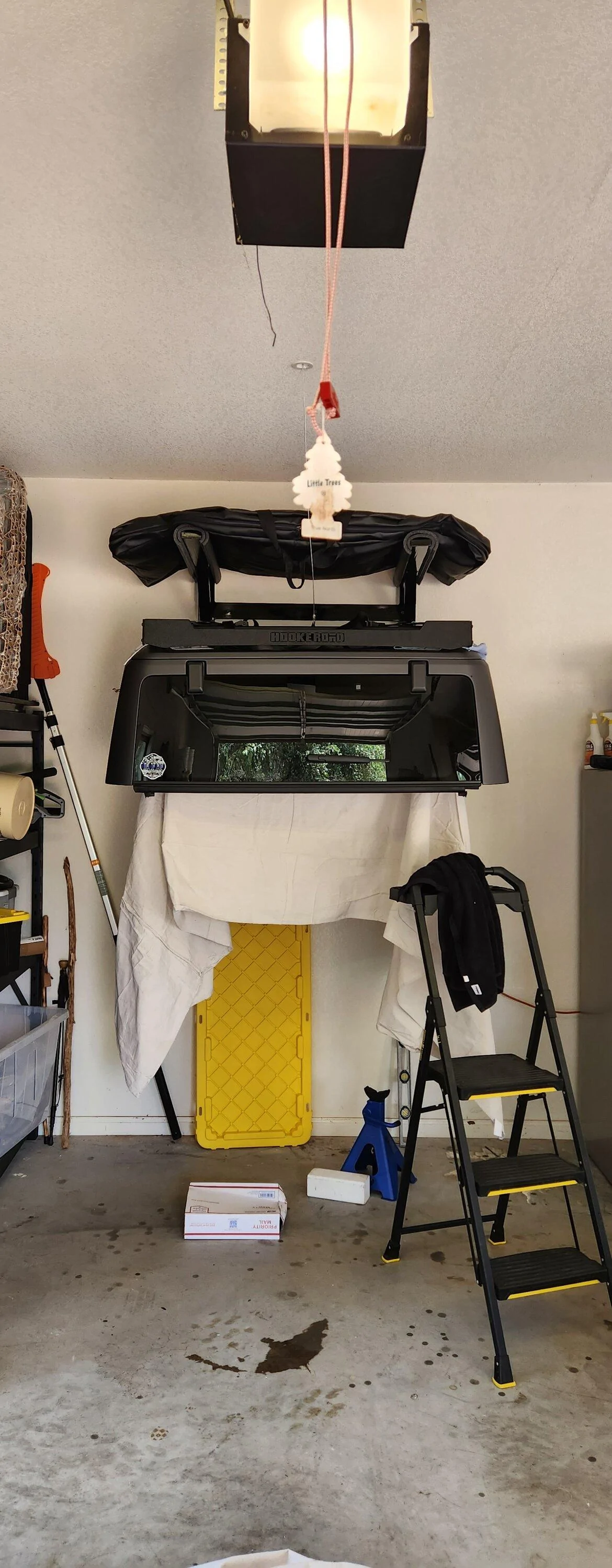

I use a Hooke Road half rack and a hoist to lift the rear clam shell to a DIY wall rack. I do use towels between the roof rack and top to minimize any scratches.

Good setup. I’ve not seen a vertical wall mount like that before. My garage ceiling is tall enough for me to lift straight up and it be out of the way. Thanks for sharing you lift it from the Hooke Road rack.

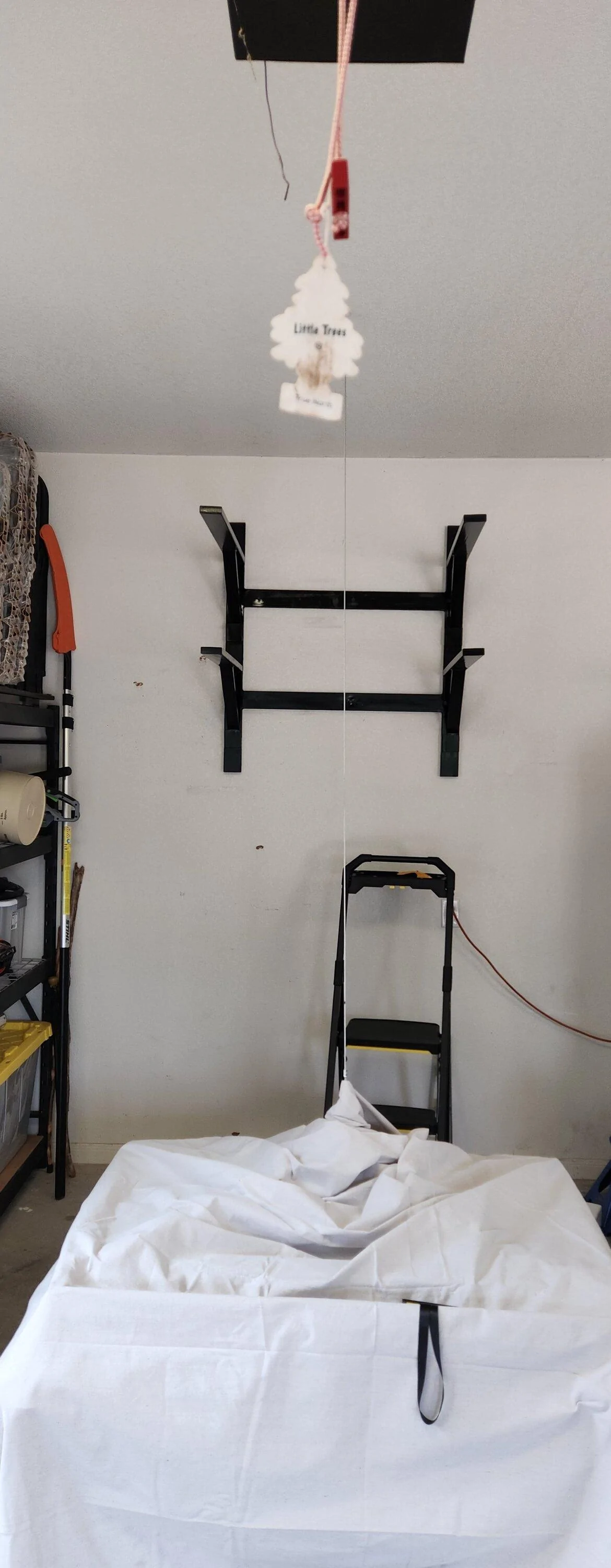

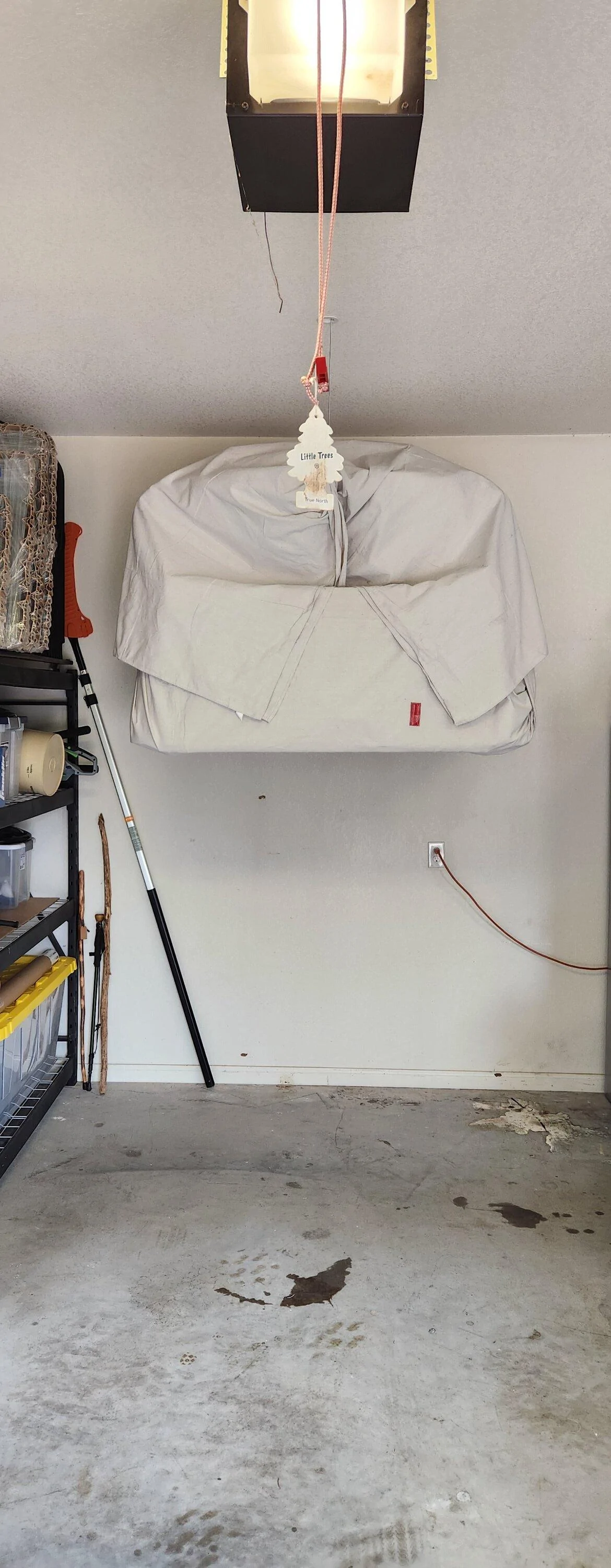

Here's a better view of my wall rack. The three removable panels are stored on the top in Ford bags, and the clam shell is on the lower. The arms are removable when not in use. The canvas tarp covering everything is to keep mud daubers out. I would like to get a custom bag made to store the clam shell in.
