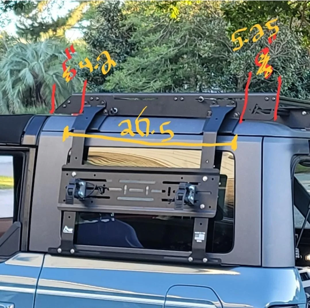

Ok, I didnt realize the tent opened to the side! So since its a matter of inches, and I was guessing the overhangs, the rain stopped and i went out and measured the overhang. You have about 26.5" of span from the outer edge of the two brackets. And if the tent opens off to the side, and its only 48" wide, thats 6" overhang front and back of the rack. It you used the side saddles for additional capacity . . . Email @TrailRax and ask the weight capacity of the half-rack with the PakRax side-brackets installed. The downside is no place to put the mid-panel (I put mine on the half-rack). I think I might do a tent like yours if the weight capacity was adequate . . . Your tent would prevent the 2row skyrider from opening, but the one-row skyrider would work great in that application, perhaps.
Whats the name of your tent?
We rate the half rack at 150 pounds dynamic and 300 pounds static evenly distributed. That being said, we do not recommend mounting an RTT to the half rack. We only recommend mounting tents to the full rack because it has the extra support of the windshield mounting brackets. These tie into the studs under the caps at the top of your windshield that say "accessory ready"!

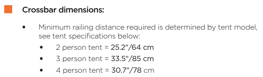

Ok, I didnt realize the tent opened to the side! So since its a matter of inches, and I was guessing the overhangs, the rain stopped and i went out and measured the overhang. You have about 26.5" of span from the outer edge of the two brackets. And if the tent opens off to the side, and its only 48" wide, thats 6" overhang front and back of the rack. It you used the side saddles for additional capacity . . . Email @TrailRax and ask the weight capacity of the half-rack with the PakRax side-brackets installed. The downside is no place to put the mid-panel (I put mine on the half-rack). UPDATE We now know TrailRax does not recommend putting tents on the Half-Rack, and the tent mfgr says you need 32" span between mounting brackets, not 26.5, so the official answer is no!. . . Your tent would also prevent the 2row skyrider from opening, but the one-row sunrider would work great in that application, perhaps.
Oh well! Whats the name of your tent?
hmm.. ok, that might change things a little bit.
The tent I have is the Tepui Low-Pro 3. I've used it for years on other trucks and it has held up really well. I definitely wouldn't put too much extra weight up on the rear top section of the bronco, though, so it's probably limited to solo camping? Tepui itself was also sold to Thule and I think they may have discontinued this LP3 model. (seen here on clearance: https://offroadalliance.com/CLOSEOUT--Thule-Tepui--LowPro-3-Roof-Top-Tent--901003/). Thule does still offer the Low-pro 2, though, which is slightly smaller version at 50" x 43" x 10" when it's closed, and weighs just 98 pounds.
I'll reach out to Trailrax to discuss the possibilities. Thank you again!

Interestingly enough, it does look like the Low-pro 2 would technically work with both the weight limits and the crossbar width if you're under 202 lbs body weight. (and, at 50" long, it would hang off just 7" front and back).
Ford Bronco Installed TrailRax "Half-Rack" on OBX 1697135877675
That said, it's probably best to take the manufacturer's advice and avoid it altogether... :devilish:
