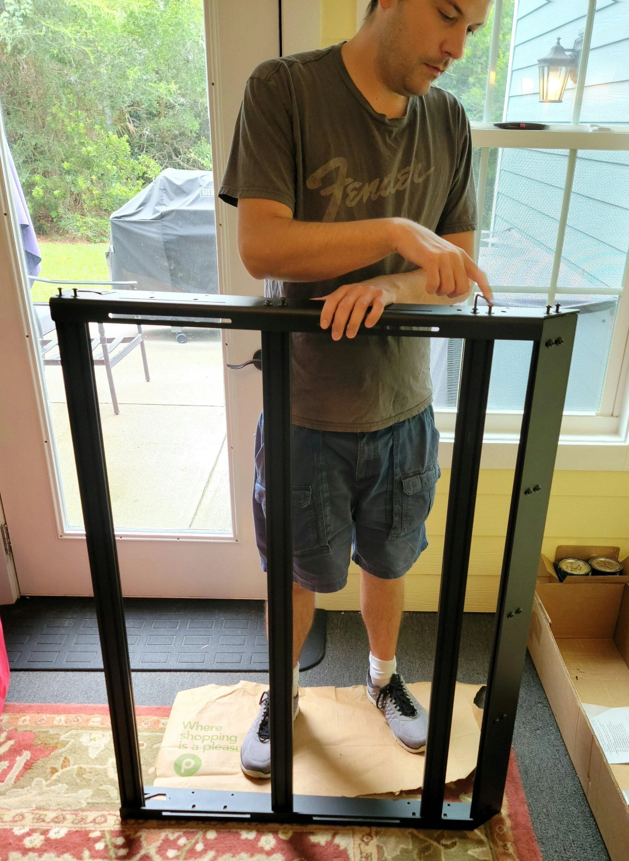

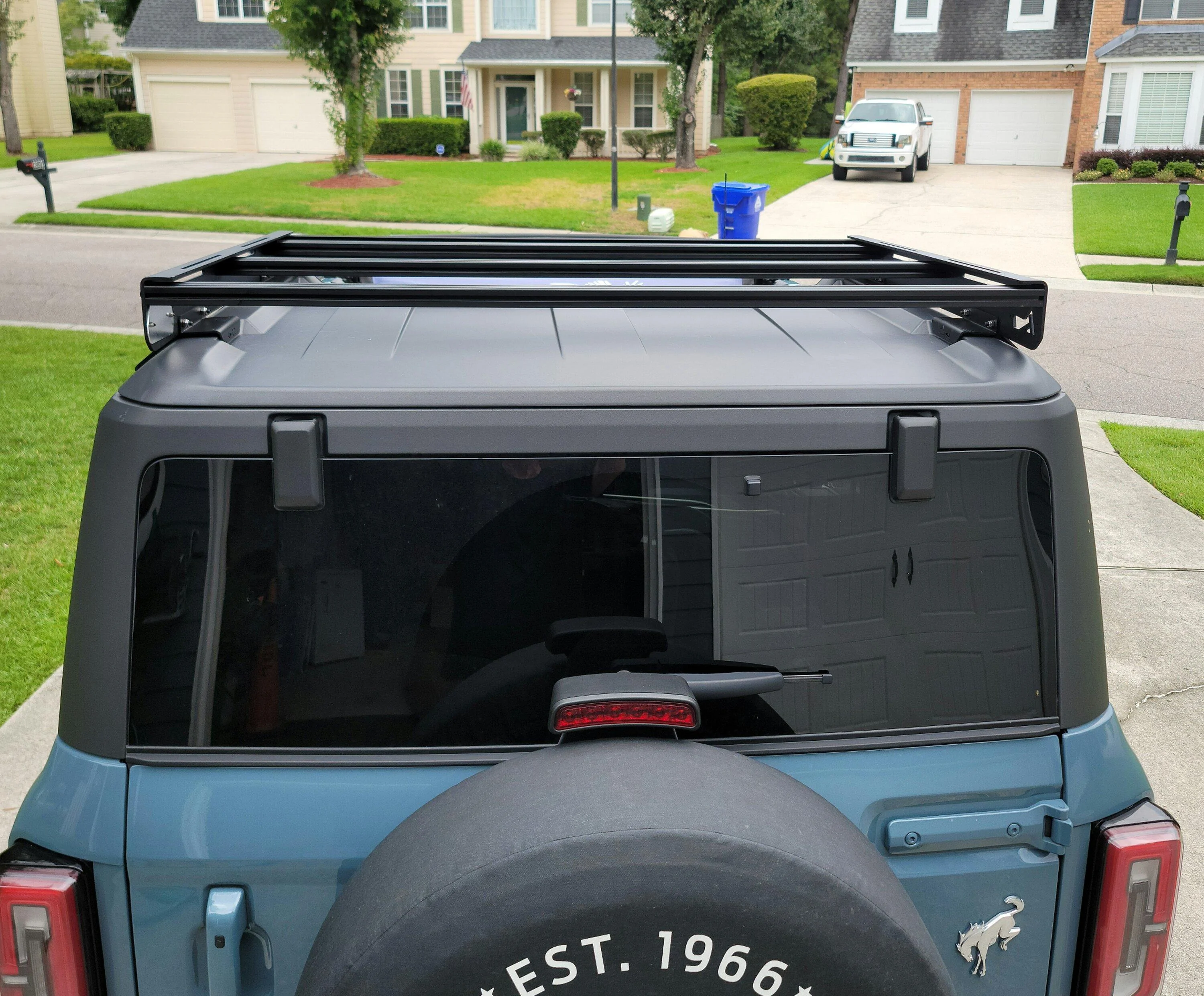

Since I bought my OBX in October 2021, my plan was to put a small roof rack over the rear cap, so that I could remove the front and middle panels and still have a small roof rack. I leave the rear cap on the car, so this works for me.

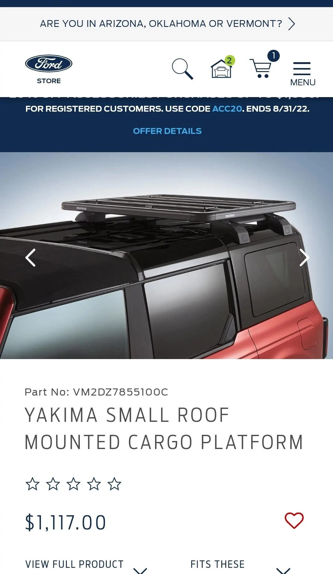

The Ford Performance/Yakima rack featured in the 2020-2021 concept vehicles I couldn't find, but the TrailRax https://www.trailrax.com/ becameavailable a few weeks ago so I bought one through Bronco Nation for $765. There is a video to install their full-roof rack, and I used the applicable portions from that. I decided to not purchase the side saddles, but I could easily do that if I have the need.
The rack seems very sturdy and well designed with a low profile. I'll know if it makes noise over the next few days of highway driving (update on very minimal wind noise below). I wanted to get something on the roof because I like the tie-offs for awnings at the beach, and because we're driving to Texas late October for a 10 day trip to Bronco Off-Roadeo.

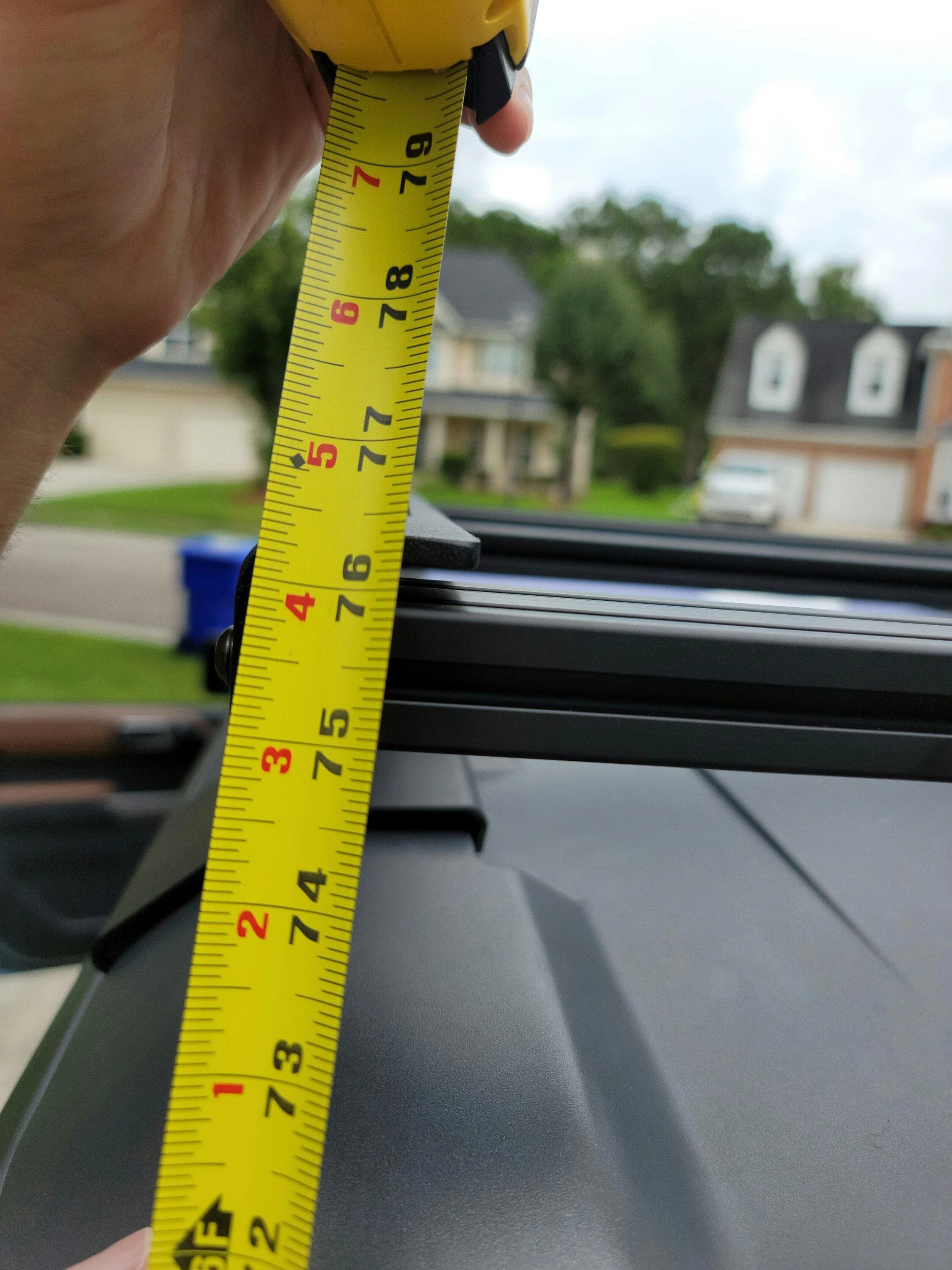

The rack adds 4.3 inches to the Bronco. The OBX was <72" high at the rear roof cap, it is now 76.5 inches, just shy of 6'5" high.
Ford Bronco Installed TrailRax "Half-Rack" on OBX 20220822_142351

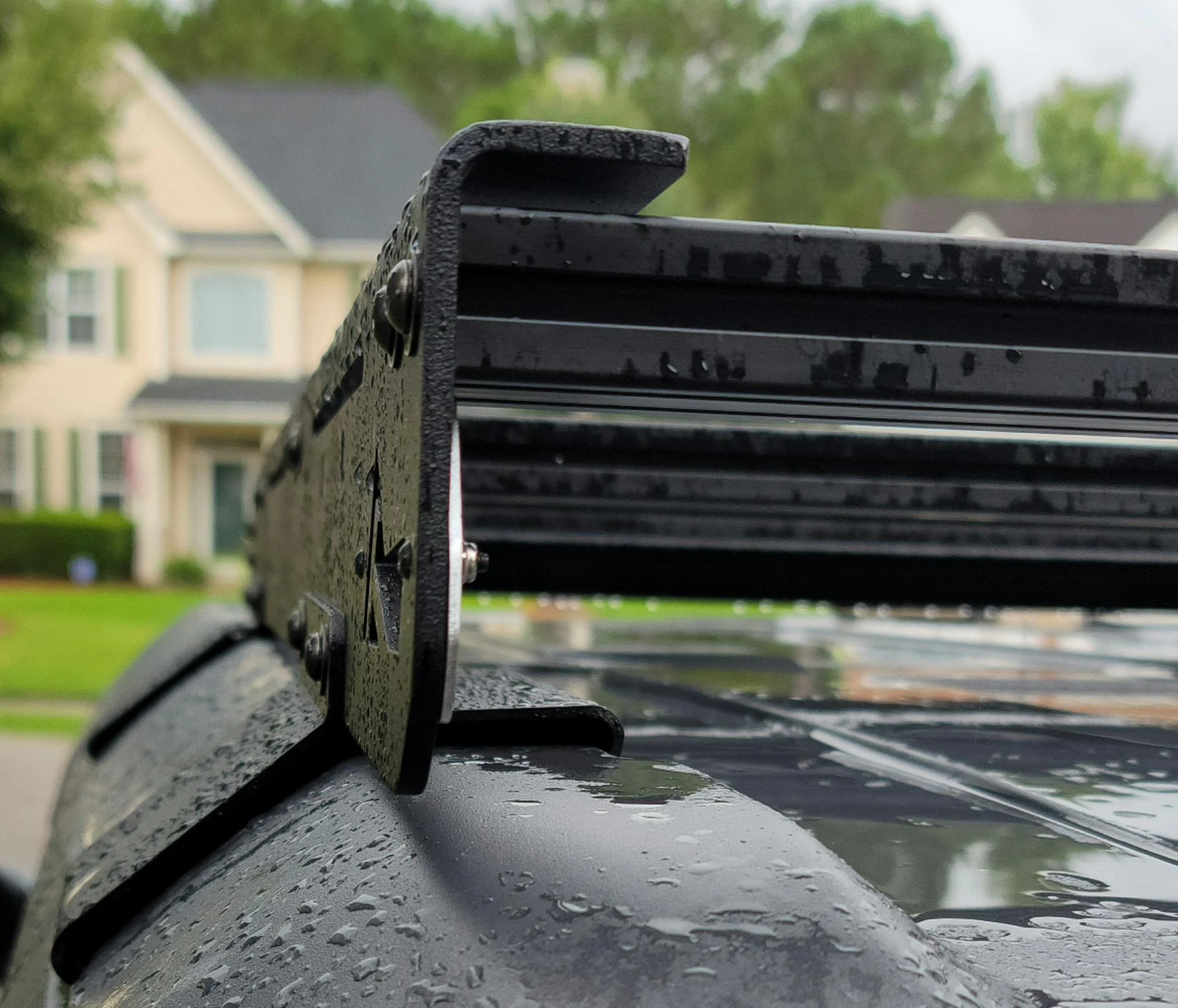

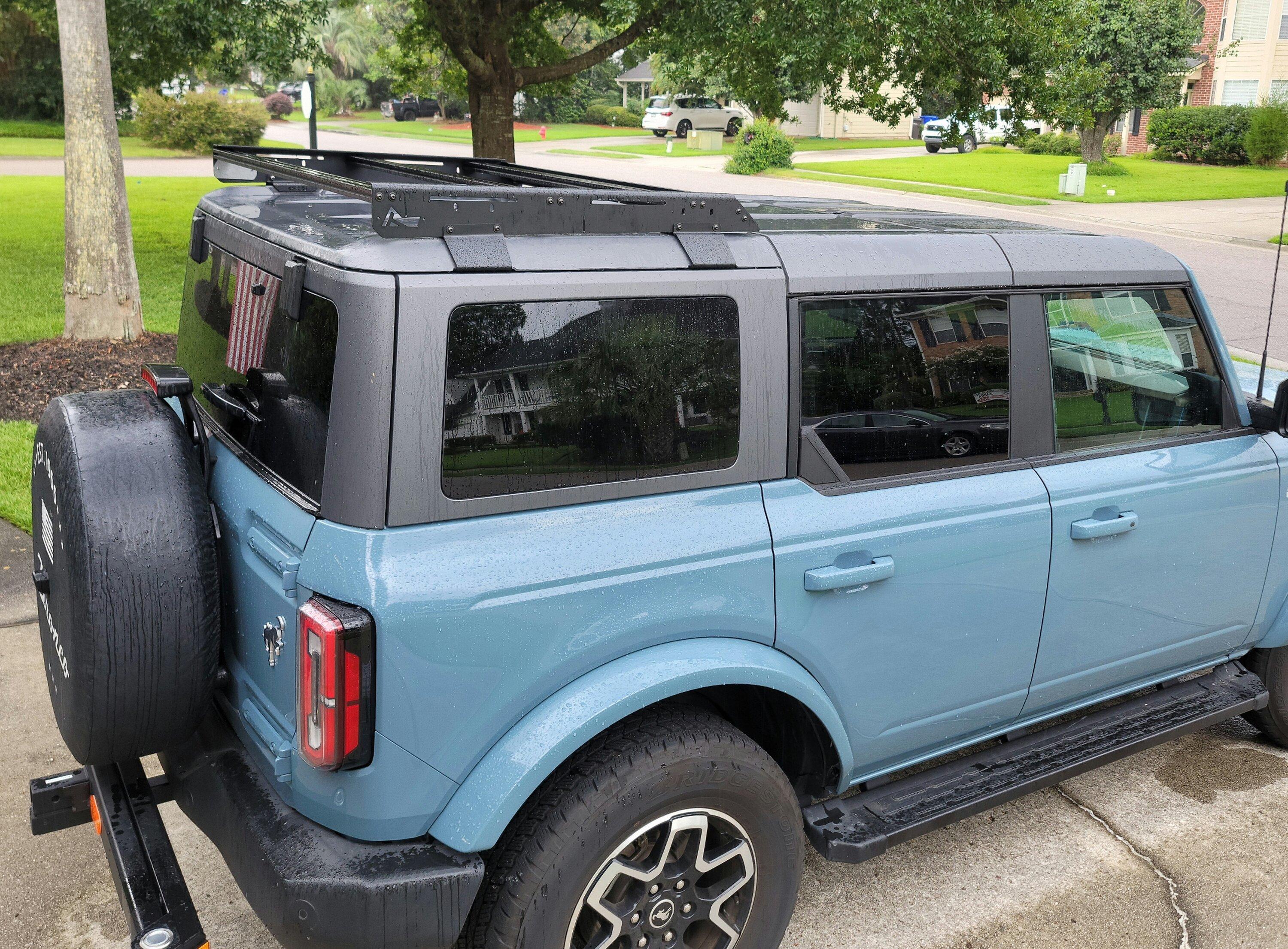

Its a bit industrial looking, but fits well, matches the MIC top finish, and clamps on strongly.
Ford Bronco Installed TrailRax "Half-Rack" on OBX 20220822_120934
A second pair of hands is a help, when reading directions, fastening dozens of fasteners, and especially when installing the rack on the roof.
Ford Bronco Installed TrailRax "Half-Rack" on OBX 20220822_142522
The air foil is close to the roof to reduce noise, but it can be removed.
Ford Bronco Installed TrailRax "Half-Rack" on OBX 20220822_140629

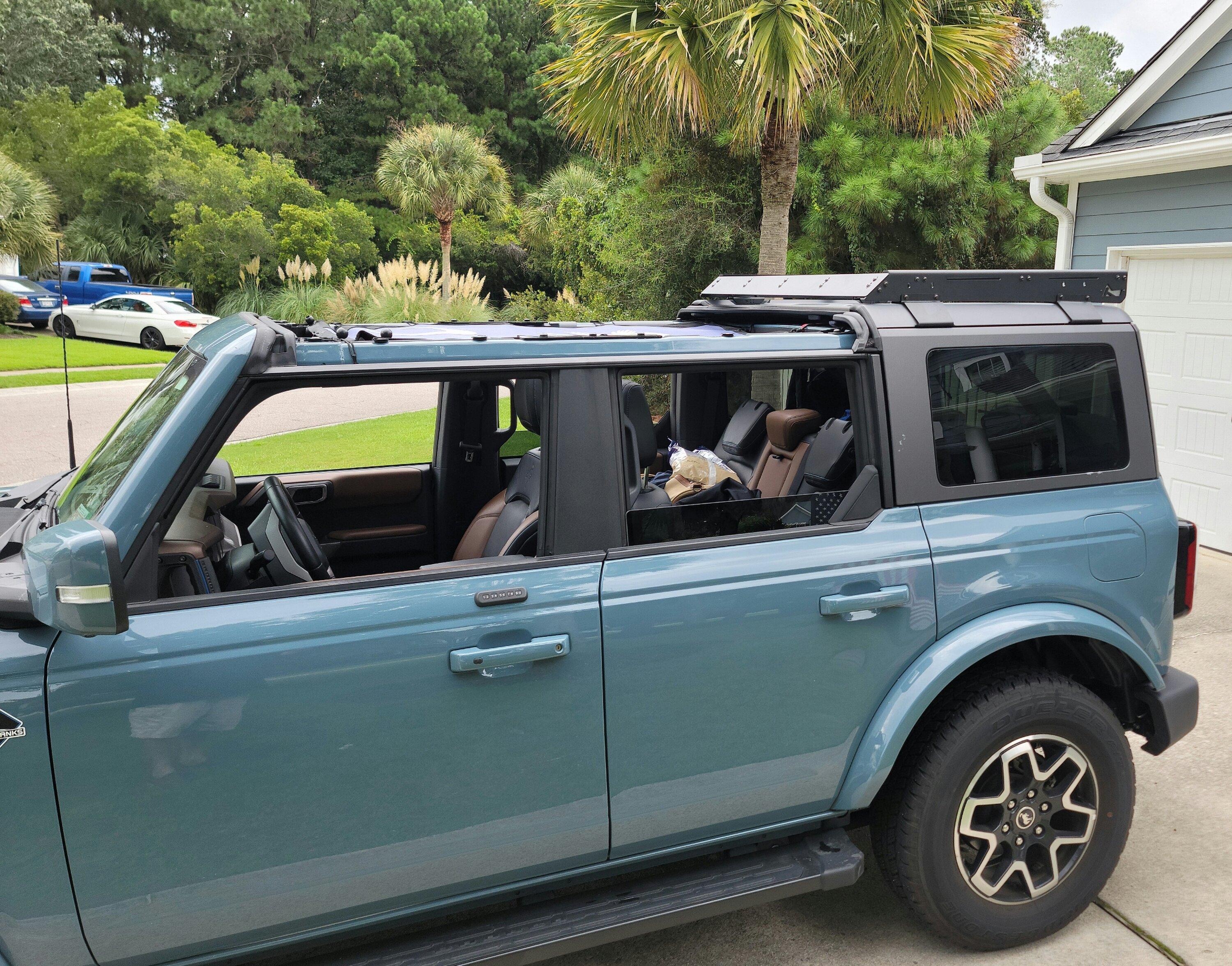

I can have an open top with three panels off, and a roof rack as well! Of course, as soon as I removed the panels to test the process, the rain started to pour . . . So some photos show rain!
Ford Bronco Installed TrailRax "Half-Rack" on OBX 20220822_135103
The middle panel removes with the rack in place, but its tight. Part of my problem is the gearshade screen. The latches can get caught in it when removing.
Ford Bronco Installed TrailRax "Half-Rack" on OBX 20220822_140520
Ford Bronco Installed TrailRax "Half-Rack" on OBX 20220822_135214
As I hoped, the TrailRax seems a perfect place to store the middle roof, if we're out on a trip on the beach. and want it off until it rains!
Ford Bronco Installed TrailRax "Half-Rack" on OBX 20220822_142538
The clamps use 1/4 inch rubber pads to provide cushioning and cut vibration.
Ford Bronco Installed TrailRax "Half-Rack" on OBX 20220822_142454

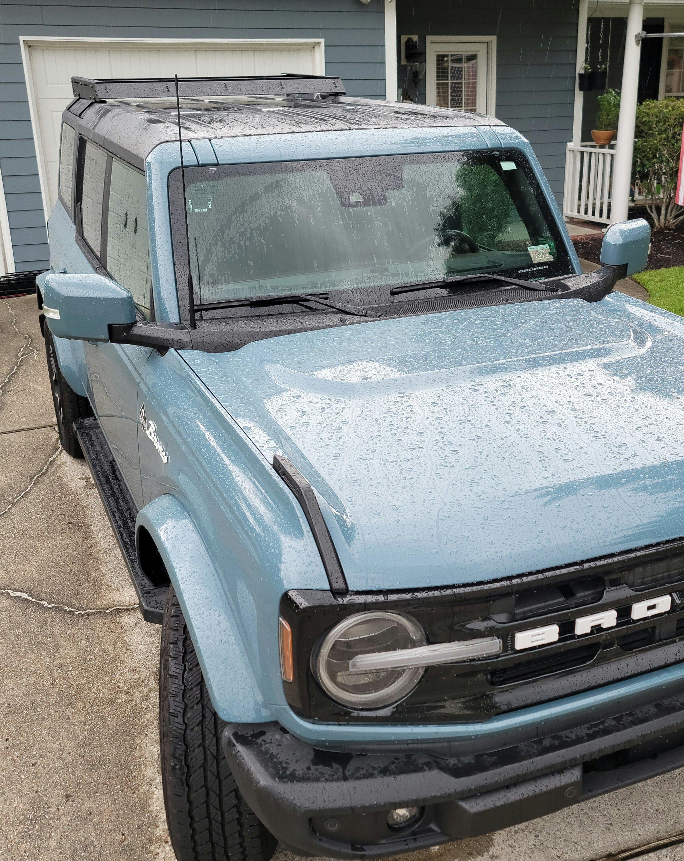

Nice profile. There is a wind deflector that the company says is designed to cut wind noise at highway speed. It does, and there is no change in MPG.
UPDATE, Wind noise & MPG, 8/24/22: before and after install, I took two nearly identical 177 mile round trips on SC state highway 17 to Myrtle Beach. About half the travel is 67mph, my cruising speed on a 60mph highway. The rest 30-50mph beach traffic. Both trips, rack on then rack off, i got an identical 23.2 mpg on my OBX. Aerodynamically, then the TrailRax has NO effect on MPG.
Wind noise, there is absolutely NO whistling or humming or vibrating from the rack. My MIC roof has had persistent background wind rush noise over 60mph since I bought it. The rack has added wind noise, I think it has added general wind noise, if I listen hard with the radio off, so that if it was a 3 before, maybe its a 5 now at 67mph, and maybe yesterday on the interstate at 75mph, a 6.
Height: The topmost part of the rack is about 76.5 inches. Even when I add 33" Tires, I should fit in most parking garages.
Ford Bronco Installed TrailRax "Half-Rack" on OBX 20220822_140754
I can add the side racks anytime, as a pair on both sides. Adds storage, and strengthens the rack adding weight capacity. The brackets go under the MIC rear shell and bolt it all down. Photo clipped from TrailRax video.
Ford Bronco Installed TrailRax "Half-Rack" on OBX SmartSelect_20220822-220411_YouTube

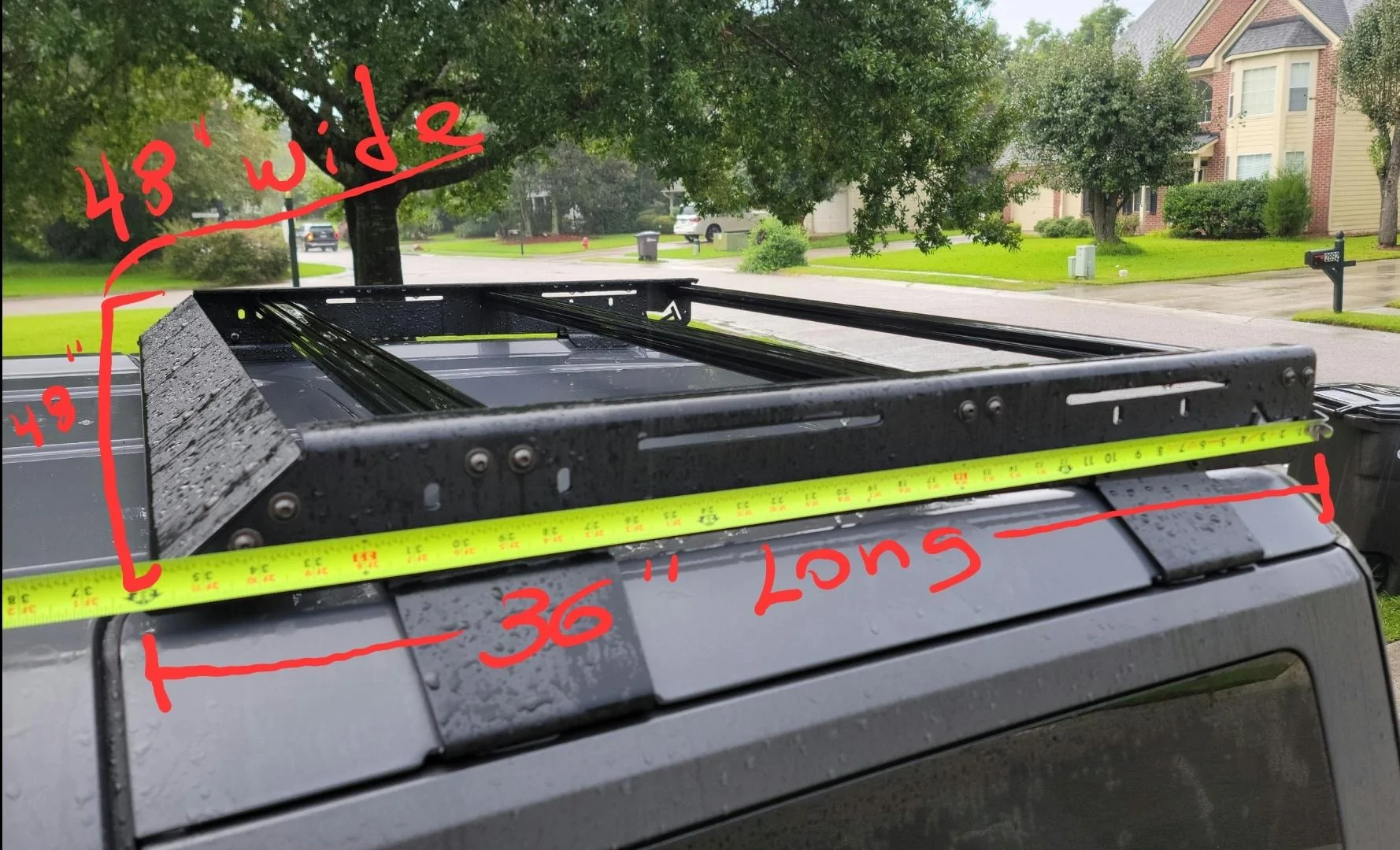

The dimensions of the TrailRax, installed: 36 inches long (front to back) and 48 inches wide (side to side), not including clamps, which are not obtrusive.

Apparently, you can now order this on Ford Accessories! 20% off!
Black_Stallion13
Dec 20, 2021
455
557
Cincinnati
Tacoma
Ford Bronco Installed TrailRax "Half-Rack" on OBX SmartSelect_20220823-153716_Chrome
I wish that were true but I'm 99% sure you don't get the attachment points shown in the picture which is the problem. The description only mentions the platform itself and if u scroll over to the 2nd pic it shows the platform mounted to a Bronco Sport with factory rack. It looks to me that Ford used their fishing concept build to snap a bunch of the accessories images on that site which sadly showcases the rear crossbars that we can't get. I did email Ford though to ask if we do order the $1100 accessory you posted will it come with the attachment points shown in the pic. Will update if I hear back!
Yes, everything you just said is why I bought the TrailRax. It exists! I cant find any description of what we're actually buying with the Ford/Yakima, including whether the attachment bars/mounts are available or included. But the link let me "order" . . . If you buy, You'd be doing a great service to Bronco Humanity!

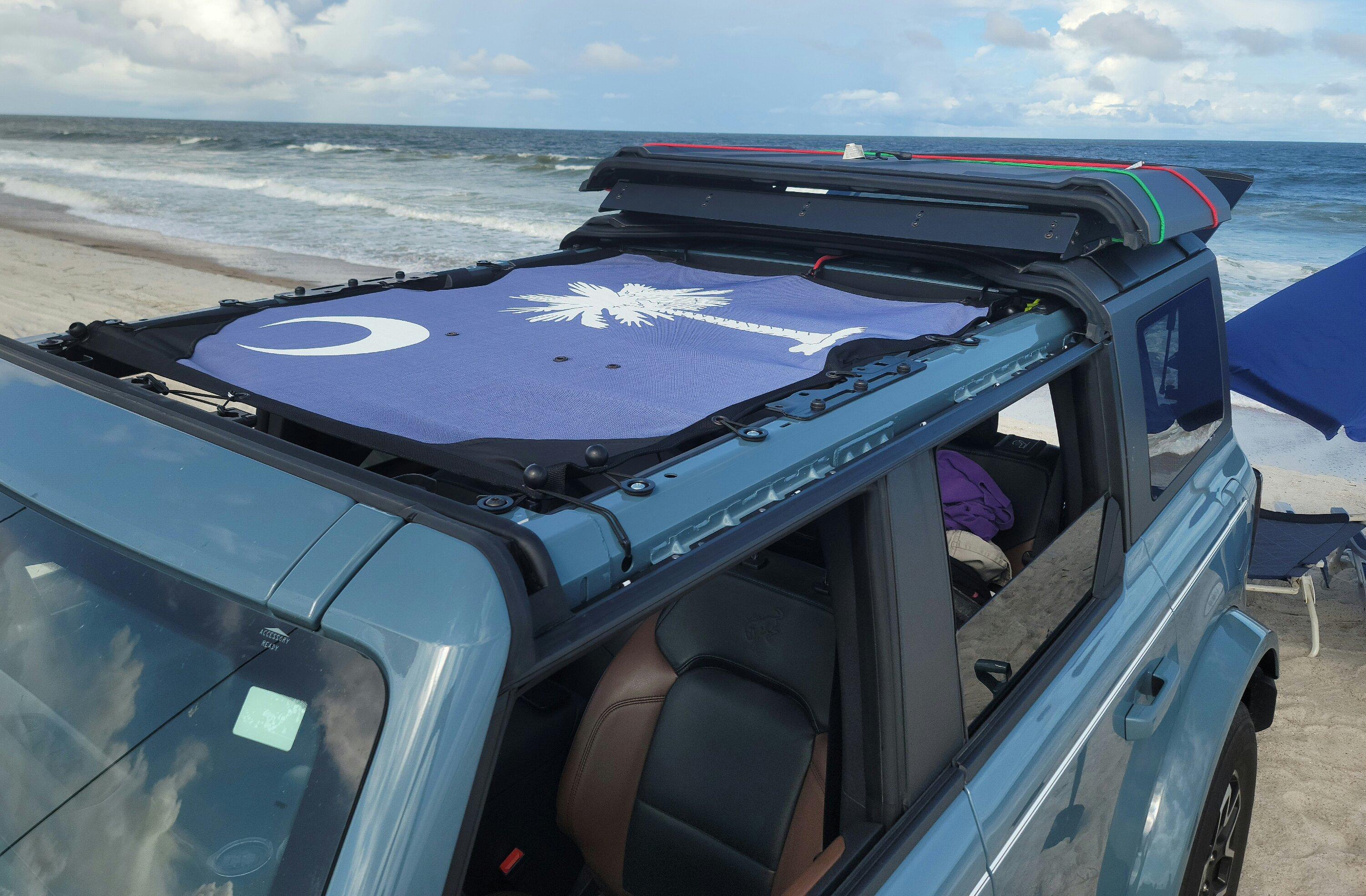

Excellent write up and photos. Curious as to how you are securing the roof panels on the roof rack? thanks.
lakesinai
lakesinai
Mar 22, 2021
1,957
2,585
Charleston SC

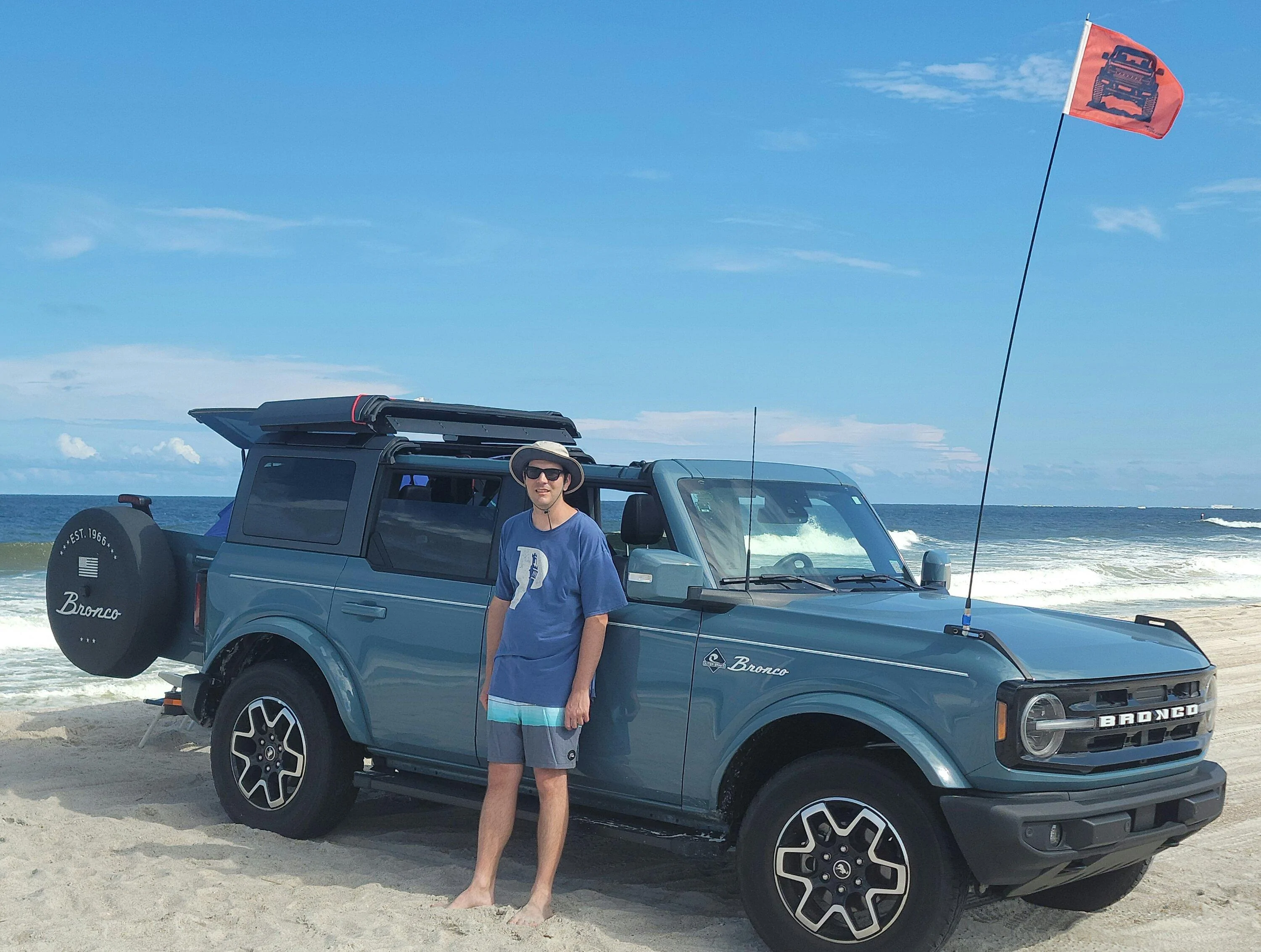

I have not tried putting the mid-panel on the rack yet, while driving on the Beach! My plan was to put it in the Ford storage bag (for cushioning), then put on roof and strap with bungie cords. In time, I may try to adapt one of the TrailRax case clamps, or similar! In my home test, it fits well! Will be on Amelia Island this Monday-Tuesday, will try! I would not do that at highway speed, however! My front panels go behind the front seats, regularly.
lakesinai
lakesinai
Mar 22, 2021
1,957
2,585
Charleston SC
Great info! I had the same thoughts with storing the front panels in the back and the Center roof panel on the rack. Nice to see it works well, now how to strap the two together
It worked well today, driving on the beach. Will work on a few more bungee or strap attachments, but the mid-panel fits like a glove on the TrailRax half-rack
