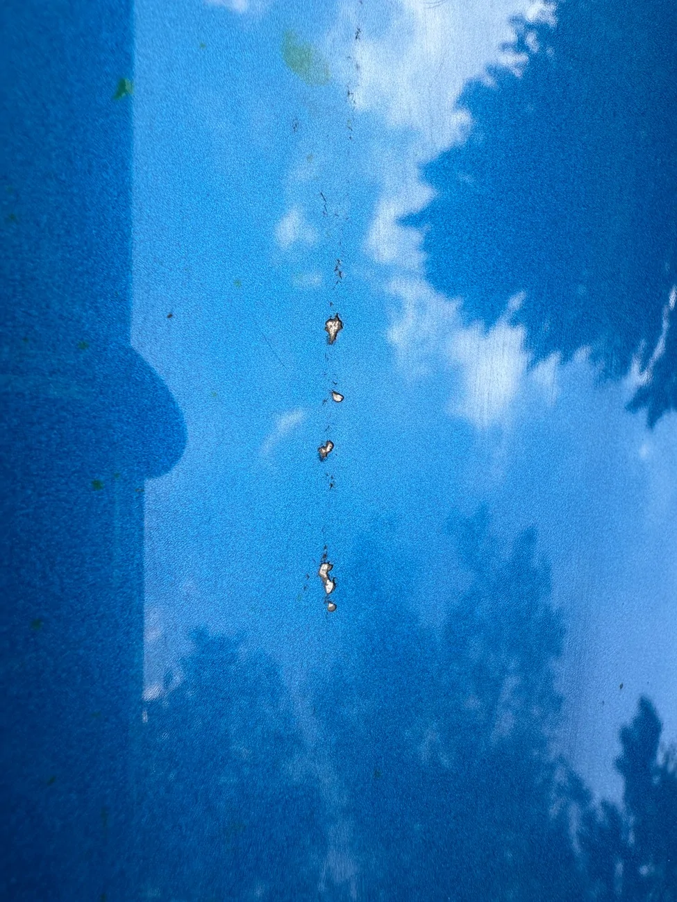

My experience is that it DID damage the paint. I bought my Bronco used and the PO installed a carbon fiber look protector/deflector. The carbon fiber got weathered and I pulled it off very carefully. This is the result!
Ford Bronco Hood protector using tape? IMG_5649
The pic is a bit misleading because the chips are very small. They were all along the outside edge of the 3M tape. I ended up installing the Ford non-carbon fiber protector and positioned it to cover the chips.
EDIT: I need to clarify. These chips were along the outside edge of the tape , NOT under the tape.

Did you use heat and/or any solvents while removing the tape? Or did you just pull the deflector straight up without cutting the tape with a wax string or floss first? Definitely need to cut the tape and then remove the tape separately from the deflector to prevent it from yanking the paint off of the metal. Paint adhesion can only be so good.
