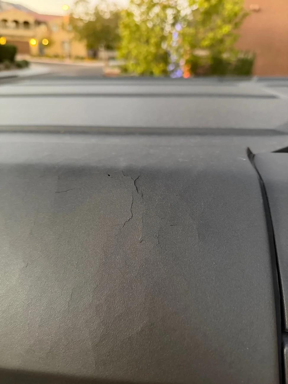

Currently have a 24 Bronco with soft top, thinking about trading it in for a higher trim level with a hard top. How common are the cracking issues on the latest models? I see videos of the tops cracking and having to be replaced only to have it happen again. Just curious to how widespread this is and if it is a big concern. Thanks
I'm telling you I believe every single MIC will delaminte/crack. I just ran out of my 3y36k and I have had 4 roofs replaced due to delamination (thanks to my dealer for working with me). This final roof was installed July 2025 and now has signs of delamintion. I've found small hairline cracks forming on the rear clamshell. I thought my issues were exacerbated from automatic car washes, but turns out that didn't matter with this most recent MIC roof since I only hand washed it once. I'm more curious if the painted hard tops will start to crack/delaminate

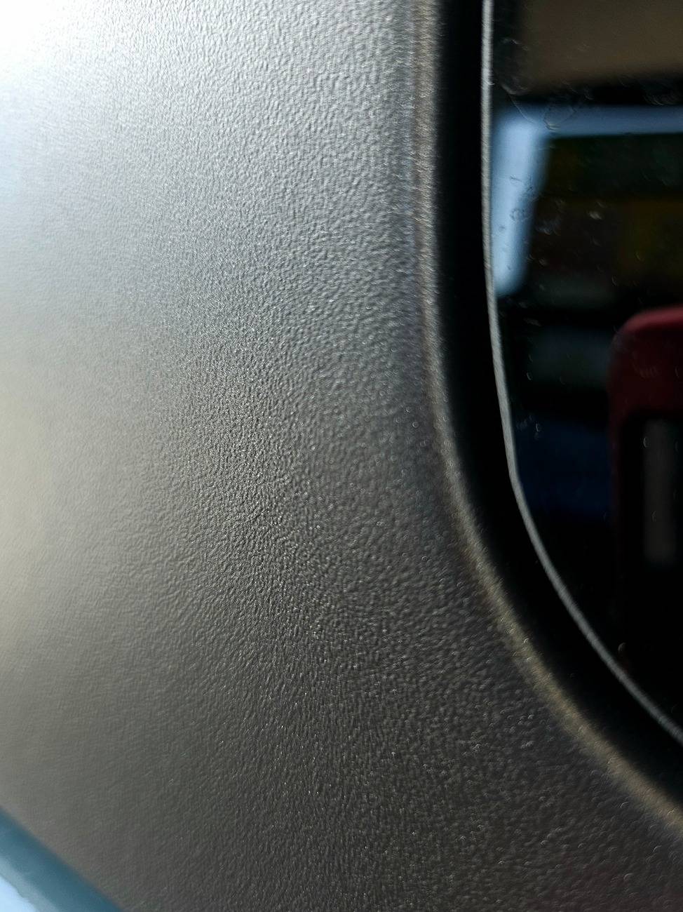

Just brought my 2025 Raptor in yesterday with same issue. Only 4100 miles on it
Let’s see what Ford does for me.
