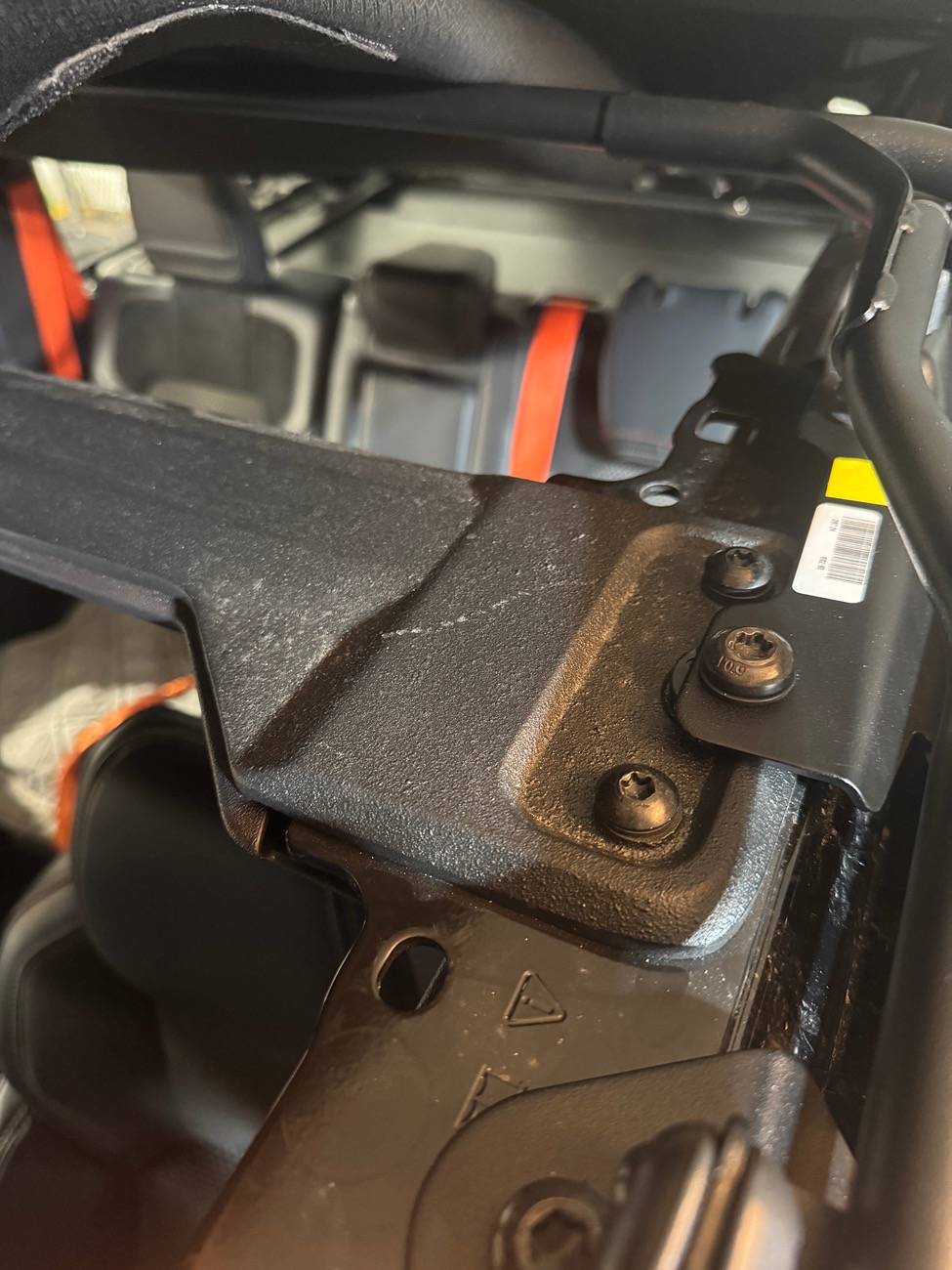

I have the oem soft top on mine. I wouldn’t call it an easy swap. But I do it each winter/summer. I have a ceiling mounted hoist that makes it a tedious 1 man operation. Even more tedious if you also have the oem Tuffy storage because that has to be disassembled to do the swap. If you have 2 people, install is much easier.
Ford Bronco Install soft top on Raptor IMG_0369
Ford Bronco Install soft top on Raptor IMG_1154

do all the rails along the top have to be removed before reinstalling the hard top?
HeliPilot
Kenny
Dec 17, 2021
1,717
3,624
CT
2022 2.7L SAS
I remove none of the hardware when I swap back to my hardtop. Though, I do adjust my front (windshield) latch plates when I swap, as the alignment pins from each top hit in slightly different places. I’m sure I could adjust that out somewhere else, but those two latch plates are the easiest to access.

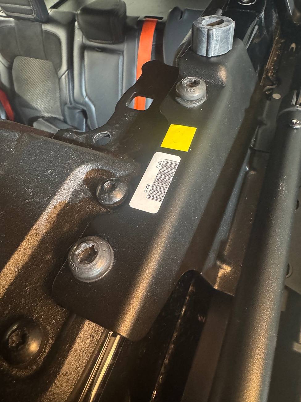

@Brian_B & @HeliPilot How did you mount the Main Pivot Brackets and Rear Door Rails? Did you mount the Main Pivot on top of the Raptor b-pillar support brace or under it? This seems to be keeping the Rear Door Rail from lining up with the Front Door Rail.

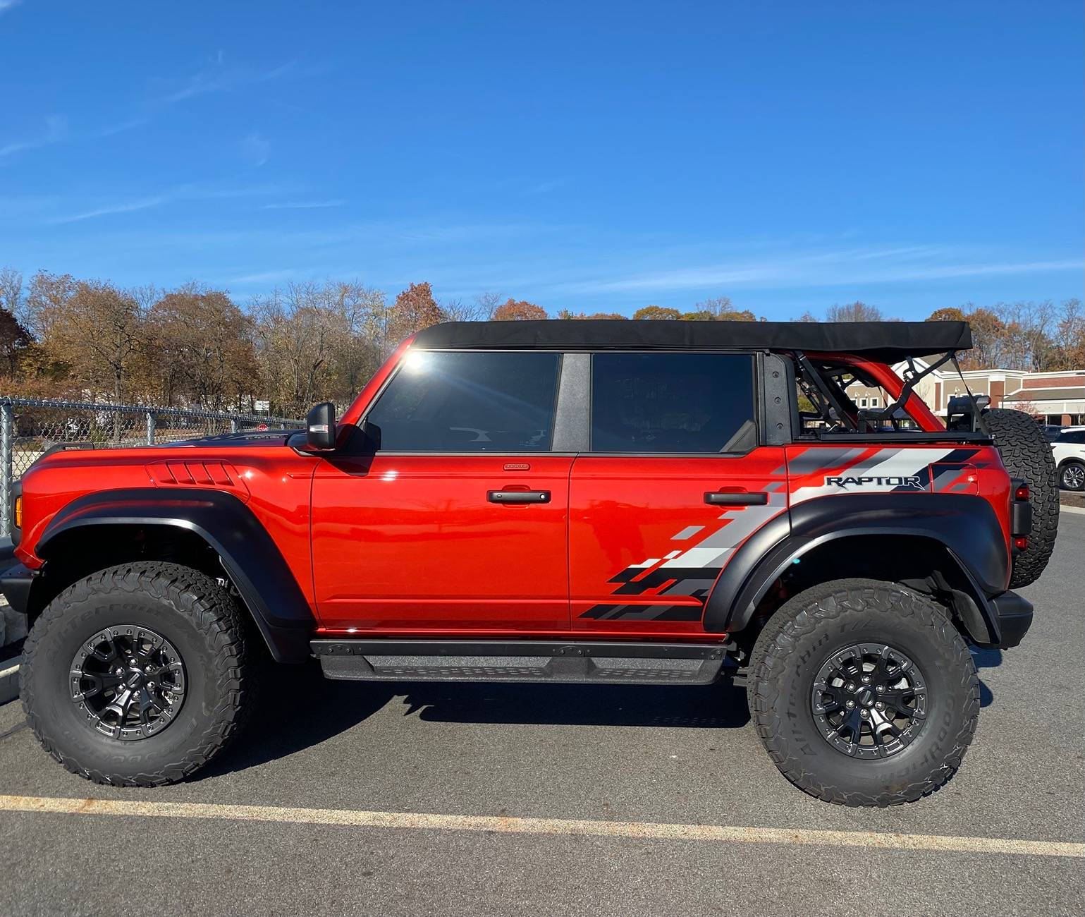

funny thing, passed by a braptor with a soft top on, looks very convenient for the summer!

did you have to remove the b-pillar center cross brace to install the Main Pivot Bracket under it or did it just mount on top of the cross brace?

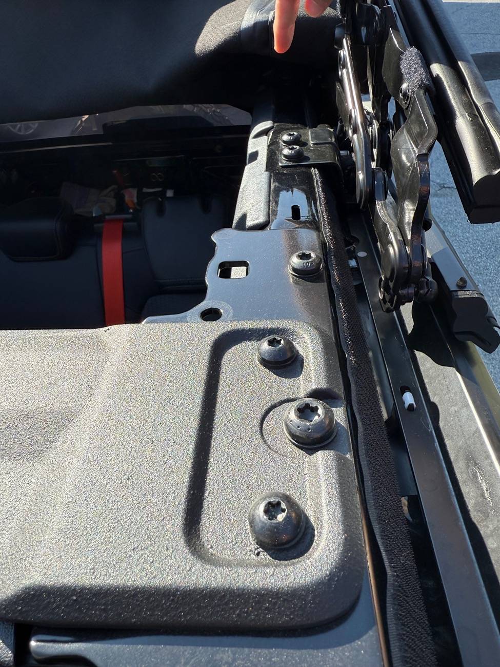

Perhaps you can post a pic to illustrate exactly what you are referring to because the nomenclature is confusing. The brackets on the roof (M2DZ-78515A53-B & M2DZ-78515A52-B known commonly as the brackets on the roof simply bolt onto the roll cage above the passenger door - no braces need to be removed. I hope this helps.
Bschurr
Jan 28, 2021
1,816
4,168
NY
Here is a pic from the front of the vehicle looking toward the rear. My finger is pointing at the mounting location of the bracket. (It’s waaaaay behind the center cross bar - like the center of the rear door)

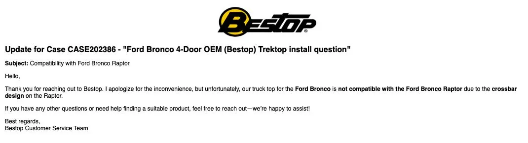

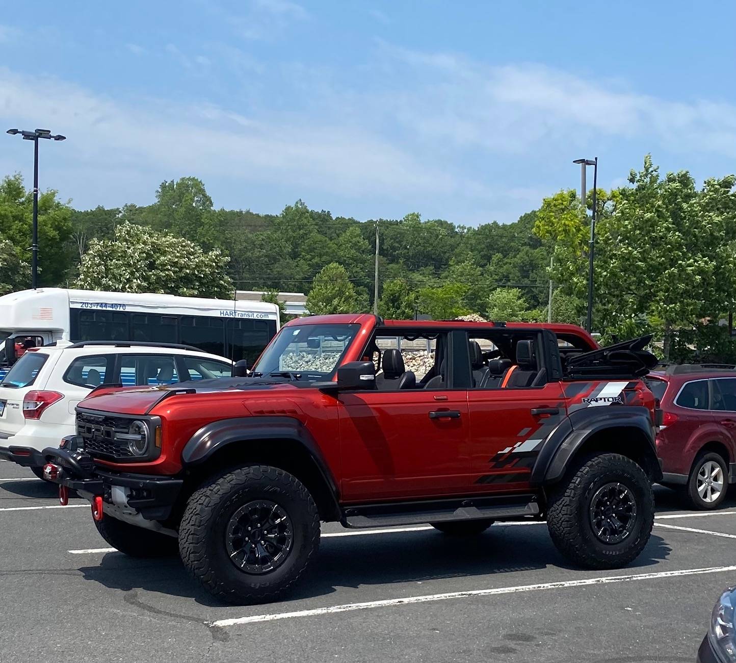

@Brian_B & @HeliPilot I'm starting to think we've got different soft tops... I contacted Bestop (maker of the Ford OEM soft top) and they responded that their's doesn't fit the Ford Bronco Raptor specifically because of the center crossbar.
The soft top I bought from my local ford dealer is Trektop for Bronco 4-door (part 56873). Are you guys using a different soft top?
