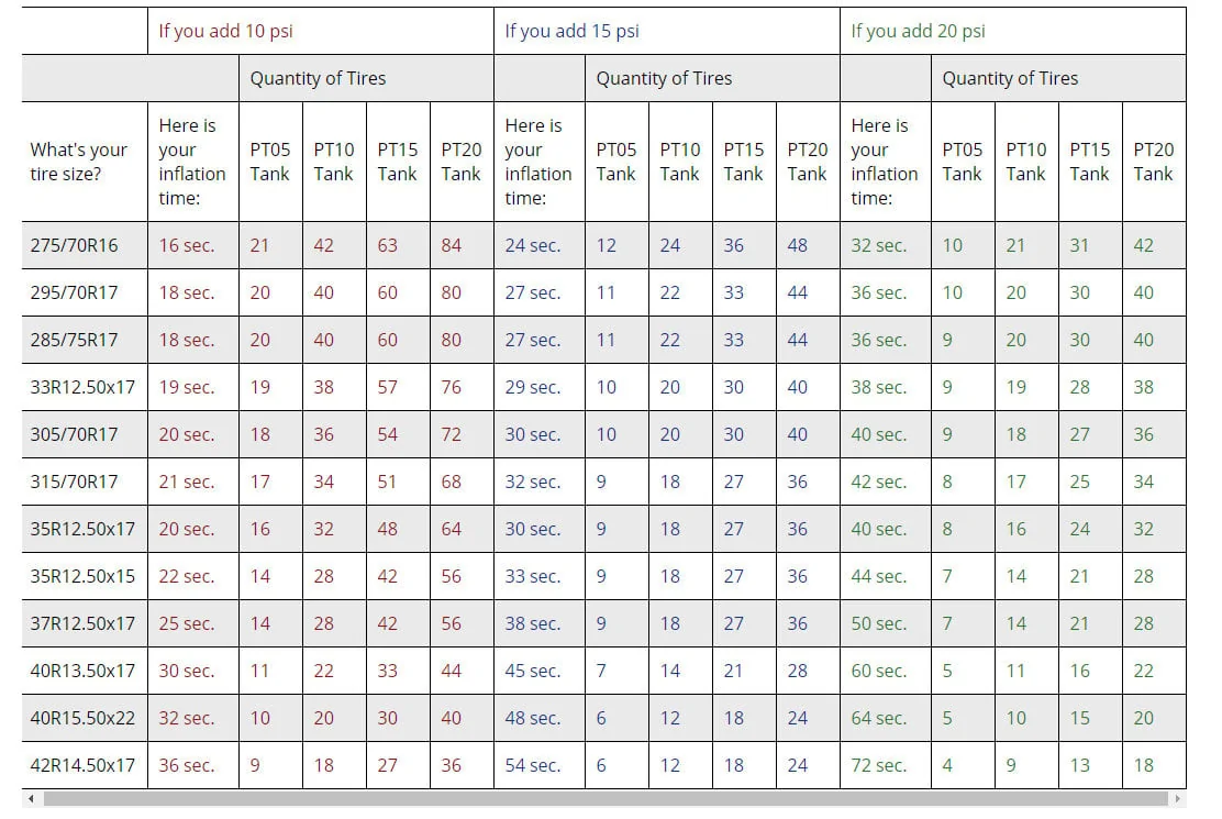

Sorry @dgorsett , missed your reply/question. Your missing a key thing about CO2 tanks and how they differ from say a SCUBA tank.
The vast majority of the CO2 in such a tank is liquid (a tank designed for 1000 psi)!
The space above the liquid is C02 vapor. A "full" tank is about 2/3 liquid. The vapor pressure at "room temperature" is about 850 psi. Oddly, there is an equilibrium pressure between the vapor and liquid that maintains that same pressure as long as there is any liquid in the tank. It's called the phase equilibrium pressure.
If you used a tank&gas system where the gas didn't coexist with its liquid phase the situation would be very different. You could then use the ideal gas equation PV=nRT. That would apply to your specific question.
If you happen to be interested in how many tires a CO2 tank can fill, this chart courtesy of Power Tank gives tons of data.
Ford Bronco Installed Aeroflow CO2 Tank Brackets Power Tand Air Tool Use chart (002)_10
