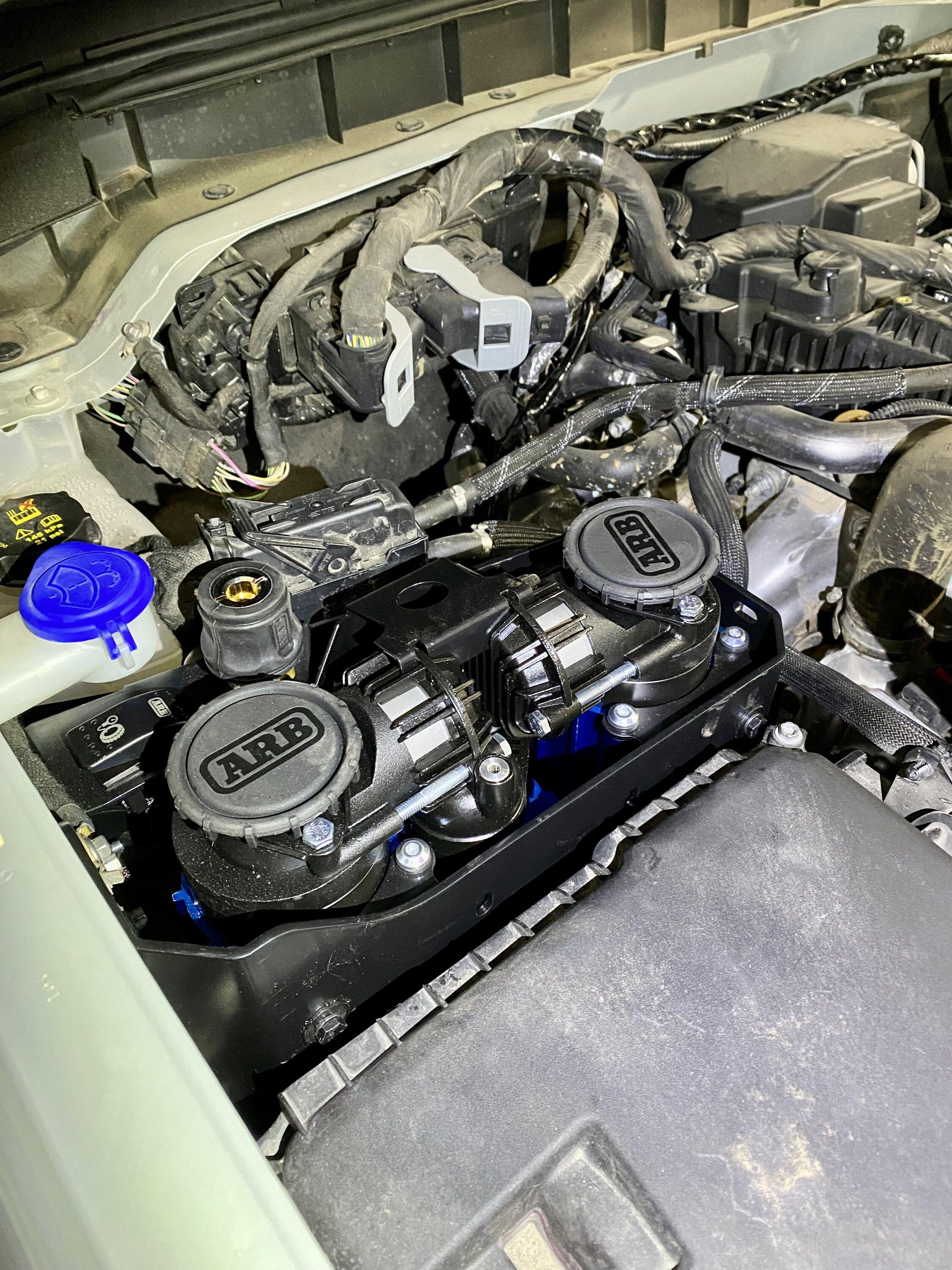

TL;DR is that the Grimm ARB Compressor Bracket is quality and I like the vertical placement, however, I don't think it was tested in the 2.3 engine bay. In the end, it worked out, but took a lot longer than it should have to install.

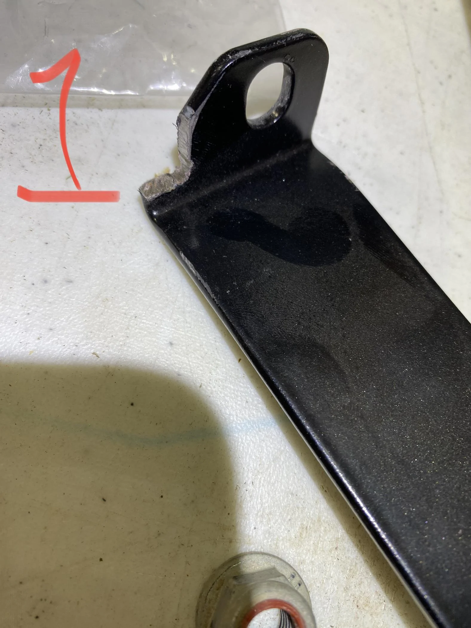

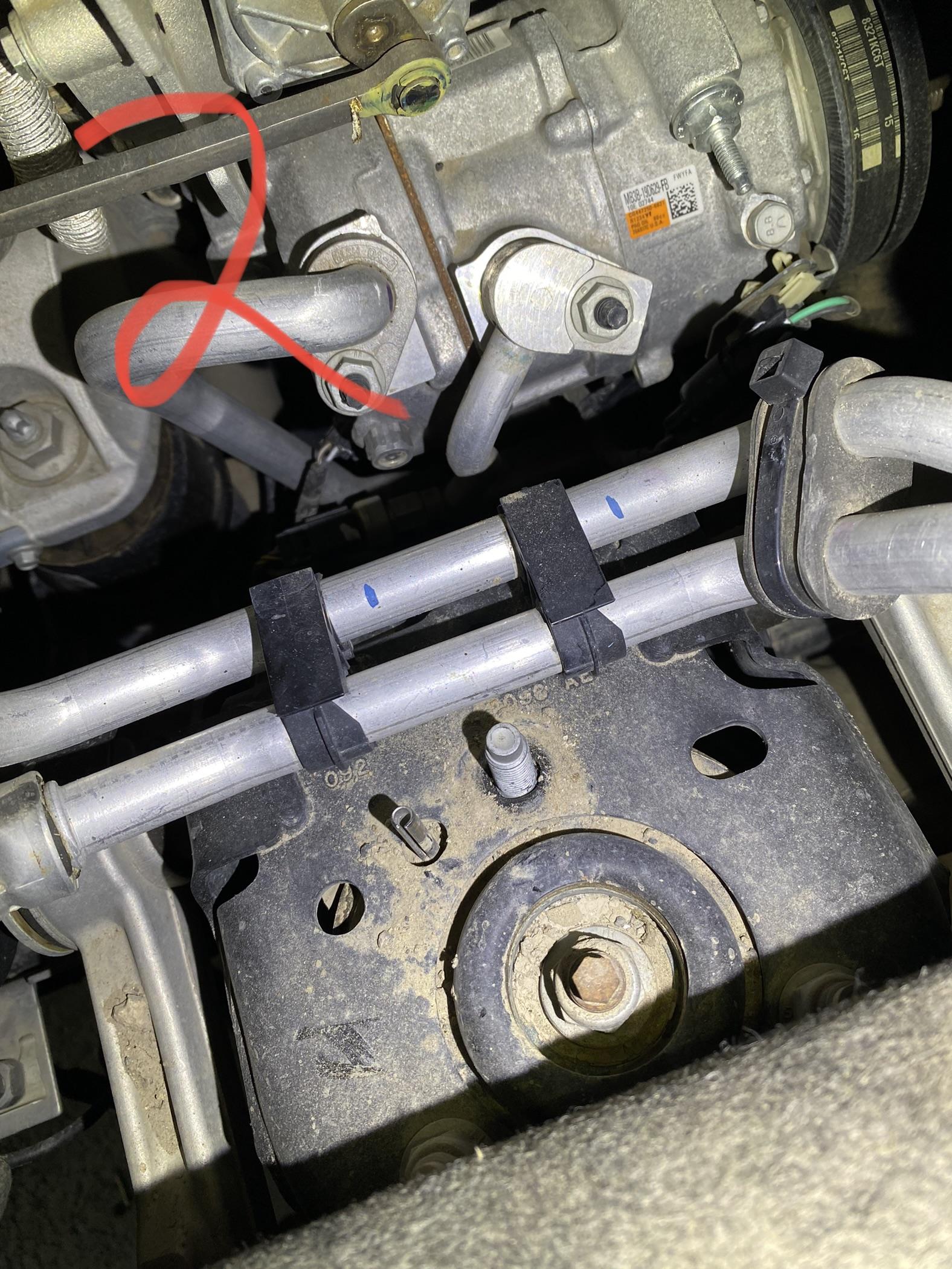

Heads up that I installed the mount last night on my 2.3 Badlands and I don't think it was designed for the 2.3 engine as it doesn't fit without modification. There's two hard AC lines that run right where the lower support brace is supposed to mount to the shock tower. I had to re-bend the brace, grind down a couple of spots and mount it in reverse to get it to fit. [1] [2]

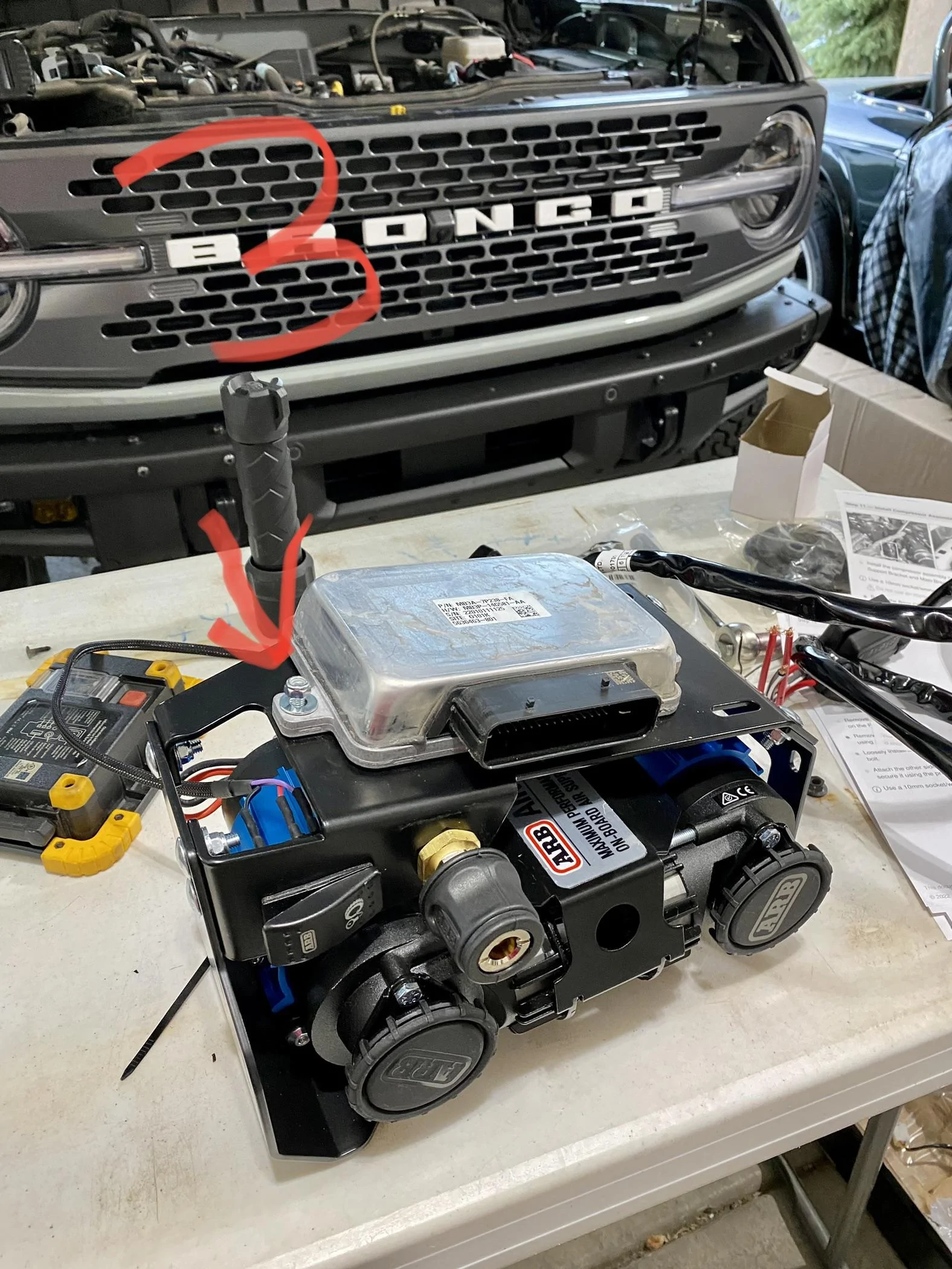

Additionally, the bracket and/or directions should be modified to make it easier to mount the upper support brace to the PCU. Ideally, put a captive nut on the bracket so you can insert the bolt from the PCU side. That was a horrible experience trying to get that brace installed without pushing the bolt back behind the bracket. At the very least, maybe alter the directions to loosely secure the brace to the PCU prior to mounting the assembly in the Bronco. [3]

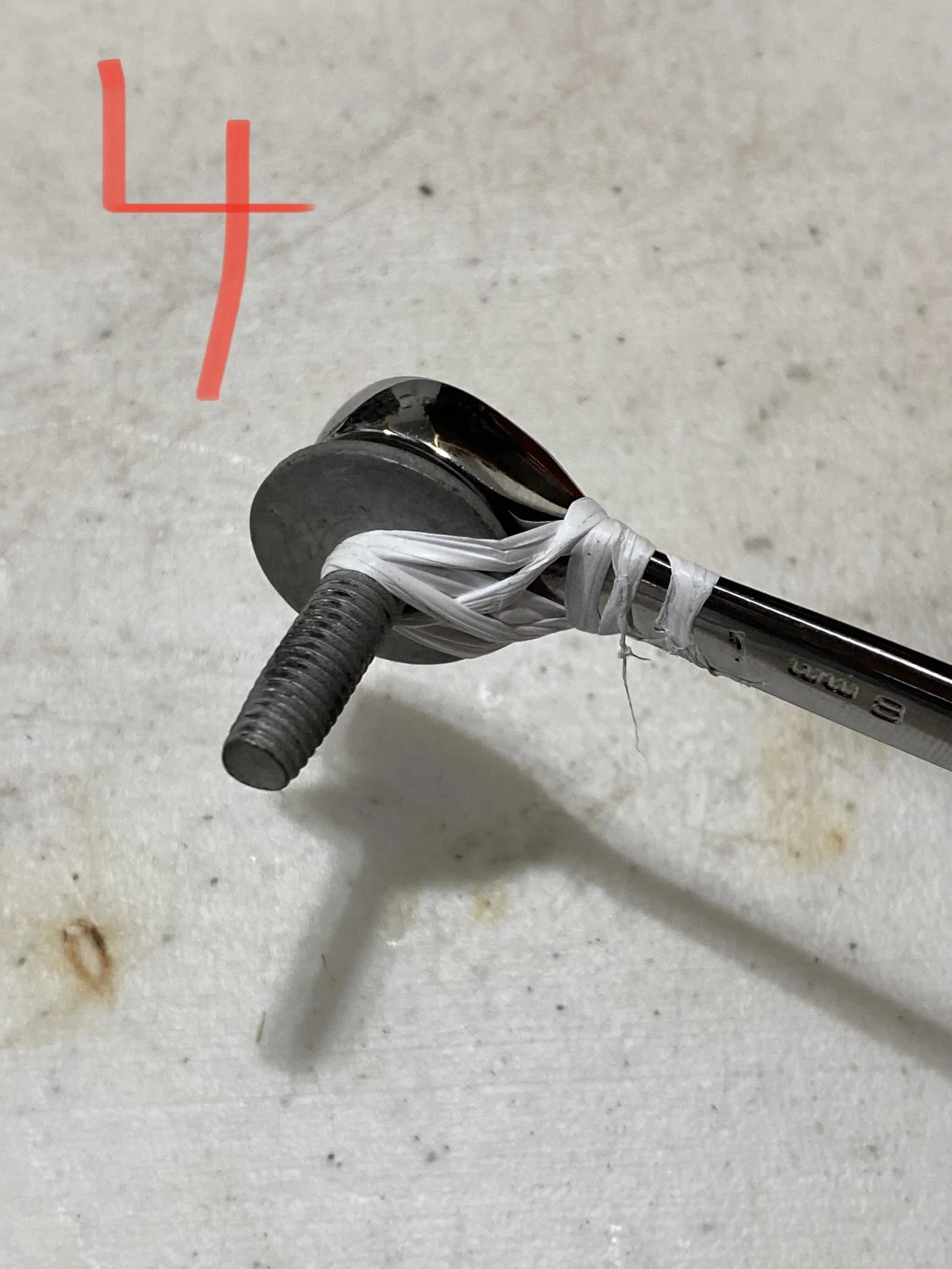

Lastly, the lower of the 3 bolts that mount the entire assembly to the Bronco sidewall is near impossible to get to. I'm not sure how you can make that easier, however, I had to rig up a method to hold the bolt into my wrench to get the threads to bite. [4]
In the end, it took about 3 hours, with most of my time modifying the lower brace and trying to get the side brace attached to the PCU.
