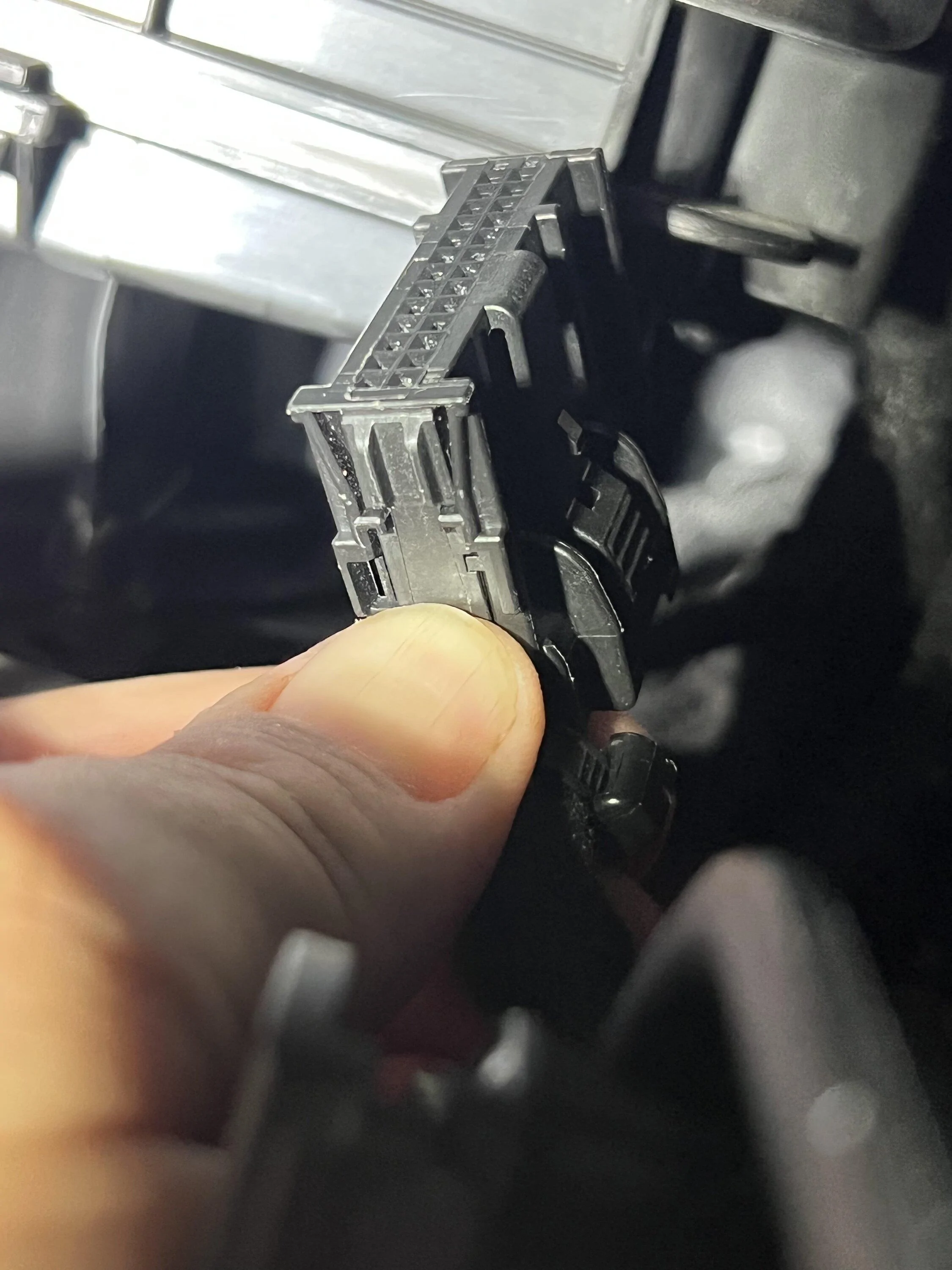

The hard plug can be reached if you have a set of small hands available while mounted. Posting a pic of the plug. Not sure if you can get zip ties on it while still mounted.

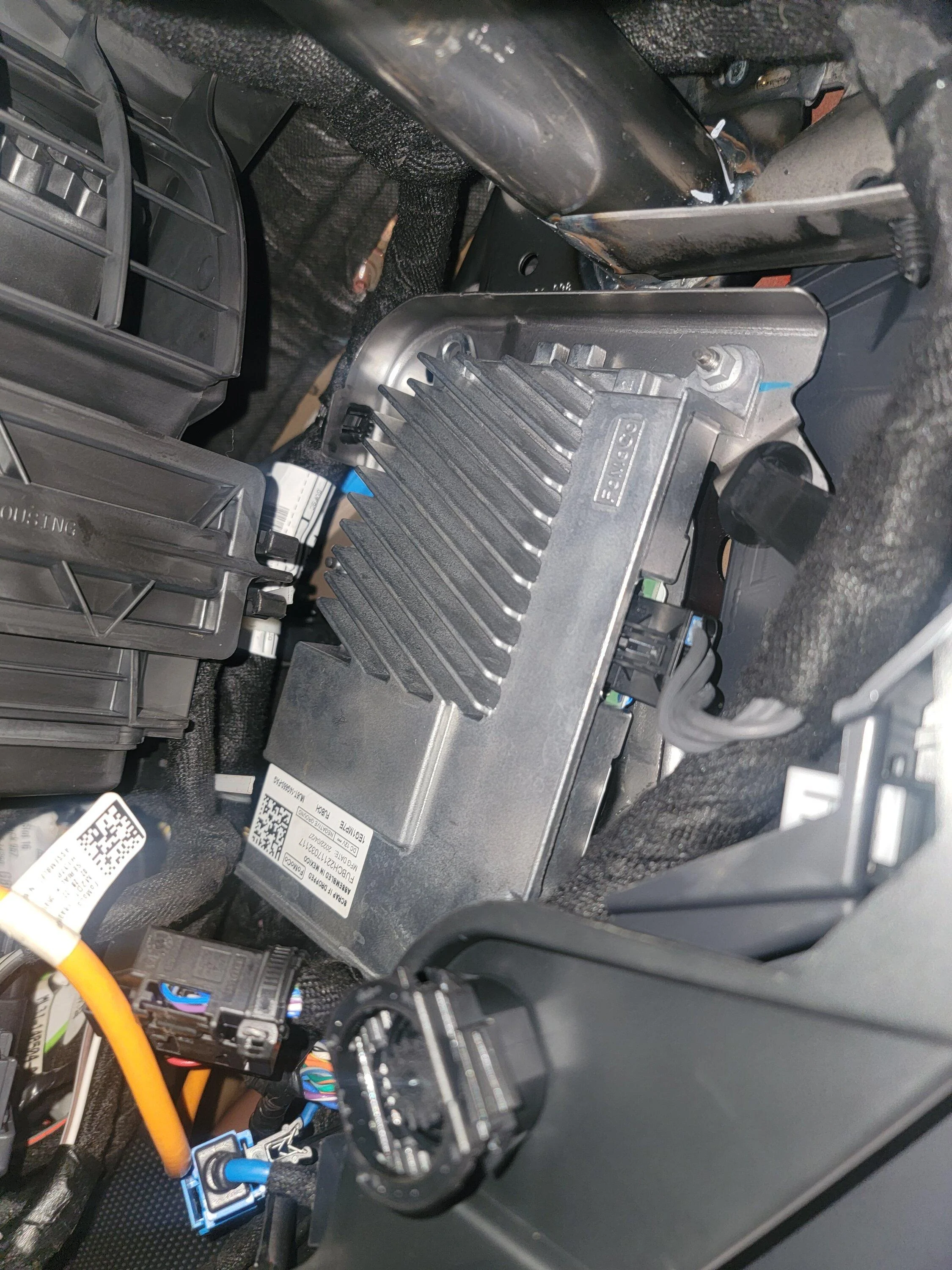

Well I went to turn up the sensitivity knob and this is what I see. The original module in mine looks different than O/P but nowhere is the enhance module under the dash. Im friends with the owner so hes a little upset if they charged me the install and never installed it. Unfortunately for them i tested the unit and it didn't even seem to work. So i went to adjust the sensitivity and found the tech never put the module in. If there was no module to install, why charge me for it. I told my friend(the owner) that I'm not dumb but if I was some average person that didn't ever look I woulda been screwed out of $235 for the module and install costs.

Well I went to turn up the sensitivity knob and this is what I see. The original module in mine looks different than O/P but nowhere is the enhance module under the dash. Im friends with the owner so hes a little upset if they charged me the install and never installed it. Unfortunately for them i tested the unit and it didn't even seem to work. So i went to adjuat the sensitivity and found the tech never put the module. If there was no module to install, why charge me for it.
That silver device is the existing module that the perimeter plus plugs in line with. I don’t see the perimeter plus module in your picture.
They could have placed it somewhere else. Check the cable at the bottom of the silver module to see if there’s a T cable in line and if it goes elsewhere. It is hard to get to though.
I pulled the lower kick panel and the rubber flooring and I can't find it anywhere but I'll check a 3rd time

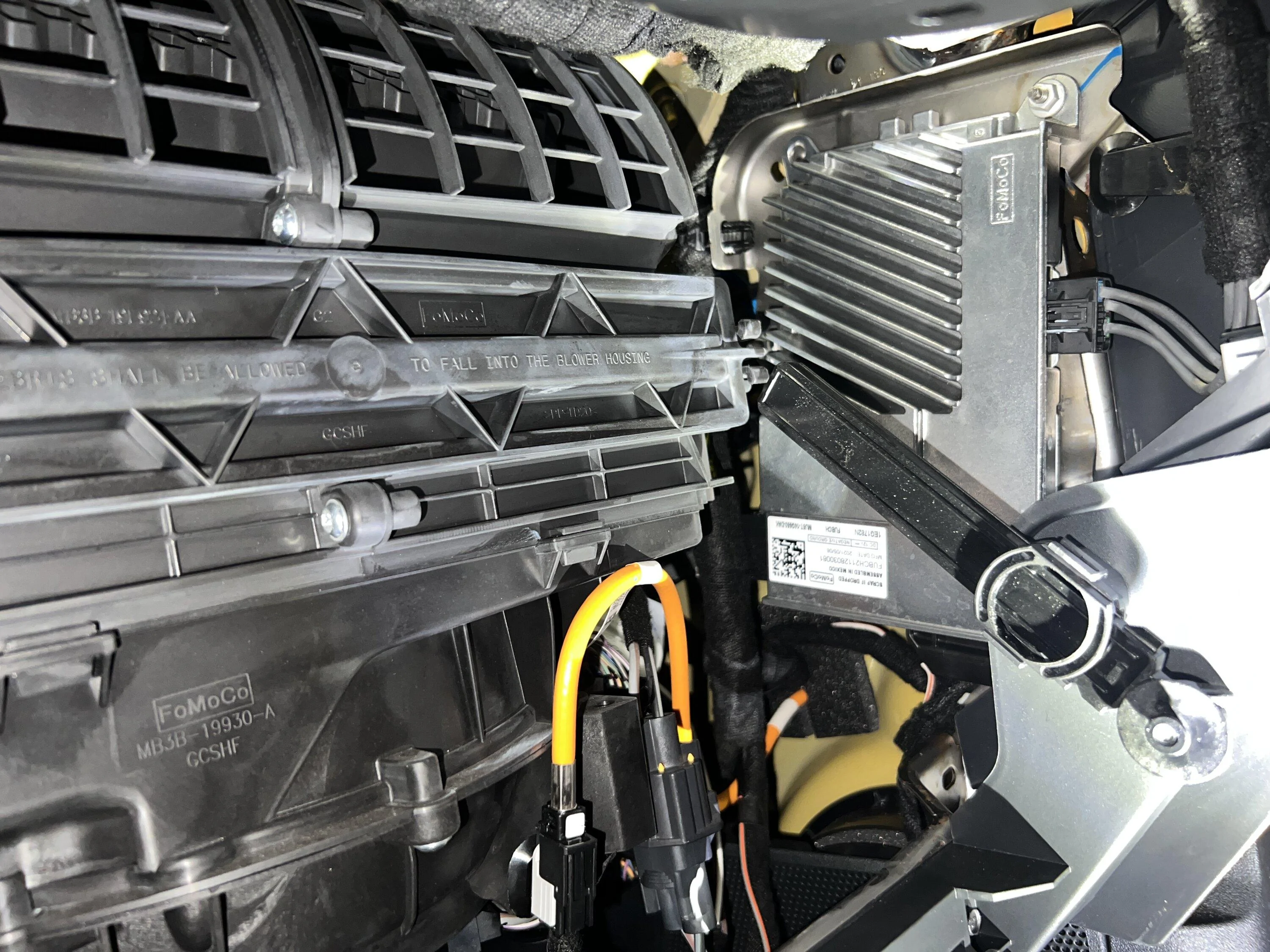

It looks like the plug for the module does have something connected to it. Follow the wires to see where they stuffed the perimeter plus module.
For reference here’s mine before install.
Ford Bronco Installing the Perimeter Alarm Plus — DIY How-To Writeup 54744AE4-9C4F-49CF-AF49-FE21EC552FEE
Ford Bronco Installing the Perimeter Alarm Plus — DIY How-To Writeup A75967E1-BD87-4DDE-9DA7-CBF8B211FC3F
Different angle, but you can see the connection on the bottom. Yours appears to be disconnected and off to the side with possibly the perimeter plus module harness connected.

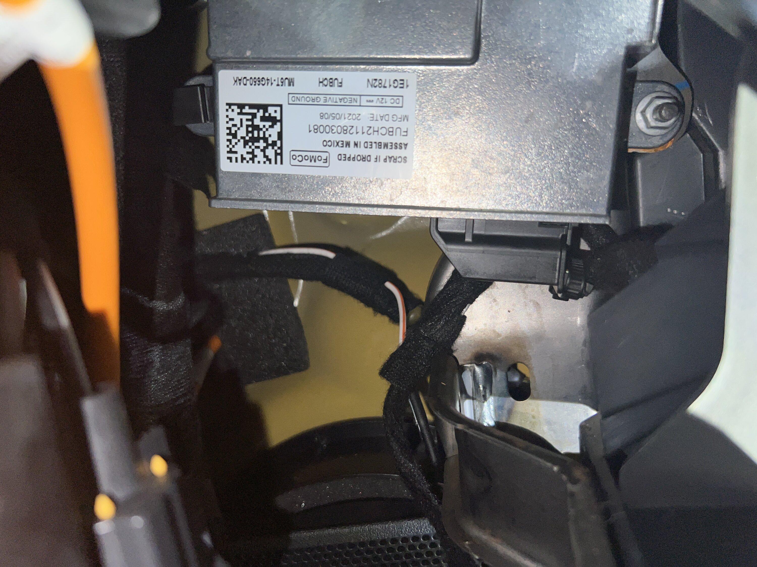

You're 100% correct I checked again and thr module is tucked way up where the firewall is up past a bunch of other wires and not visible
Can you get a picture of it? Curious where they put it. I just zip tied mine to a dash frame tube but think it’s not as sensitive as it should be there.

I pulled it out and am gonna mount it where the o/p put it. Turning sensitivity up is definitely clockwise. Counter clockwise is where it was at and barely did anything. Now it works.
