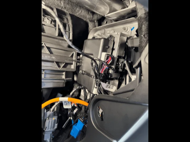

I did this upgrade today. It was very easy so far as the plug n play part goes, but getting that module out was a PITA. No room to maneuver and difficult to get into a position to remove the 3 nuts. I didnt add the LED yet, but will do next time I have the bronco under the knife. I have a trailer brake controller to install next.

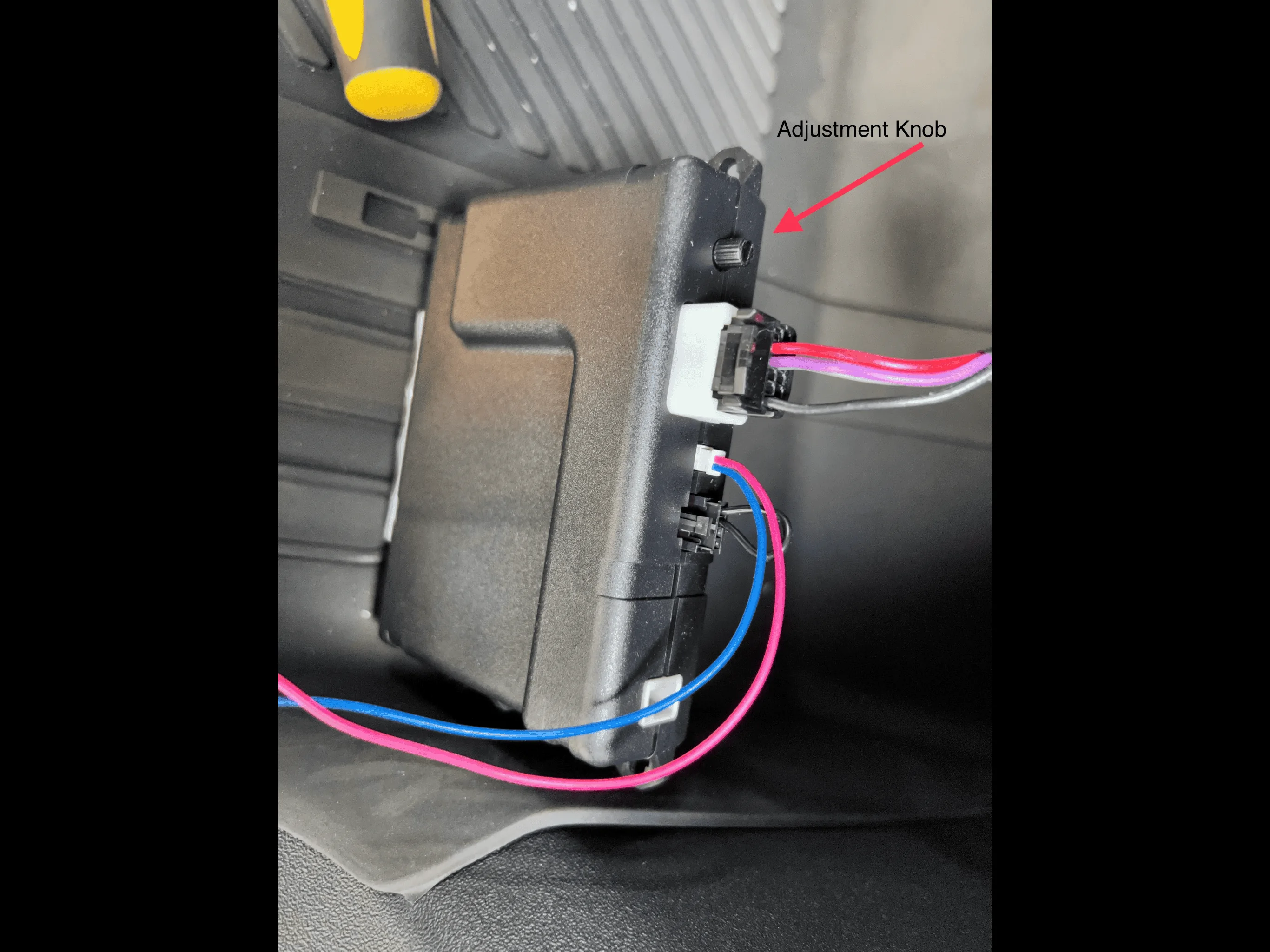

Great post. Thank you! I have one on my 21 BadSquatch and I need to adjust the sensitivity. It goes off in parking garages (while I’m on the plane🤦🏼‍♀️), and if a loud motorcycle or truck goes by.
I have seen it in the glove compartment area.
So you know how to adjust it?

I have the perimeter plus. My neighbor just had her catalytic converter stolen. I turned up the sensitivity just in case.
Then it stormed the next day and thunder from a lightning strike a couple blocks away set it off. :)
Just for reference, you can temporarily bypass the shock sensor by clicking unlock 3 times then lock. It’ll honk twice to indicate shock is bypassed. It will turn back on after cycling the ignition on and off once, so isn’t persistent.
You can? Wow! How did you learn this? I would like to know how to adjust the sensitivity and anything else I can about it.

When looking right at the knob, clockwise for more, counter-clock wise for less.
Thank you sooooo much. It’s so sensitive and goes off way too much.
