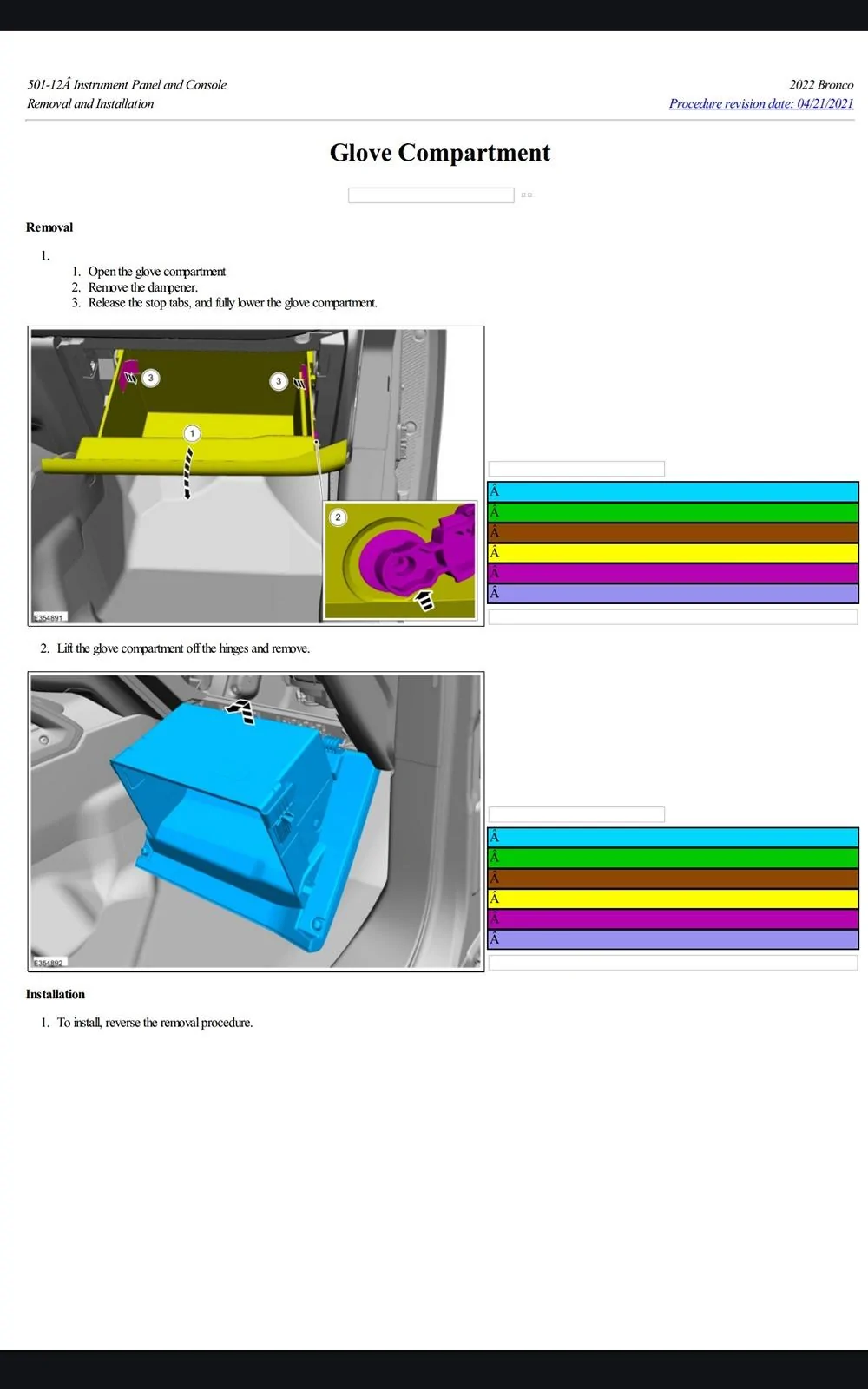

So.... the glove box dampner, just pull on it and it comes out?

So I found this, but what exactly do I need to do so I dont break anything?

Squeeze the sides until it drops down. Then just give it a soft pull down and it will disconnect. I can record a video after it’s done getting washed from our off-road weekend.

This showed me, thanks.
I probably would have pulled that inside tang off that holds it to the glove box
I broke the hell out of mine. It still closes fine and stops at some point that it doesn't spill all over, so whatever.

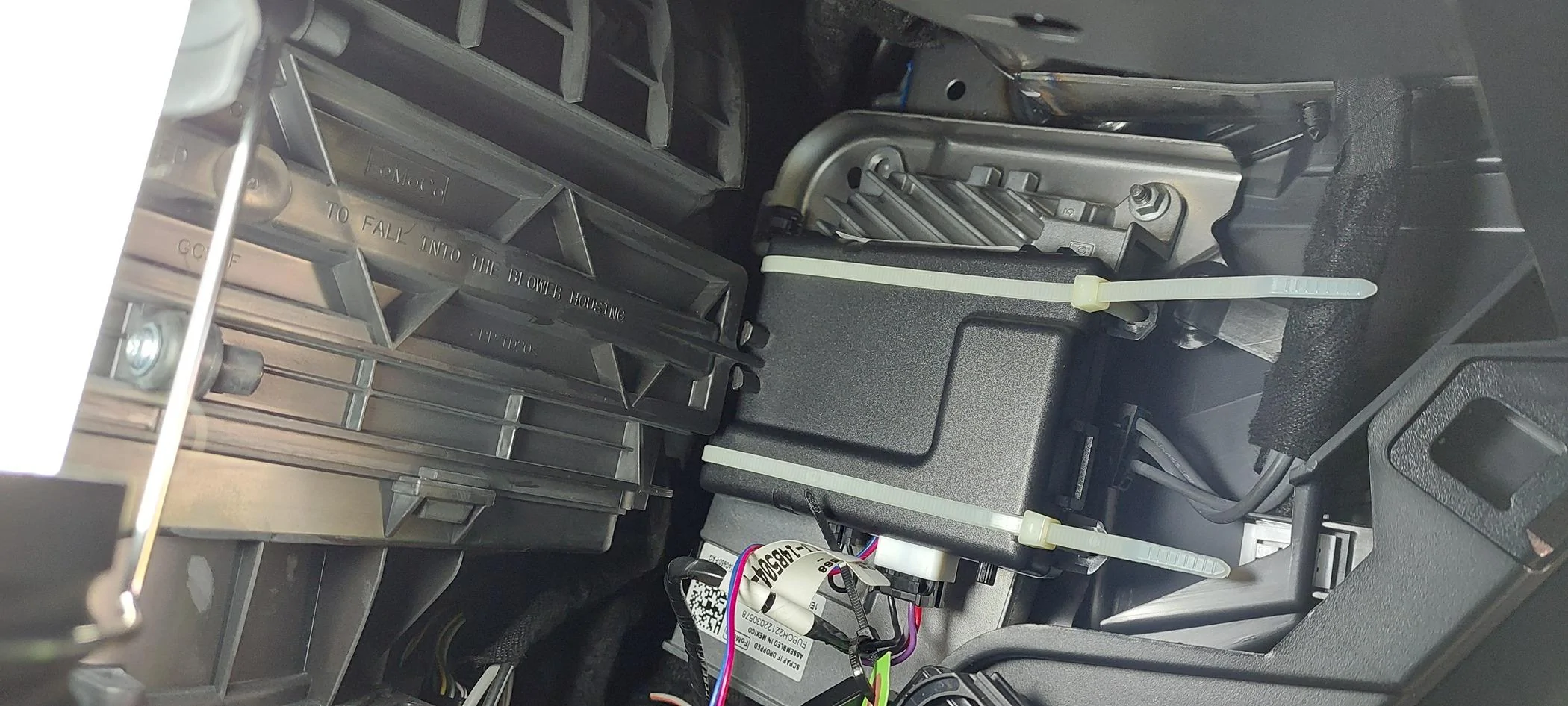

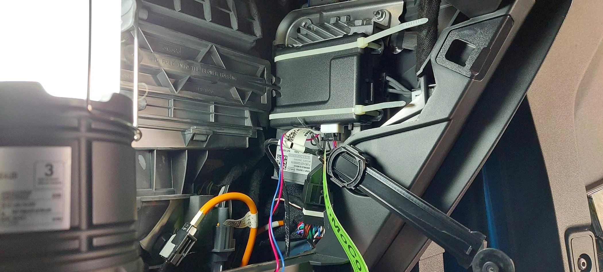

Did this today, you can probably do it without removing the 3 nuts, but I eventually ended up removing the nuts. the silver box is still hooked to something at the front vehical side, I couldn't make it out. but removing the nuts allows enough play to get it hooked up.
Wrench for 3 nuts is 8mm.
Zip tied to silver thing, seems to work.
Haven't drilled speaker cover yet
Didn't receive notification when playing with it. Does honk if I try to get in door when locked
Didn't break anything, so that's A+ for me
