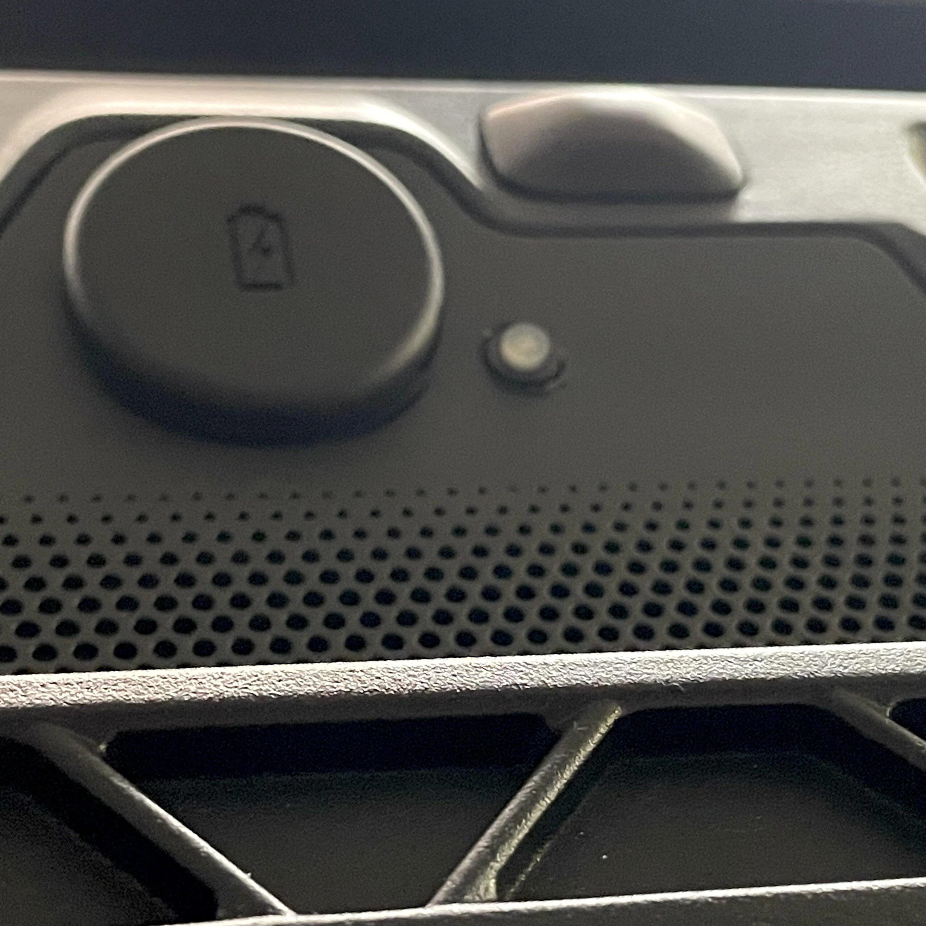

Very nice write-up. Have mine apart and in process of installing now. Would like to put the LED in the center switch console with the rear differential control. Have this removed and would like to take apart to see if feasible. Has anyone taken this switch assembly apart, and if so, how?
Put mine here

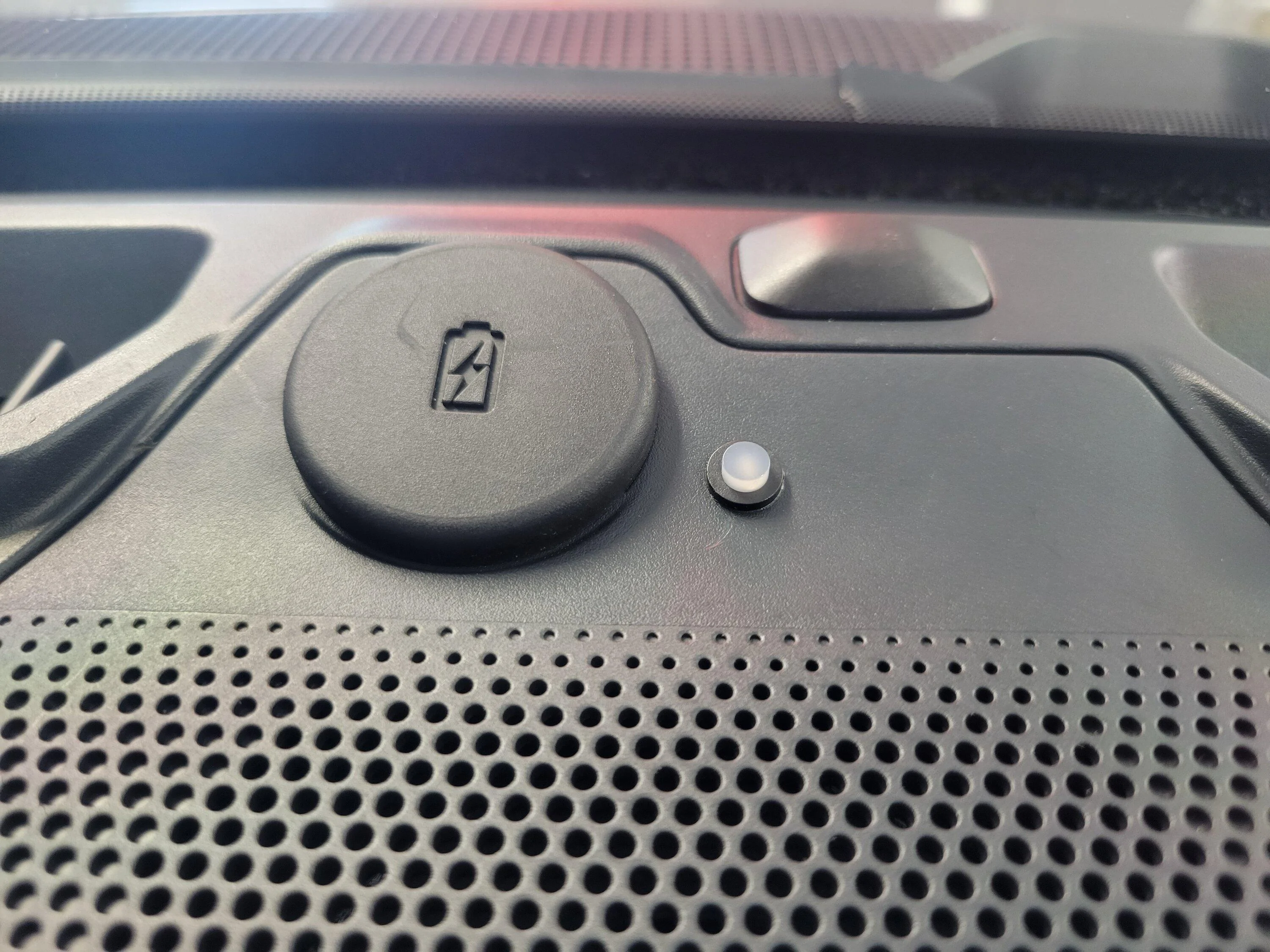

Installed mine today. Thanks for this write up. I tested the led and it works but I’ll put the led in its final place tomorrow as I’m running out of daylight now. I’m thinking of putting it near the row with the hazard lights / off-road switches. I’ll look up how to get behind there tonight.
