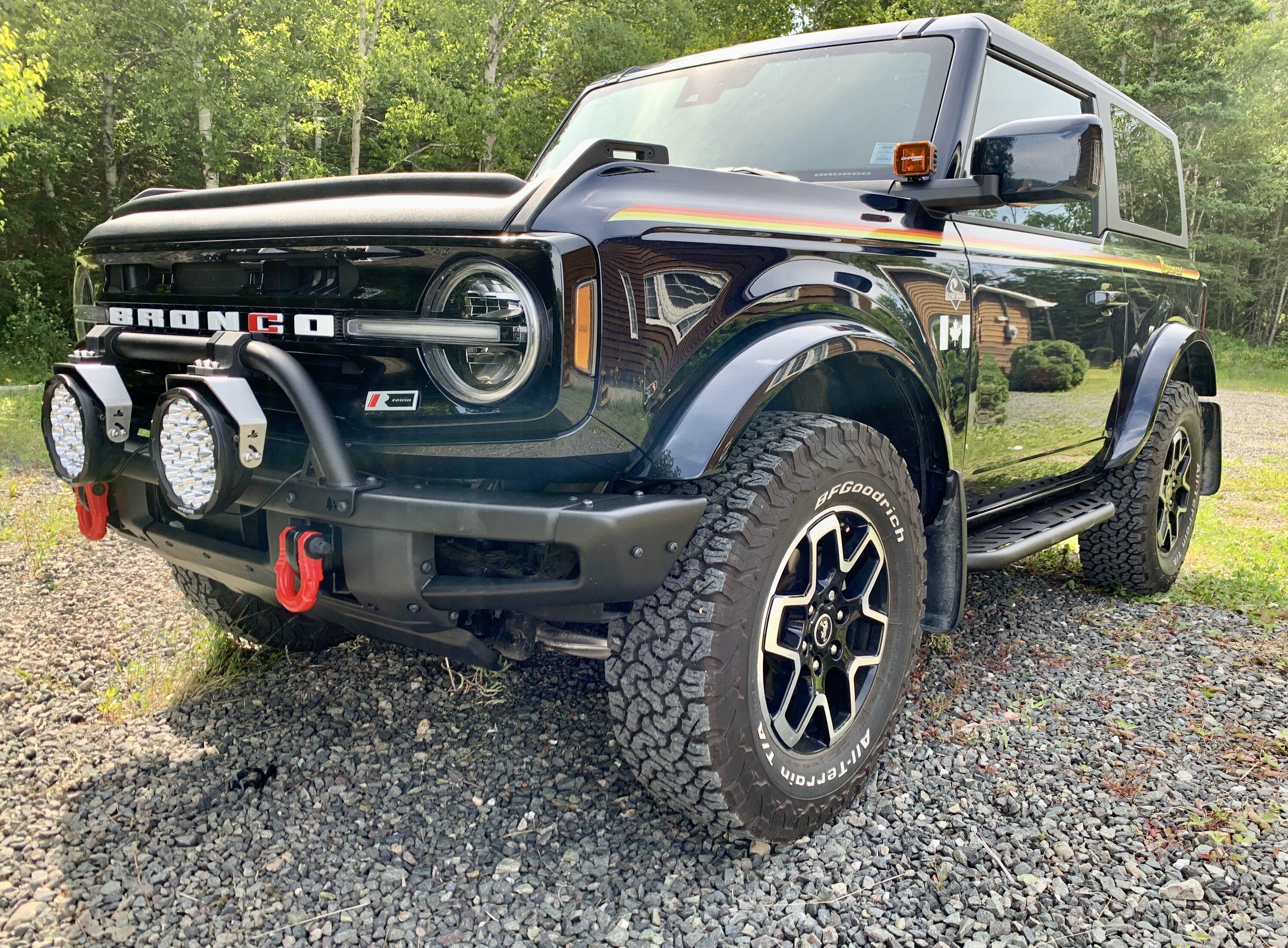

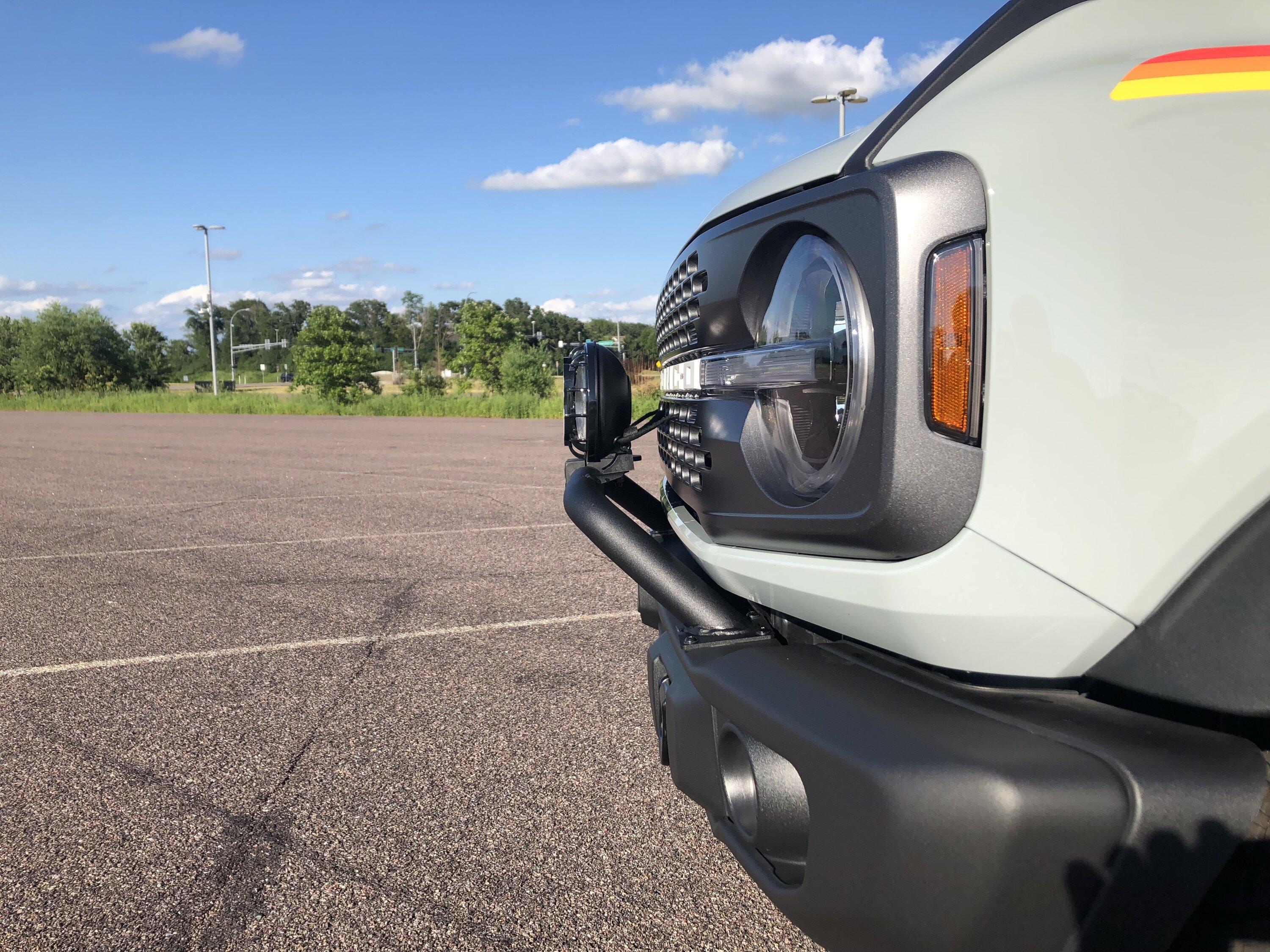

I was going for a sort-of retro look with the KC lights with stone guards. Pretty simple to attach the bar and wire the lights in to aux switches. Center spot to Aux 2 and outboard driving lights to Aux 1.

Nice, what bumper bar are the lights mounted to, do you happen to have a link?
I assume you had to drill holes and bolt thru top of capable bumper?
Here is a link the bar I installed:
https://www.amazon.com/gp/product/B07K8BJG9C/ref=ppx_yo_dt_b_search_asin_title?ie=UTF8&psc=1
Yes, I drilled the bumper and bolted the bar on. I was going to thread the holes but the bumper is too thin to support the bolts, so thru bolt and nut. I think the bar came with backing plates that have nuts welded on, but I couldn't get those to fit inside the contours of the bumper.

That looks great and is exactly what I’ve been trying to find for the capable bumper. Two questions, first is the capable bumper solid enough so that you don’t get any wobble. Drives me more crazy when wobbly lights shake when you’re driving along with them on at night. Second question is regarding the front camera, if there was no light mounted in the center do you think the camera would be blocked?
Seems solid enough to me. I have not tried running down a really bumpy road at night, but no wobble from the bar when you grab and pull.
I can't comment on the camera since I don't have one. If it would help, I can take additional pictures or measure distances for you.

What is the distance between the light mounting spots center of bolt hole to center of bolt hole? I'm interested in doing this then putting a low profile light bar instead of rounds. This will allow me avoid too much interference with my forward camera. I ordered the bar but it's not gonna be here for a while. I have to decide if I want to nut and bolt it or use a metal nutsert setup for easier removal
The bar is 9 inches and the light are 8.5” but the 6 bar mounts take the lights out far enough to comfortably clear the bumper. I bought their anti-theft hardware too. Had to grind strips of rubber (vs supplied foam) given the weight of the light/bracket combo. Very solid now.

Did you remove the bumper to drill the holes? If so, did you follow any instructions from someone else? Do you have a camera that needed to be relocated?
