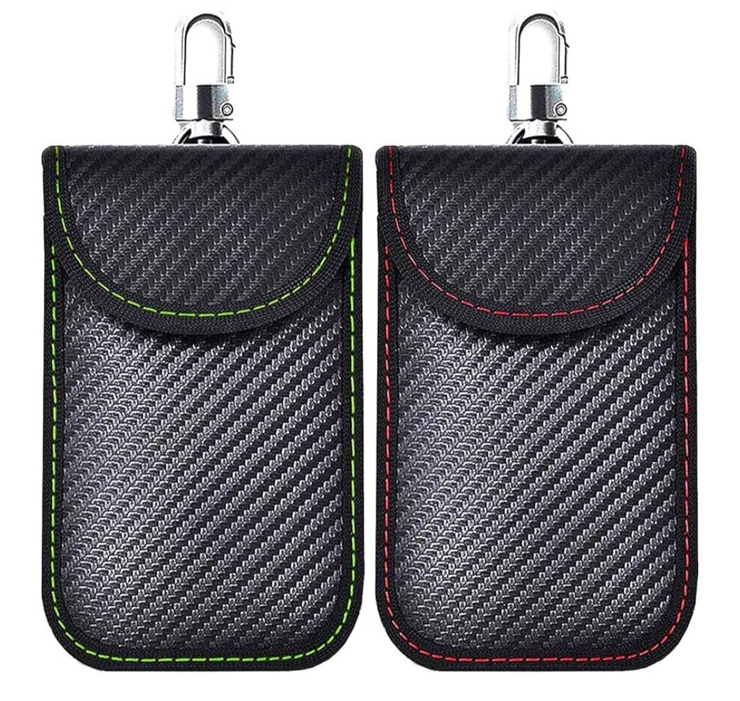

I have a couple of these that I keep the fobs in, they aren't much larger than the fob itself and fit easily pockets. I think it was $10 for a 2 pack. They work well.
