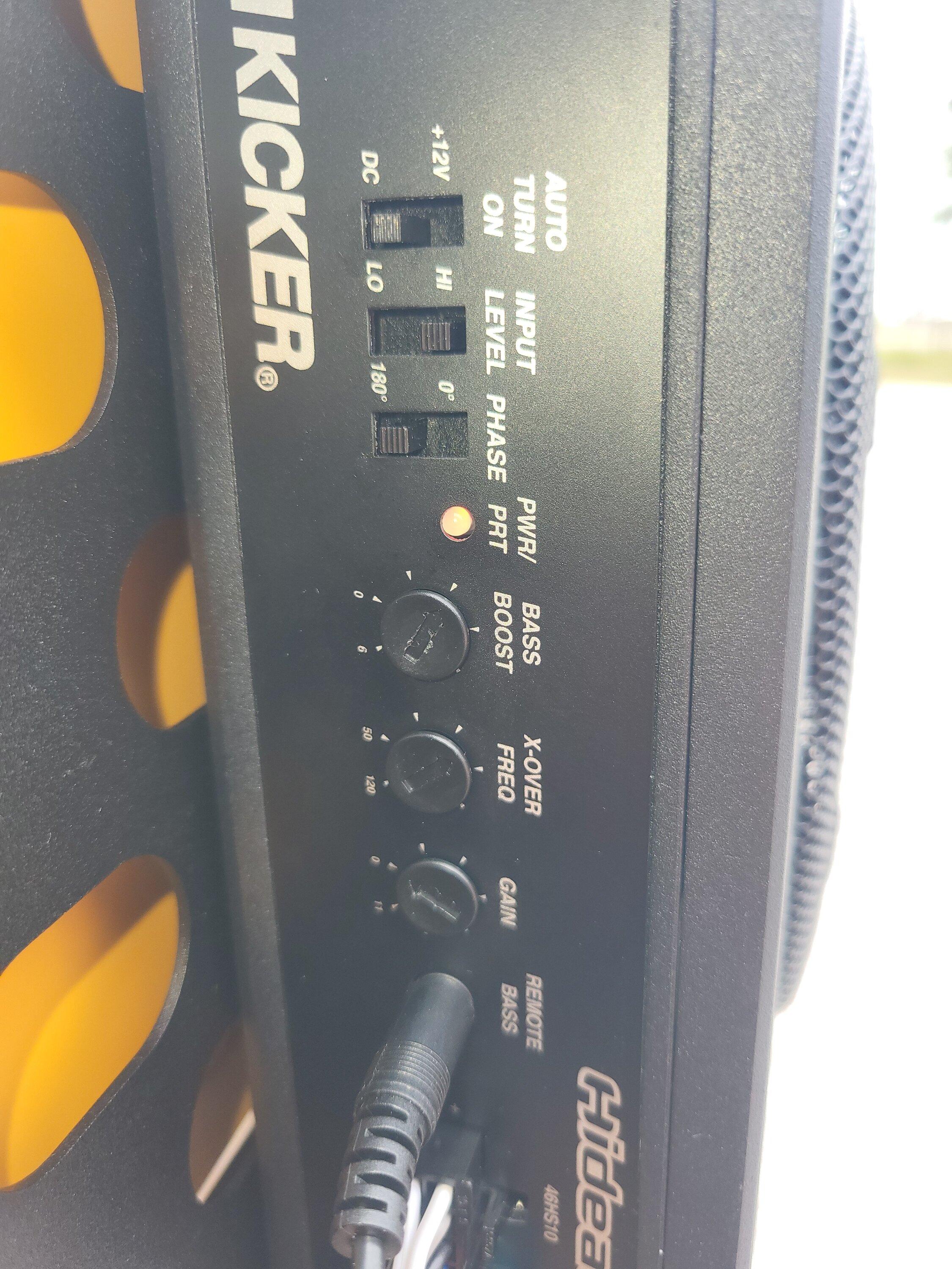

I think I've got it figured out. The red light was steady on because my battery was low. I adjusted the settings till the blue light would stay on. I have the bass level knob all the up so I control the amount of bass. Let me know if these settings look right. Or if I should adjust up or down on anything. I listen to a variety of music so I just want it to sound good and be able to control the bass through the level knob. Thanks for the help.

First of all you have the gain at 0, which will effectively do nothing, take a small screwdriver and first put your speakers to a level you are comfortable with then go to the amp and adjust the Gain up until it seems about right. The bass knob should be used to fluctuate more bass when you want it. The gain is you main problem, think of it as a valve and with it at zero nothing is going out.

Ok, I adjusted the gain. I got it at about 3/4. So far everything sounds really good. My only question is; I didn't hook up the blue wire. Should I connect that wire to an ACC fuse. I'd like the Hideaway to turn off when the Bronco is off. Is that what the blue wire is for?

The blue wire or remote wire is connected to a switched ignition. Some amps have signal sensing that turns the amp on when a signal is sent to the amp via the rca cables or via high input wires. If the amp is turning on and off with the vehicle already then you should be okay. If the blue/remote wire is coming from the harness then it should be wired to be hot or powered when the car is on, in that case just connect it to the amp so you don’t have a live wire loose.
