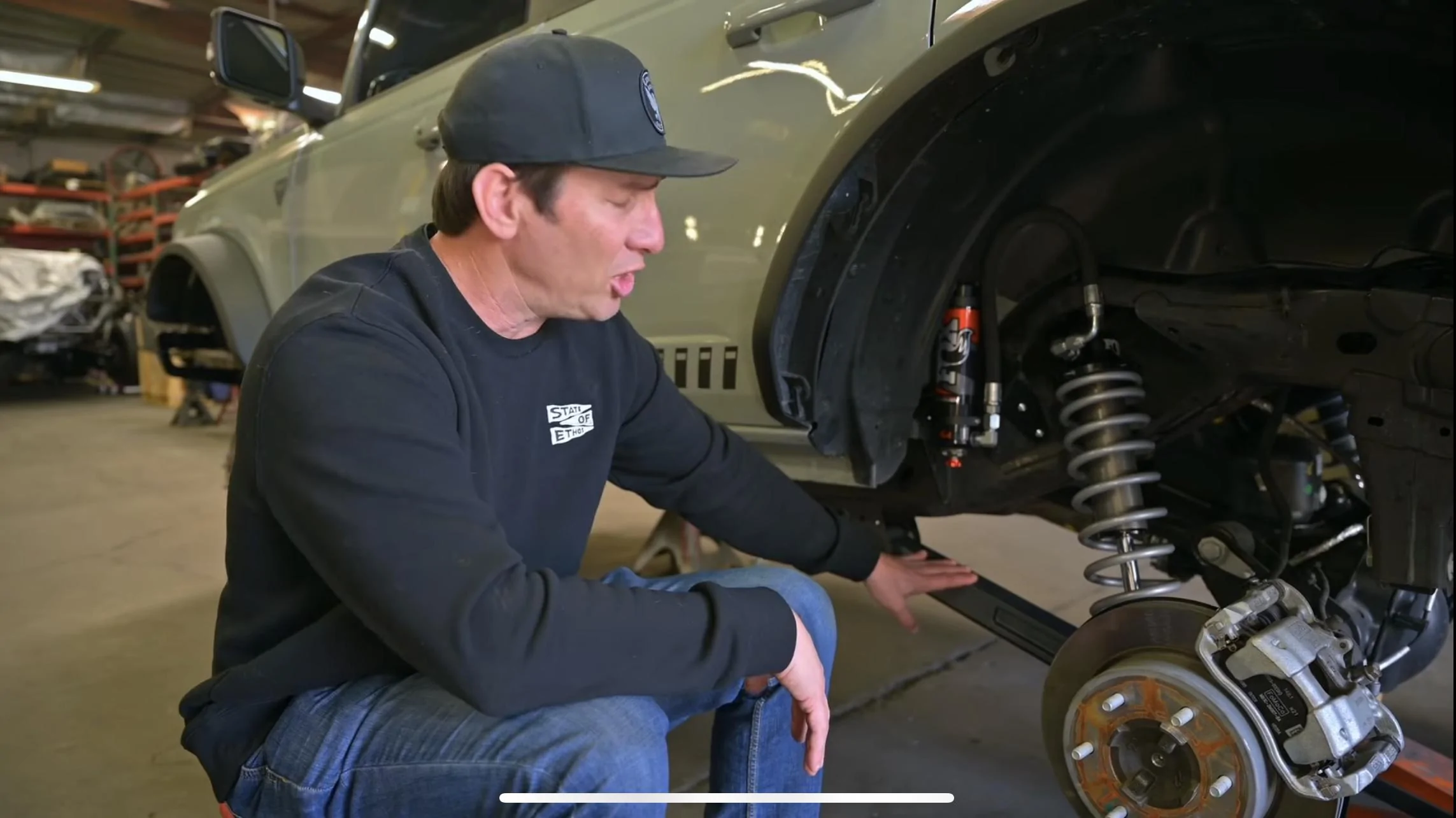

Almost as if these 2 had a competition on who can make the adjuster the most inaccessible with the tires on…
fox front (will likely be covered by a 35, definitely by a 37):

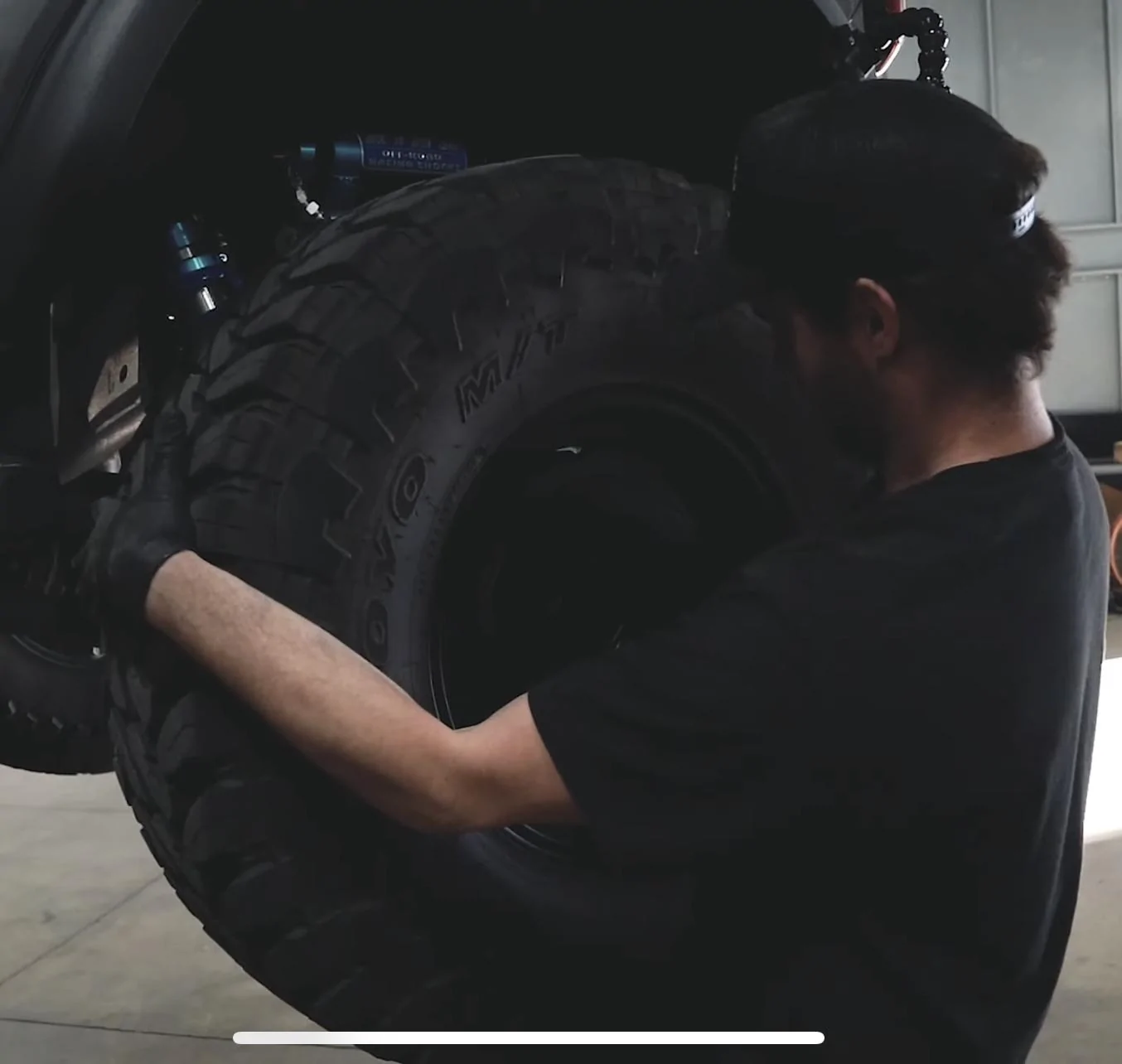

Fox rear (huh??):

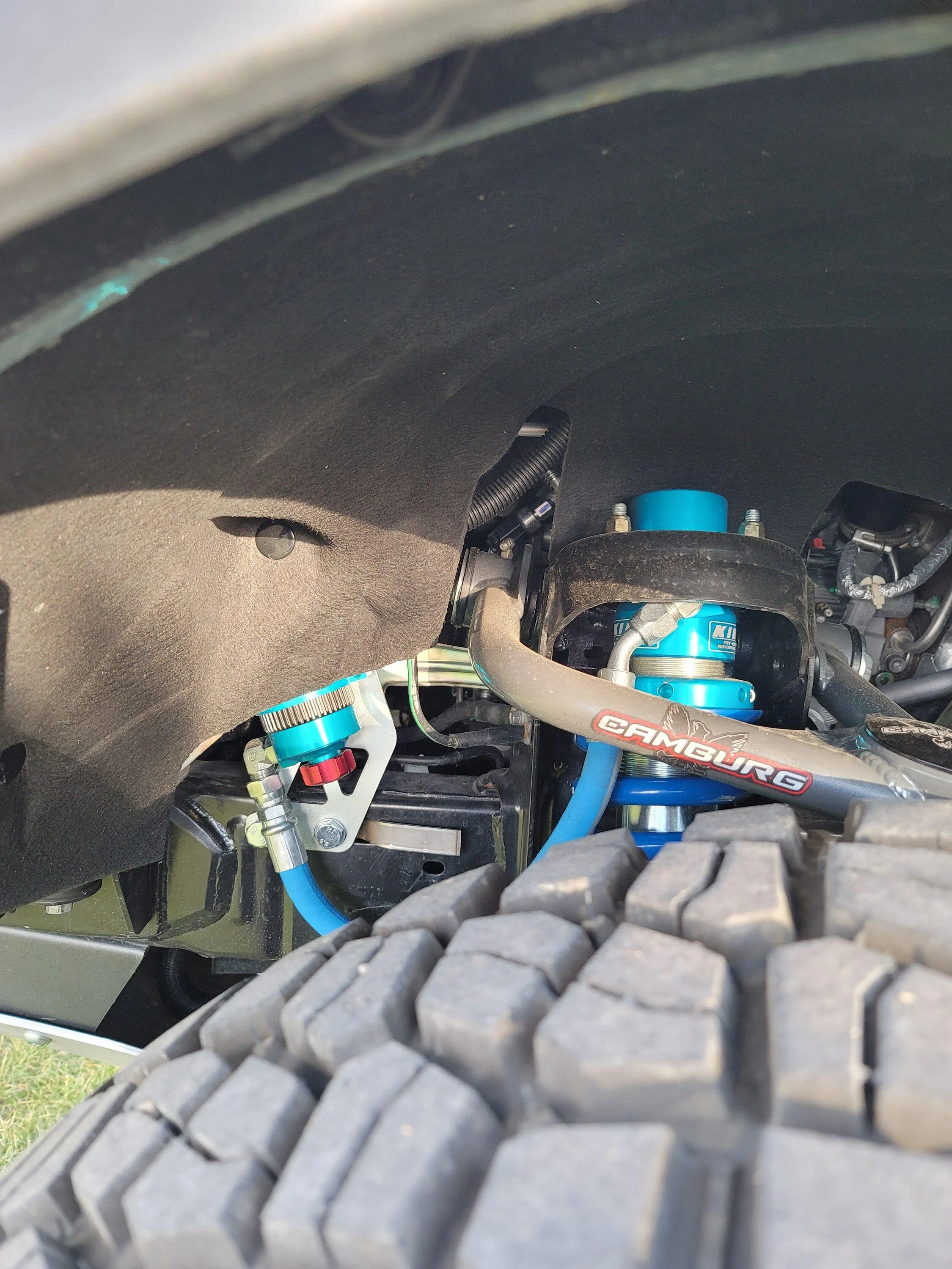

king front:
Ford Bronco King and fox compression adjuster placement 92BD6AC2-2801-45F3-9A92-1190C3B99747

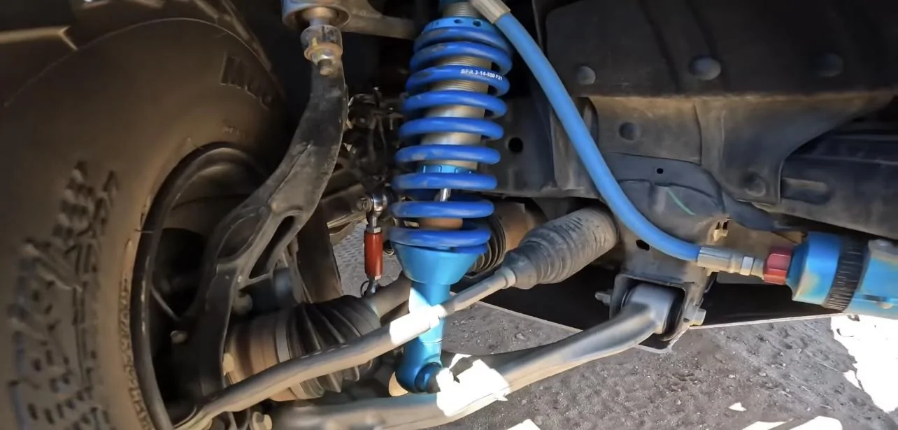

king rear (not bad at all):
Ford Bronco King and fox compression adjuster placement C38EE806-03C3-4B79-A2F5-35B644DB006D

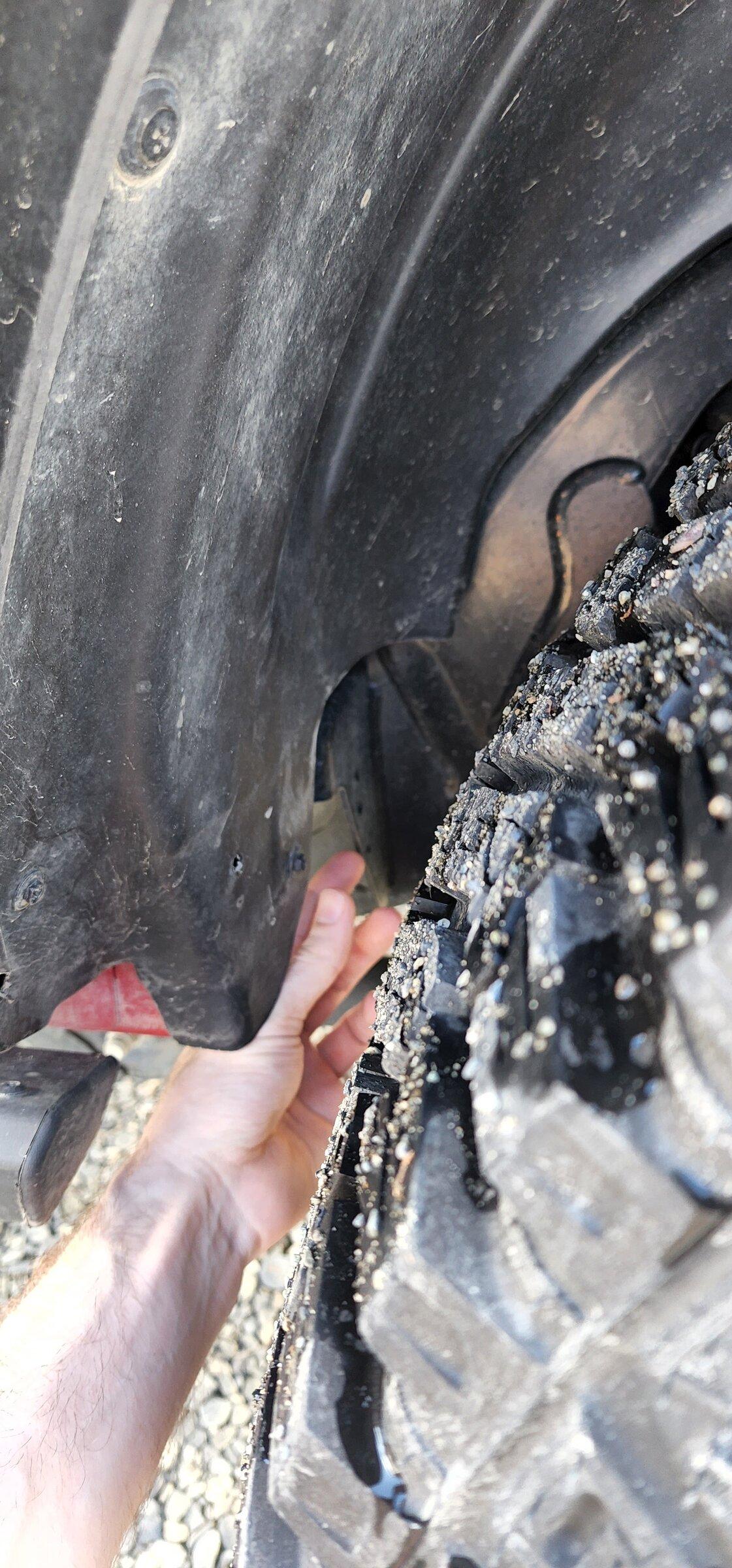

You do realize that the front tires turn…. Right?
And for the foxes, i do realize the rear tires come… off.
I guess if you haven’t seen them on other vehicles, you wouldn’t really know how bad the placement is on this.

Eh I guess documenting a relocation like this won’t be necessary then:D
Ford Bronco King and fox compression adjuster placement 1AE23811-F6D5-4FDF-A034-A7BBCCFA1B0D

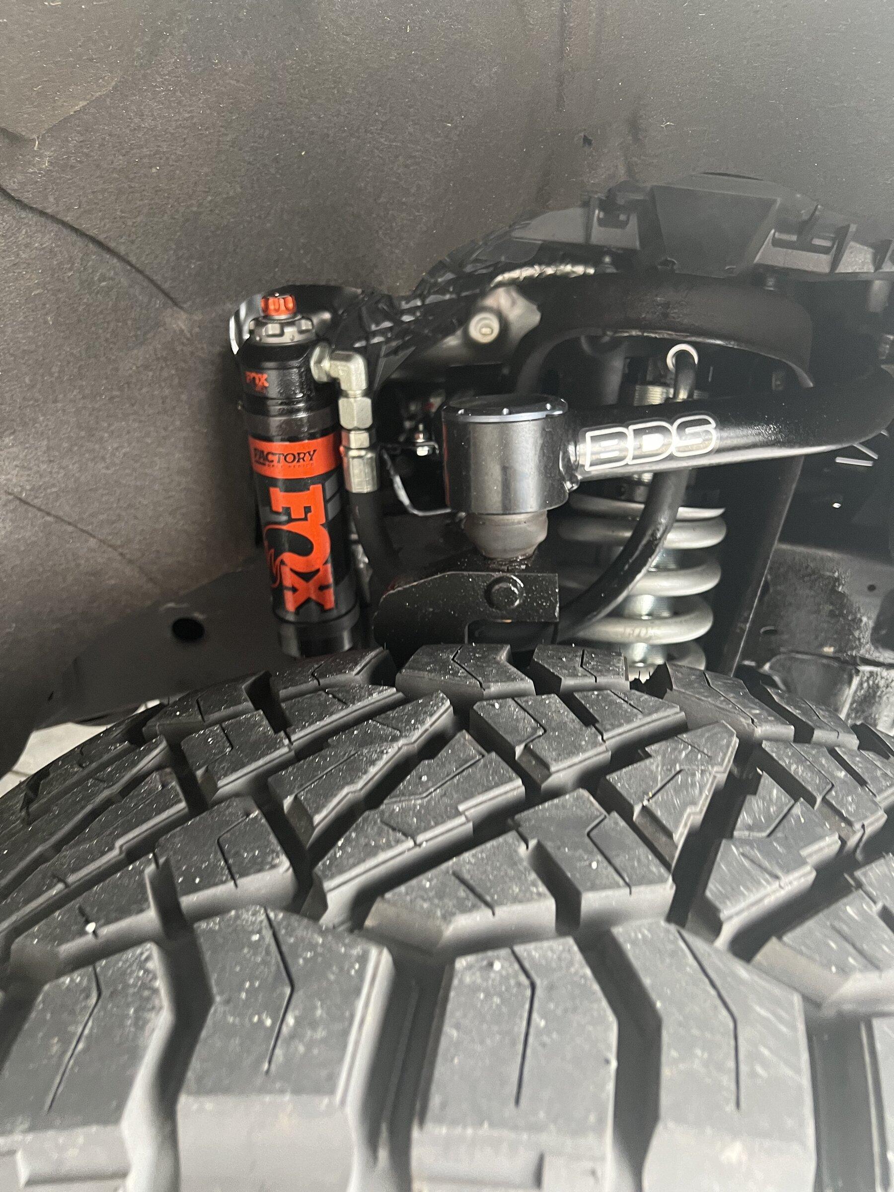

Has anyone come up with another option for mounting king reservoirs?
I just realized that the bracket for the king reservoir is designed to bolt to the body mount/crash bar. Which won't work with my JKS max tire clearance kit.
NevadaBronco
Seth
Jun 5, 2022
89815
2022 Bronco
Yes welded nuts to flat strap to make the tabs
