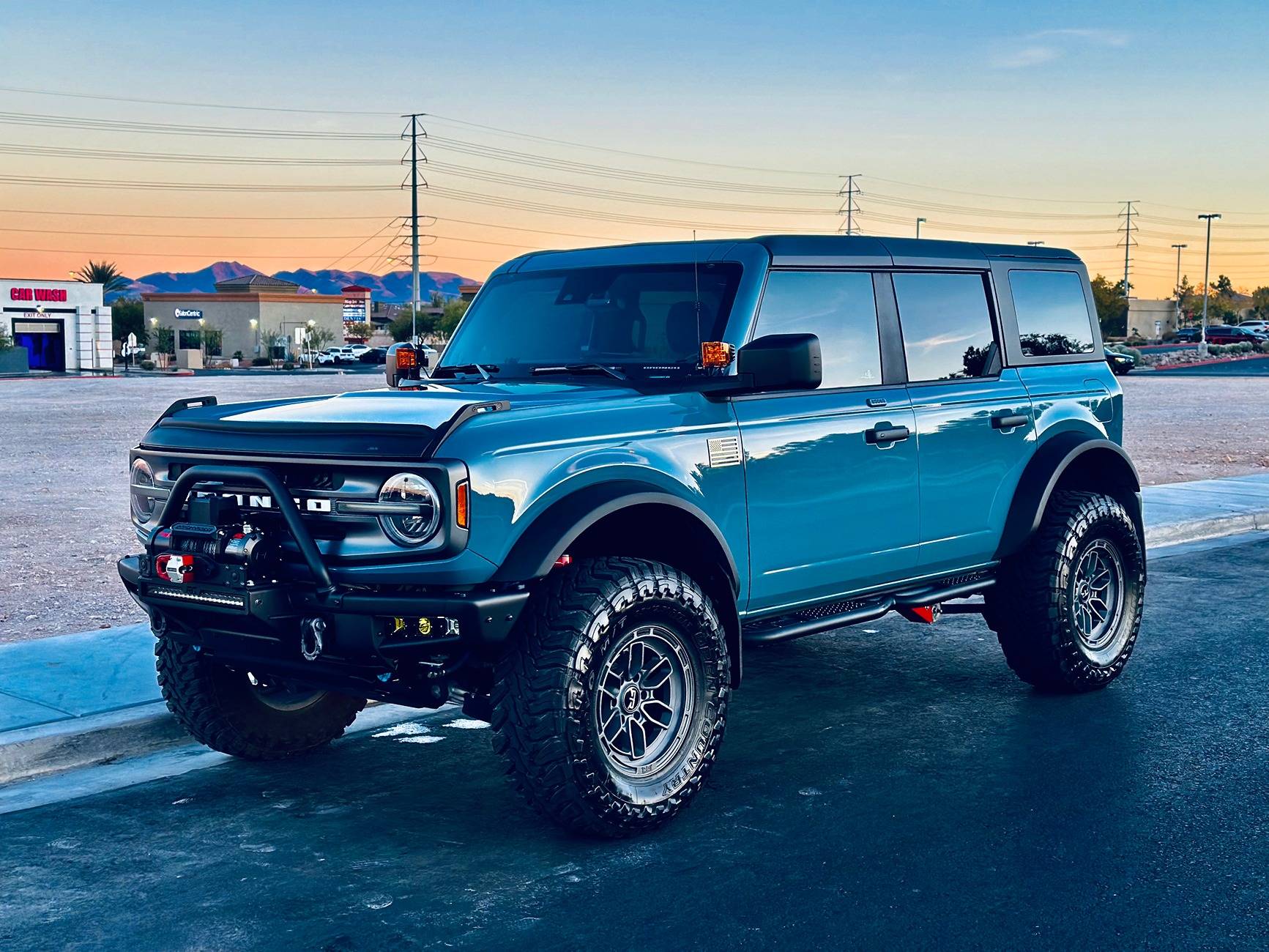

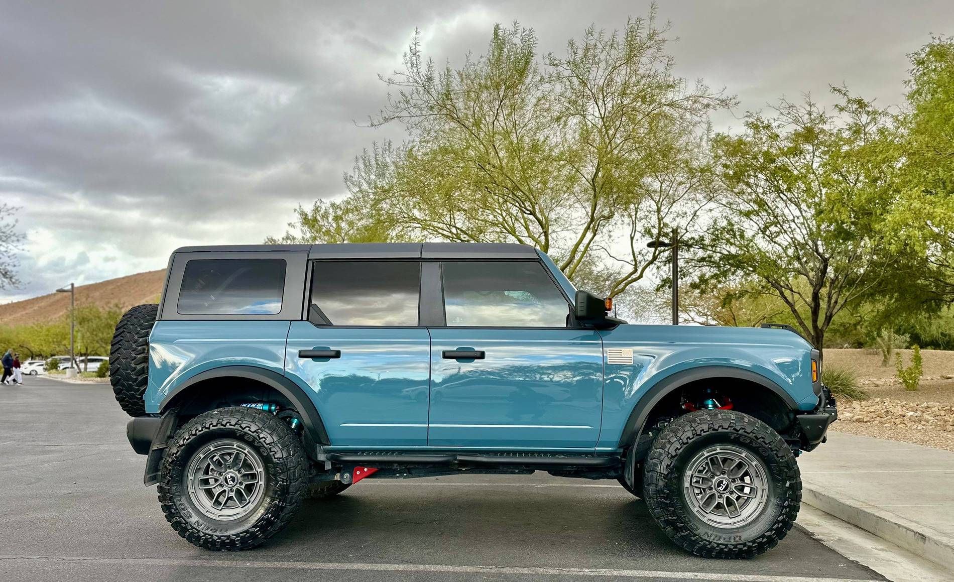

Yea I have D load range tires. Super stiff but I like them for durability. Looks good! I’m still convinced something is not right with my front end. It sits soooo high on stock springs at ride height at the lowest setting. I’m on 37’s and have the full bumper/winch setup. If I was on 35’s it would look like a stork.
it’s livable. But I have yet to see another setup from King as high as mine. Still good though even after 3 rubicon trips and tons of desert running and local trails. No CV binding at all
..."a stork" hahahahahahahahahaha!!!!!! That's kinda what mine looked like to me in the beginning.....then I got used to it being so high. But man......does it handle GOOD. Oh and my tires are E range :)
You're in CALI bro - KING is based there too. I would call them, ask for Marvin (super cool dude and gives SOLID advice) and see what they can do. Maybe you got wrong front springs? Perhaps they can provide softer ones?
