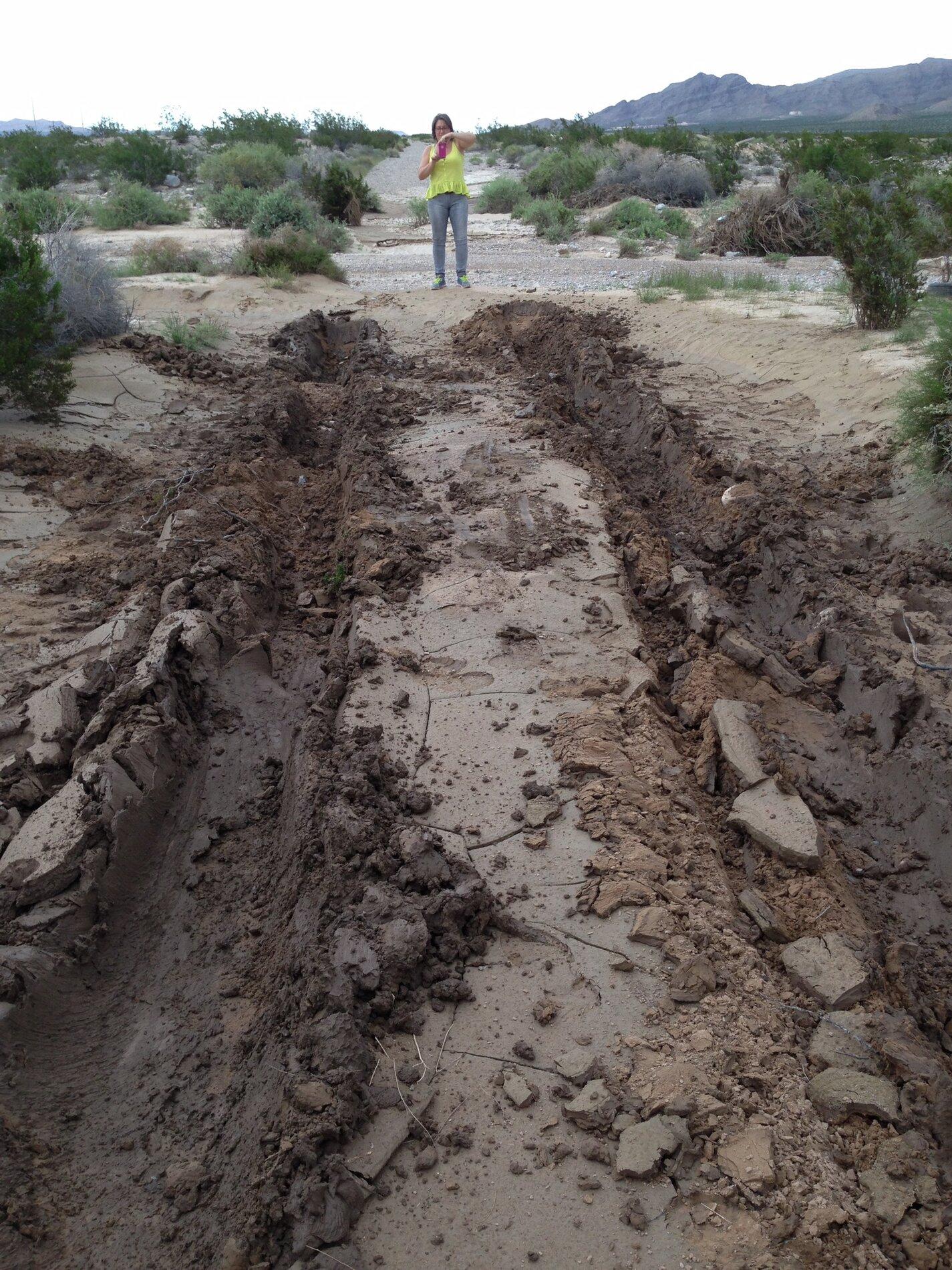

My JEEP was open diff when purchased. First day out we went for a ride in the desert. As far as you can see, dry desert. Then we came across the one and only (tiny) mud spot and got stuck with the front tires 8 feet from dry land. Took us 30 minutes to get out of it by moving rocks and tumbleweeds. Jeep has brake lock differential to automatically slow a free spinning tire and send power to the other wheel, it tried to get us out but still stuck.

A week later I had a Eaton selectable rear locker installed. For me, I will always choose to have at least a rear locker, but I also take my rig to Moab and quite a few other places for fun. I never considered a front locker, never cared for the $$. I have had my locker for 7 years and it has been engaged maybe 10 minutes if you add up all the time. I only use it to get over an obstacle and then it gets turned off.
