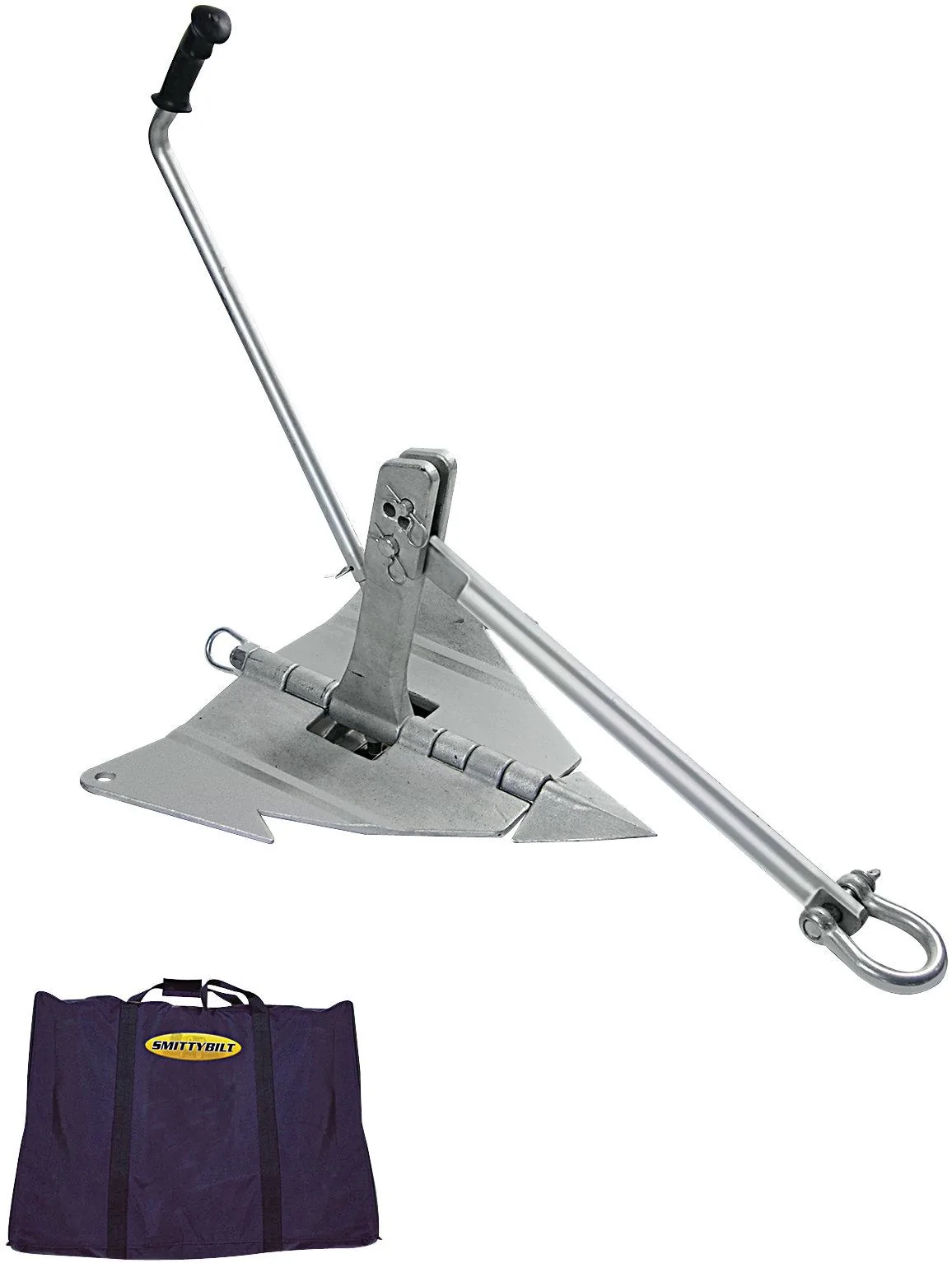

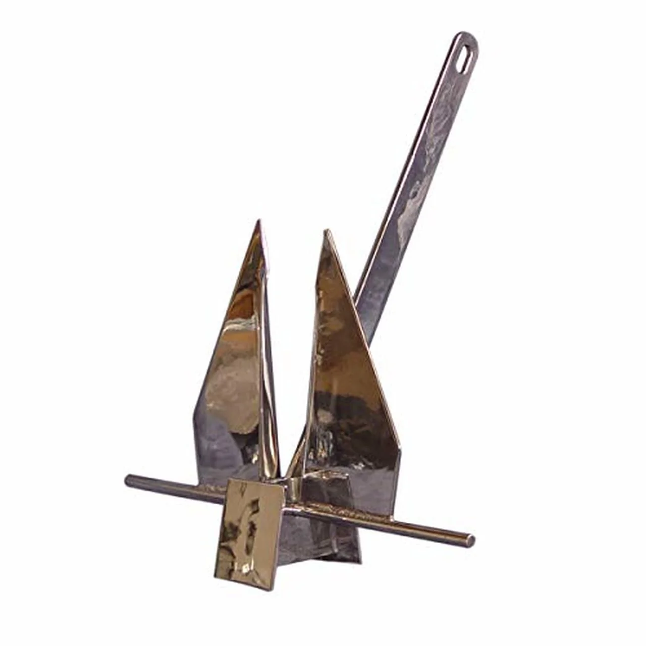

You all have confused. The only time I need help is when I get mudded in. What helps then?
Never had to do it but you can bury your spare and hook up to it if you have a winch.
A a minimum get a rear locker that will get you through most stuff you will encounter .
