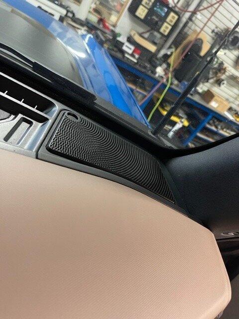

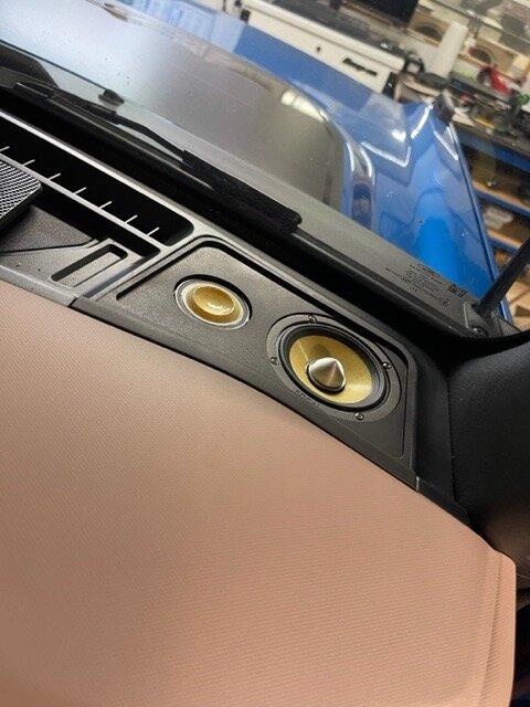

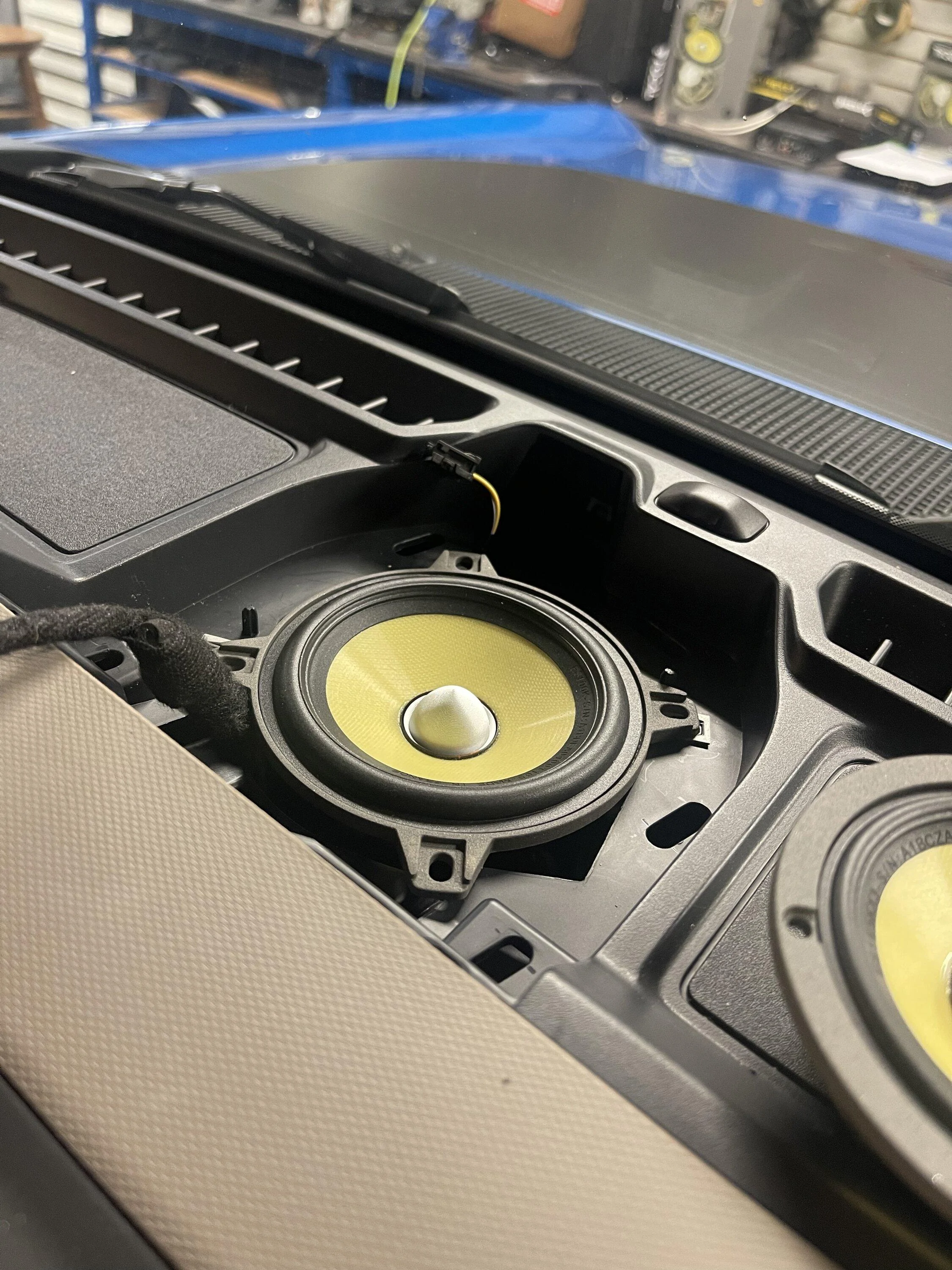

I was planning to install next week, but I was able to get it done sooner. I got it back today and I love it! Here is my build:
  1. HELIX V TWELVE DSP MK2
  2. ZEN AUDIO DSP6A-A2B
  3. FOCAL 6.5” 3-way component kit ES165KX3 for front left and right - see picture (3D printed new speaker grills)
  4. FOCAL 4” 2-way component kit ES100Kfor rear and center channel- I’ll add pictures tomorrow
  5. XD300/1v2 - Monoblock Class D Subwoofer Amplifier, 300 W
  6. STINGER SWING GATE 12" SUB ENCLOSURE TXFBB12-Subwoofer by Phoniex Gold
  7. Install sound deadening throughout the vehicle (floor, doors, wheel well) - To me, Road Noise is worse than wind noise in the Bronco.
Happy to answer any questions.

Is your center channel just a midrange driver? Been trying to decide if i replace my center with a coax or just midrange driver
Bacchanalia
Tony
Jun 8, 2022
Just a mid-range. The speakers are so close together, that I didn’t feel I needed a tweeter.
