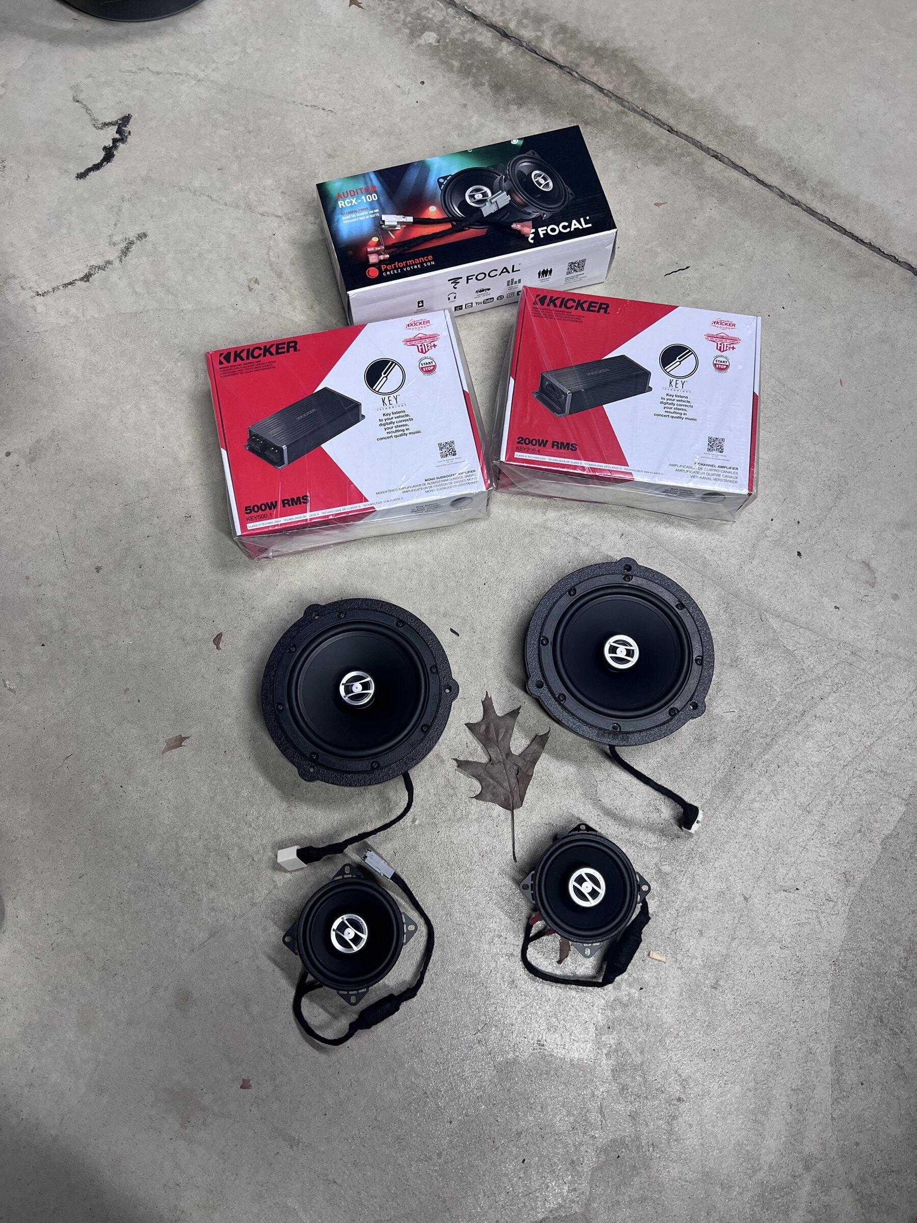

I've posted a couple things in a few different threads, but thought I would consolidate some of my notes / thoughts in one place. There are a lot of good threads with pictures, this is more tips that some may find useful.
Like many, I was pretty underwhelmed with the B&O system. I didn't have high expectations for a factory radio, but for a "premium" system, it's pretty bad. I plan to trade my truck in for a raptor at some point in the next year, so I didn't want to sink a ton of money into a stereo and wanted to avoid cutting, splicing, removing anything that would be difficult to undo or jeopardize the function of the factory radio/cameras/etc.
After doing a fair amount of reading here, I decided a good first step was to replace the front corner dash speakers with Focal ACX 100s using the amazon harness (all plug and play). Thought this would determine whether if it was worth doing anymore speaker replacements, since I had no intention of spending $800 on the NAV TV unit to replace the factory amp.

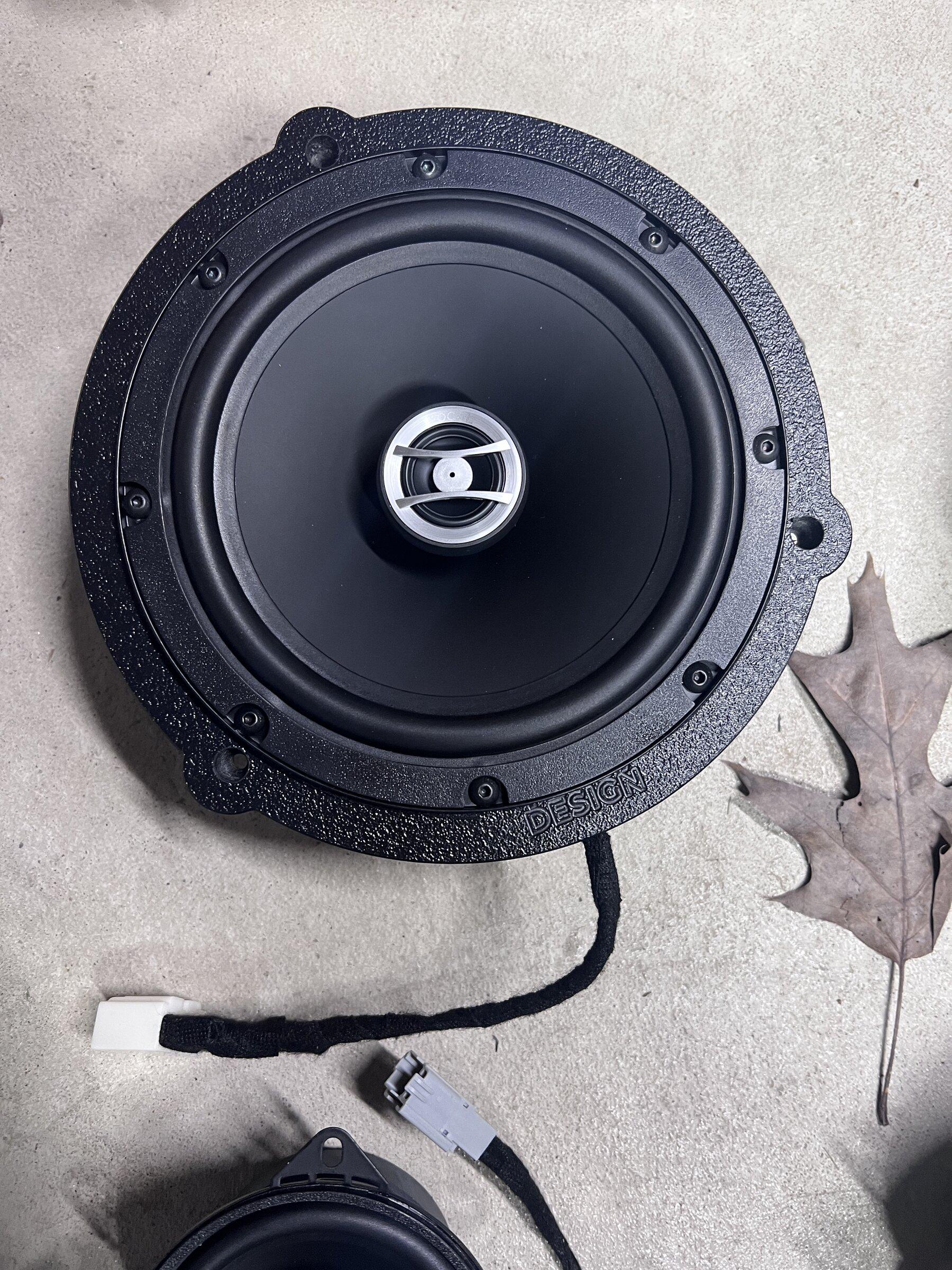

Kick Panels
I read a lot of mixed things on replacing these speakers. I went with the Focal ACX 165s (with the free installation kit from crutchfield). Bottom line is the factory amp doesn't have enough power to drive a good set of aftermarket 6.5" speakers and the factory amp filters out highs, so 2-ways are useless.
I think I lost a hair of volume with the focals but maybe picked up a little crispness in the bass. I did a lot of back and forth testing (passenger speaker swapped, driver speaker stock) and this is one you can skip. I already had one speaker installed and for $135, it wasn't worth uninstalling it and returning them. I also am going to add an aftermarket sub, so I figured whatever little bit I lost in mid volume will be replaced by the new sub.
EDIT: after some more listening, I would skip replacing these. No noticeable improvement in SQ and you may even lose a little volume.

Subwoofer
Probably the weakest link in the B&O stereo and almost every factory stereo is the sub. Subs require the most power to drive and are often jammed into awkward spaces to preserve space. The Bronco is no exception. I know a few people have tried to make the factory enclosure work with an aftermarket sub/amp, but IMO, you will be chasing a never ending stream of rattles. Those enclosures are not designed for acoustics and running any meaningful amount of power through them with an aftermarket sub will just result in even more plastic rattling and you'll constantly be trying to figure out a place to put dynamat/fill.
That said, this is a car I use every day and maintaining trunk space is important. I ordered this this Kicker down firing enclosure, Kicker Key 500.1 amp, Kicker bass control knob, Kicker amp installation kit and connector from Sounds Good Stereo (which allows you to plug right into the factory sub harness when you remove the speaker). I didn't think it is worth putting in anything more powerful, as it would overwhelm the mids/highs that are still powered by the factory B&O amp and I want something "tight" enough to still be musical, so a single sealed 10" was sufficient for me.
Link to Kicker Sub/Enclosure
Link to Kicker Amp

I highly suggest watching this YouTube video before doing it. They have a lot of great tips. Thanks! @1Five1 Garage.
Link to Focal ACX 165 Speakers
Should take about an hour for both (assuming you don't need to go to Home Depot 3 times for screws). You'll need a pry tool (for the driver foot rest cover), razor blade (to cut a hole in the foam to snake the new harness out of the speaker enclosure (watch the video below for an example), a 7mm socket (for the speakers) and a 10mm socket (for the driver side only to remove the foot rest).
Subwoofer
Link to Kicker Amp
Link to Kicker Bass Control Knob
Link to Kicker Amp Installation Kit
Sounds Good Stereo Sub Harness
I'll lose minimal trunk space with this setup and can stack things on top without fear of damaging the speaker. Hopefully, in a pinch I can unplug the speaker wires, remove the enclosure and gain full function of the trunk and everything else (amp, power, ground, RCAs, remote control wires) is hidden.
EDIT: The shop I was going to have do the install couldn't get the kicker key amp or enclosure from their supplier, so I asked if it were ok if I purchased them online and had them install them since crutchfield and Best Buy had them in stock. They agreed, so my plan was to have them install them next week. I ended up ordering a kicker 8-gauge amp install kit too, just to make things easy.
THE POWER AND GROUND WIRES IN MOST AMP KITS ARE BARELY LONG ENOUGH. YOU'RE BETTER OFF BUYING YOUR OWN POWER/GROUND CABLES. The kicker power cable is 17', which is enough to get to the middle of the trunk. If you want to mount on the passenger side panel, I'd order 25'. Ground I would go with 10'. That is more then enough for both but cable is cheap and I'd rather have a little extra.

Someone looking for a more budget friendly alternative could replace only the front three 4" speakers and add a Kicker HS10 powered sub. For ~$500 that stereo would satisfy most and probably be 90% as good as what I am doing.
Hope some of this is helpful to other people. While annoying that the factory radio is as underwhelming as it is, for under $1,000 you can turn it into something that most will be happy with.

Sounds Good Stereo makes really nice kick panel brackets that I drilled and tapped some m4 screws
I also made my own dash and rear speaker harnesses from the part #s listed previously and prewired 300hz bass blockers on the fronts
