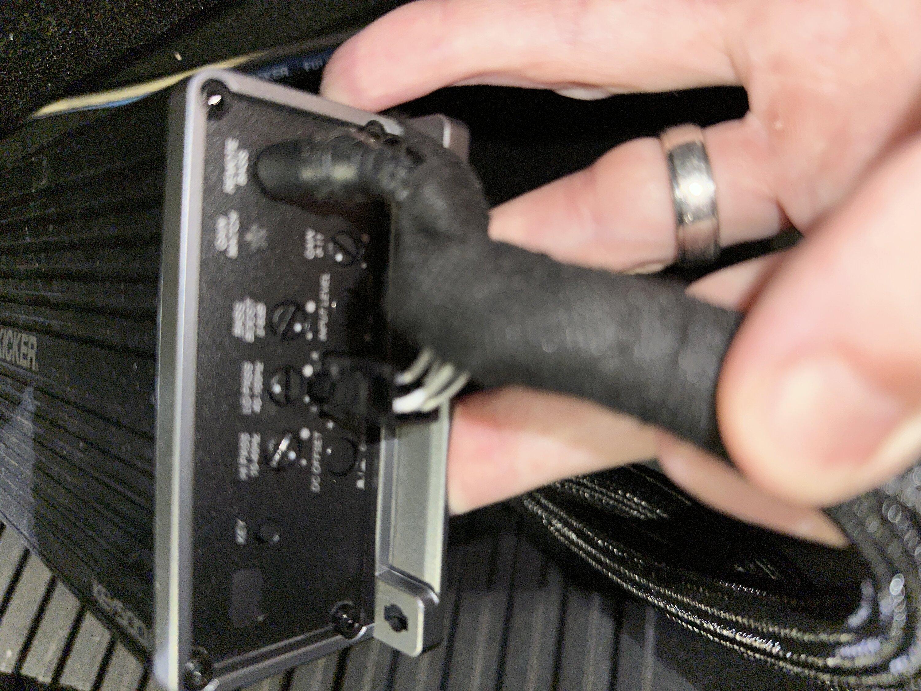

Finally wrapped up the cleanup of the sub wiring. Updated pics in my original post.

From my understanding with the B&o system you dont need to use the remote power? @JL724
