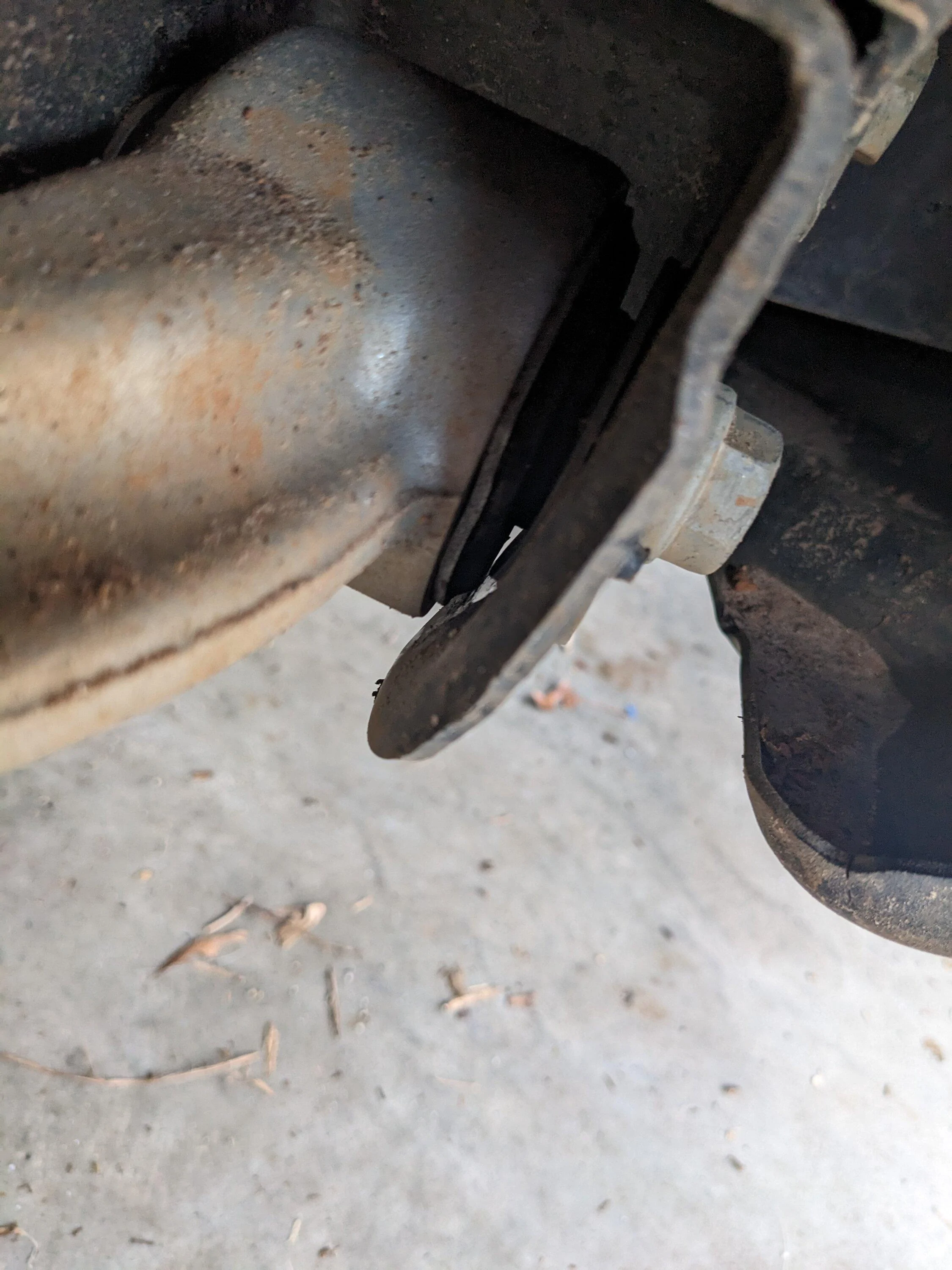

I was doing so good, so good, on this trip last weekend. Didn't scrape a single thing, until I hit some mud, and there was a hidden rock.
Left is passenger side, with the bent lower control arm mounting point, and right is the driver's side, unaffected.
Should I be worried about that passenger side?
Thanks for any advice you can give!

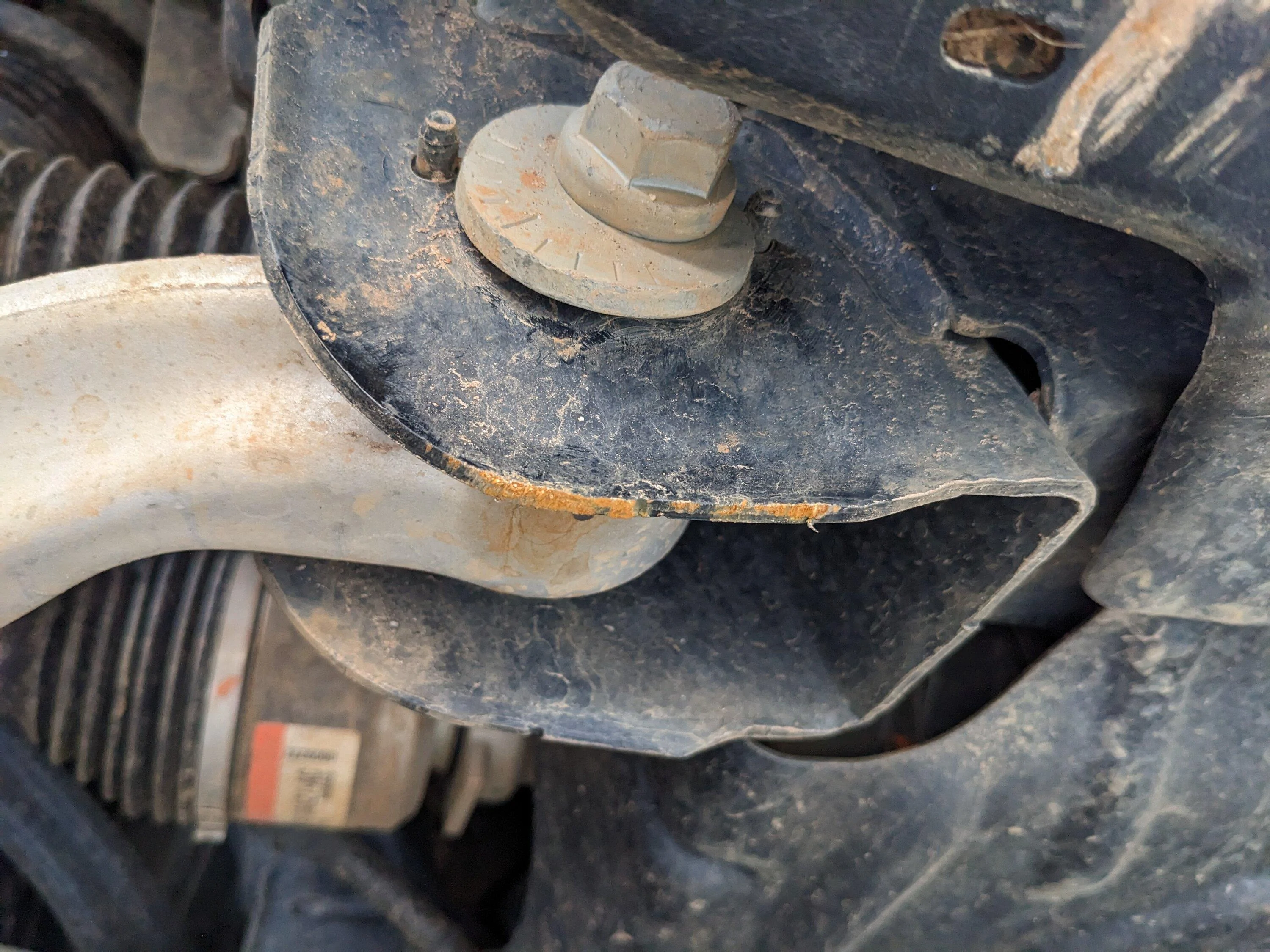

UPDATE

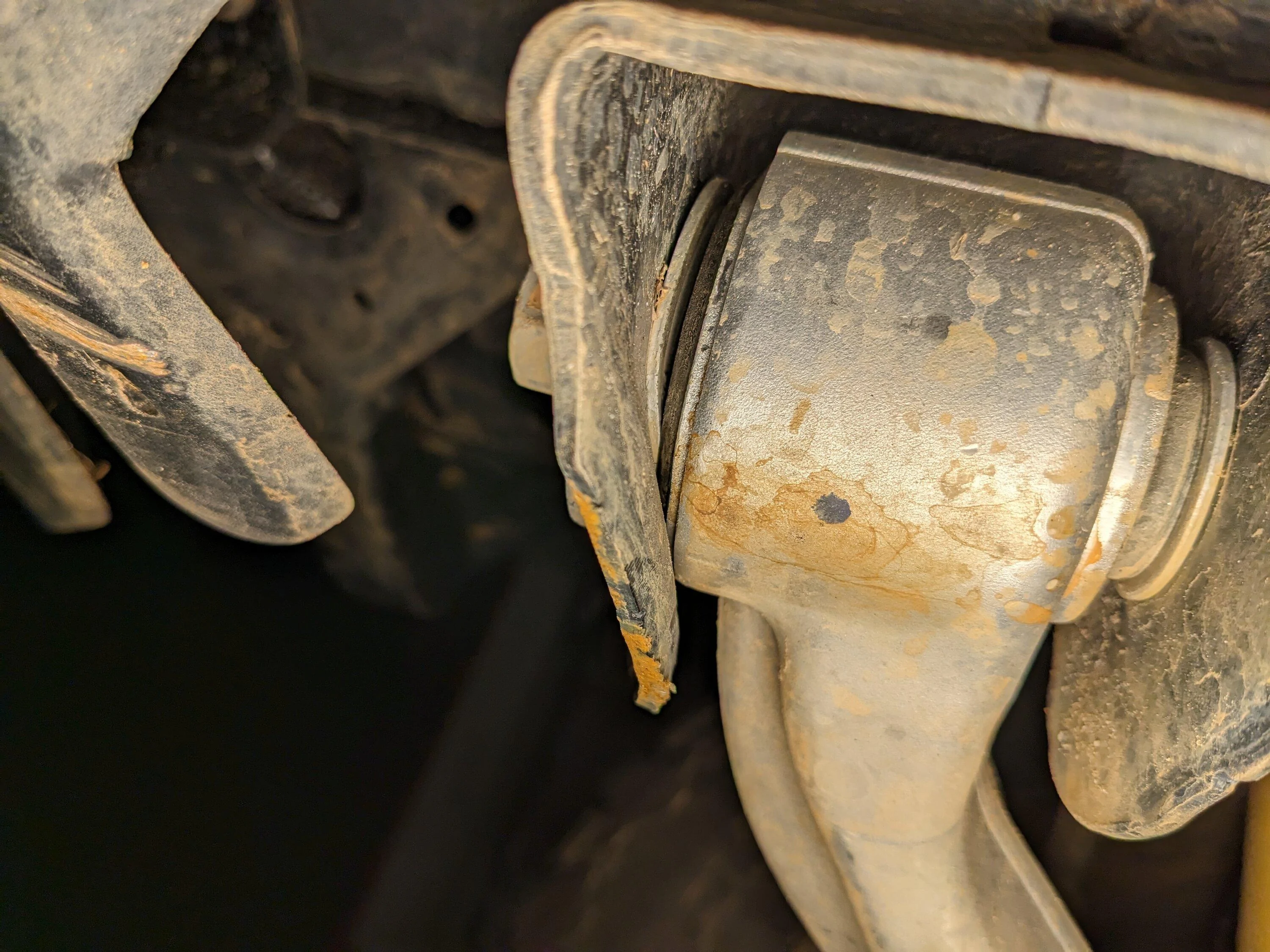

Another update, got the thing jacked up, here's the inside. How borked am I? That washer(?) on the inside is bent as well.

Seems to be bent below the bolt hole. Remove the control arm big wrench and pull it straight. At least that what I have done on my UTV's

A big crescent wrench should work good for that and get pretty good leverage. You will need an alignment afterwards too.

It's not torn near the bolt is it?

No tears, just bent. Trying to find the time to jack it up real quick and see if it rubs

If it doesn't bind at droop, I'd probably let it ride until I changed control arms/lift or bushing replacement.
