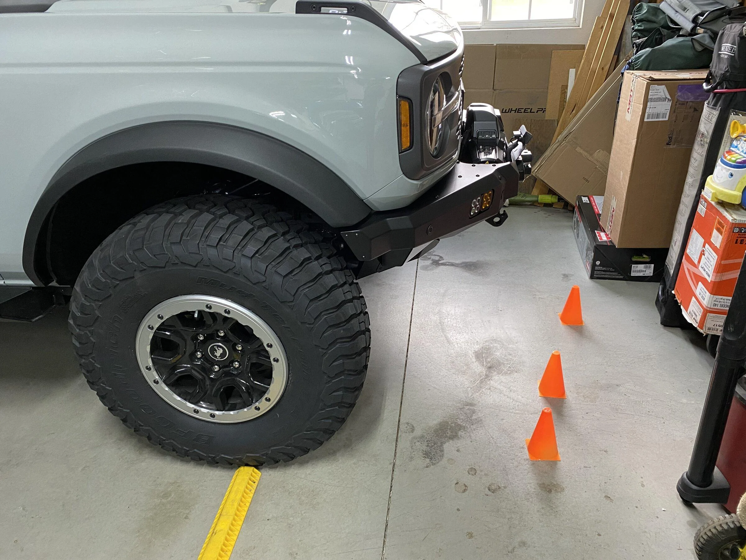

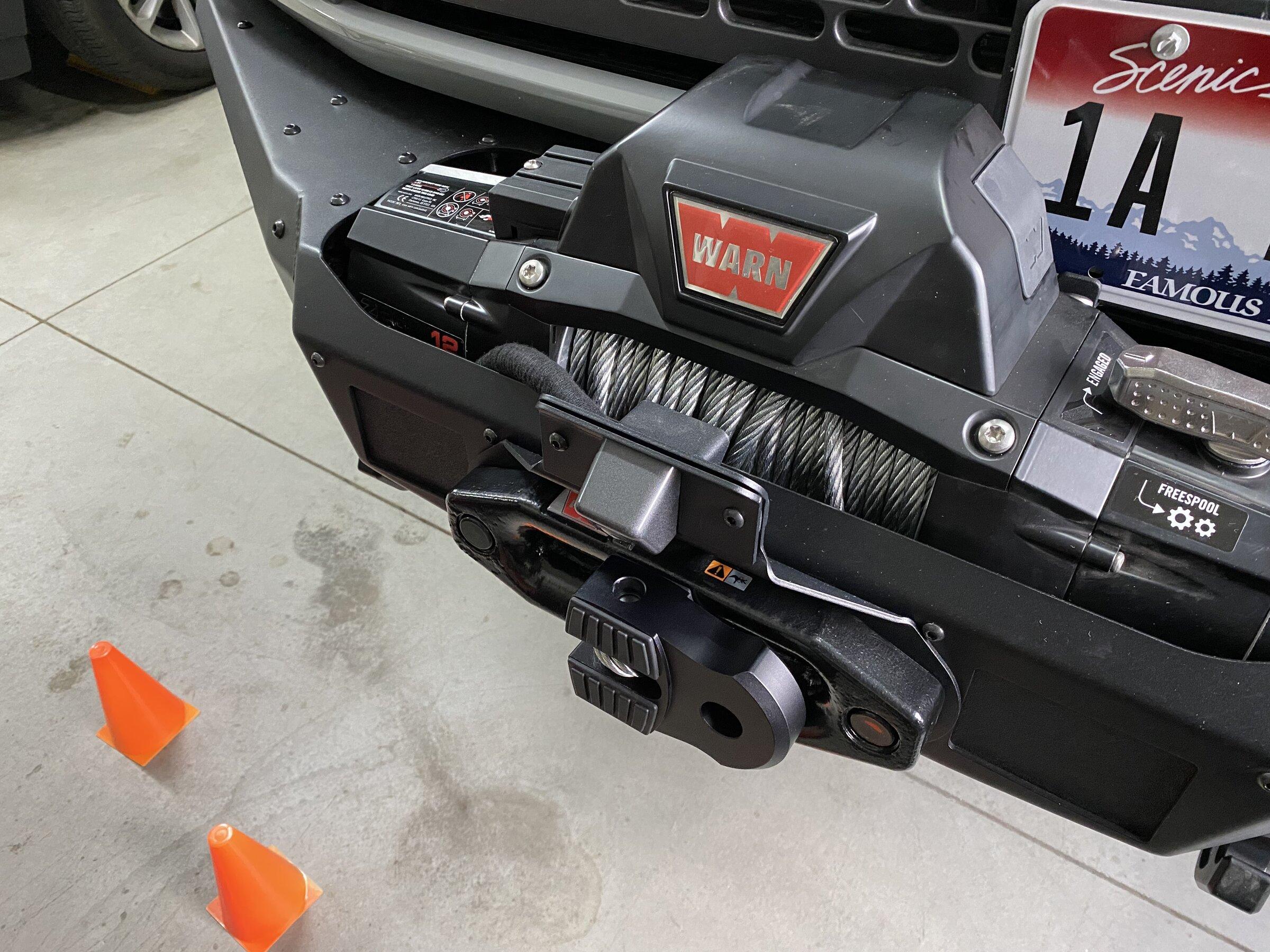

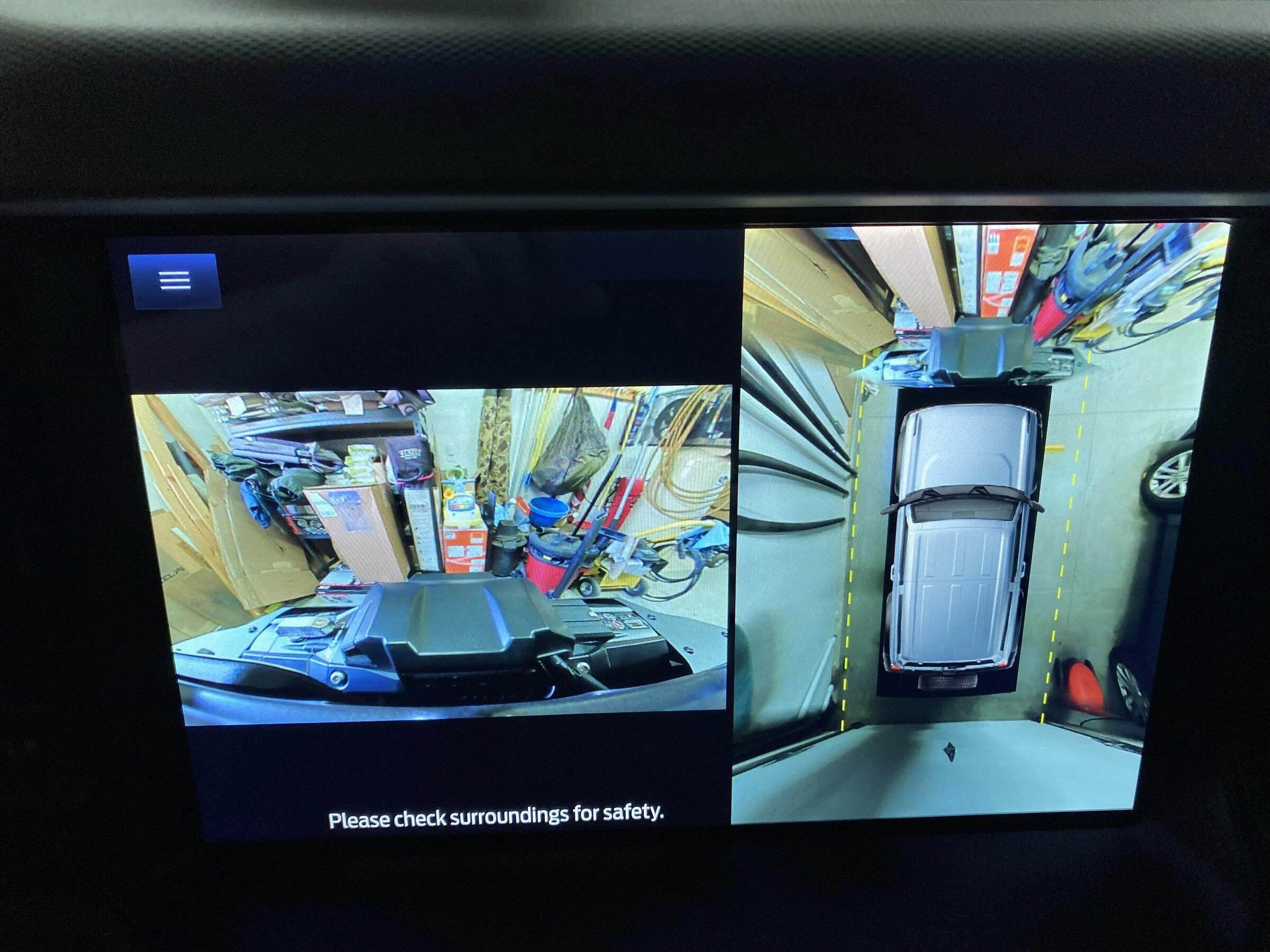

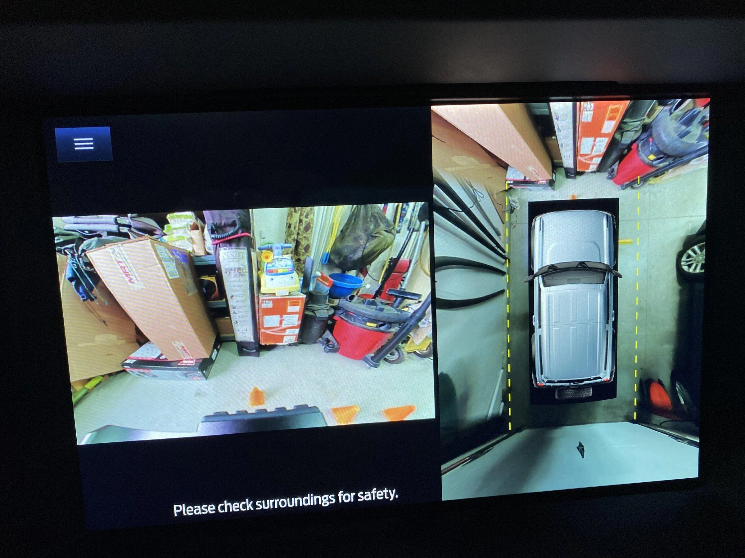

Thanks for the response. I just ordered the bumper and was thinking about a fair lead camera relocation mount. I want to use a front plate mount there also, so I hope they don’t interfere with each other. I’m planning on mounting a SB gen3 winch, looks to have a smaller profile
I tried the fairlead camera relocation bracket. The bracket is ugly and I didn't find a way to hide the camera cable/hose, but the view of forward obstacles is improved.
Maxlider camera view:
Maxlider w/JCR camera bracket:
Cones show visible ground area with relocation bracket:

I can live with that combo, did you say earlier you tried the fair lead plate mount also?

I haven't tried the JCR plate mount. I would like to see it.

Man this is exactly the kind of pictures I was hoping to see. Thanks. Did you also try to use the camera view without the bracket but relocate the winch controller module?
Clearly the view is unobstructed by relocating the camera but you lose a little field of view. Just trying to figure out what the better compromise is.
No. I think the bumper would still obstruct the ground view more than I wanted. I also didn't want an exposed spool.

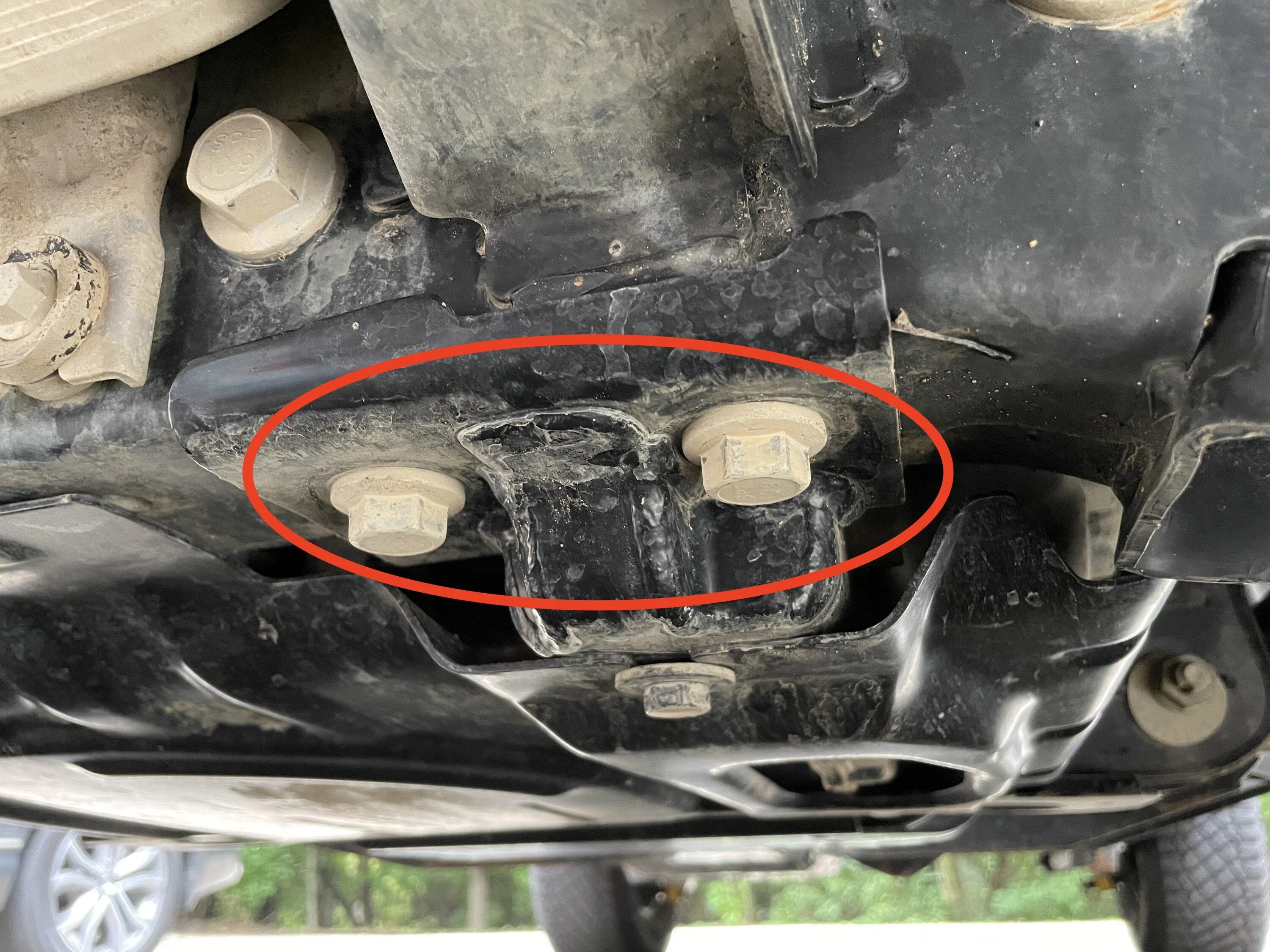

I"m just now getting around to installing the skid plate. Another step they skipped entirely in their video...
Instead of bolting to the original two locations, the skid plate mounts to two bolts that seem to have a really high torque spec. I couldn't get them to budge and I can't tell what the are holding up. I plan on bracing the area underneath with a jack to be sure nothing weird happens, but does anyone have the torque spec on these bolts?

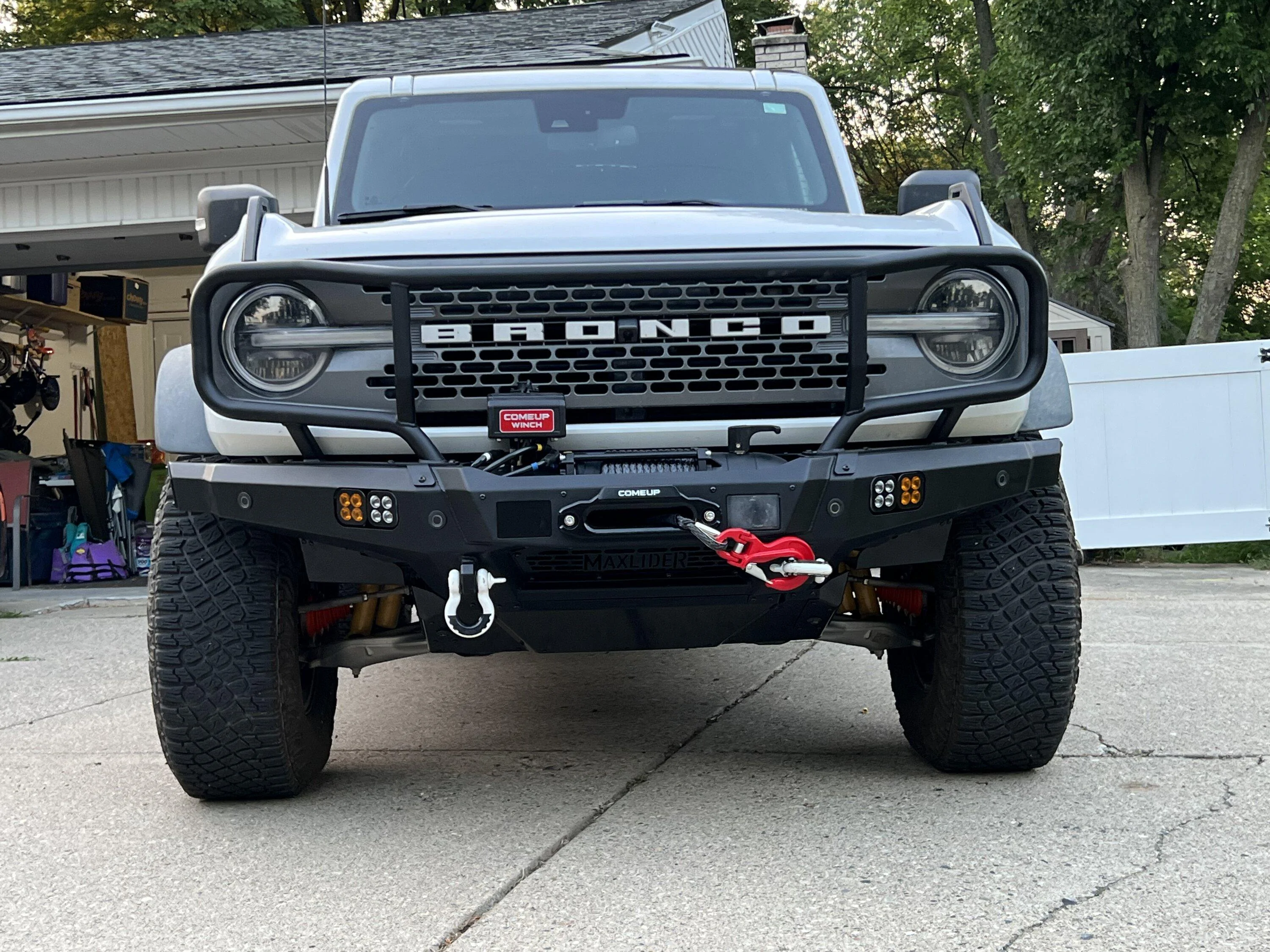

Bumper looks great. Can I please get pic from the front and close up from the front showing the alignment of the bumper extensions with the SAS fender?
