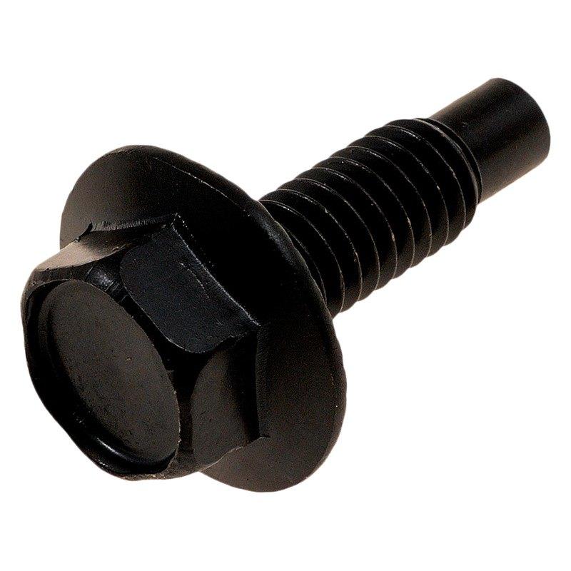

I want to make a change on my tire carrier need a bolt that is a little longer.
The factory bolt looks like the pic below. It is a M8.
The bolts I find locally look just like a standard hex head bolt NOT like the one in the picture.
If I get a M8 size and the grade (5.8, 8.8, 10.9) is correct or higher & correct thread pitch will it work?
Are there any special attributes in the bolts that are used in auto work....like the ones pictured?
I can not find any that have the bolt end showing past the thread.
factory bolt

So that is dog point hex flanged bolt.
To answer your question… yes you should use a similar bolt of the same grade. If you are replacing it with a longer bolt you can use a higher grade just to be a bit safer. If you can’t find an equivalent flanged bolt you can just use a washer as a replacement for the flange.
Admittedly the grading may or may not really matter—depends on what type of stresses these bolts will be under and we don’t have all the details of what you’re trying to do.

You have it!! The tip is my concern.
Will any bolt (any head I am willing to work with) matching the grade rating, work in an application where a pilot tip was originally used? Even if the replacement does not have the tip?

The lead point is to help speed up alignment on the assembly line. It serves no other purpose. In the metric world of "grades" 5.8 roughly equal to a Grade-2, 8.8 = Grade-5, and a 10.9 = Grade-8. In automotive it is 50/50 if the bolts will be stamped with a Grade/strength indicator. If you can't find the part you need with the flange, a standard hex bolt and washer will serve the same function. For your application I wouldn't go below a Grade-8.8. Preferably a 10.9. Where the automotive parts have an advantage is in the coating. The corrosion protection on the automotive hardware is far superior to the commercial equivalent. https://www.mcmaster.com/screws/hex-head-screws/

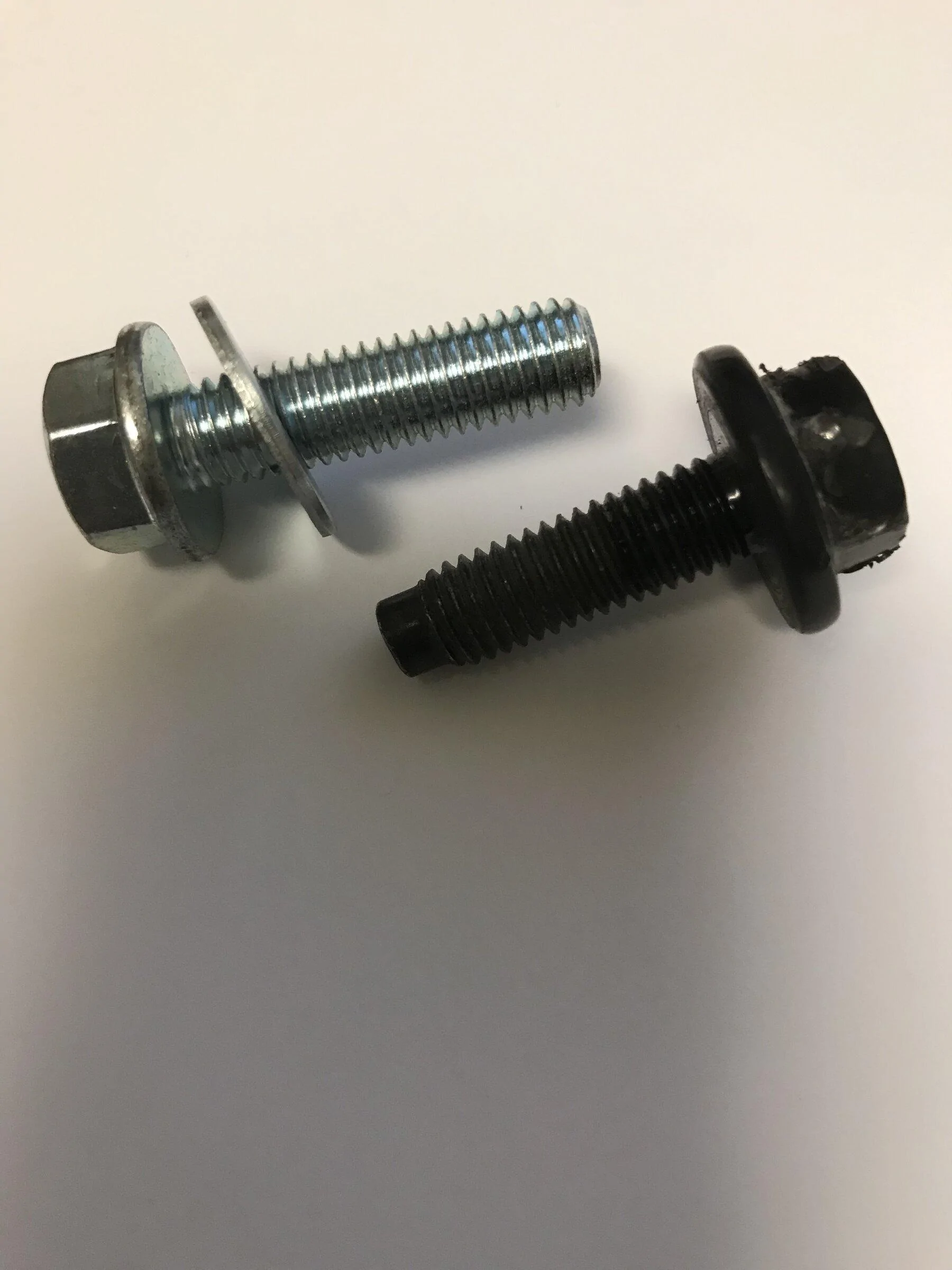

Using these. Nothing special once Igained a little knowledge.
No fancy point and no special coating. No extra horsepower.
They fit and are identical grade as the one coming out.
Thanks again for answering my questions.
