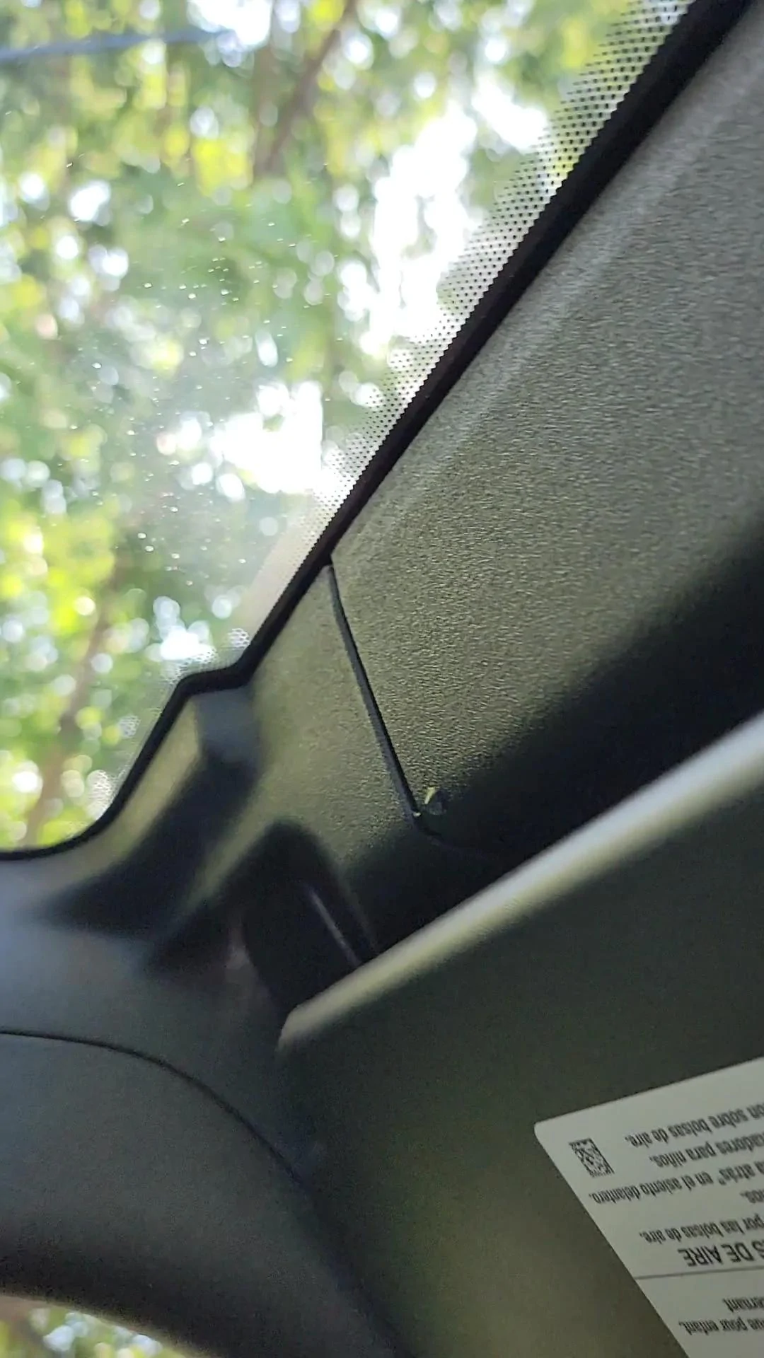

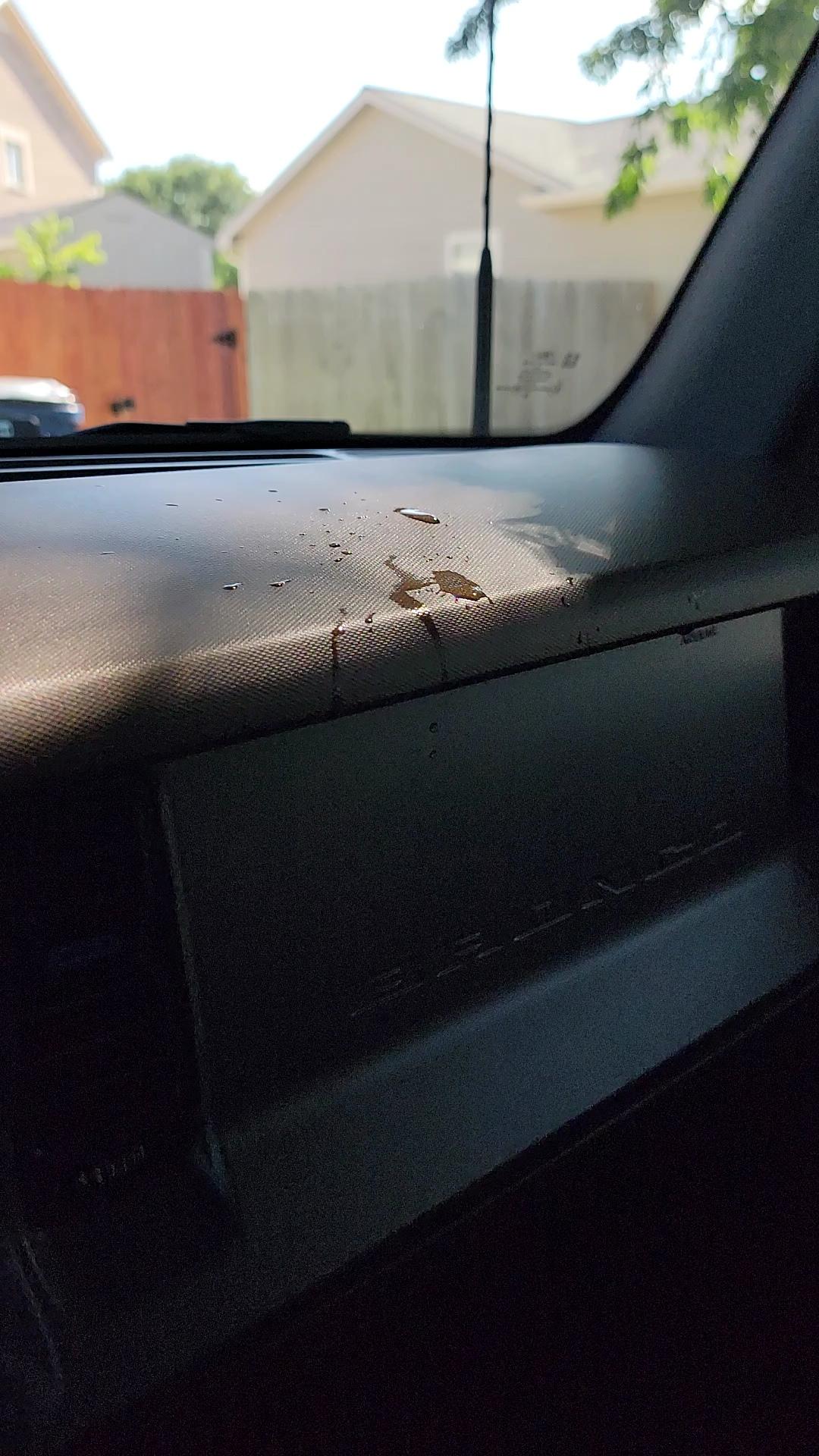

Just the other day, went through a car wash and had my 2022 leak from behind the passenger sun visor. Never had any issues since it was purchased in September of last year. It's extremely disappointing for such an expensive vehicle
Ford Bronco MIC Hard Top v2 Leaking VideoCapture_20230802-100652
Ford Bronco MIC Hard Top v2 Leaking VideoCapture_20230802-100700

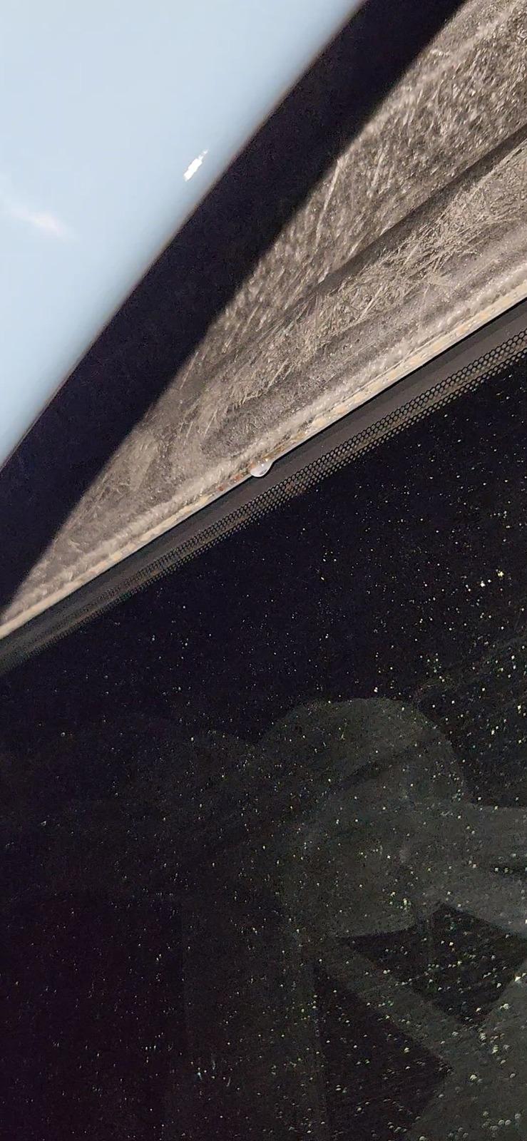

I know this thread is old but I have had my 23 badlands for just over a year and both my rear mic top windows leak. Had it at the dealer today, they tested and couldn't reproduce the leak. Luckily mother nature stepped in and once I got it home it started to rain. After 6 hrs sitting in the rain, both rear windows are leaking from the top edge.
It's 10pm so I plan to take it in in the morning , but was your dealer able to resolve your issue? Did they just reinstall/seal them, and are you satisfied?
Ford Bronco MIC Hard Top v2 Leaking 1000004914
Update: Dealer basically just told me to go pound sand. Since the water has all dried up, they say they can't do anything. Photos and videos, they didn't even want to see as it has to be "actively leaking" for them to diagnose where the issue is. I get that to an extent, but there are drops of water on the inside edge of the MIC top around the rear windows... where could the water be coming from if not the seal around the windows?
I've engaged Ford Customer Support for what that's worth...
Mine JUST started leaking this morning in the same place 😡 No issues since I picked it up September of last year (live in a cold climate so only got to take the MIC top off a couple times before winter hit, and only front 2 panels) but no issues all winter, through spring downpours, or touch free car washes. Then this morning turned into a road and water came out above the visor -what’s the heck??? I figured it was the MIC but checked all around when I got to work and nothing was wet there, then found a little plastic seam behind the mirror was slightly wet, I shudder to think what is behind the plastic cover 😞 Did you have any findings/resolutions? Thanks!
