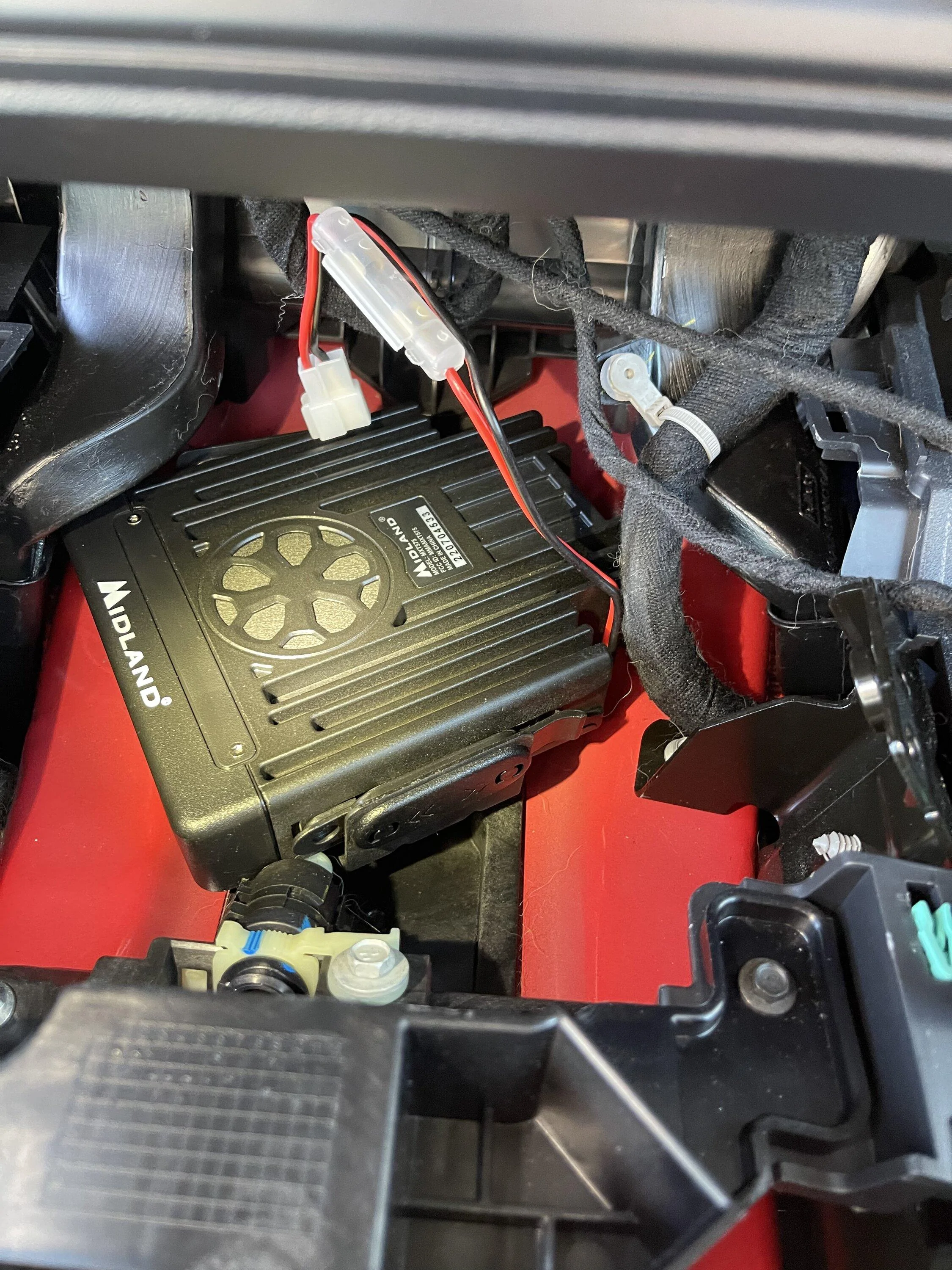

I was able to weasel the mxt575 under the center console like this:

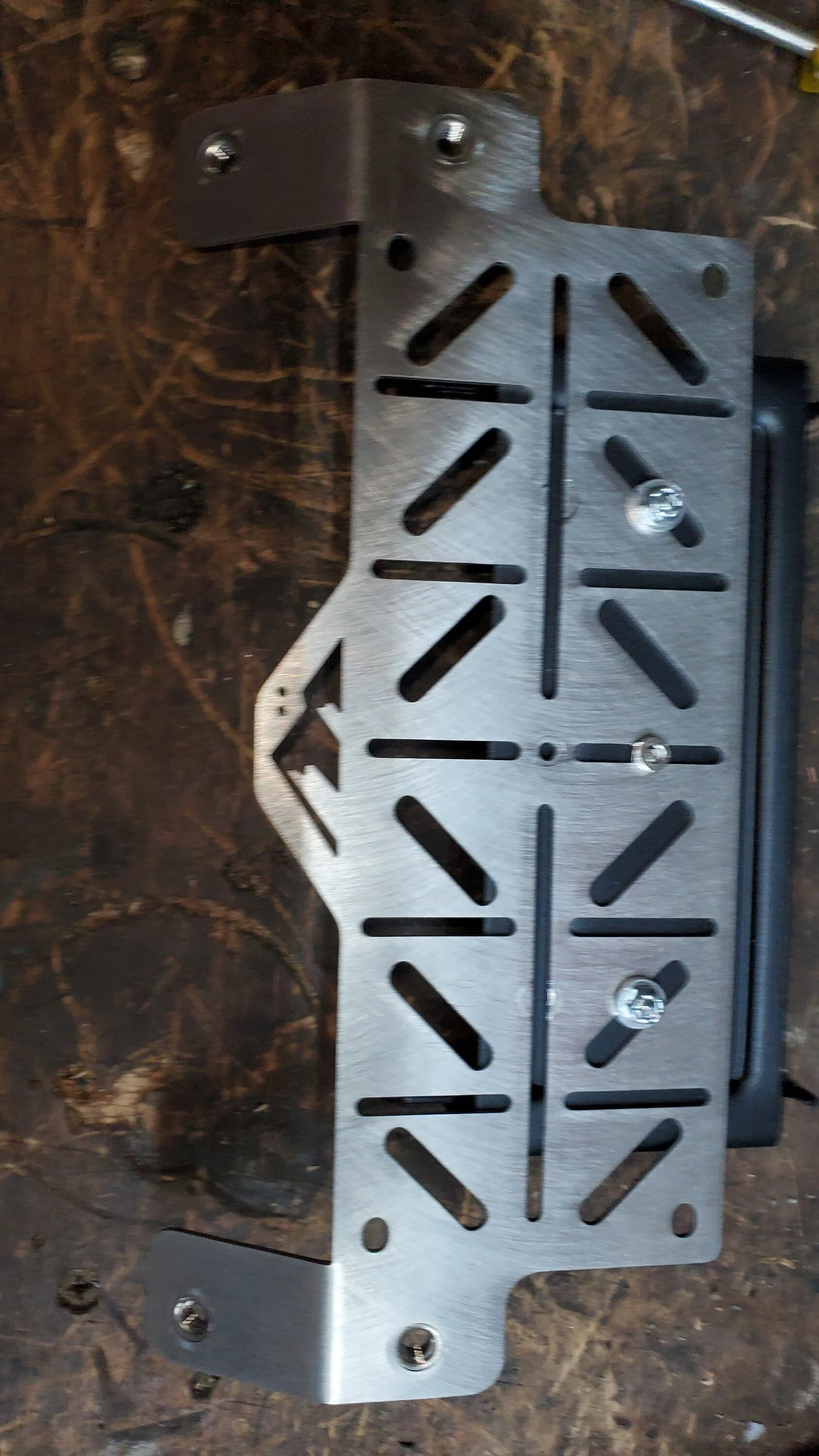

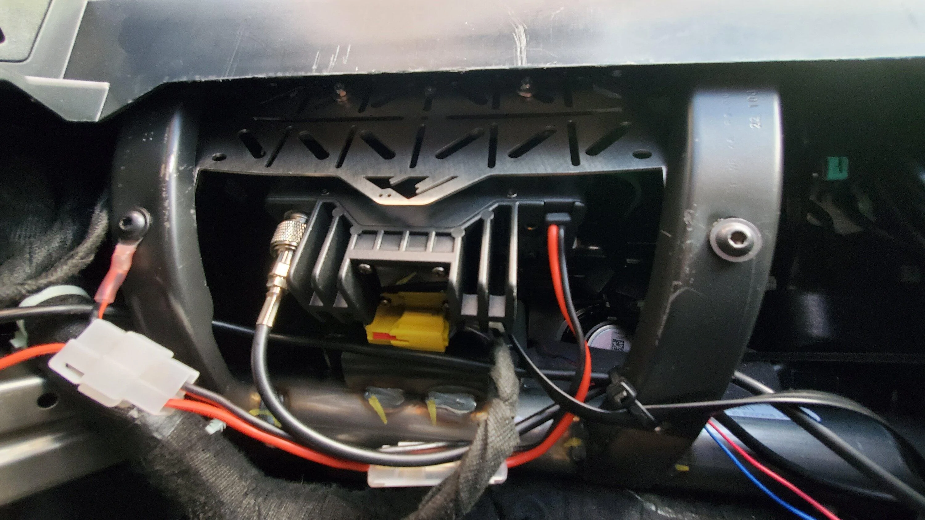

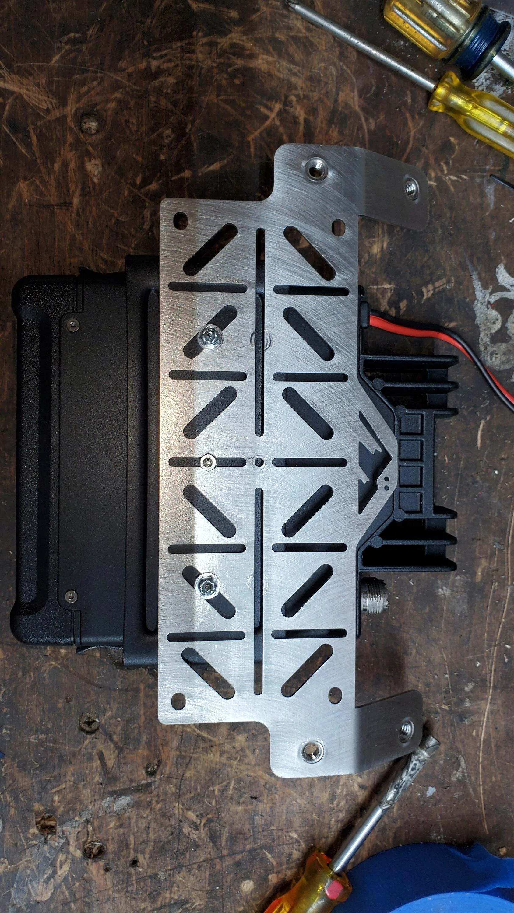

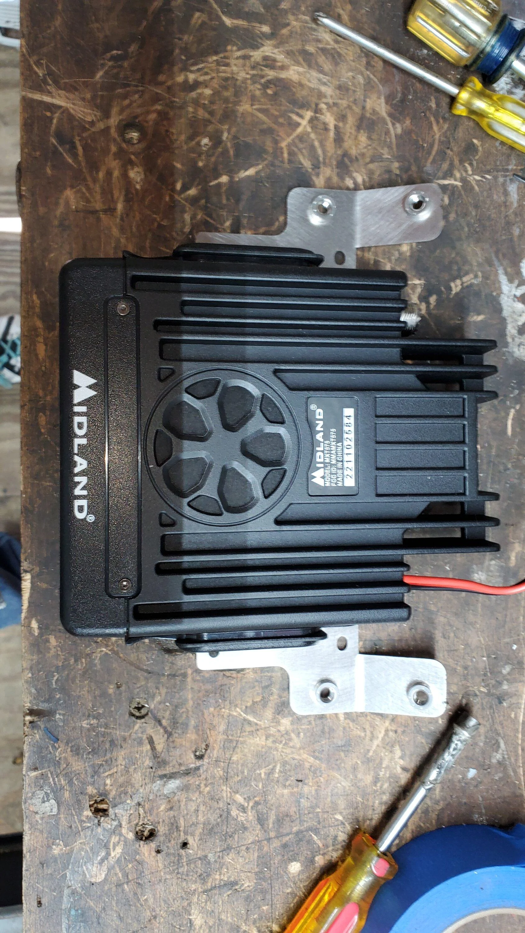

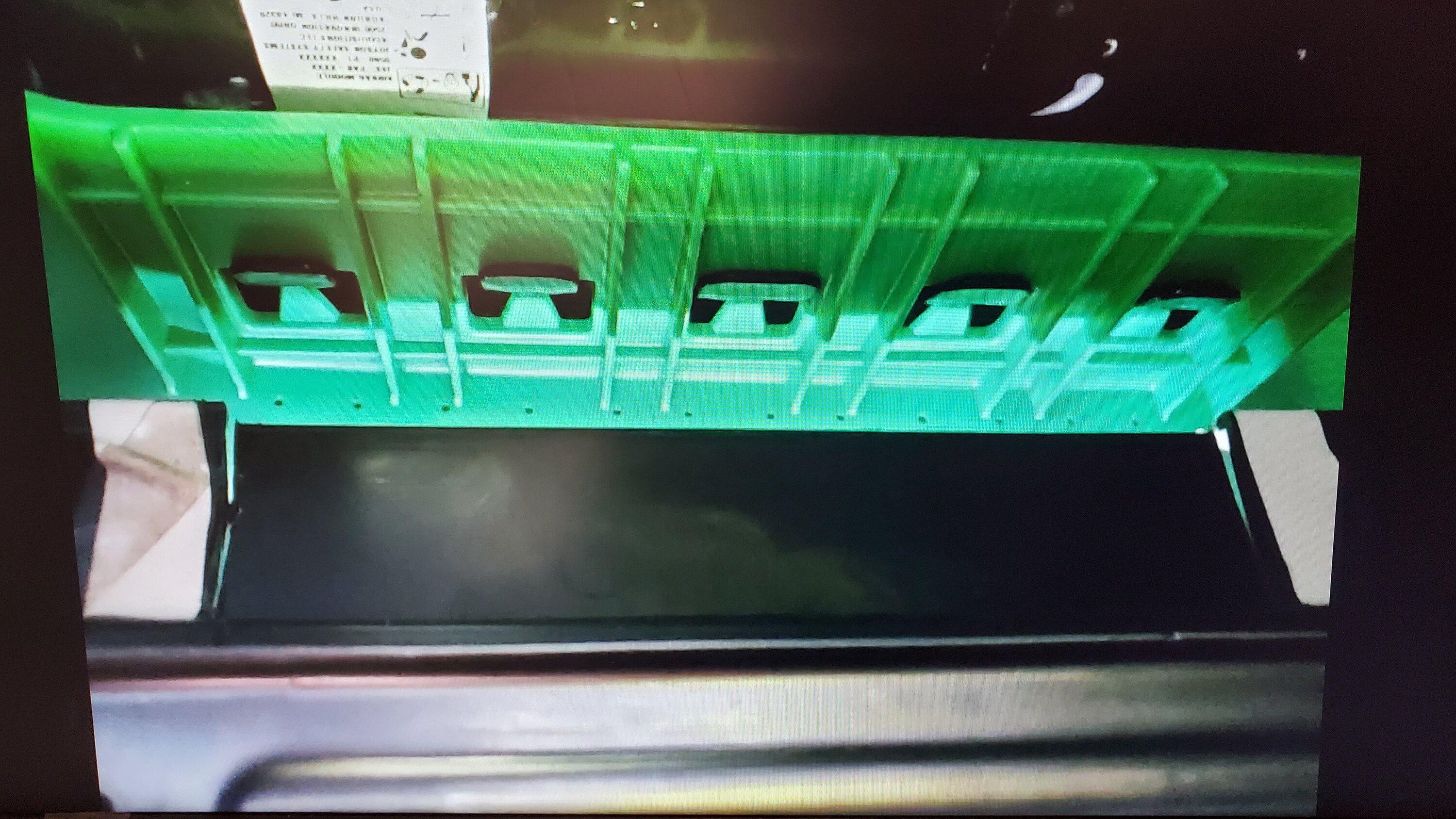

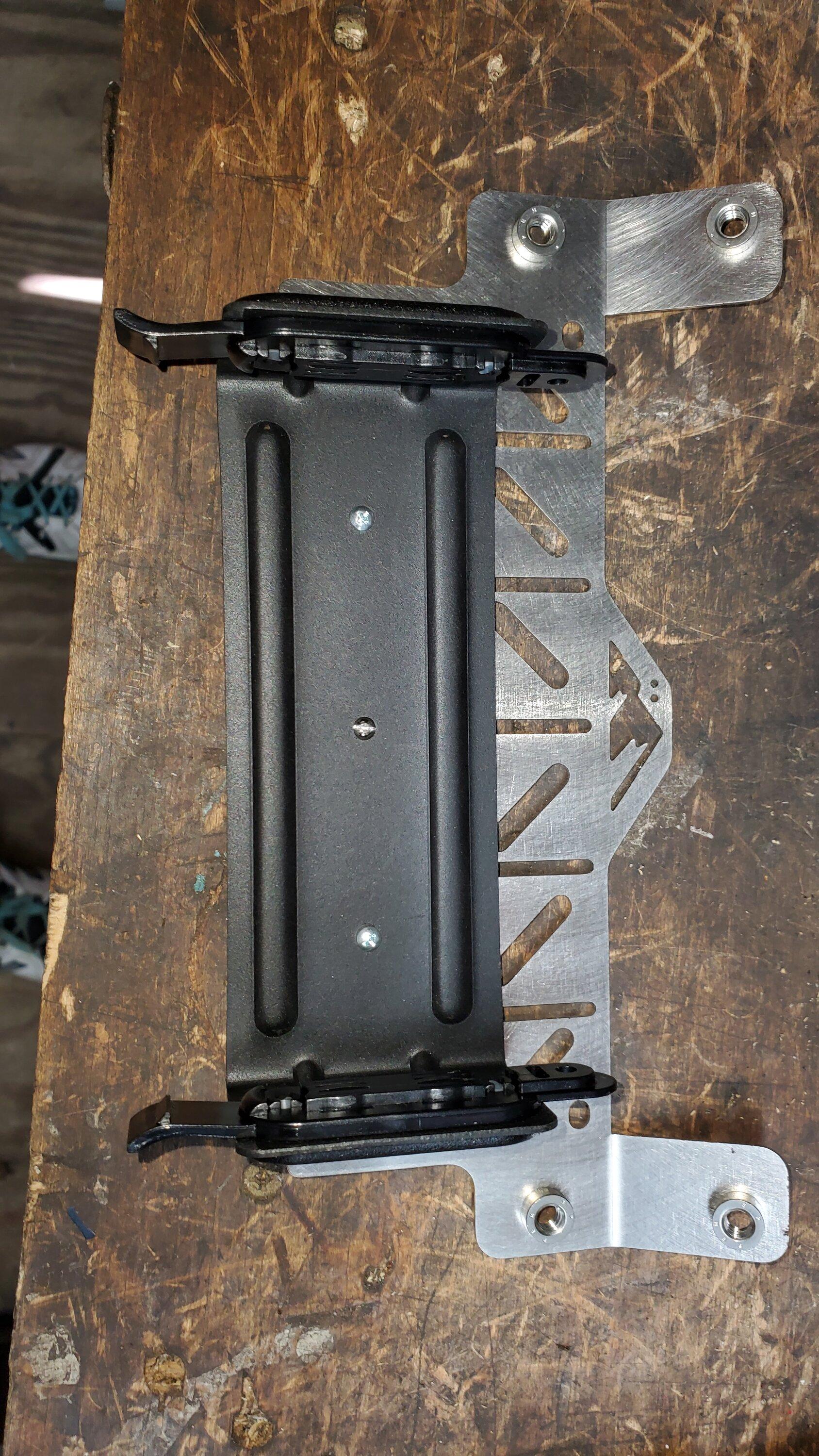

I ordered the Midland MXT575 and the M2M mount.
Reviewed maybe all of the BroncoG6 threads about the best way to mount and was thinking I would mount like the MXT275 and notch the glovebox.
Removed the glovebox today to do the install.
After careful review I did the following and had no need to notch the glovebox.
Take a look at the first picture and I took a brand-new utility blade and made 2 cuts in the dash plastic support (next to the 2 pieces of white tape.) This allowed me to move the radio deeper into the dash. Looking at the rest of the pictures you can see exactly where I mounted the radio mount to the M2M mount and installed as intended by M2M.
Ford Bronco Midlands MXT575 Mounting ideas??? 1
Ford Bronco Midlands MXT575 Mounting ideas??? 2
Ford Bronco Midlands MXT575 Mounting ideas??? 3
Ford Bronco Midlands MXT575 Mounting ideas??? 4
Ford Bronco Midlands MXT575 Mounting ideas??? 5
Ford Bronco Midlands MXT575 Mounting ideas??? 6
DocBrown did you have any issues with this install? Any tips or suggestions? This is the ideal way to go from my prospective is she fits.
Thanks!
