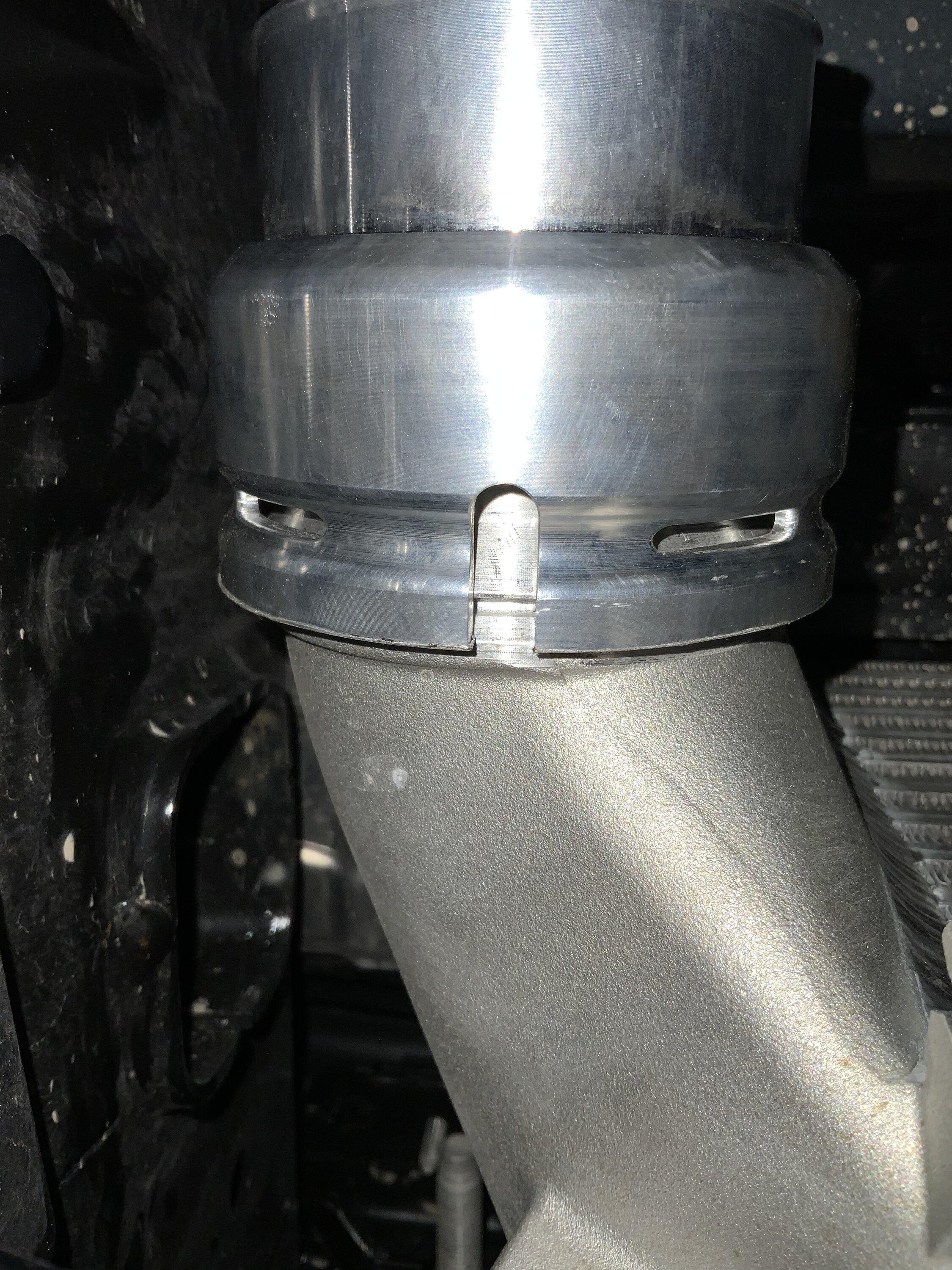

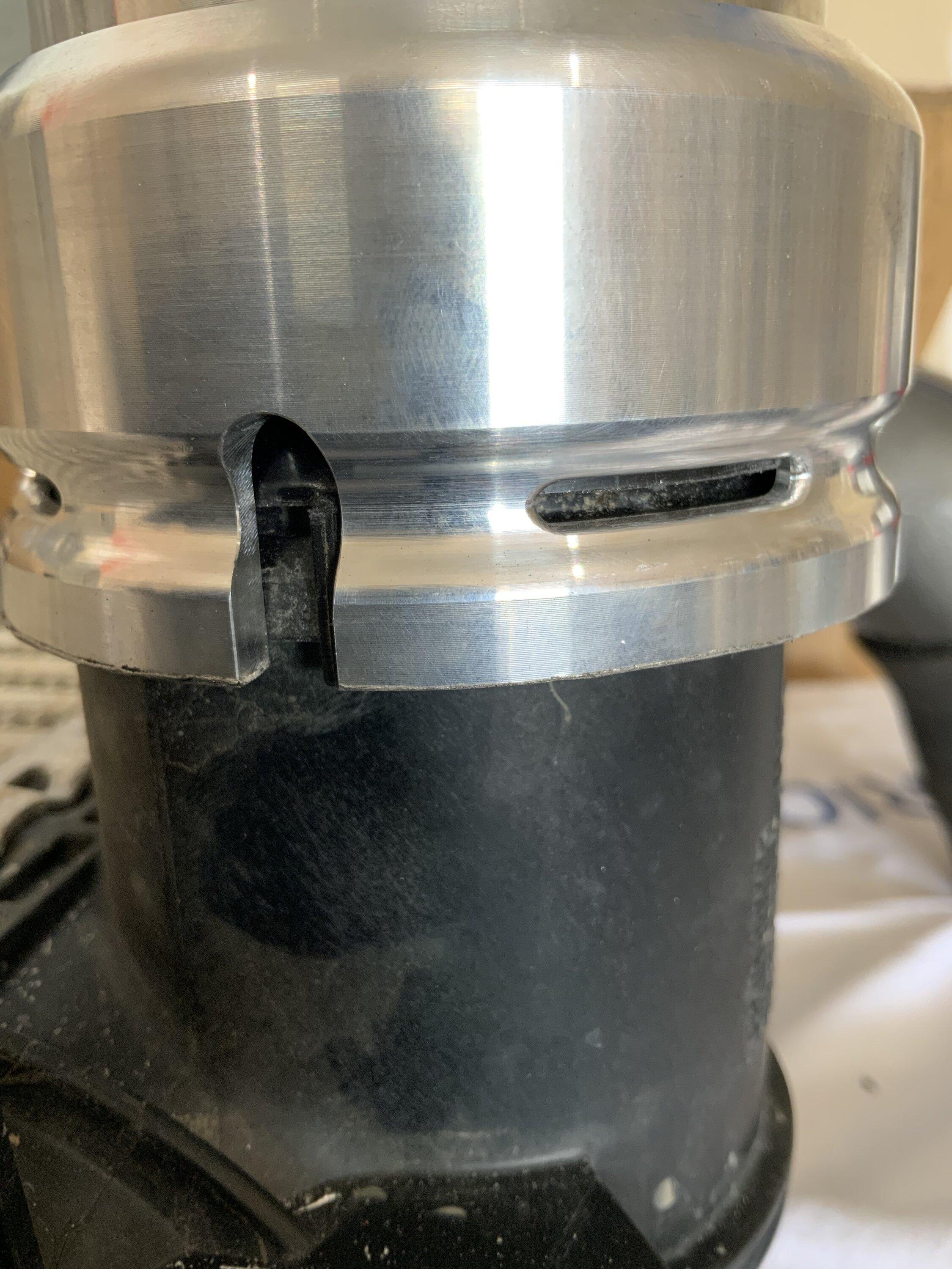

K&N cold side coupler not seating deep enough on Whipple IC………

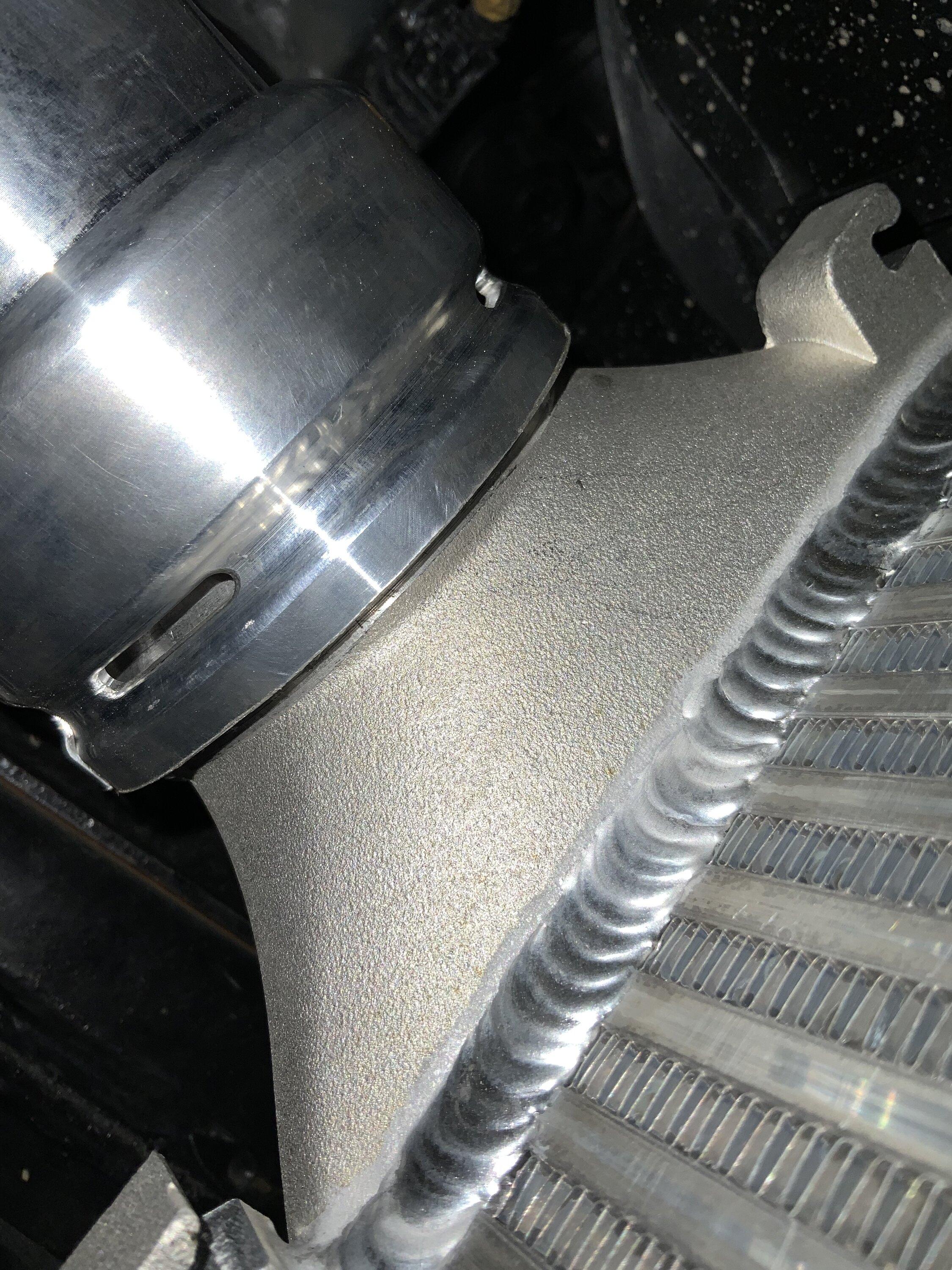

Seats normally on stock IC………
what in the fuck?!

I think it’s all in the shape of those ends. Stock has a longer neck to the tank.
