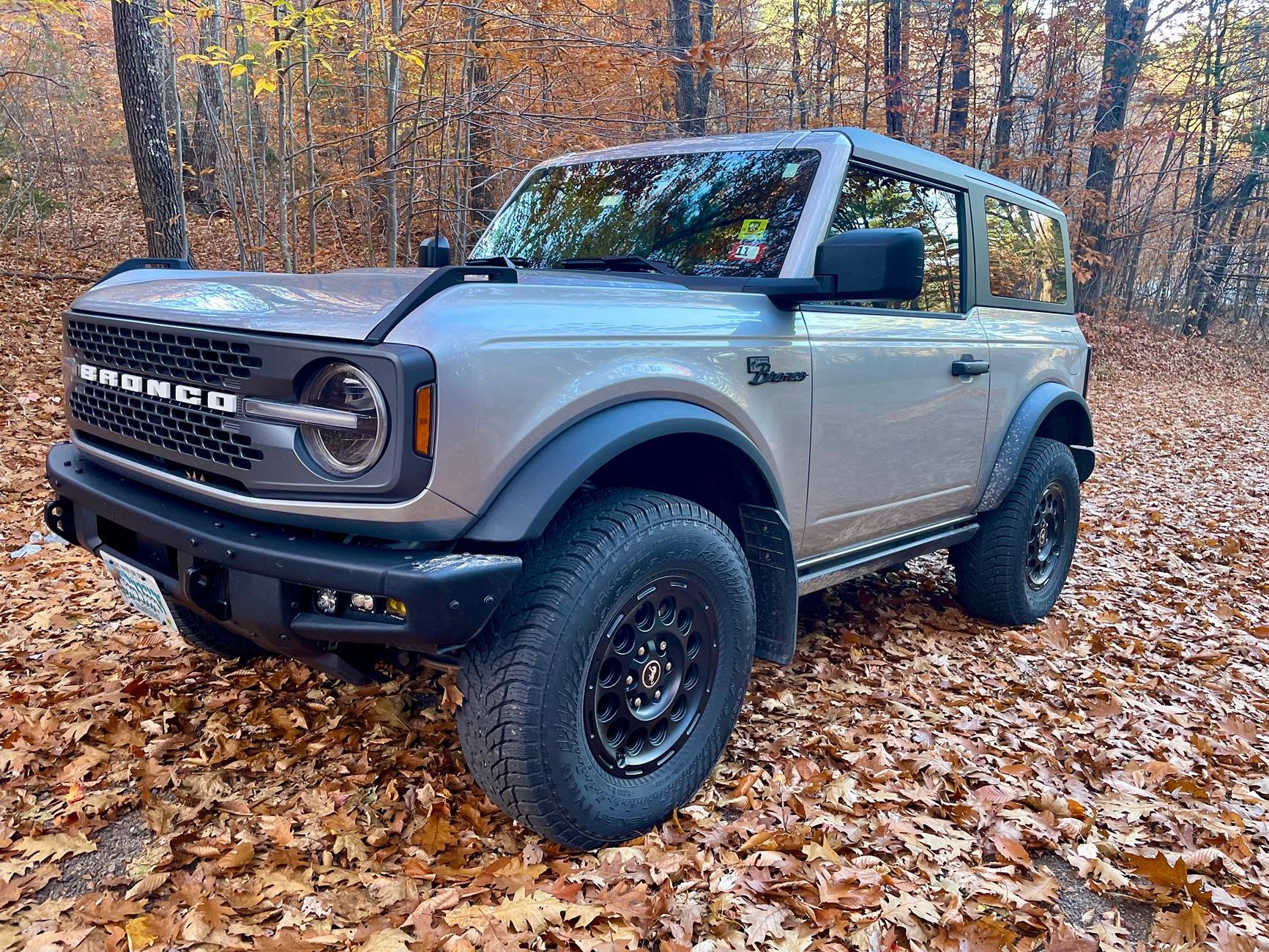

I put on the Rough Country lights
Very happy with them so far, super bright.
Ford Bronco Modular Bumper: Three Fog Lights IMG_4027
