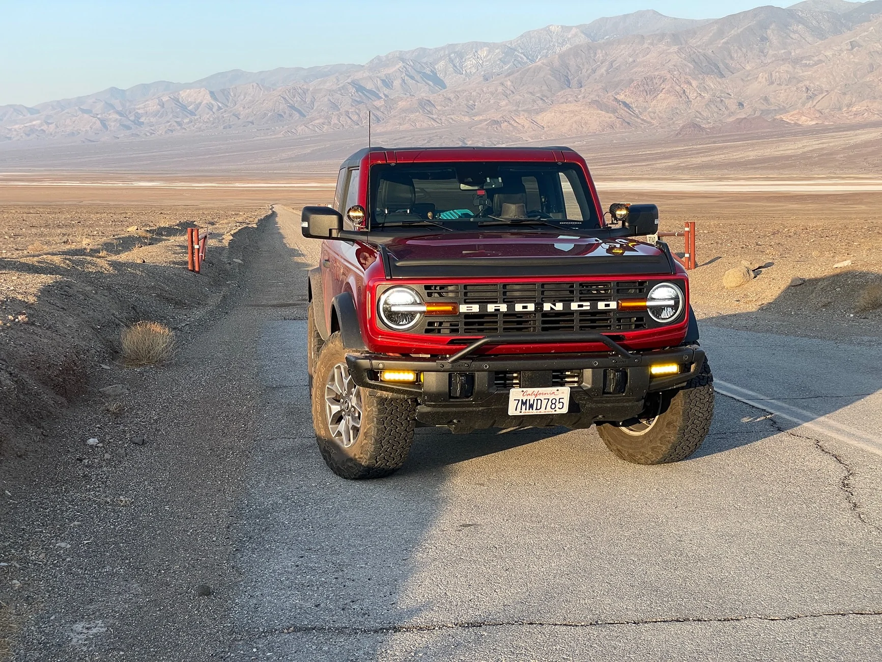

Would something like this work to avoid needing add switches on either the dash or panel?
https://www.4x4truckleds.com/diode-...ckets-for-2021-ford-bronco-hd-modular-bumper/
Those are the fog lights I got, in amber. I bought them from 4x4truckleds, tho mine are the previous generation DD stage series lights. I installed them with their pigtails that connect directly to the existing OEM fog light harness so no added switches needed. I’m very happy with them.
