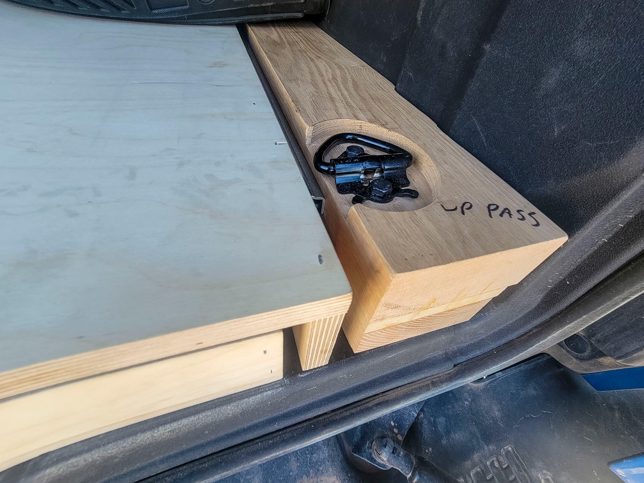

What keeps the sides that hold the runners from moving when you remove the drawer? Are they screwed to the Bronco floor?

Those beefy blocks on each side of the siding unit are bolted to the floor through the factory tie down locations. We reused the factory tie downs and recessed them in the wood to make them flush. A close up shot of one tie in point in attached photo. That drawer assembly will still be attached if I roll the Bronco.
