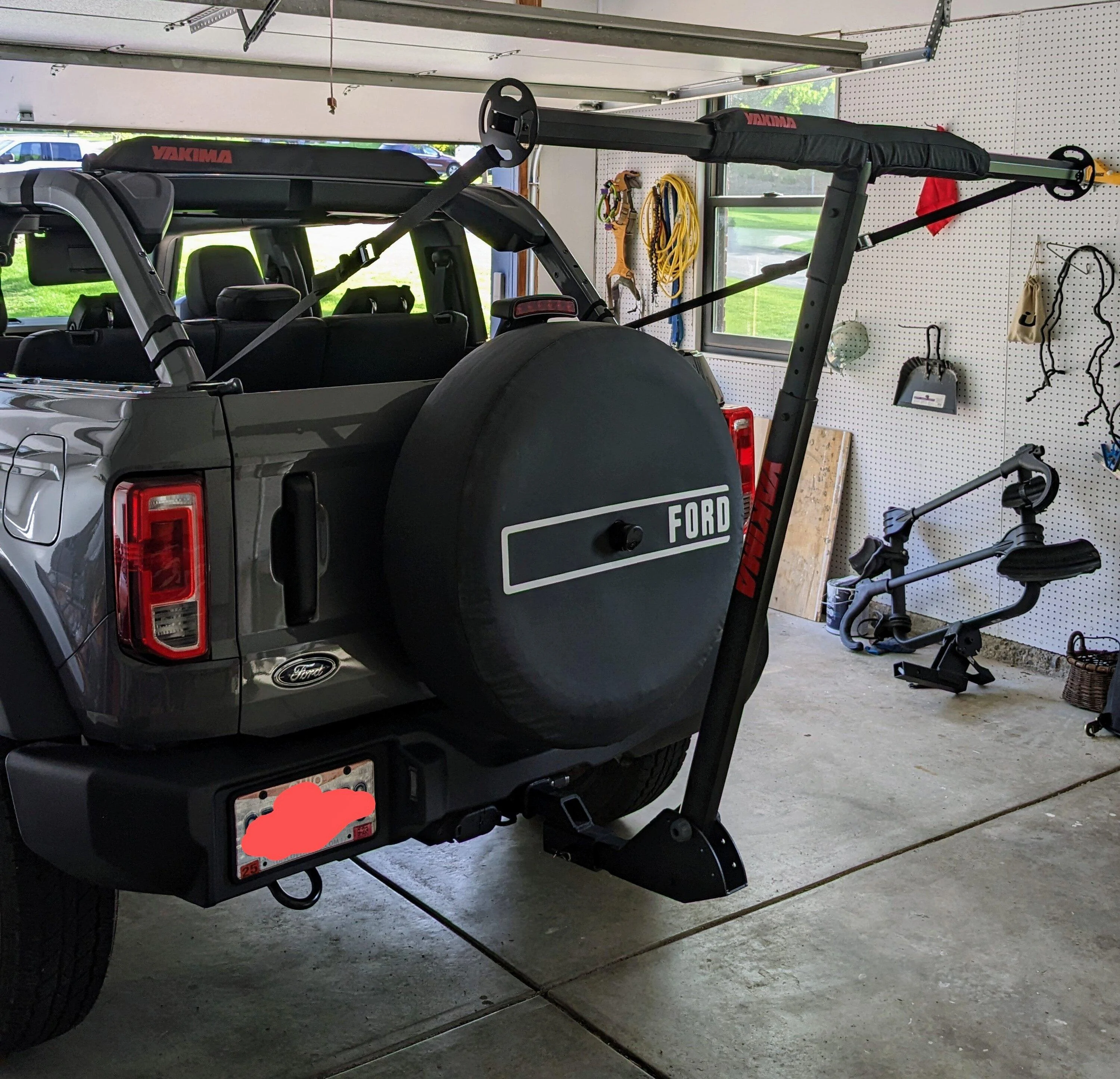

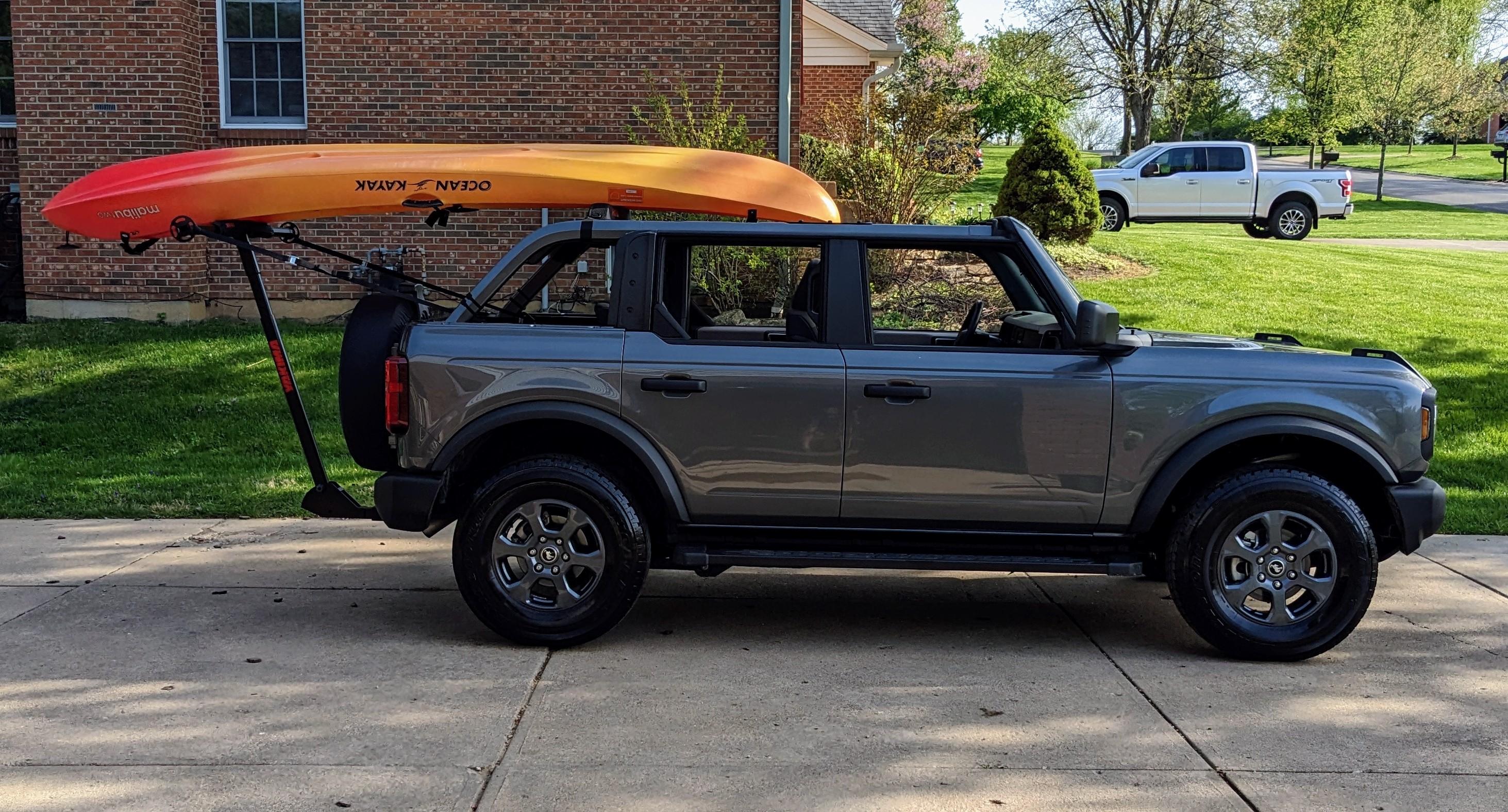

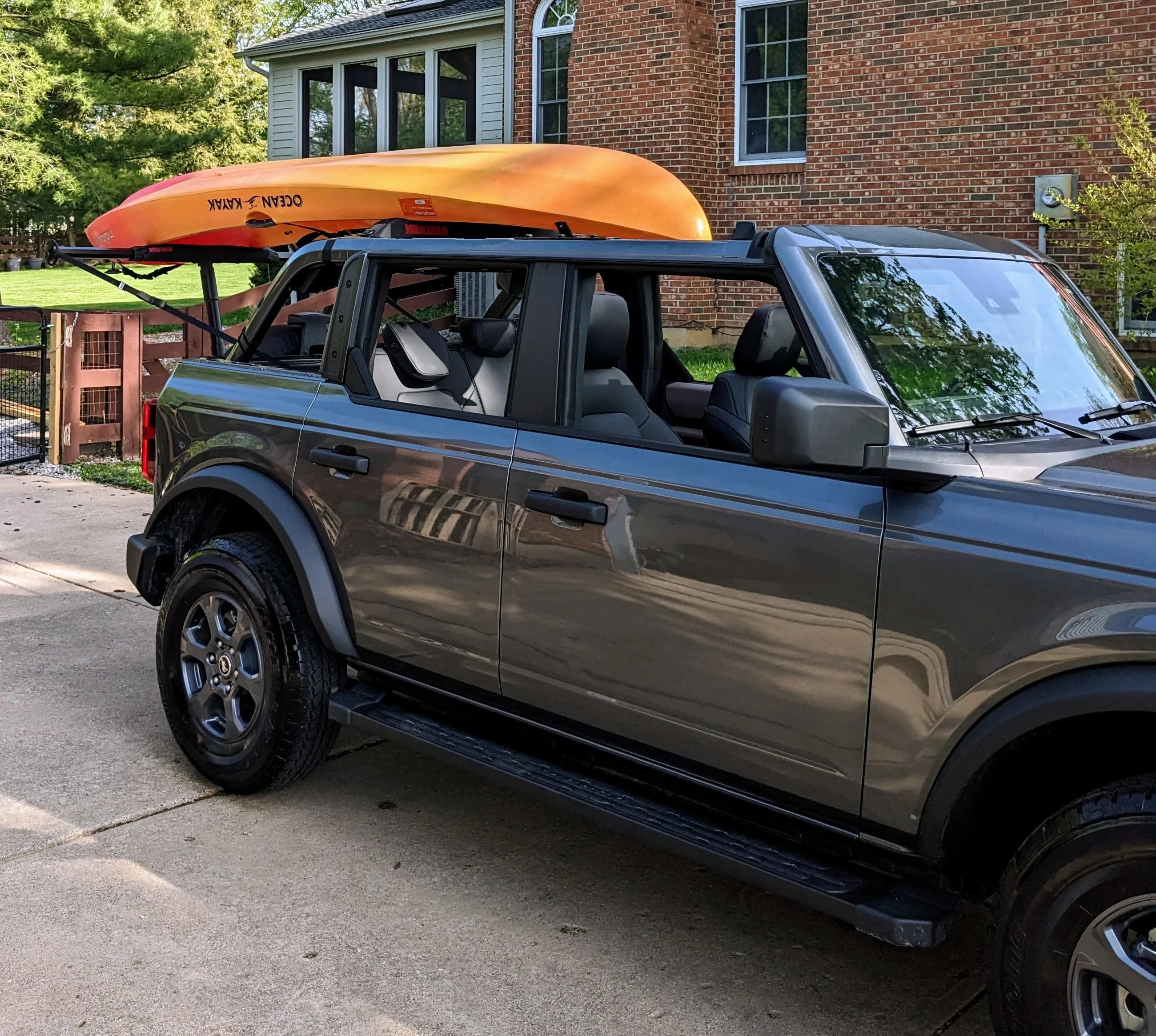

Figured I'd post my setup for summertime since my roof will basically never be on the vehicle and I haven't seen anybody post something similar yet. I simply use the rollbar as my front crossbar along with a Yakima Easy Top pad, and in the rear I use a Yakima Long arm hitch rack.
The stabilizer straps on the hitch rack attach perfectly to the car seat anchor points on the backs of the rear seats and the d rings in the cargo bed are great for running the forward tie down strap for the kayak.

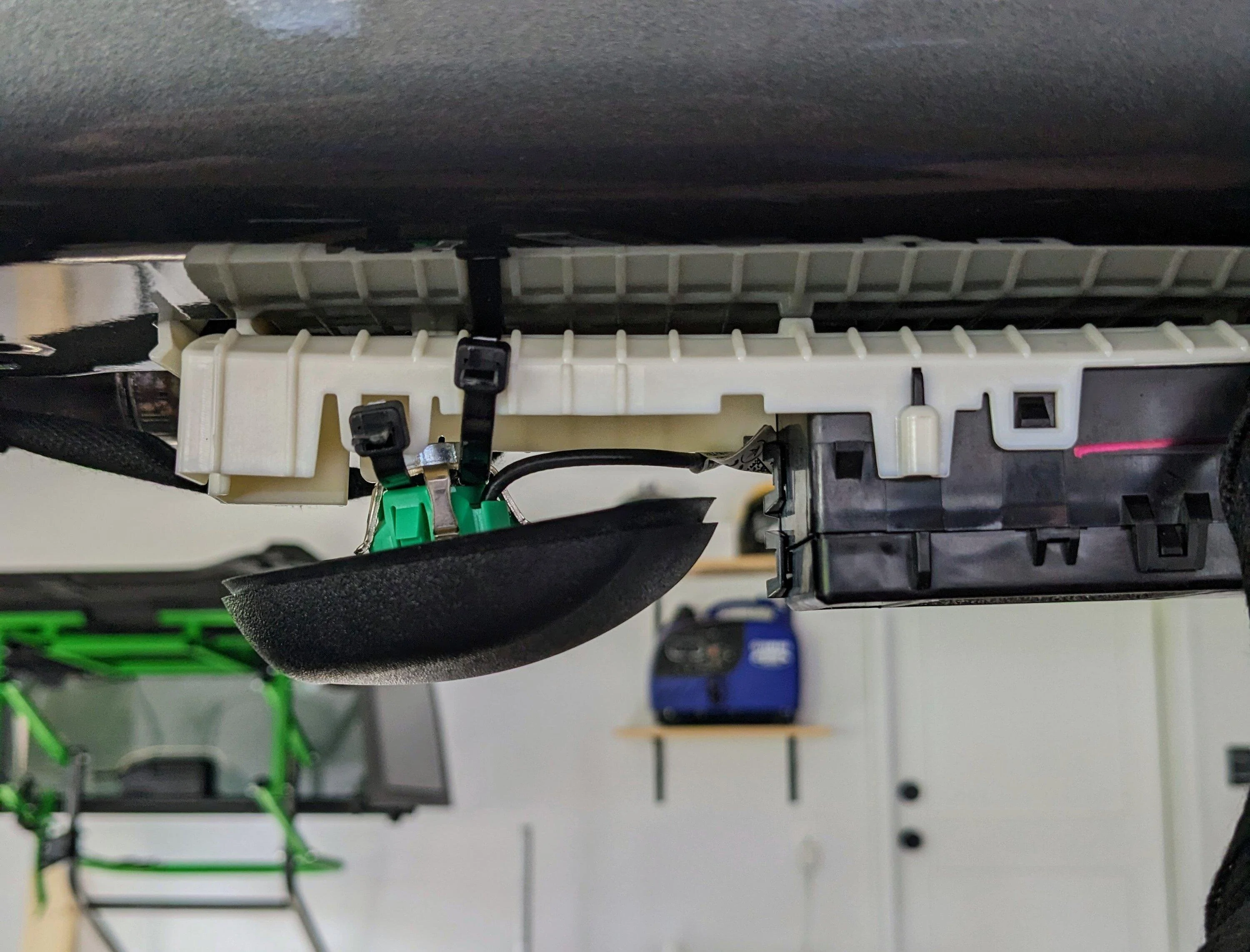

One thing to note, the black Sirius XM antenna on top of the rollbar does get in the way so I unbolted it and then ziptied it to the wiring harness that runs inside the rollbar (last pic below). This allows you to keep it plugged in but then gives you a nice flat surface up top once it's relocated. The process is pretty easy if anybody wants to try it - I attached the how to doc here for unbolting the antenna.

Might want to tie a red flag on the back of that….is that close to 4’ extended past the back?

Yeah it's right about 4' - I always keep a flag in the back for sure though. Honestly, the whole thing could actually be moved about 2 feet forward by putting the rear hitch rack in the fully vertical position (rather than angled back like I have it) and then just sliding kayak forward.

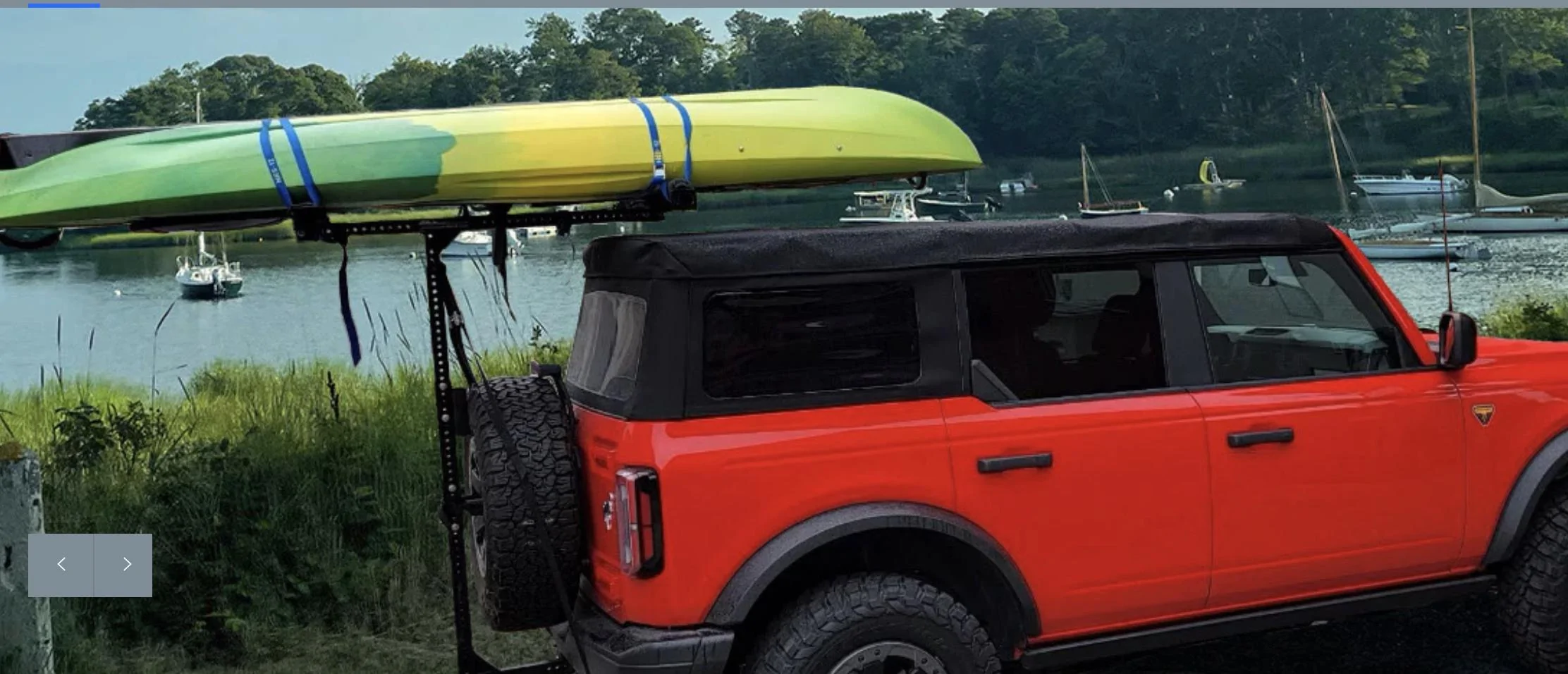

This looks like a good solution. I was looking at the hitch mount rack which completely suspends Kayak above the Bronco and doesn’t touch it at all, but the kayak would sit further back and price is high. I think access to back would be a problem with either. You’d need a swing out extension or to take the rack off the hitch.

Yes it is, I place the front end of the kayak on the rear rack then just slide the whole thing forward until it's over the rollbar. Slide it off the opposite way to remove.

Not to keen on the kayak sticking that far aft; looks solid. Better than when I loaded my 16' Delta on top of my 12' Spark.

I was worried about rear access too but I found in reality if the top is on there's no reason I can't just grab whatever I need by putting a rear seat down and reaching in cargo area through rear passenger door. Really the whole point of this setup is running it with top off tho so obviously you don't even need to open the hatch if there's no top over the cargo space - just reach over the side.
I had one of those swing away hitches on my bike rack for awhile, I found that the massive extra weight and complexity they add was not worth the rarely-used convenience of needing to open the hatch for the few hours I was using it. I guess I could see wanting that feature if you left the rack on at all times but I take it off when not in use anyways.
