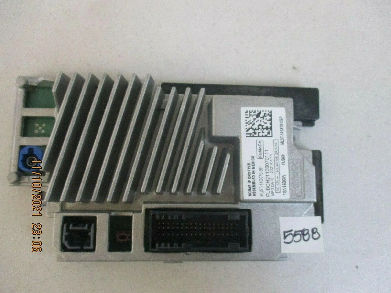

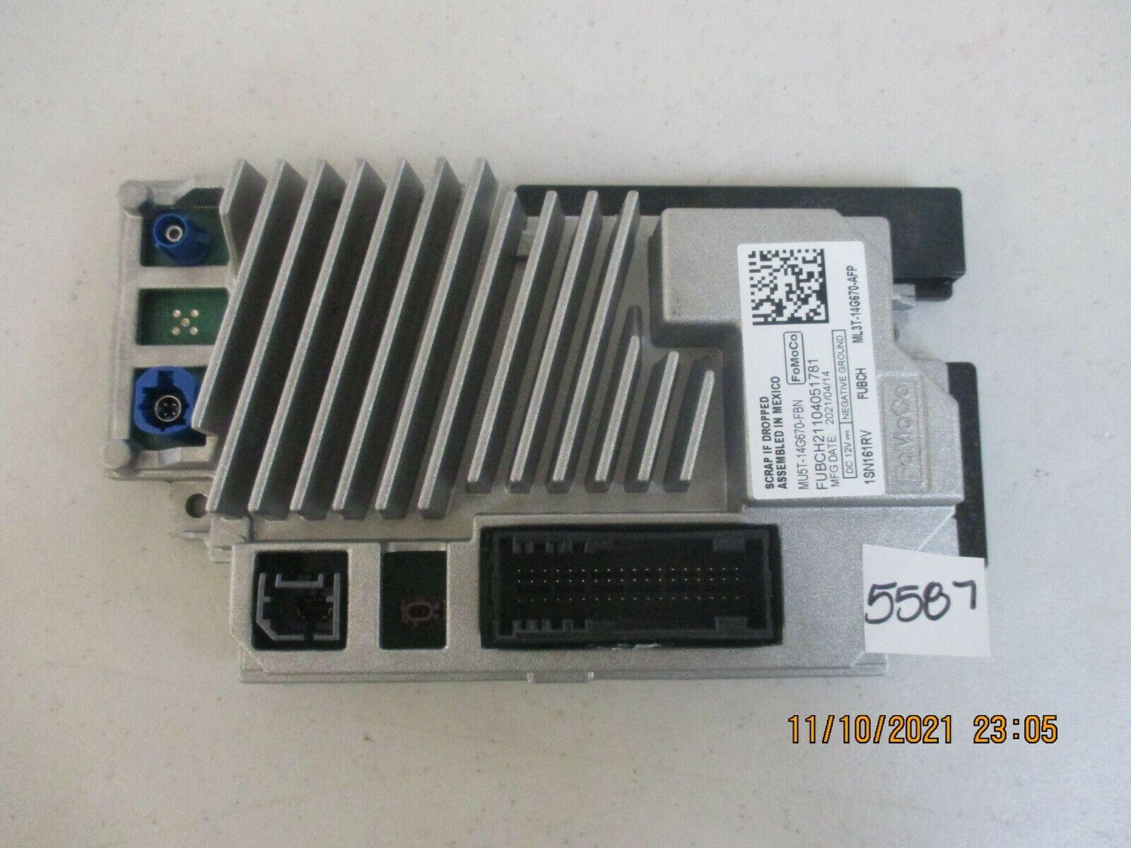

I'm guessing not. Sync2 stored maps externally on an SD card. Sync3 and Sync4 store them internally. The non-nav Sync3 APIMs simply did not have enough storage for maps and your only option was to physically swap the APIM. I wouldn't be surprised if Sync4 was the same.
Given the Sync 4 APIM still uses the same 54-pin connector as all previous generations (even the base 2008 version without a touchscreen), there's hope an APIM swap is a viable upgrade path.
Looking on eBay, the nav APIM has an additional fark connector for anntnna. Similar to previous upgrade kits, probably have to add your own antenna. It appears there's also a physical difference between "8 inch" and "12 inch" APIMs, with 12" gaining yet another fark connector in the empty spot in these two pictures.
