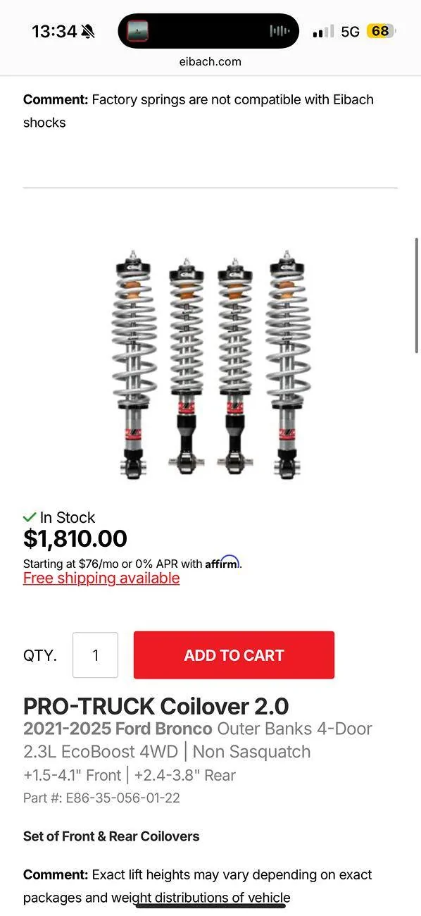

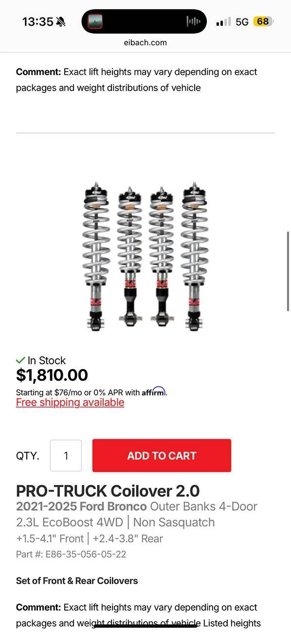

Recently I have decided to go with the eibach Pro-Truck Coilover 2.0 as I am pretty new to this stuff and it seemed like it would offer decent comfortability as well as some ride height to fit bigger tires however I have stumbled across 2 nearly identical pairs and I’m not sure what the difference is between them or which one is better for what. Do any of yall know?

Pretty sure the 05-22s come with the HD springs installed...
From their description of the 05-22:
Comment: Exact lift heights may vary depending on exact packages and weight distributions of vehicle Listed heights are with 150lbs additional weight over front axle and 500lbs additional weight over rear axle. Listed lift heights are heights with full weight front and rear, range is full range of coil over adjustment (full low to full high).

Correct!
The springs are the only difference between those 2 kits shown.

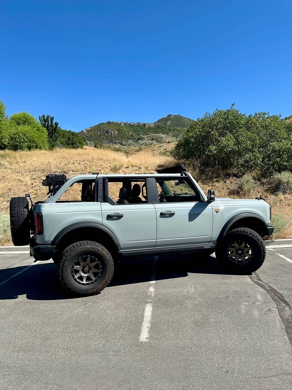

I recently installed the HD Eibachs and couldn't be happier. I wish I did a better job of measuring before and after, but I had them installed right out of the box with no adjustments and it looks fantastic on my non-Squatch Badlands on 35" KO2s. I'd have to measure, but I'm definitely a bit taller than a Sasquatch now.

Here's the Eibach Pro-Truck coilover 2.0 HD with no adjustment out of the box. Stock control arms, and everything else, on a 2021 2.3 Badlands non-Sasquatch with 35" KO2s
